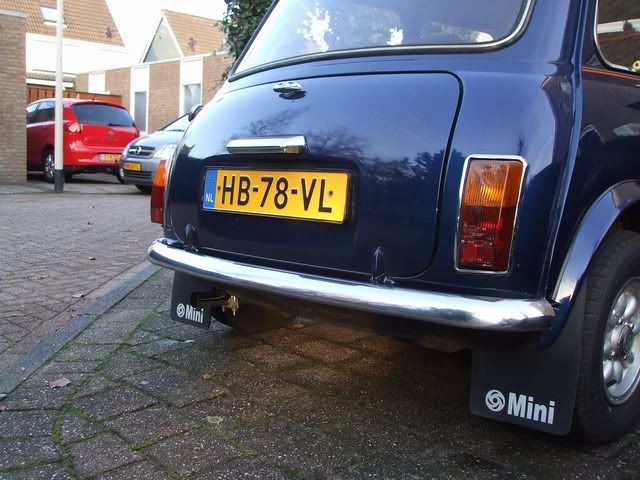

Risky: do you have Any photos of yours?
Yea sure, he looks like this at the moment. I'm going to fit some hi-lo's this thursday so it should go a little lower.
The wing still has to be repainted in the right colour, but that will be done soon when I've got some spare time!
