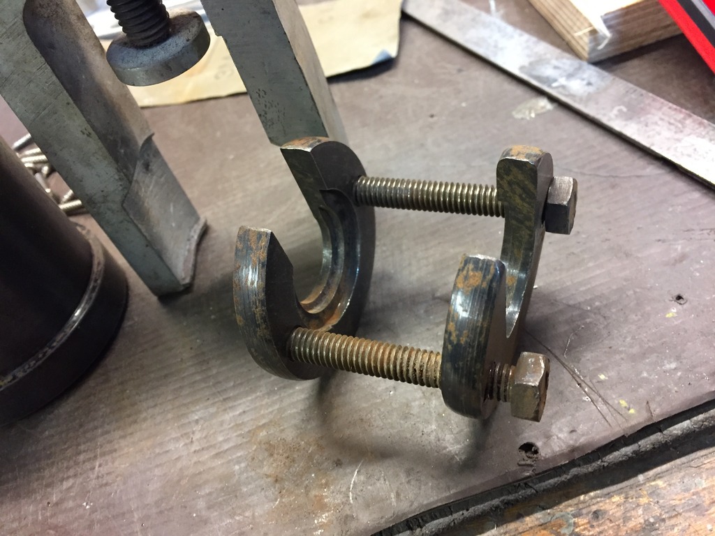

With the problem with the gearbox I thought I'd try and get my hands on an another gearbox to strip apart and put back together to see how to do it (or what not to do) I managed to find someone local selling some locally for £25 each, so obviously bought 2 :lol:. So this weekend I stopped them down. It was a pretty simple task really with the help of a mini magazine guide.To get the first motion shaft out you ideally need a slide hammer, which we have but attaching the 2 together was a problem, the thread is really fine so had nothing apart from the nut that was on it. Luckily I was given a Starter bendix spring compressor (below pic) a while back which happened to be all the right dimensions :gimme:
f9aead1c3684072e7693112f861218c2bd1cbeda
With the help of a top arm washer I got this and pulled it out easily .
