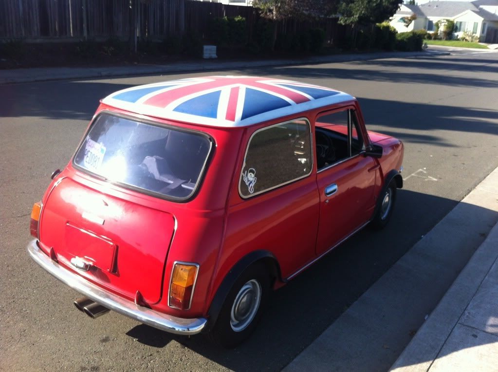

So, my 1960 Mini was parted out due to extensive rust. I am hoping I will be able to keep this one around longer.

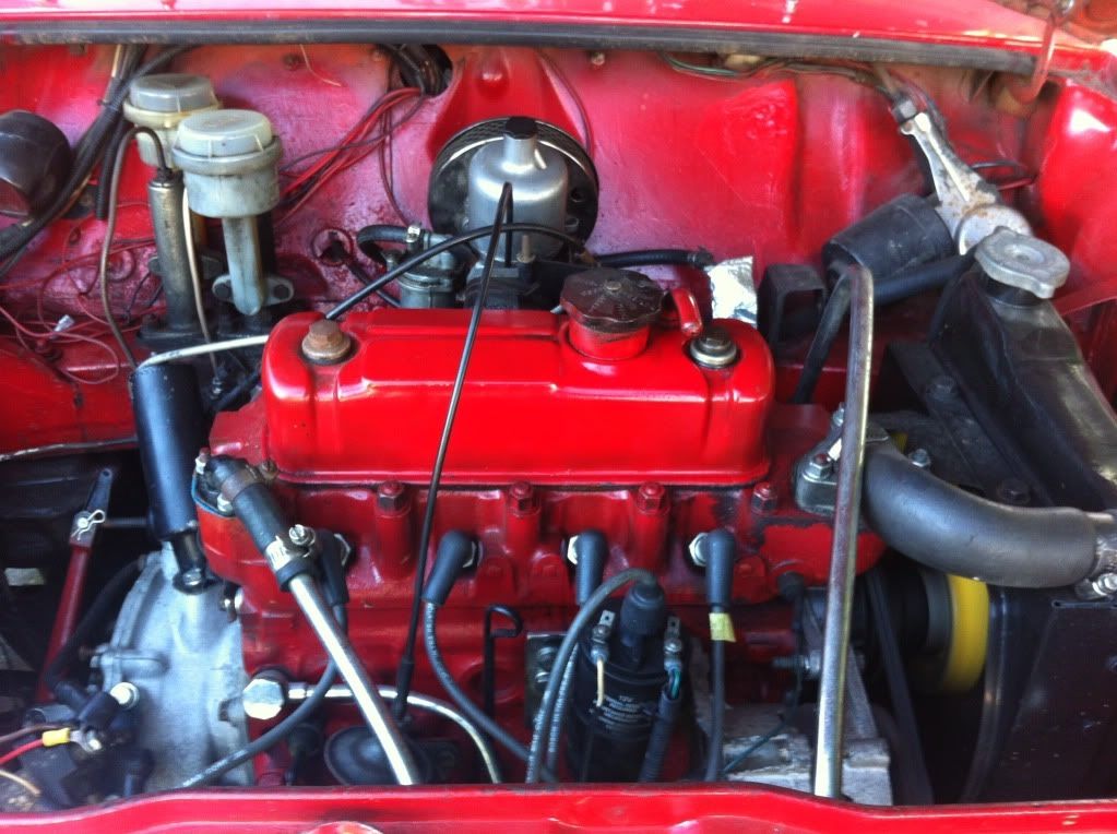

The story with this one, I have been shopping for another mini with a limited budget for awhile now. I came across this Mini on the Mini Mania website and noticed that it had been for sale for awhile now, since about June of this year. After sitting on the ad for about a week, I decided to contact the owner. He was asking $5500 USD, but I didn't want to pay that much. I had him send me additional pics of the car, since the ad only had one and I also asked him to send me pictures of all the rust and interior. He also provided me with video of it running. The rust still made me a little warry, so I decided to take a shot in the dark and offer him $3000 USD for it. He agreed to the price and we finished the deal out. I was also able to get it shipped up here from American Canyon, CA for $509 USD, not a bad price. The main reason why I think he had to sit on it for so long is because its a Clubman, the unloved model of the Mini line up. Most everyone wants the round nose, since its considered the classic design, but I have always an affinity for the odd.
Last Thursday, I received all of the paper work for the Mini and found a couple of receipts for work done at Mini Part, a British repair shop. The receipt showed that a used 1275 motor had been bought, and a complete rebuild of the short block had been done. I called the shop on Friday, and spoke to the owner, he told me everything that had been done to the motor, including a +20 overbore. He said that they had retained the previous owners transmission from his 998, but that the syncros and bearings were replaced in it. In all it ended up being over $3600 in work.
Yesterday (12/03/11), it shows up to the house. The drive was unable to get it started and said that he had trouble getting it started at his last stop. He thinks that its out of gas. I decide to start trying to figure out what was wrong with it, and the first thing I found is that the positive battery cable head was completely cracked through... So, I ran to the parts store and got a new head. After that, I spent a couple hours trying to figure out why it would catch and run for 10-20 seconds but then die randomly. I checked all of the connections, found a blown fuse, and I was already getting mad at the stereo system and alarm system that the previous owners installed (both will be getting ripped out). I checked the plugs, and found out that I had flooded them, and put some other one that I had laying around in. I also checked the ignition components, most of which seem to be new. My next step today or tomorrow is to put in fresh gas, as I don't know how long its been sitting. I already pumped out the old gas out of the tank.
Rust:
The previous owner told me about the rust in the right front floor pan, that was definitely there. There is also rust in the right sill / door step area. I also found a little bit in the left front floor pan as well. The rest of the car has a little bubbling, but seems to be ok overall.
Some photos the the previous owner took:

So, Chuck got bored and found out that just the steering column is shot, the steering rack is ok. The problem though, is that the steering column is nothing like Chuck has seen before (been around Mini's for the last 40 years, but never worked on a Aussie Mini before). It has parts of Mk 1, 2, and 3 aspects in it and is shorter then standard. He also found out that the fuel adjustment nut on the carb 27 flats off (double what it should be), so the jet had barely any room to move and help choke the carb.

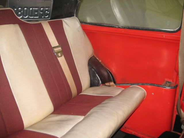

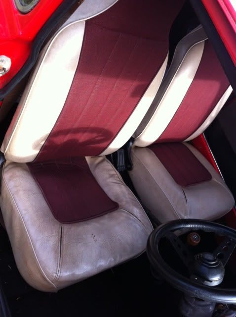

Get it running and driving for now. Hope that the motor checks out and is in good shape. After all the little things are fixed, I want to convert it to discs up front. Once all that is done, get the body work sorted and repaint it. There are a couple areas of brown paint on the Mini, where the red has completely chipped off. The interior clashed with the exterior, so I am really starting to think that it originally was brown. I don't know much about the Australian Mini's, so I am hoping someone can help me with that.

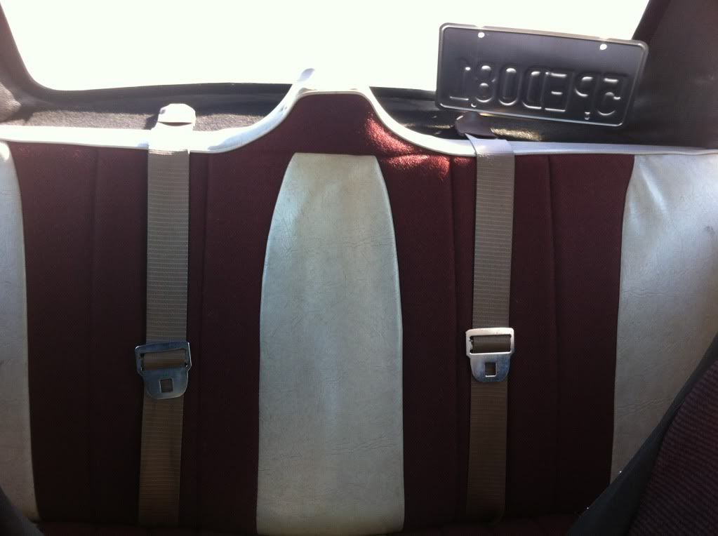

In regards to info on the seats i'm from aus n i havnt seen that fabric before but i'm going to a show tomorrow n will keep an eye out, i have a colour chart on my computer somewhere
#11 buddylove
buddylove
  • 1,640 posts
  • Location: North America
  • Local Club: SAMOA
Posted 11 December 2011 - 05:37 AM

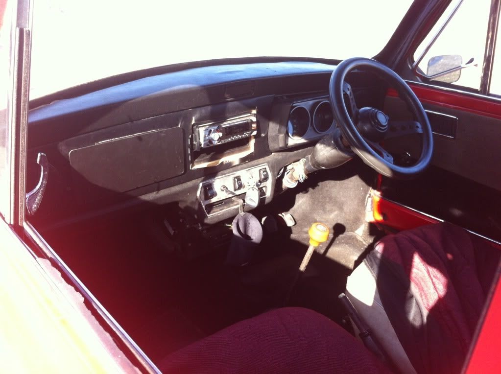

Awesome, thanks! If you know anyone with interior shots of the same year Mini, specially the dash area. I would be immensely thankfull! Mini has been messed with a good amount and I would like to return it to a factory setup for the dash area.
#12 123grosso
123grosso
  • 36 posts
  • Location: Victoria
Posted 11 December 2011 - 12:00 PM
I asked a few guys at the show and they said they havnt seen that style

Thanks for the link. The dash photos helped answer a couple things that weren't making sense. Do you know how the chokes were setup? Mini is to the left of the steering column, under the dash.

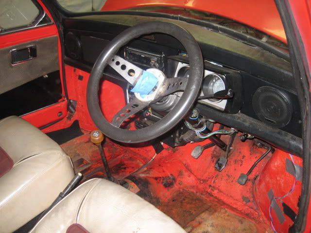

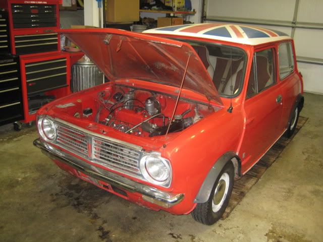

Update from today:
Lots of electrical tear out. Chuck was busy all weekend chasing the starting issues on it. He rebuilt the carb and setup a new plate for the new throttle cable. He also replaced the steering column rod and steering column, with a MK2 unit, as mine was destroyed. He had a whole list of stuff he checked over. At the end he said he couldn't stop because my car was being "frustrating." ha ha I really do appreciate all the time and effort he put into it, I wasn't expecting it!
So, today... Chuck got to catch up on his errands and dog walking while I chased wires.

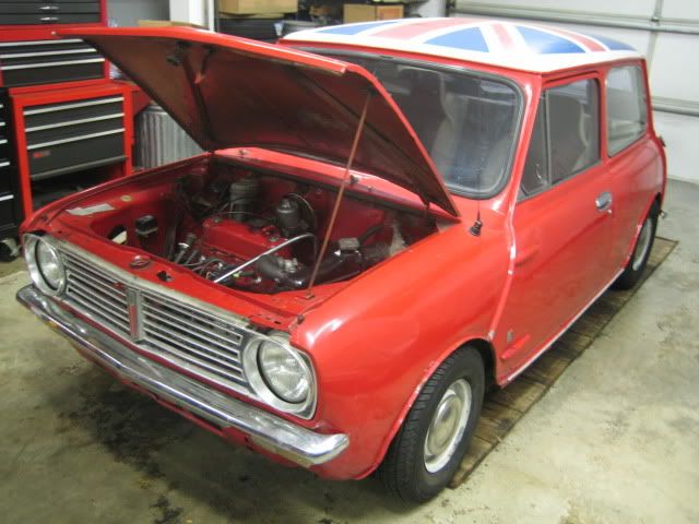

The new steering column and rod, you can also see the old dash in it:

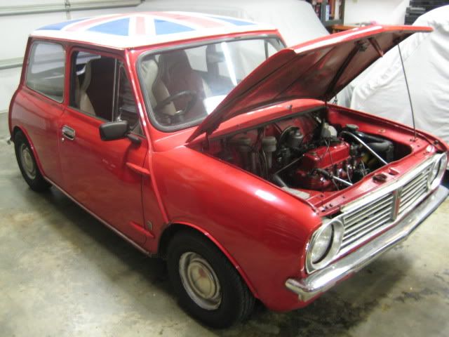

The clubby with flairs still on it:

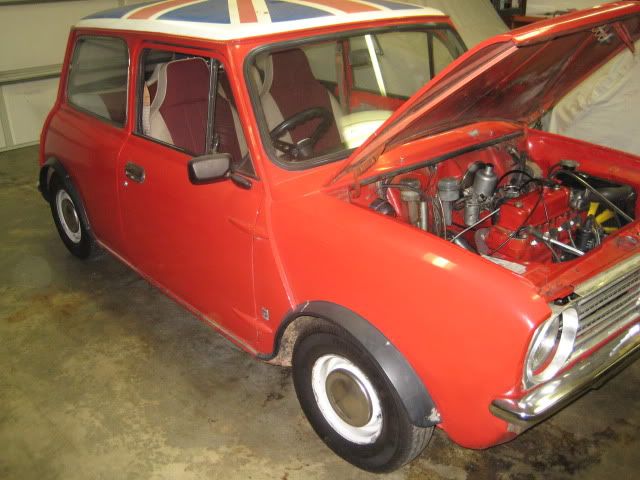

Minus flairs:

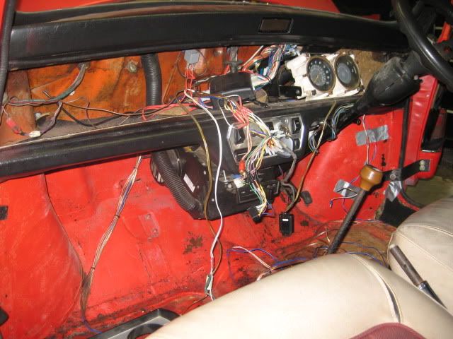

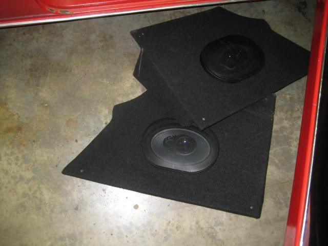

Removing the rear speaker setup and hunting wires:

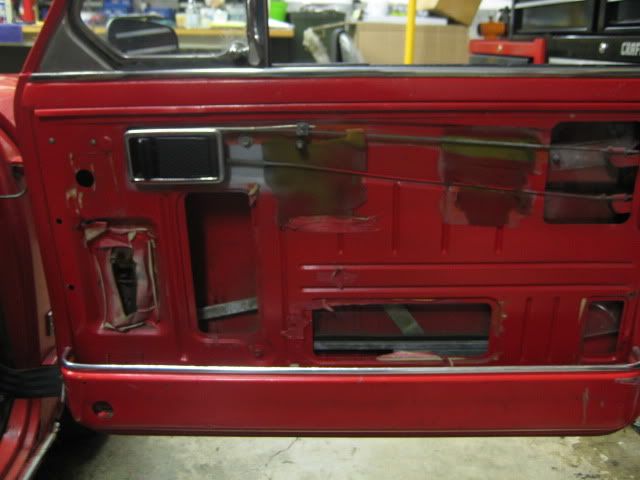

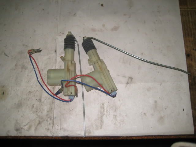

Removing the keyless door entry system:
How the dash is now... not looking forward to trying to sort out that mess. A combo of alarm and speaker wiring.
Chuck had the Mini running when I showed up today, it sounded horrible with the current exhaust. He also said that he had re-timed the car, as it was way too far advanced. Replaced the needle and seat in the fuel pot, and completely rebuilt the carb. He took a cold compression test of the motor, and I am hoping that it does better with a warm compression test.

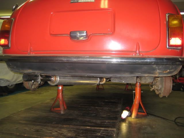

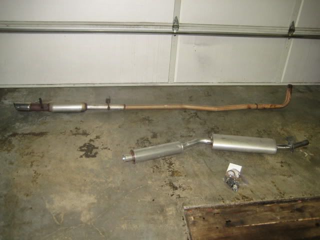

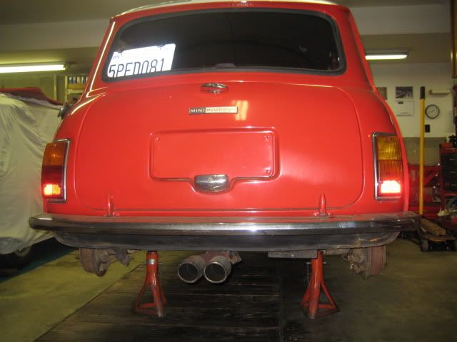

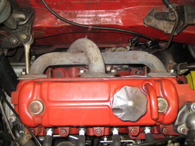

So, today we started by trying to find a carb inlet manifold that would line up with the head properly. The current one didn't have any slots to help it line up using the studs and it wasn't designed to fit with collars. Chuck's magic shelves came to the rescue and we found a good candidate. The butterfly and shaft in the carb have too much play and is a air leak, so it's getting sent off to Mini Mania for repair. We were going to replace the CV boot on the right side of the car, but upon starting up the tear down. We noticed that the adjusters on the backing plate were completely destroyed. Previous owners / shops most likely used vice grips to adjust them. After some struggle, we got the drum off and found both brake cylinders to be shot. I am guessing that the other side is shot as well. So, the decision now is whether to put money into these brakes or wait and save up to get front discs. I am leaning towards the latter.
Some pics of the work today. Installed the RC40 two box system and Janspeed LCB from my old Mini.
Old Exhaust:
New exhaust and header:
