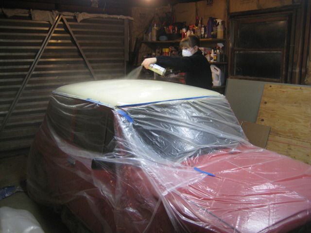

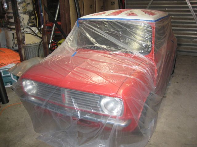

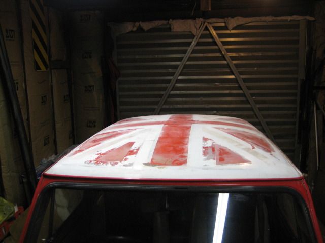

01/14/12
Fought with the fuel system for another hour again today. I might just give up and get a proper Mini mechanical fuel pump... We have no idea where the fuel pump on it came from. I have been wanting to fix some rust on the roof, so Lis and I tackled it tonight. We sanded down the roof and removed as much of the flaking as we could. It isn't the best paint job, but for $8 in paint and some sanding its not bad. We got a little reaction in the paint, but it will hold over till we strip it all off down the road and repaint it. I also found tons of dents in the roof, another body item to tackle down the road.
Sanded:
Wrapped:
Lis doing some painting:
Left to dry. The flag is still partially visible, but its still a night and day difference.

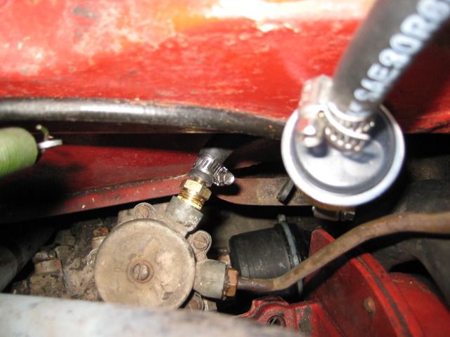

I went to Mclendons earlier to see if they could help me out with another fitting for the fuel pump. I had gone to Autozone the other day and they found a fitting, but it had a 5/16" inlet. I didn't like having to run such a big fuel hose, and for some reason the fitting just wasn't fitting right. The guy at Mclendons found a fitting for me with a 1/4" inlet and recommended a sealant for the threads that could tolerate fuel. I plumbed a fuel filter in the middle off of the short soft line from the hardline in the rear and ran 2' of fuel line after the fuel filter to wrap it down into the fuel pump. After the line filled back up with fuel it fired right up and I didn't see any leaks. I let it sit for a bit and still didn't see any leaks. Time will tell if it will leak anymore or not, but I am hoping that this fix will last me a good while till I eventually get a actual Mini pump. The fuel filter is plastic and I have it a good ways away from the down pipe, but I am still a little worried that it will melt.
The offending connection:
How the fuel system is plumbed now:

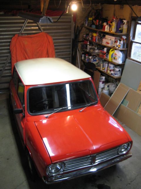

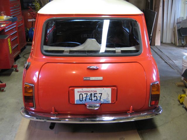

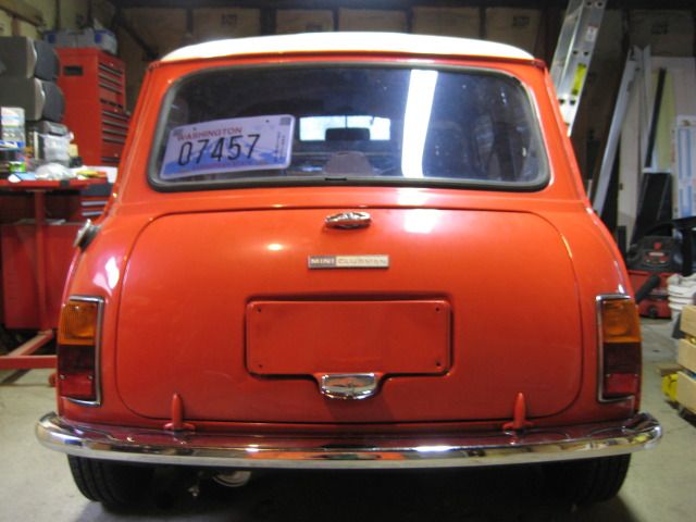

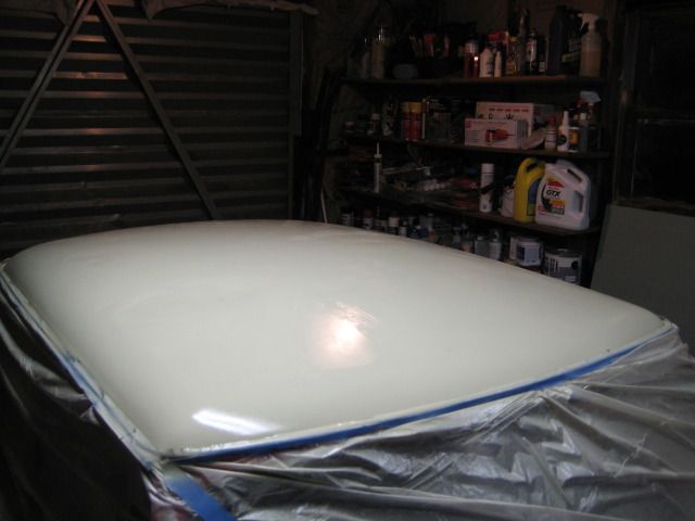

Over the last couple of days, I have done some small things. I put new taillight lens on, along with new seals. I also claybarred the front end and did a quick job of putting some wax on the front to see if it would shine up.
Yesterday, I drove it out to the White Elephant SAMOA Mini Event. It ran the best so far on the way up and on the way back, but I definitely need to get rid of those gaps in the door and the hole in the tunnel. There was a ton of cold air circulating throughout the cabin. Lis also got her first ride in it, and enjoyed it... Other then the quick pace I was going at on the freeway sometimes. I knew the Mini was low, but didn't realize how low it was till yesterday. The exhaust is only a few inches off of the ground and even though I was being careful it hit the pavement a few times. The seat is going to limit my driving of it, till I fix the diaphram or replace the seat, as it makes driving the Mini rather uncomfortable.

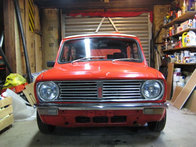

Today, I tried to clean up the aluminum / chrome on the car with some aluminum/mag polish. It brightened it up a bit, but definitely highlighted how scratched up / banged up the bumpers are. I also took the rear license plate light apart and cleaned it up, one of the bulbs is burned out. I am going to have to take it apart and again check for power, as it currently isn't lighting up.
Shined up bright work and front end paint.
Current shot of the roof, it appears more white in the photo, but the lighting is bad. It is a lot more beige.

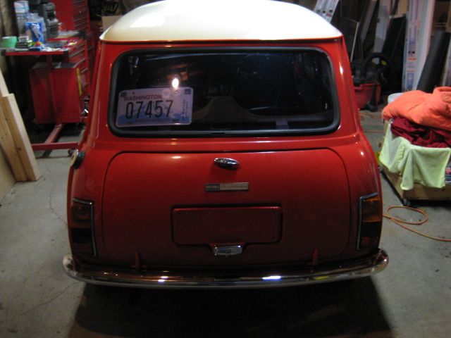

Nothing too exciting for tonight. When I think of 1974, I think of a mk3 Mini. I keep forgetting that this Mini has a lot of mk1 elements in it. I bought a mk3 bulkhead pad, but I would have been better off with a mk1 bulkhead pad. I cut the pad to work with the wiper motor, but I should probably do some modifying on the opposite side as well. I also gorilla taped up the lhd side for the brake and clutch master cylinders.
I also did some testing on the license plate light. It is getting power, I am just not sure why the light bulb is not lighting up.

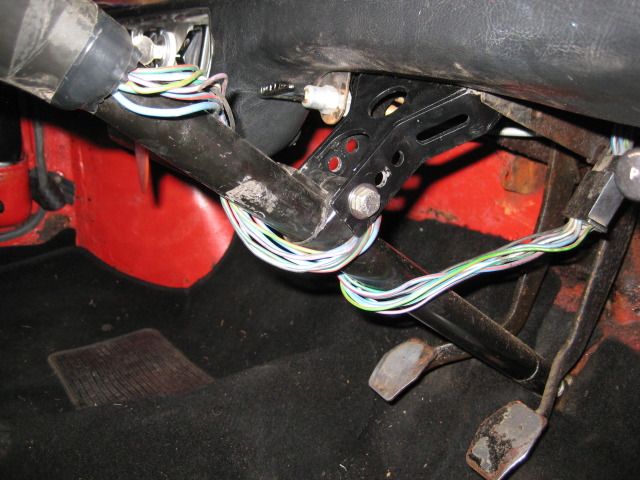

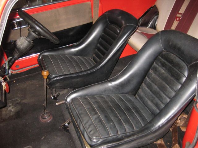

Finally made a bit more progress on the Mini. I got the Japanese style extender column steering bracket for my old Mini last year and didn't end up using it. It extends the column down a max of 3 inches. I tried installing it yesterday and it ended up being too narrow to go around the column clamp. After talking to a good friend, he came up with a easy way to widen it out a bit, which worked like a charm.
Old steering column clamp setup:
Japanese style steering column extender bracket:
I also put in the passenger seat today. With how low the seats sit right now, the steering column drop is perfect. Eventually I am going to get new seat brackets and raise them up. The seats came from Chuck's magic shelves (thanks again, Chuck!).

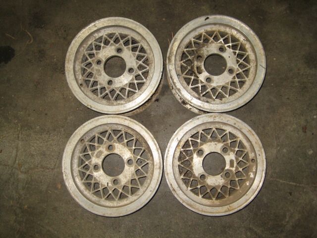

Last week, Chris (CLM) from Oregon was coming up to pick up some parts and brought along some wheels I wanted to purchase from him. They are E-T Crosswire Wheels 10x4.5. A future refurbishment will be in order. Thanks to Chris (Rabbit16v) for dismounting the tires for me today.

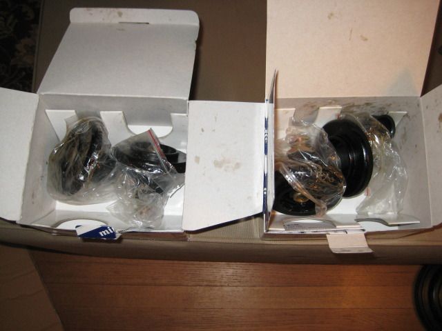

2/23/2012
I promised myself that after I drove the Mini last, I wouldn't drive it again till I had replaced the suspension.  I know its taboo to say this, but it really is too low.  I was super careful on my last drive and I still smacked the exhaust 3 or 4 times.  It just doesn't create a enjoyable driving experience, and I am more into performance with this car then looking good.
Placed an order earlier today to replace a lot of the suspension components on the Mini.
Minispares Order:
GSD415
SPEEDO CABLE 48" 'CLUBMAN DASH' 76-90
SZU10001
PEDAL RUBBER LATEST TYPE
JPC2017
WINDSCREEN FILLET CHROME FINISHER JOINING CLIP
CGA2835MS
DOOR SURROUND SEAL MK3 WITH WIND UP WINDOWS TO 1996
MSSK3006
SUSPENSION PACK OF HILOS AND LOWERED SPAX MINISPARES DAMPERS
GPR104
PEDAL RUBBER CLUTCH and BRAKE +POST 76 ACCELERATOR PEDAL
MSSK3008
CAMBER TRACKING KIT OF 21A1091 AND C-AJJ3360 WITH BUSHES
Mini Sport Order:
FAM3968C              Competition Uprated Rubber
                       Suspension Cone
Minispares was out of the rubber cones that I wanted so unfortunately I had to order it from Mini Sport.  I had to eat an additional shipping charge for that one.  On the upside, ordering it from them saves me a ton of money as the US Mini sites want about 4 times as much for a lot of these parts.
I am not sure if we have talked about this before, but an explanation of the suspension components is probably in order.   The Rubber Suspension Cone is in effect the spring for the suspension.  It sits up inside the subframe and then the HiLo sits below it.  The HiLo can be compared to a sleaved coilover or even just a coilover.  It lets you raise and lower the car, in comparison to just the standard trumpet that is in there.  For the time period it was a very progressive design when all you saw back then was leaf spring setups.

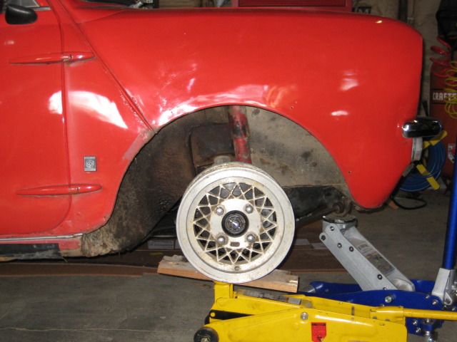

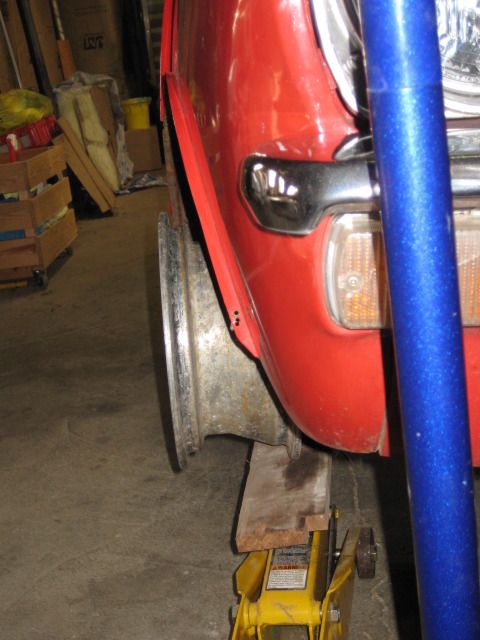

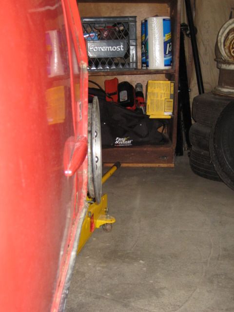

I washed the new to me wheels yesterday and test fitted one of them today.  I am pretty sure the wheels are drum fitment as there is a slight bit of poke.

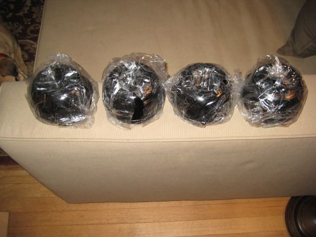

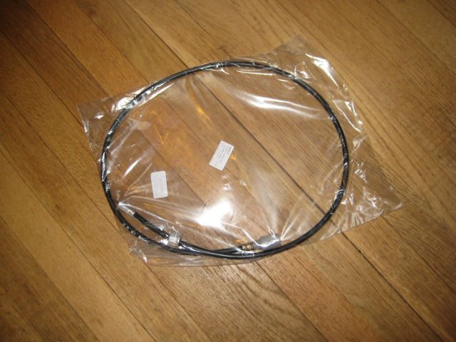

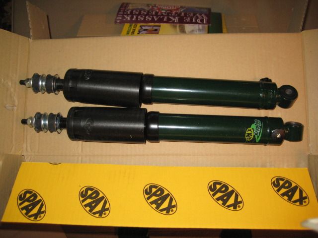

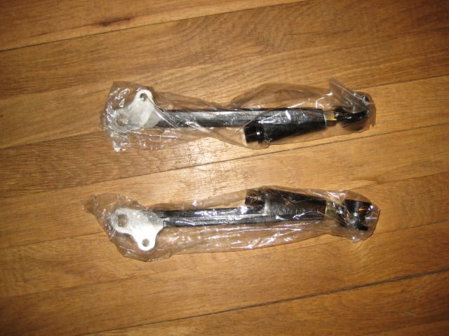

Received packages from UPS and DHL today:

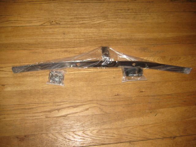

Works style light bar
Road/Race Competion Rubber Cones
Mk3 Door Seals
Speedo cable with slip on fitting
Adjustable lower arms

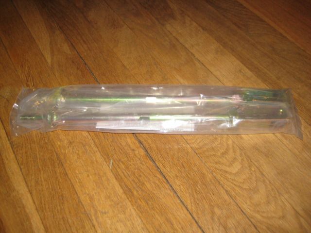

Heavy Duty Tie Rods

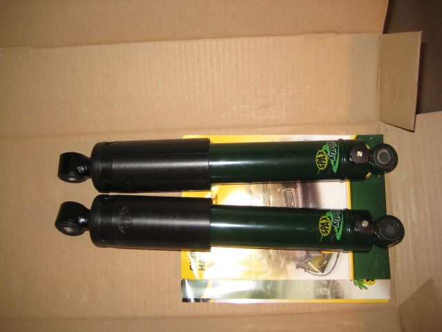

Front and Rear Lowered Spax Shocks
Genuine HiLo's, bars for the rears not pictured
I also have bushings for the tie rods and lower arms that aren't pictured, as well as new clutch and brake pedal covers.

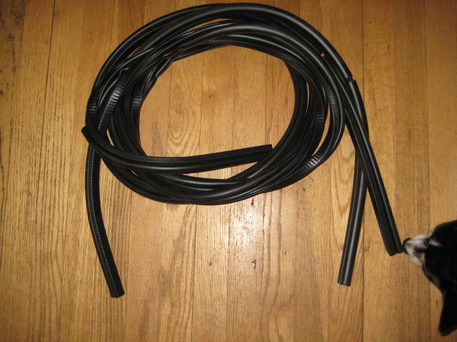

I installed the mk3 door seals, and they went on so much easier then the mk1 door seals that I tried first.  It also is creating a better seal around the door, though the passenger door is slightly bent out at the top causing it to not seal fully.  I am looking forward to driving the car with the new pedal covers on, as I won't be slipping off the pedals anymore.  The suspension won't be going on this weekend, but hopefully next weekend.  I am also still on the hunt for lights for the light bar, I have lost a couple of auctions by a $1 so far.
