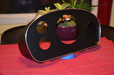

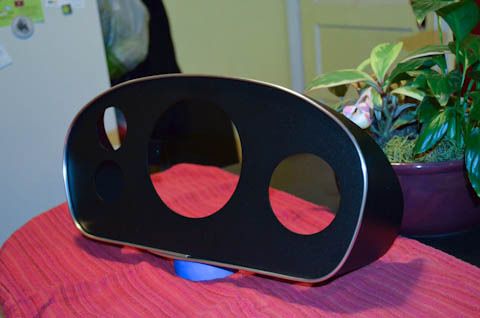

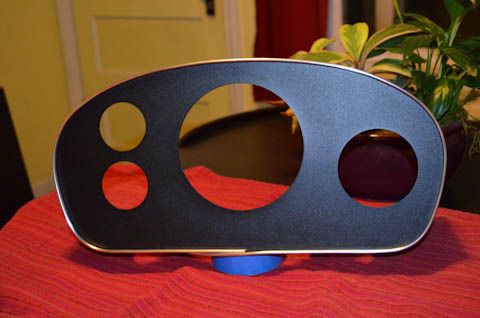

12/22/2012
My new dash setup arrived from France.  It's a Dulles Dash repro. Still need to order a center speedo binnacle for it to mount onto, and a 80mm tach.
#64 buddylove
buddylove
  • 1,640 posts
  • Location: North America
  • Local Club: SAMOA
Posted 10 November 2013 - 06:11 AM
Photos of the original dash setup, the repro isn't quite the same, but it's still close enough.

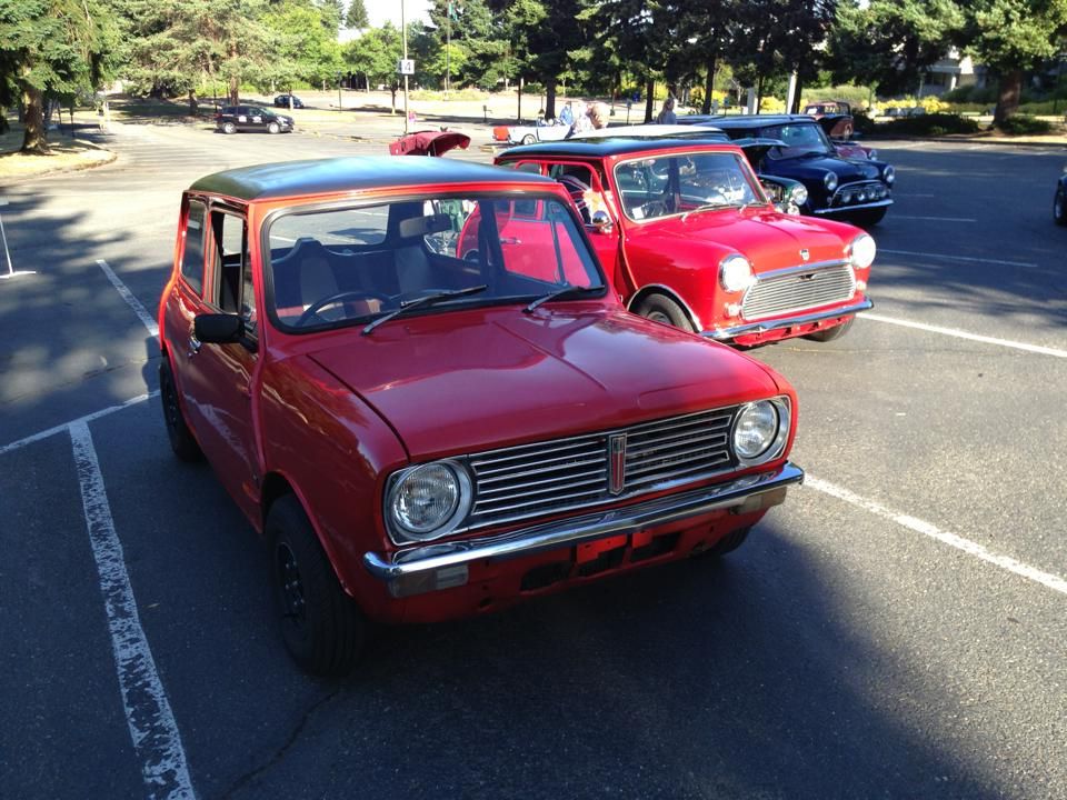

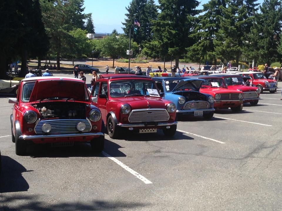

07/28/2013
I guess they didn't change park lots, from what I hear.  They only change some of the locations of where the car marques were stationed.
Lis took the Mini out to the Western Washington ABFM held at Bellevue College yesterday.  She said it was a good time and that she confused a good many people with telling them that it wasn't a "Cooper".
1014172_10102222955261738_423898982_n.jp
1002555_10201651885927063_166064456_n.jp
Who's the odd duckling?
