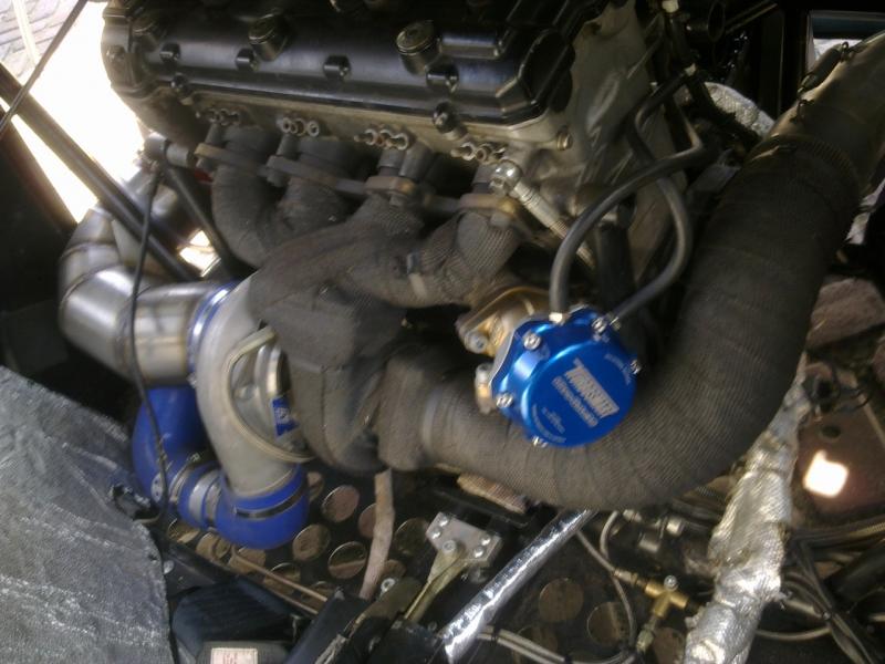

hmm looks good and steady, are you going to give it this special spray coating, which increases the temp sealing function and should make sure that it doesn't fall off to quick?
I did and the first 30 miles i thought my car was burning, so much smoke came into the cabin. it's like black spray and my dealer told me to use it for sure in order to keep it ok for longer as one year...
it will look like this afterwards, but I can't tell you if it really makes it last longer...I cán tell you that the wrapping which was on the headers when i bought the car was 300 miles old and it fell apart like burned paper!

Yep, already did it.

I don't know if I would trust normal fiberglass header wrap on a turbo exhaust side housing. Typical wraps are only rated to between 1000 degF and 1200 degF - uncoated turbine housings can easily get higher than 1200 degF. No problem with the headers being wrapped, just the turbine housing itself. Why not use a blanket that is rated for turbine housing temps?

I guess it because I don't know what I'm doing. I've never worked with a turbo before. Looking at Johanmini's wrap, and talking with my local speed shop, they said this is what to use. So I assumed they knew what they were talking about.

depends on what you're using, I used a special brand which is secured untill 1400 degrees celcius, should be sufficient. There are those "socks" for the turbo, but it wasn't available at the moment I needed it ánd it was quite expensive and the dealer told me to use this wrap because of the extremely high temp range. The wrap was some bits more expensive, but ok.

Looking at this picture I see you're wastegate, hope it's (very) high temp, mine melted within 200miles (the diaphragm), when I wanted to take the serpent of in order to test the gate, it fell in 5 parts, was as hard as a rock...so when you're experiencing boost which isn't controlable through your boostcontroller anymore all of a sudden, the gate or the serpent is leaking. maybe you should also ad a special heatreflecting hose around the serpent in order to prevent this sort of problems, it's so close to the turbo and wastegate at your setup.

I used a 2000 degree wrap made by "Cool it". As far as the waste gate location, this is where the kit instructed it to be installed so I can only assume Terry at "Mr Turbo" know what he is doing.

jep that's the one i used also! I thought it was even warmer, but ok, 2000 fahrenheit should be ok, mine's still ok after 300 miles now. The serpant...damn google translate, I don't know the word, the air tube which goes onto the waste gate and probably one to go out of it back to the actuater. The hose? choose your word...

OK. There's only the waste gate which bolts onto the pipe from the exhaust. And a rubber hose going out to the intake. I can see where the hose could easily get hot and melt.

be careful though...the 2000F rating on the Thermotec (Cool It) is a 30 second rating.

I'll just have to give it a try and see how it does. If it burns off I'll just have to get some K-Wool from the refinery I used to work at. Nothing will burn that stuff.
