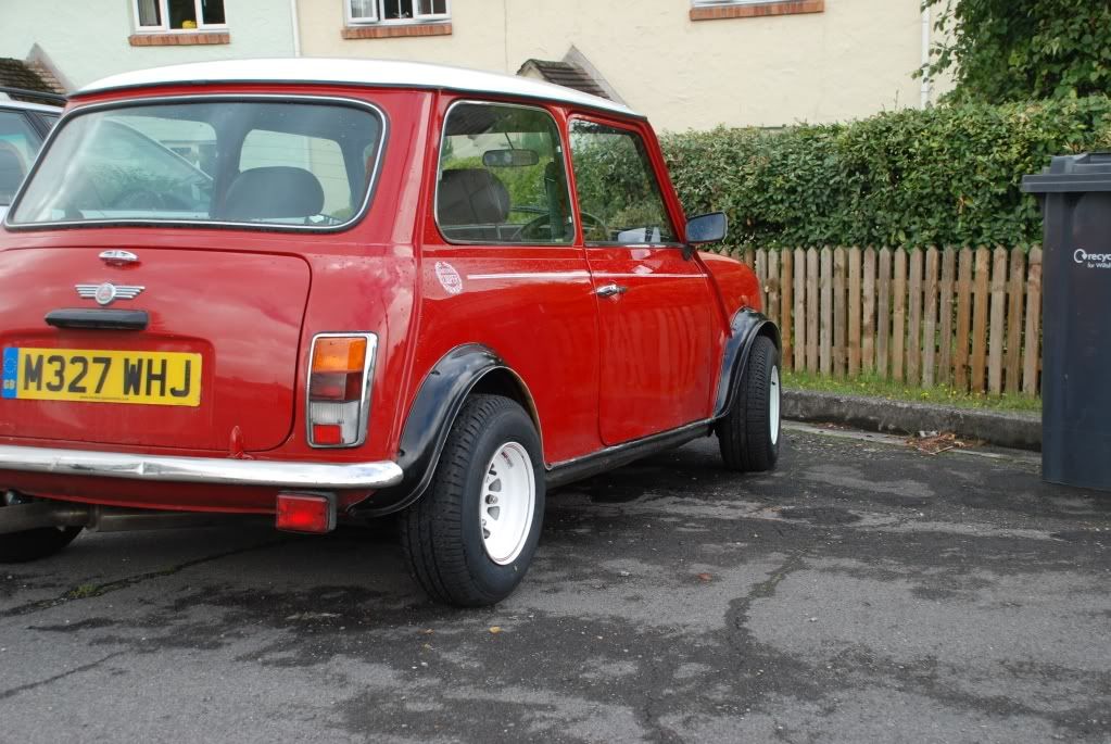

Right a little back story to fill you in, this is how i got it, bought off my dad when he got his Audi 80 wagon
It looked pretty decent, but 2 years on the road as a daily drive had taken its toll on the old girl. Turns out aftera bit of a poke around from me and then the MOT man it need new floors and a new front end. After all that I got it some nice new wheels and brakes, and this is how it was

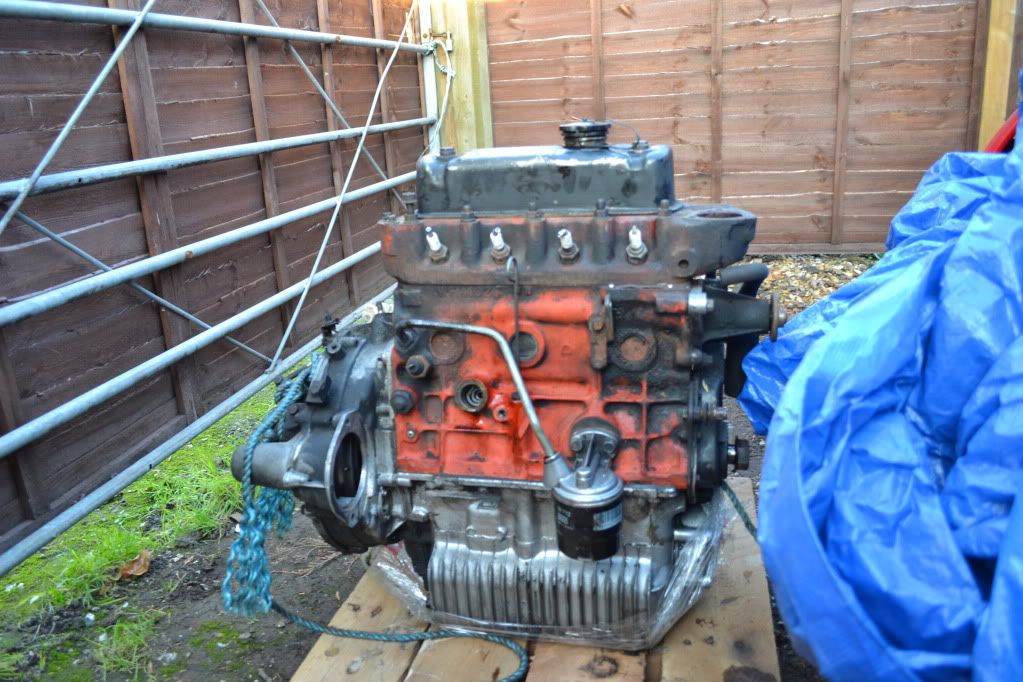

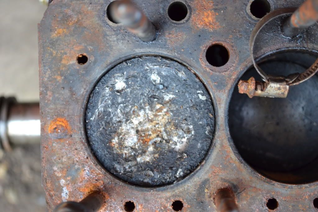

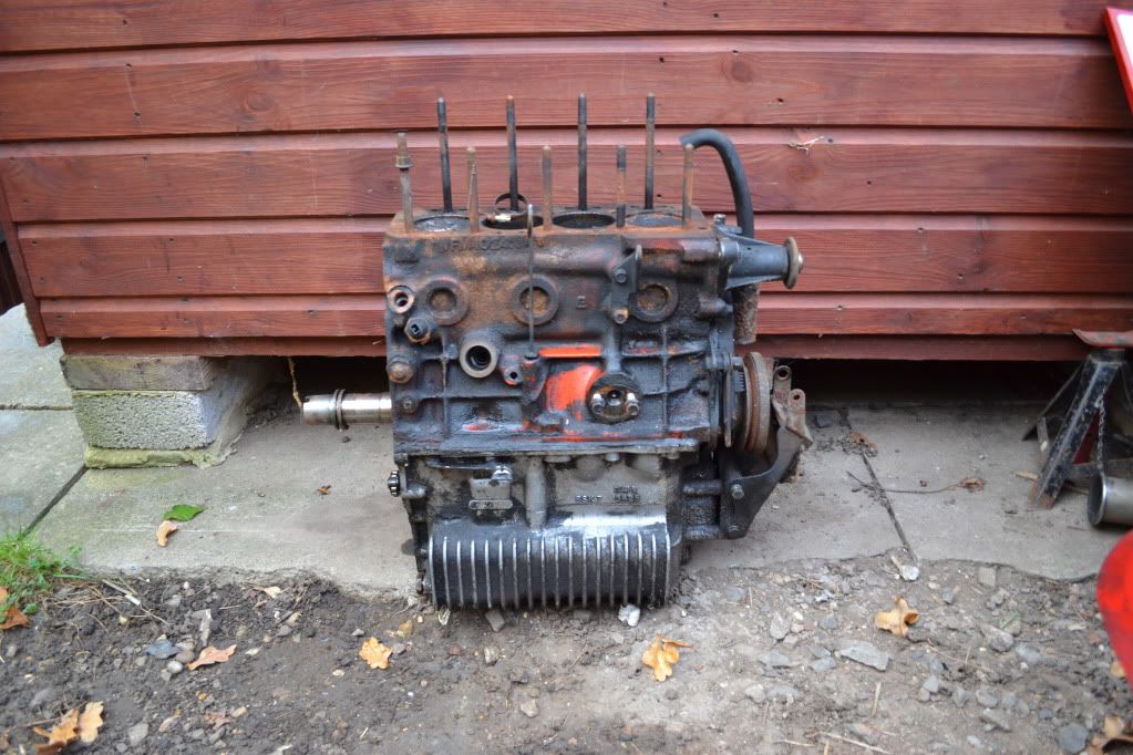

Started stripping the engine

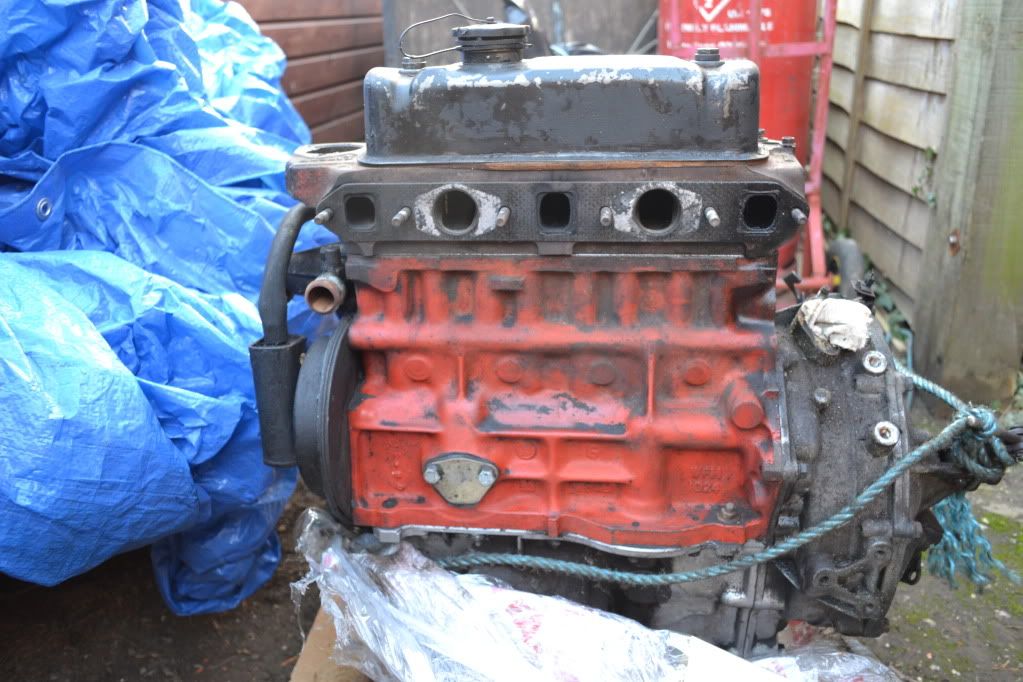

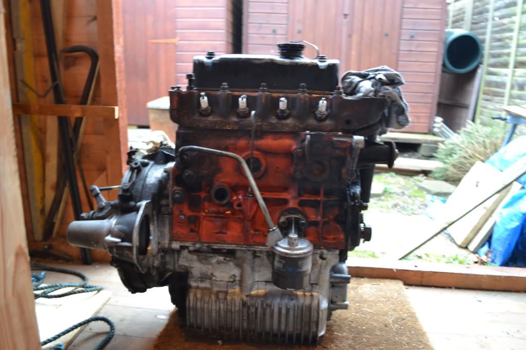

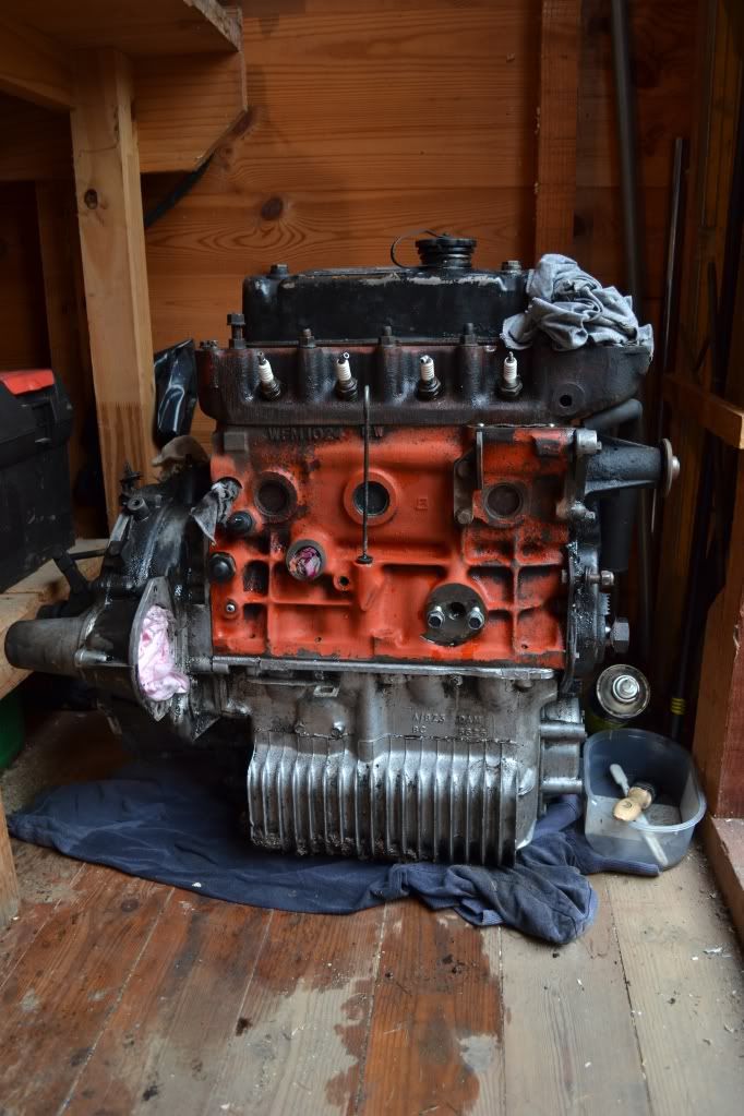

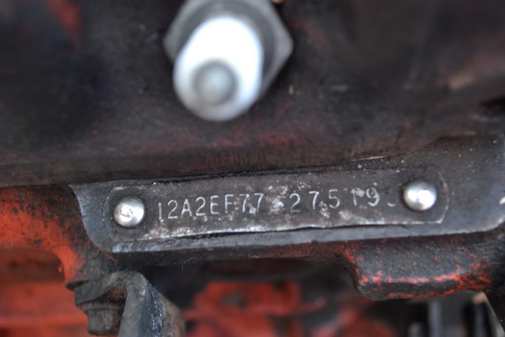

I got this far and realised that with my limited knowledge of engine building, it'd be easier to buy another unit and strip and build the fast engine out of the car, also giving me a chance for a re-bore and more time to learn about engine building rather than rushing it :)
so I bought this unit, from R1minimagic, same engine as my old one so its just a straight swap with the injection system.
So hopefully I'll be dropping this one in in the next month or so, maybe with a new cam and head if I can afford it!

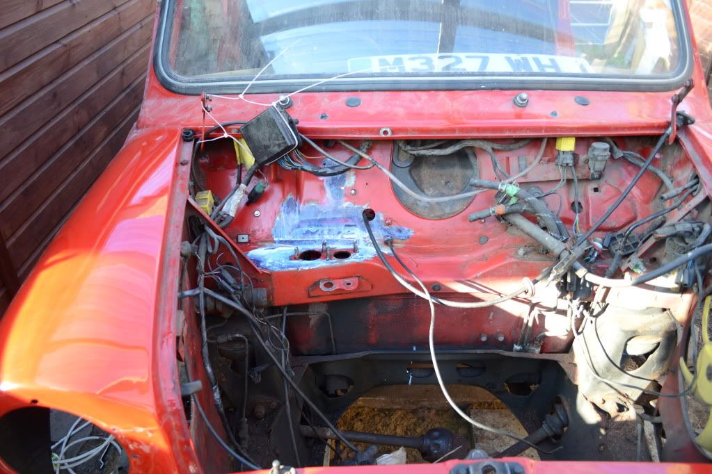

A bit of bodywork
engine bay at the moment
Want to try and "smooth" the engine bay hiding as much of the wiring as possible, and possibly mount the ECU inside the car next the the instrument panel.

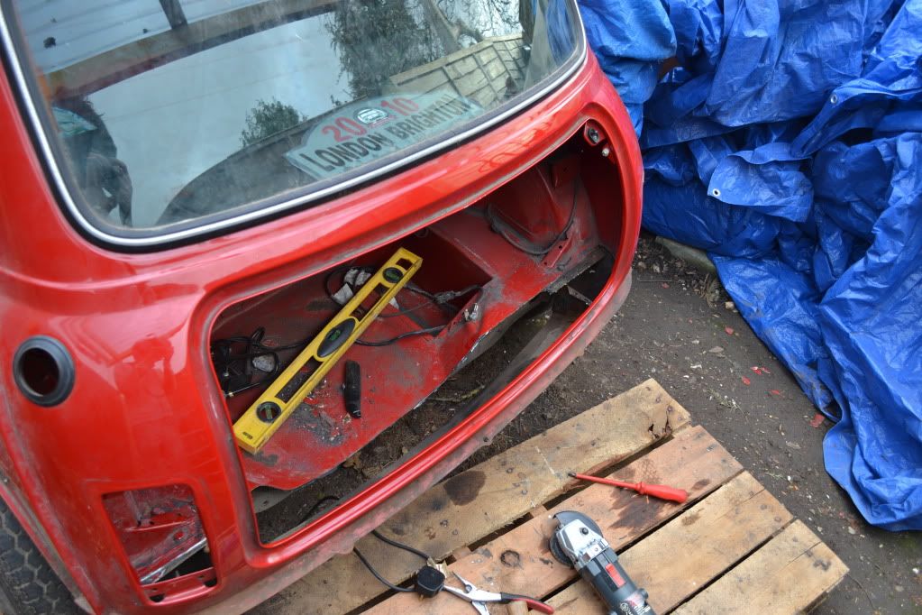

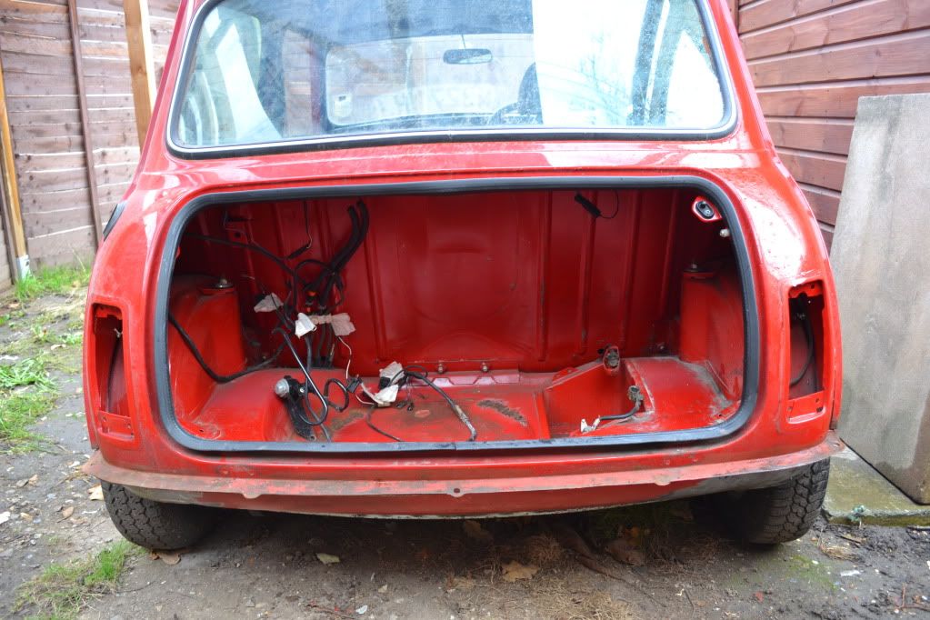

Rear end, stripped out the lights and the petrol tank,
found this...
with help from my new favorite toy

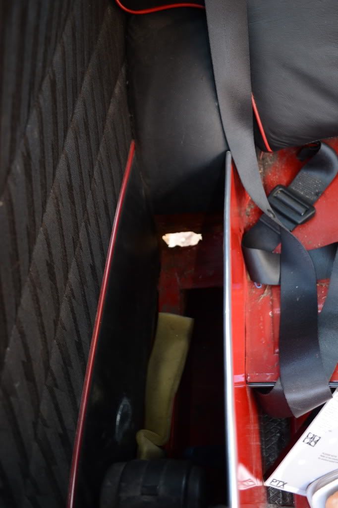

Basically the boot floor has detached itself from the rear seem all along the rear, so I have this, the first of many panels I imagine
and this on the rear valance
its the same both sides, forgot to photograph the other side, but it was worse where the fog bracket was mounted and rusted to it and rusted a huge hole in the panel.

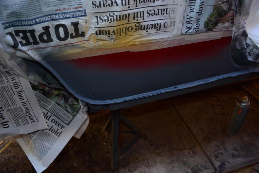

started on the doorsteps not too bad just some surface rust that needed tidying up

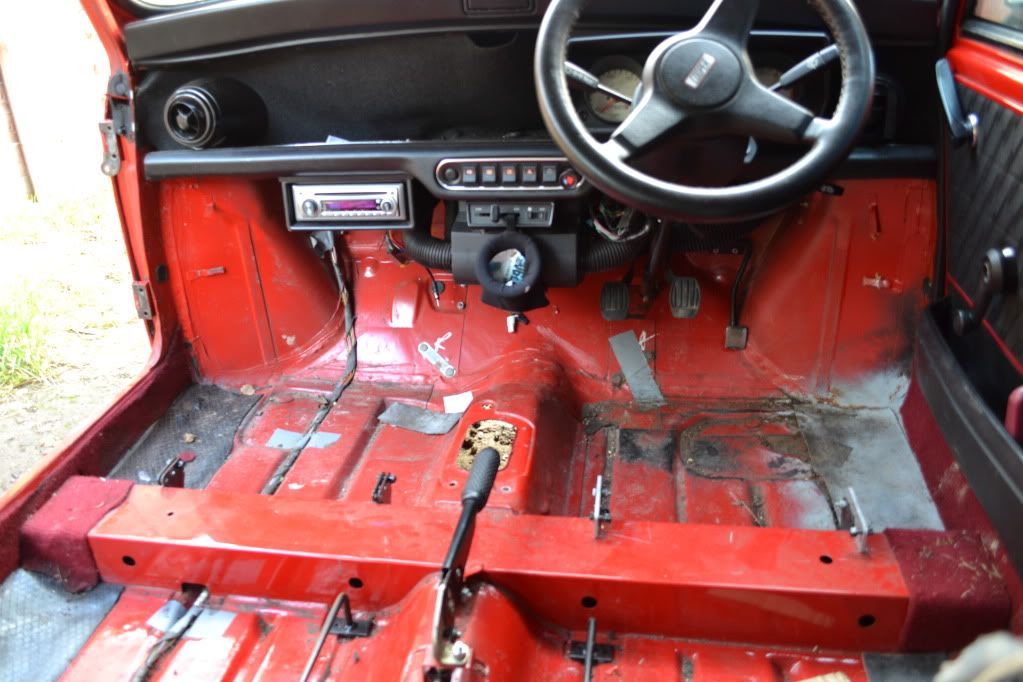

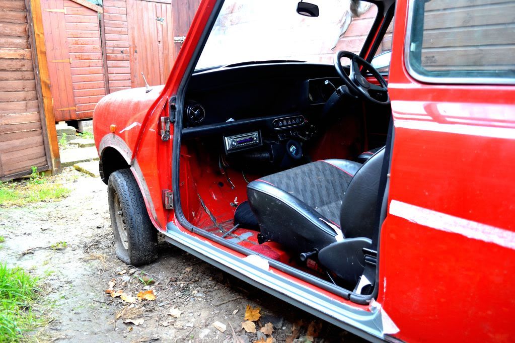

stripped out the interior as well, nothing bad in here, probably the only place!!

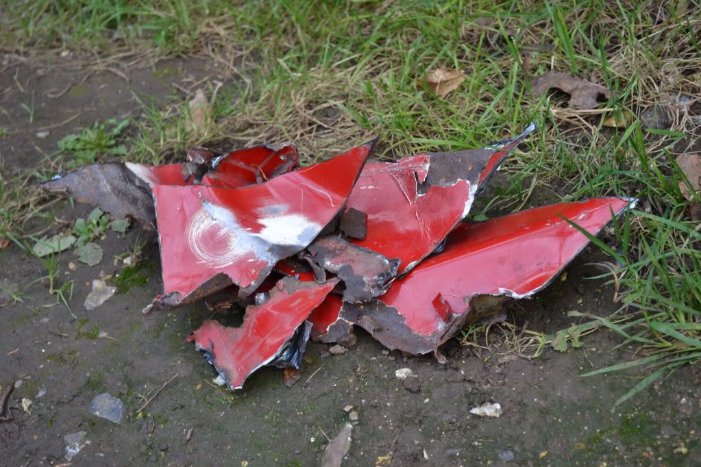

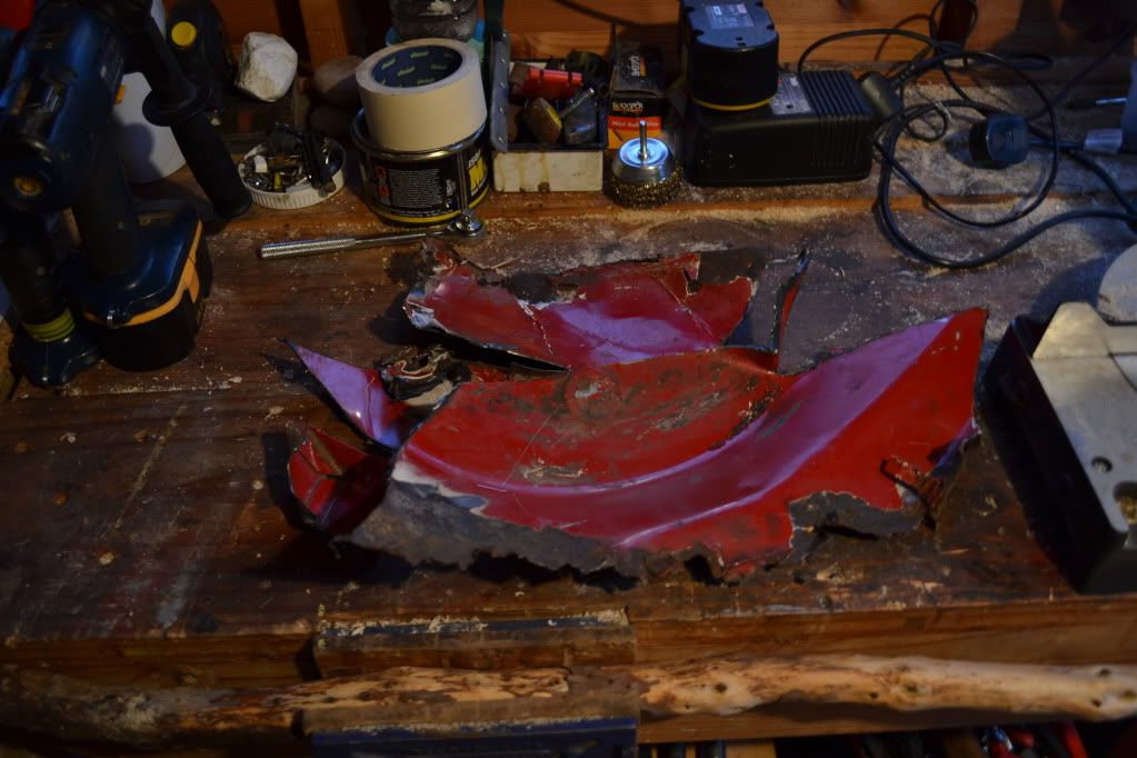

Cut out the rust in the boot
The leftovers

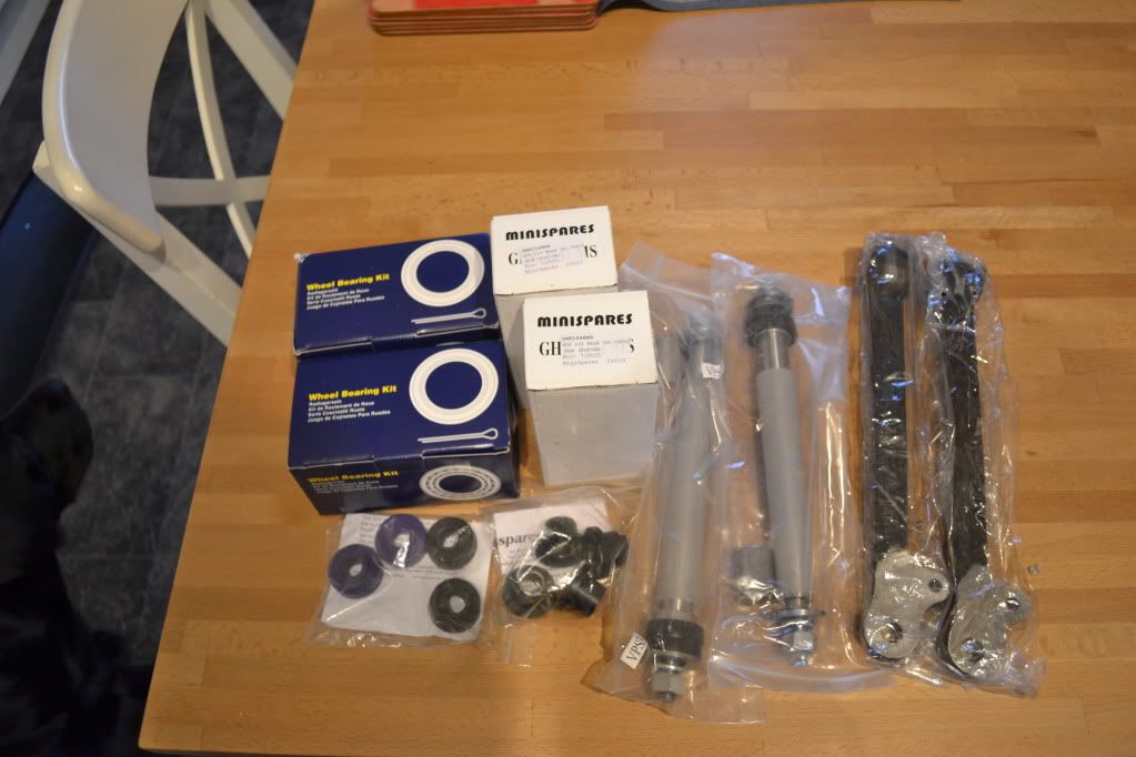

Placed an order with minspares for:
2 radius arm repair kits
full car wheel bearings
-2.0 lower arms and bushes
tie rod bushes
rear valance panel
I'll get some photos up soon of the progress, maybe tonight, who knows!! :ph34r: haha
#9 RayBoogs
RayBoogs
  • 1,109 posts
Posted 09 February 2012 - 08:51 PM
Right some pictures
got these in the post today :proud:

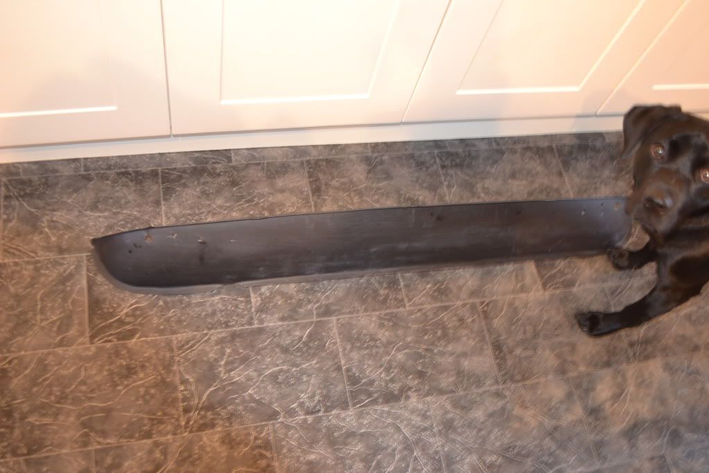

My dog being very interested in my rear valance..
Will be stripping the suspension this weekend and finding what else I need, then, hopefully it will all be going back in soon, with some hi-los and some lowered shocks :thumbsup:

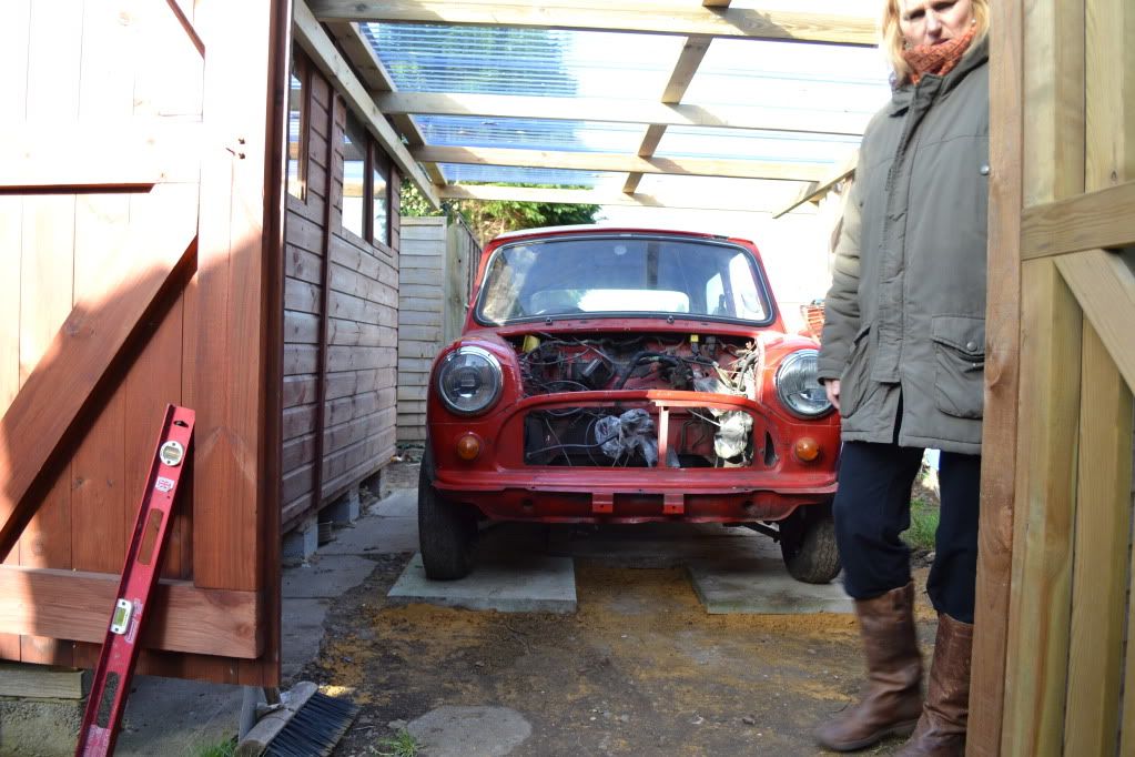

Got a good load of work done this weekend on the mini!

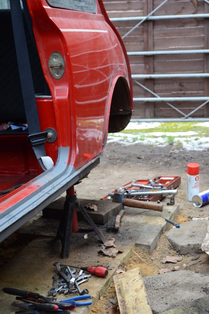

Got it onto a firm ground not just mud.

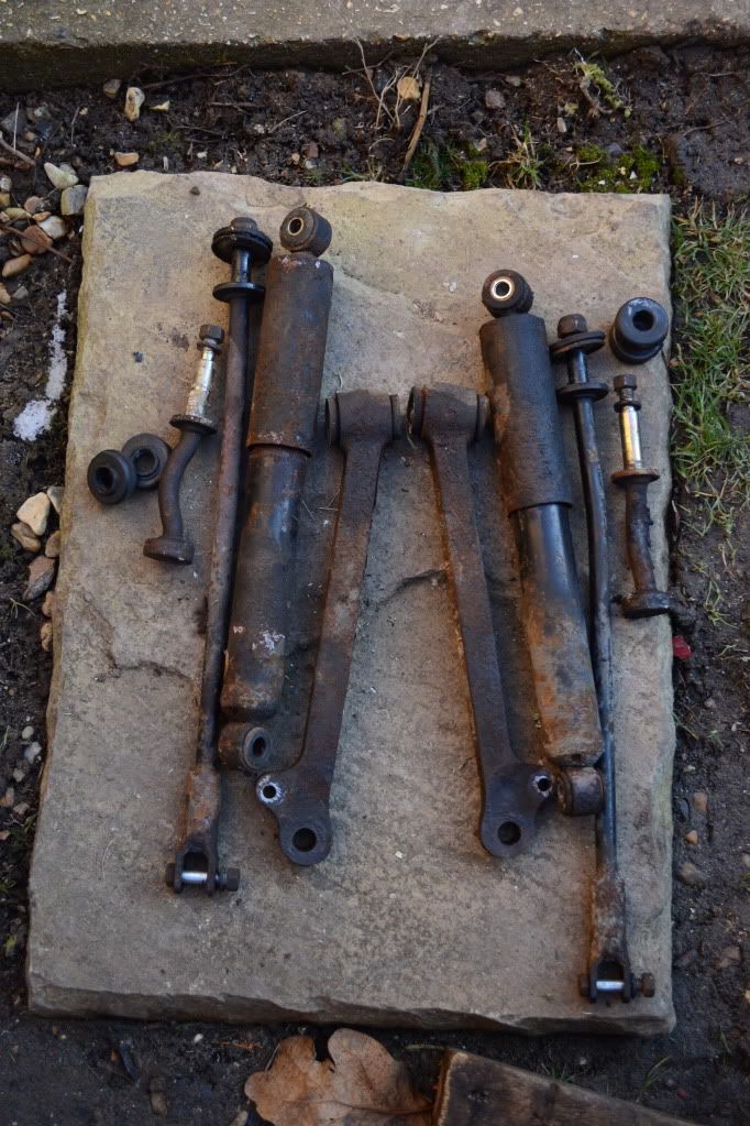

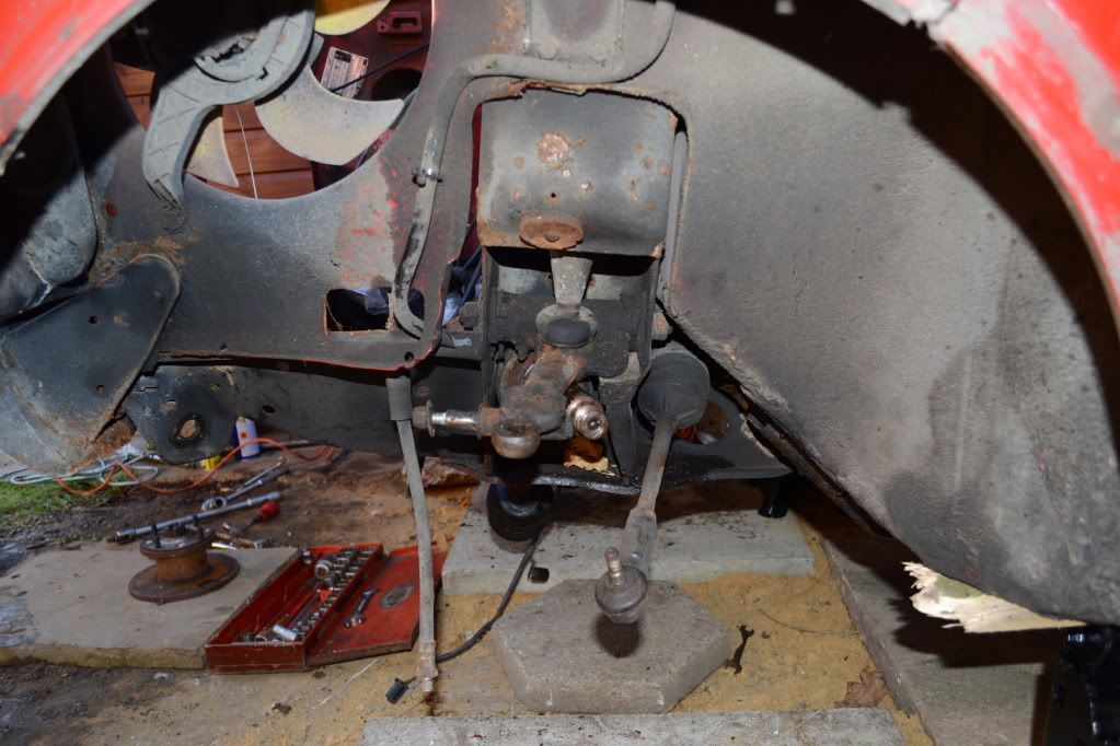

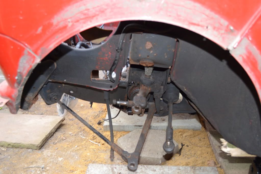

Then got the car on axle stands and started stripping the front suspension
Need a cone compressor to get the top arm and front cones out
All the old stuff!
Will be re-using the tie-rods, just tidy them up a bit!

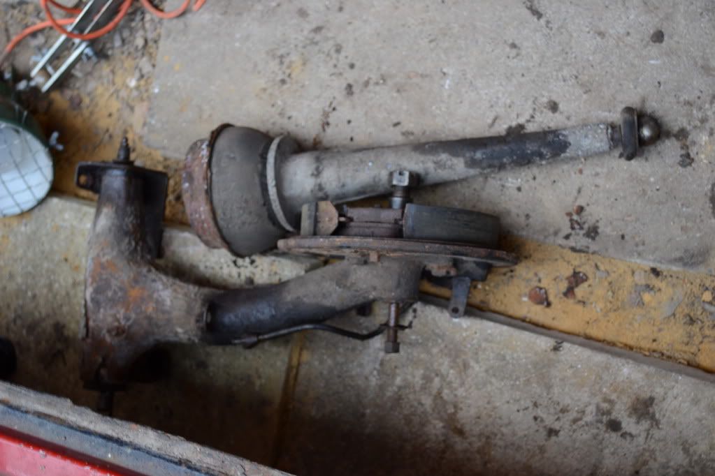

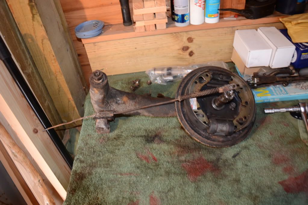

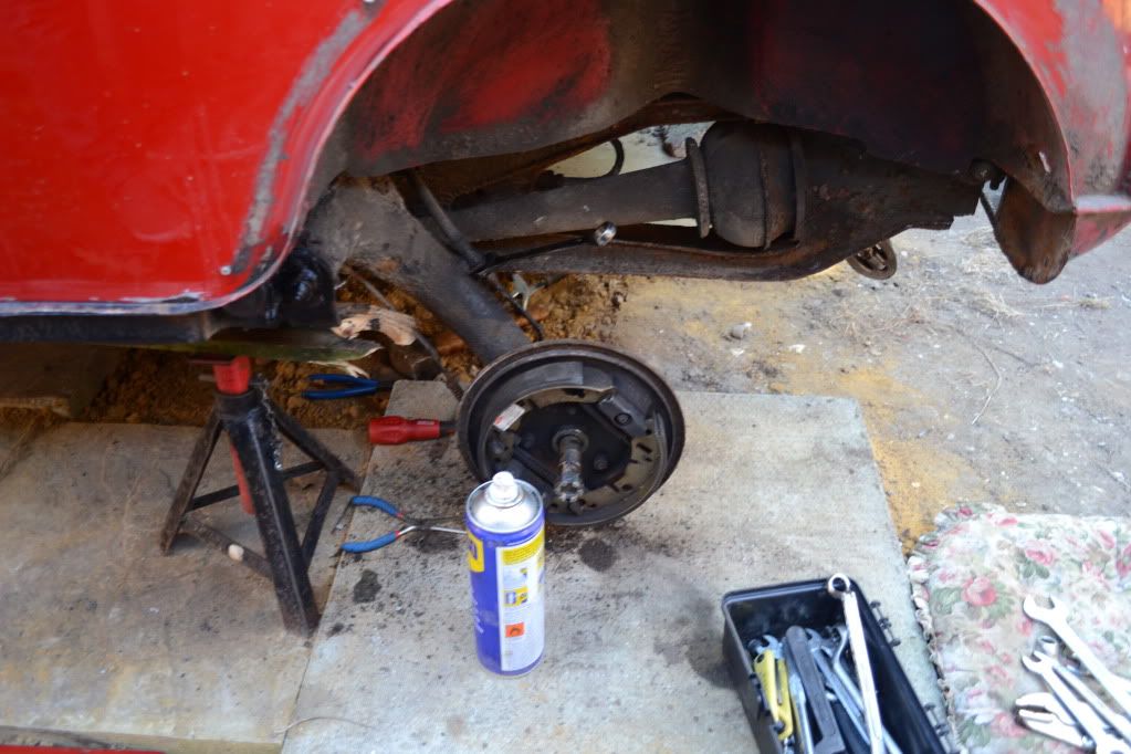

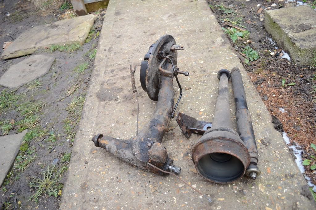

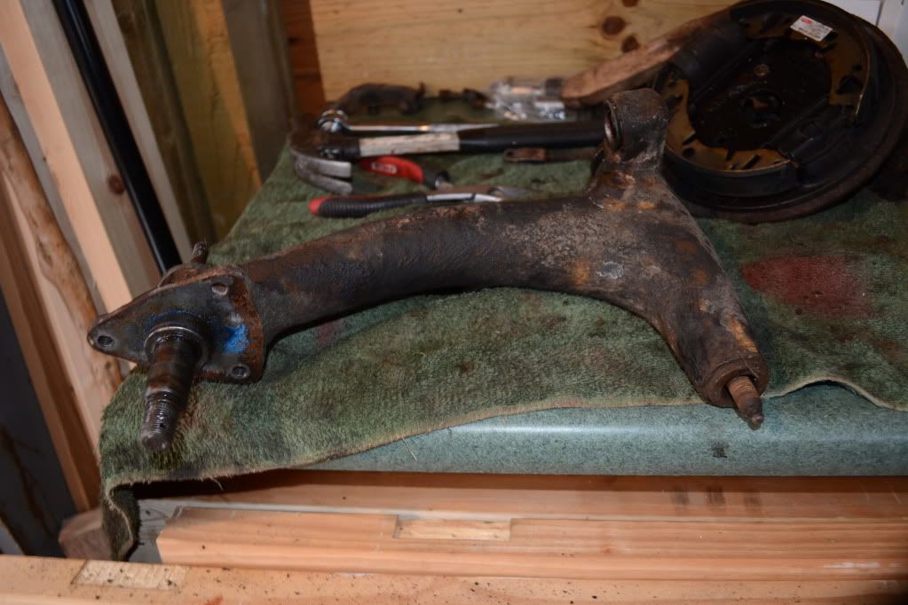

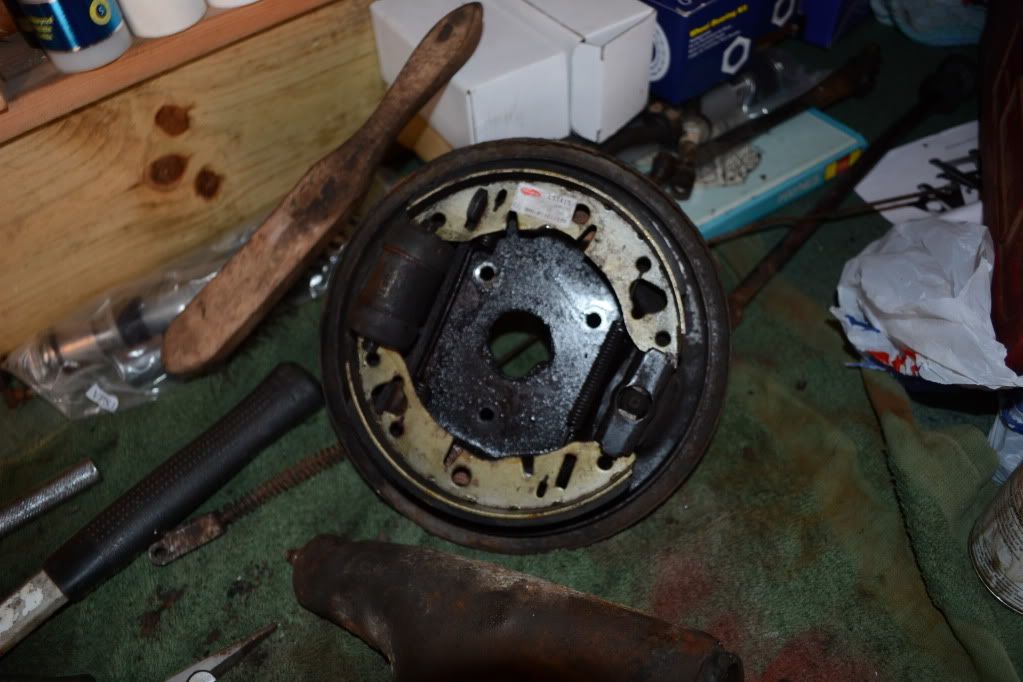

Now the rears and the radius arms...

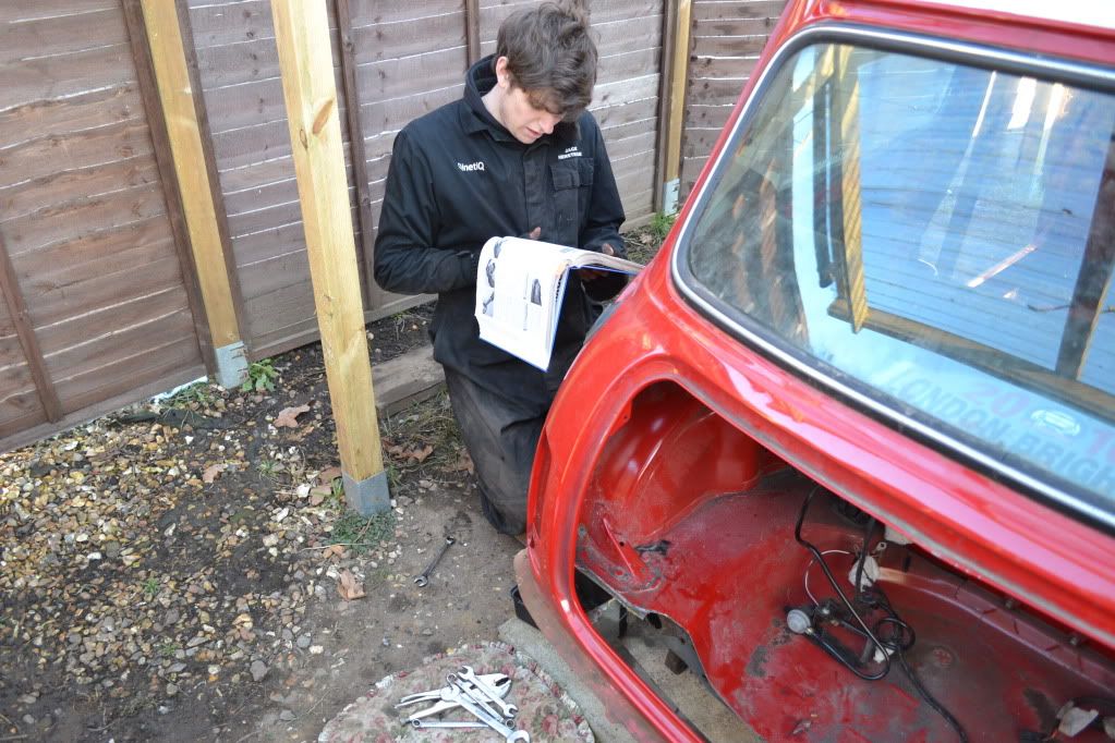

Got the shock off, then got a bit stumped and turned to the haynes manual.
All this for a radius arm... O_O

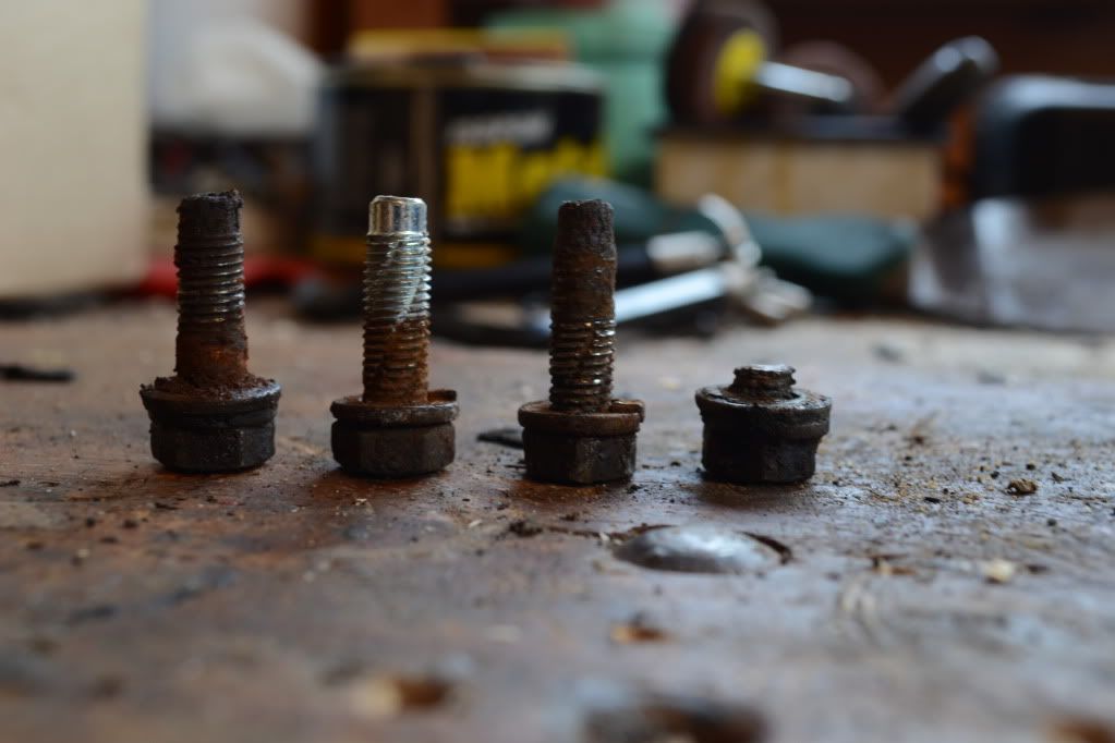

The radius arm bracket bolts have seen better days! Good old rust!
One arm ready for stripping..
And thats as far as I got, Hopefully will get the other radius arm off this week, remove the rear valance, prep for welding them on and prep for tubing the rear arches. Stay tuned!

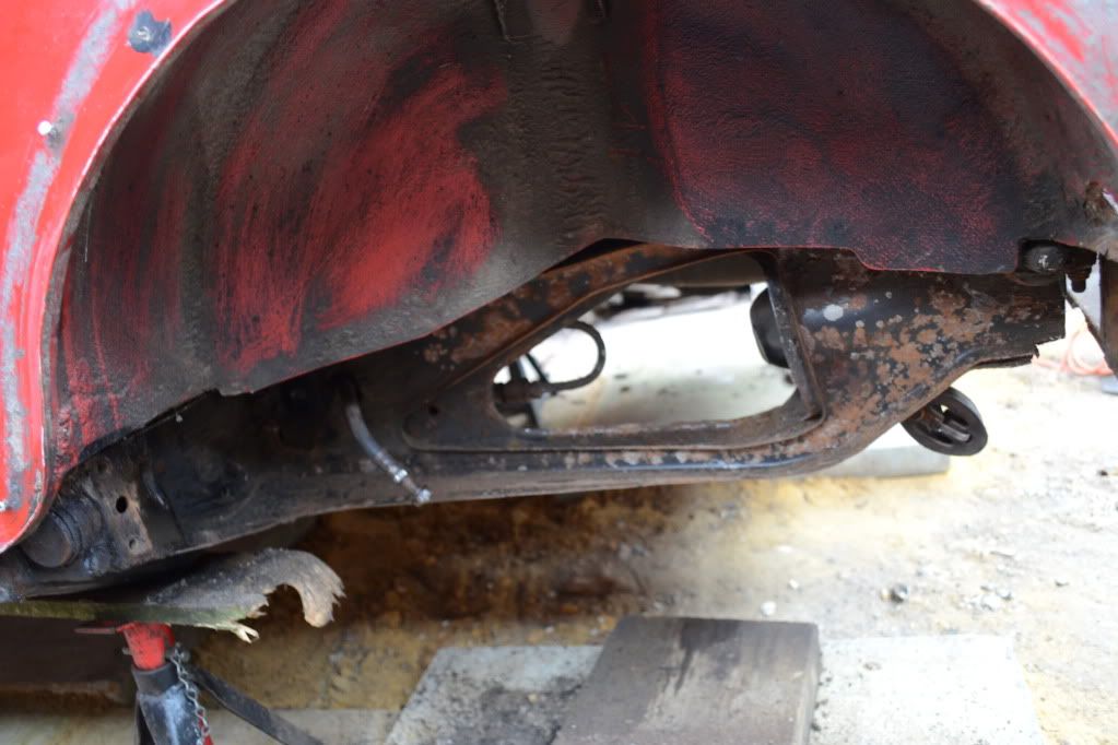

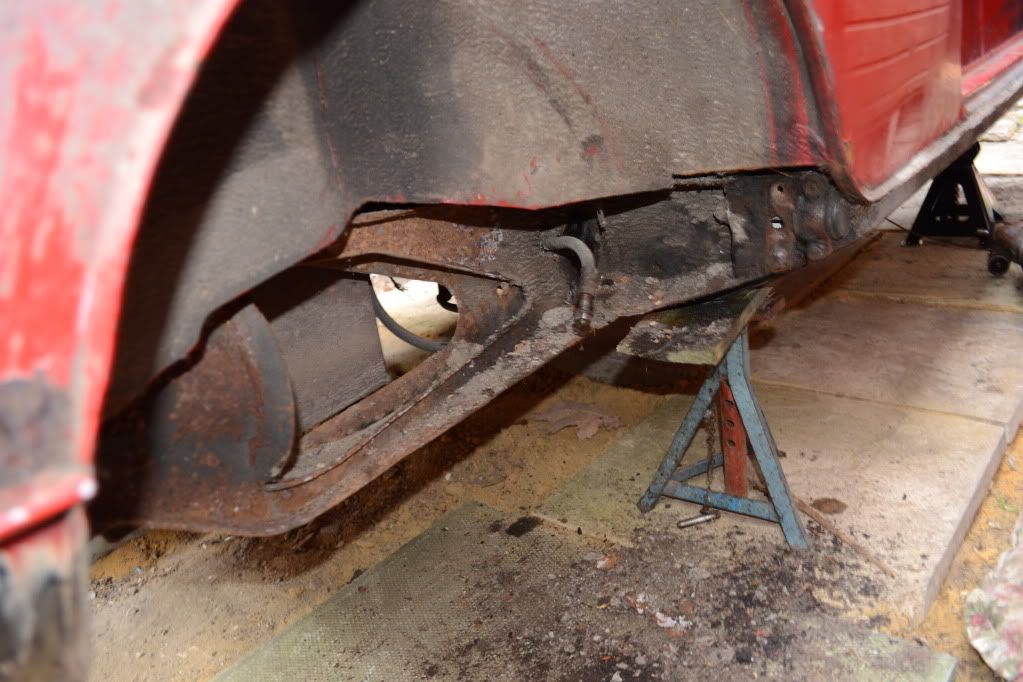

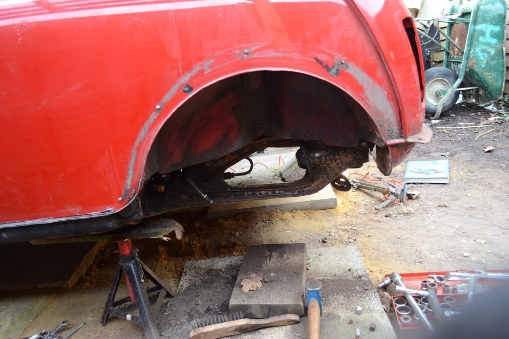

Finally got both radius arms off, but instead of repairing them, I'm going to get recon'd ones.

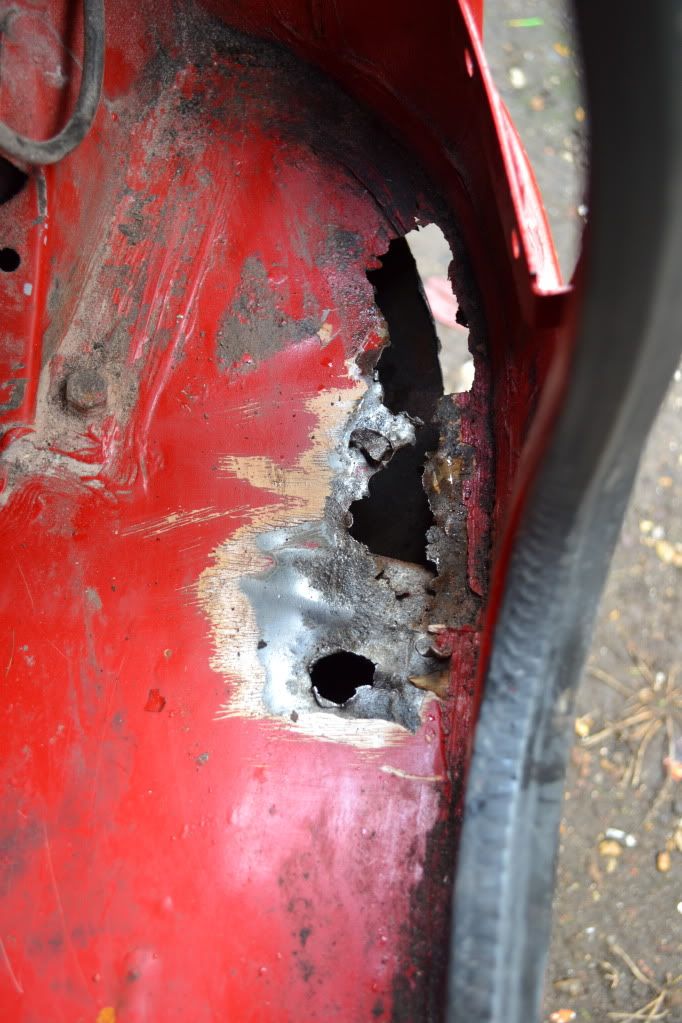

Bit of rust repair on the rear quarter, luckily this time no holes :proud:
Spoke too soon >_<

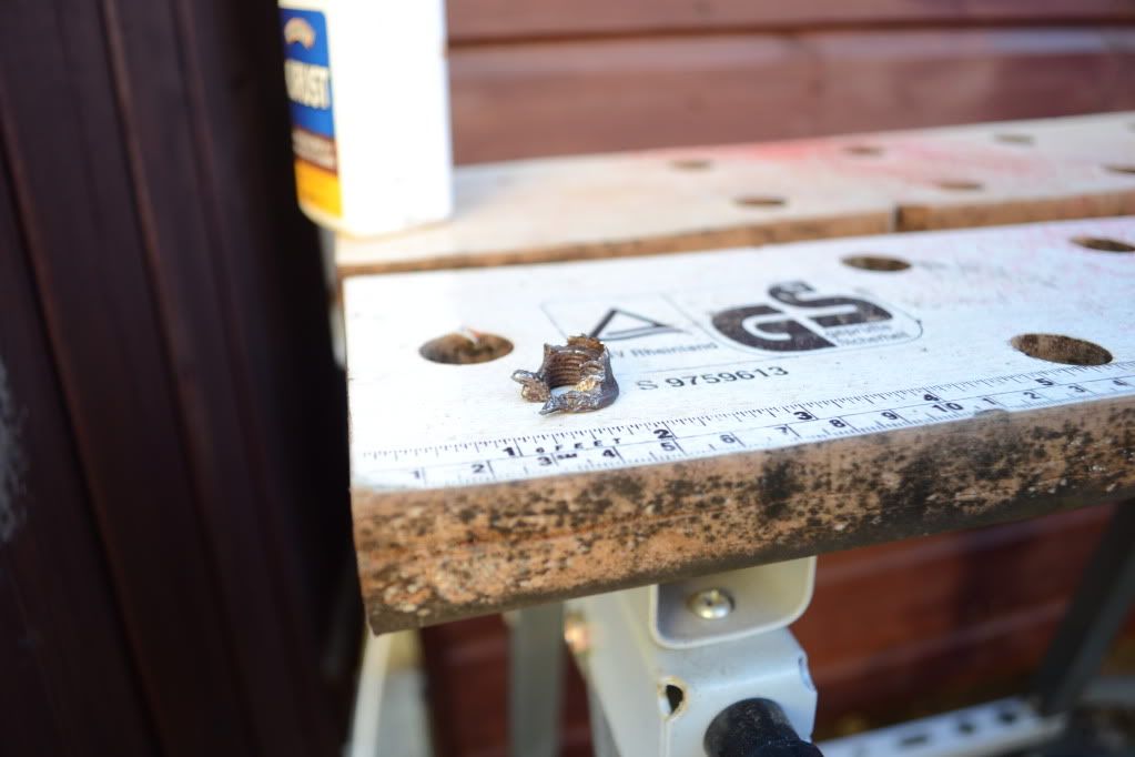

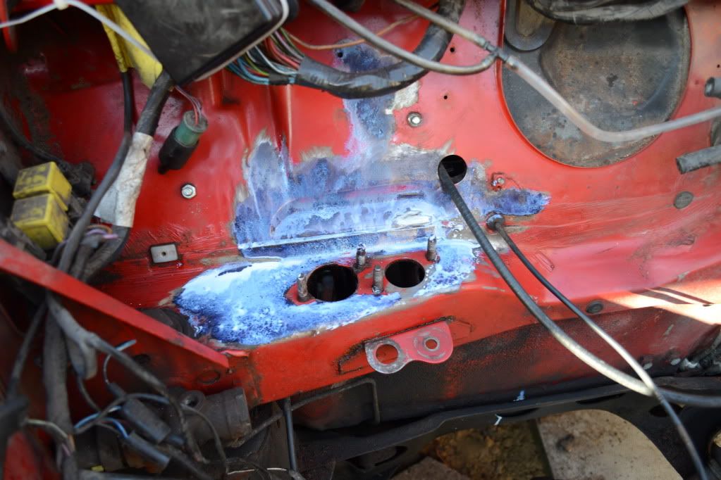

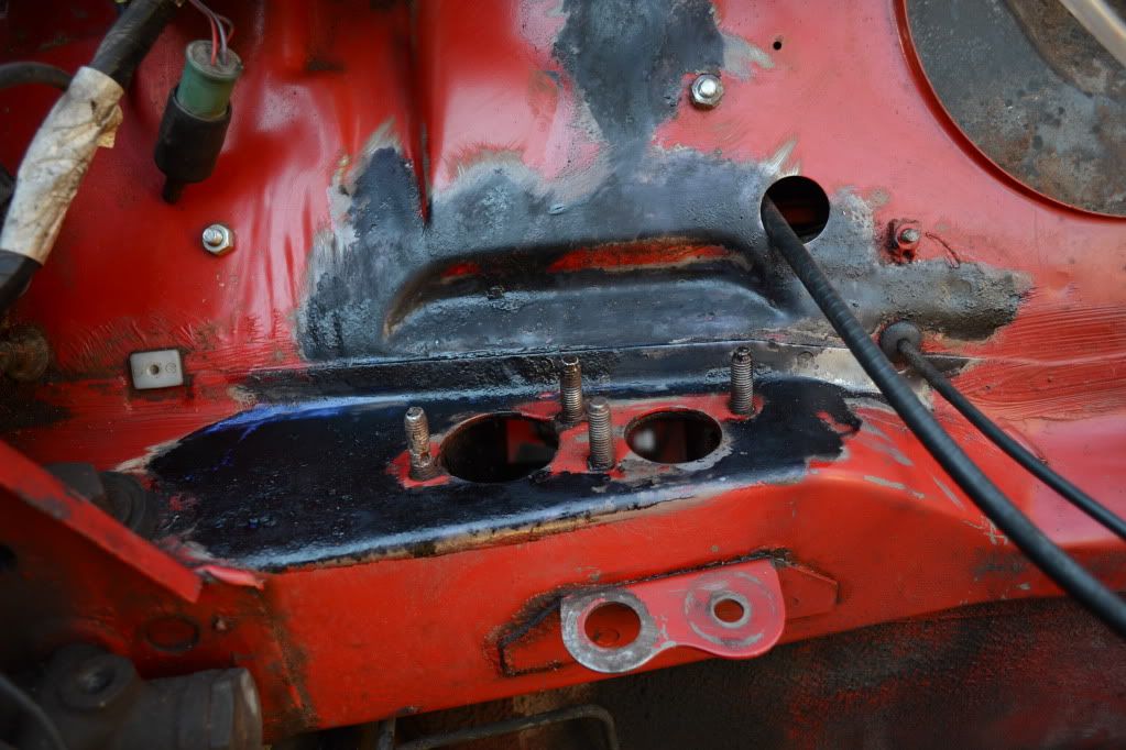

Rust under the servo mount (now been primed and sprayed). Had to wrestle this bugger off though...
Wasn't fun :angry:

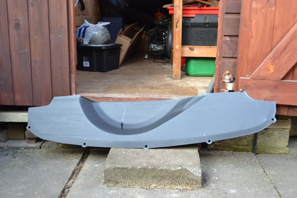

Cut the rear valence off
Old and new!

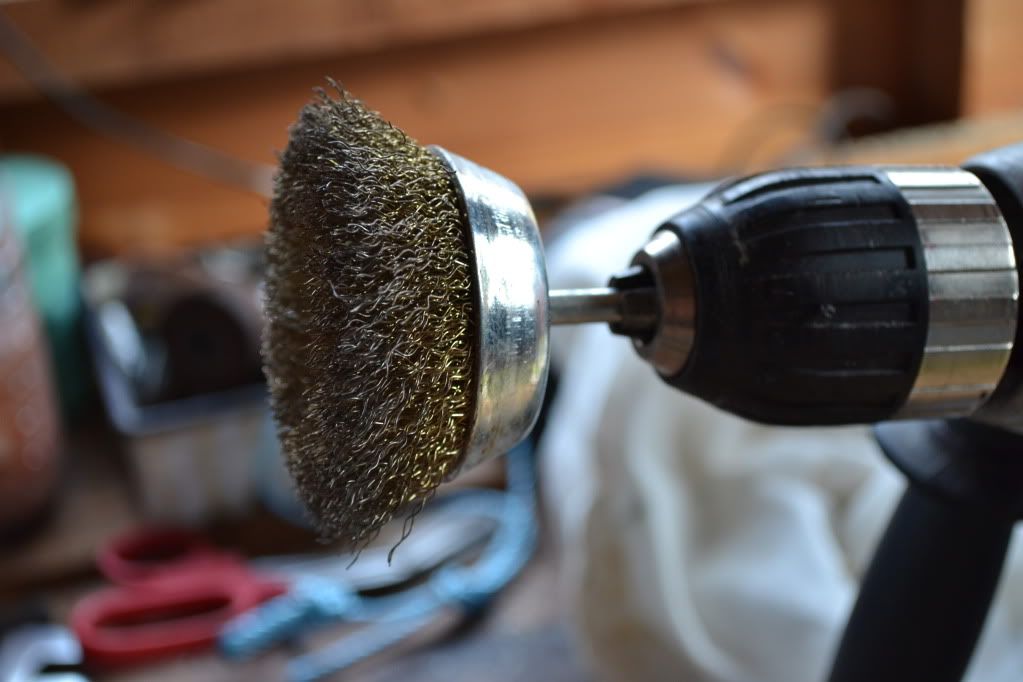

I will do! Can't remember the last time I had a drill bit in my drill and not a wire brush attachment! :blink:
