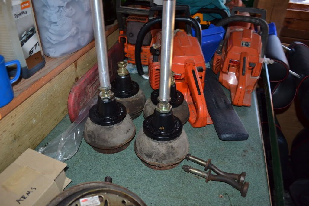

Yay some more photos and ramblings from me!
Well still no sign of the knuckle joints, hopefully I'll have them tomorrow then I can start rebuilding the suspension :D. Also I ordered my new radius arms tonight, and Also a new couple of grease nipples, as one on my front hubs was battered :(, oh well only a quid! Right now lets get some photos up, everyone likes a good photo.

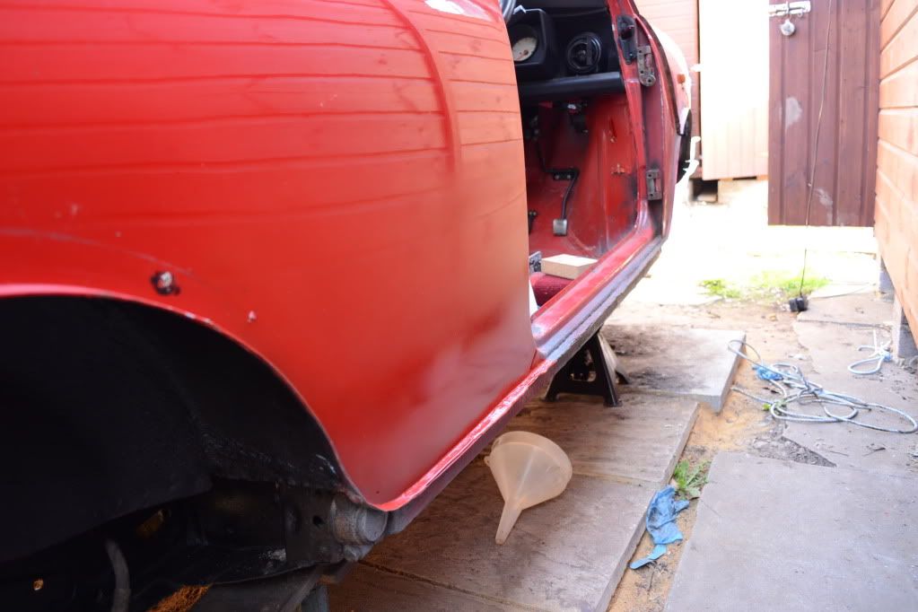

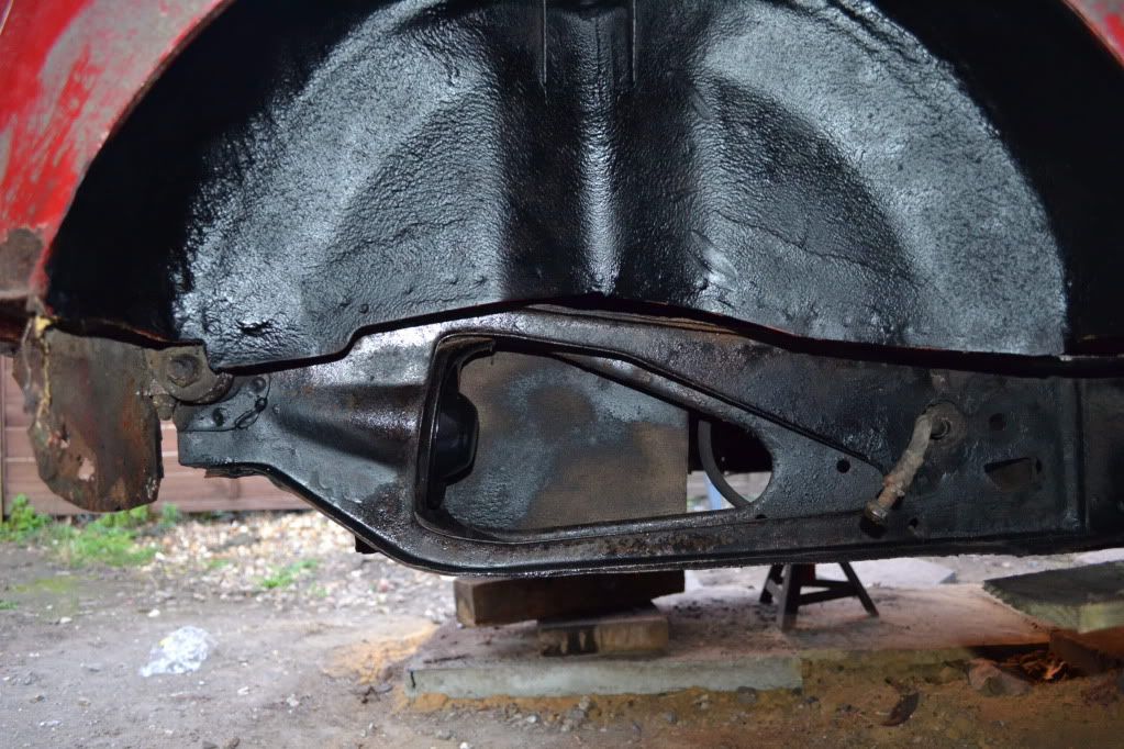

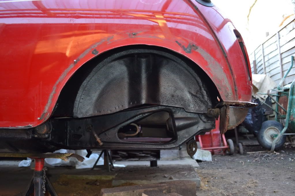

painted and waxoyled arches and subframe, still needs a second coat.

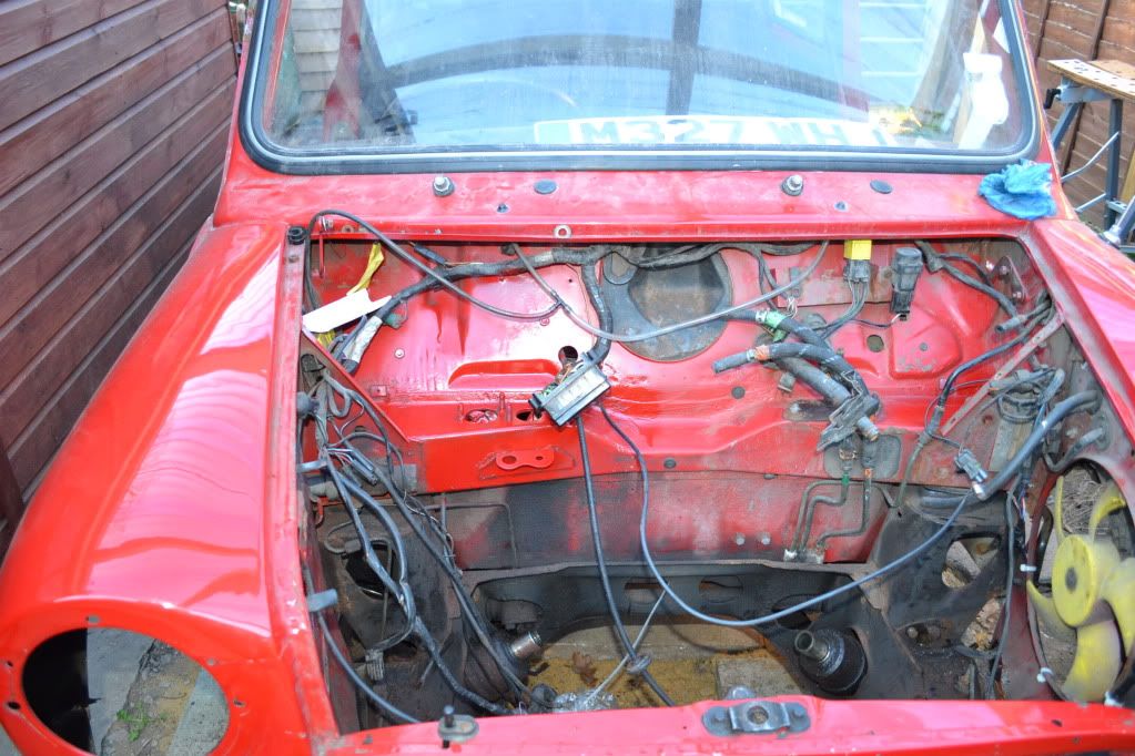

Bit'o paint for the engine bay.

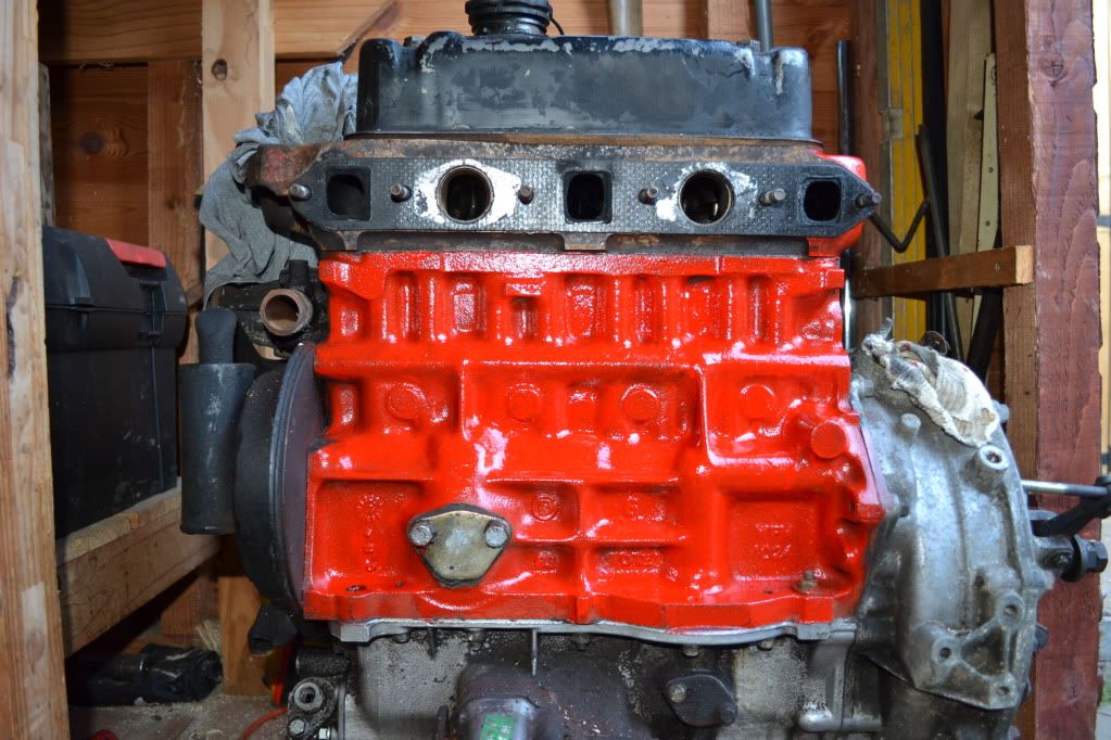

Painted the back of the engine :-)

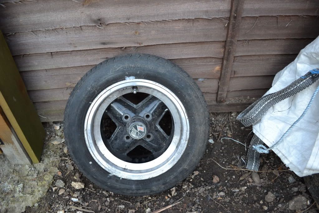

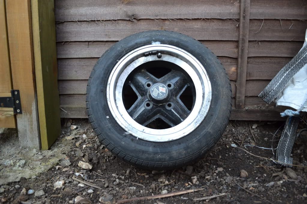

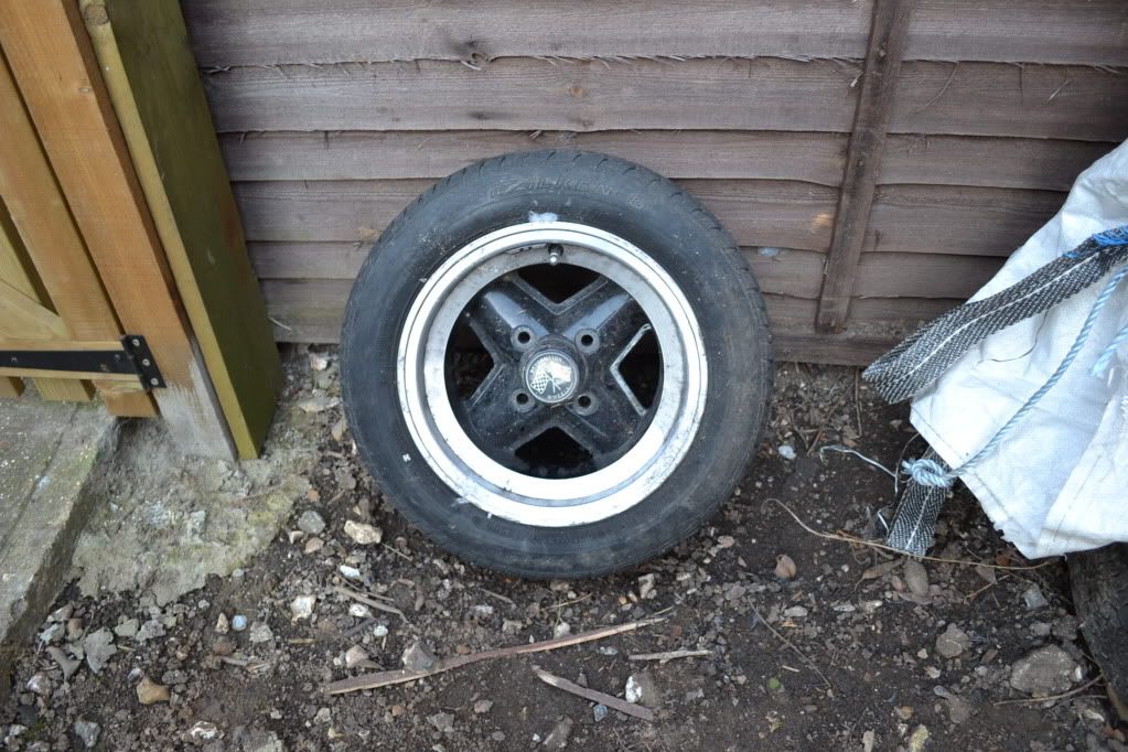

More photos of the free wheels I got, was expecting some old crappy steel wheels when my Dads friend said "I've got some old mini wheels my son had if you want them". But I nearly exploded when he handed me these!! There not mint but just need a good clean!

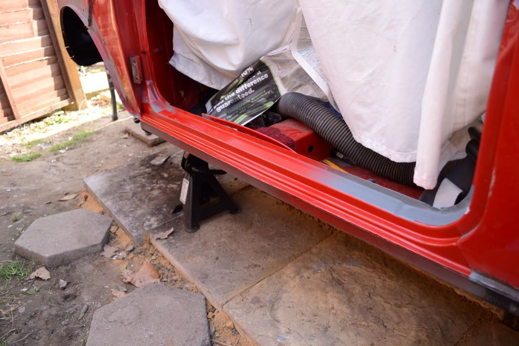

Right, got a 3 day weekend so, hopefully I will get a lot done, at the very least I want the front suspension built up, and the primed areas on the doorsteps/rear quarters painted in at least a couple of coats.
Got the radius arms as well, so going try and get those sheered bolts out of the subframes, Yay....... should be fun...
#25 RayBoogs
RayBoogs
  • 1,109 posts
Posted 01 April 2012 - 07:15 AM

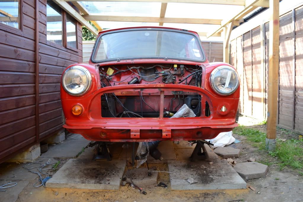

Right some progress!
Got some paint on the car, pretty happy with the colour match just needs to be rubbed back and a couple more coats, then polish it up to blend it.

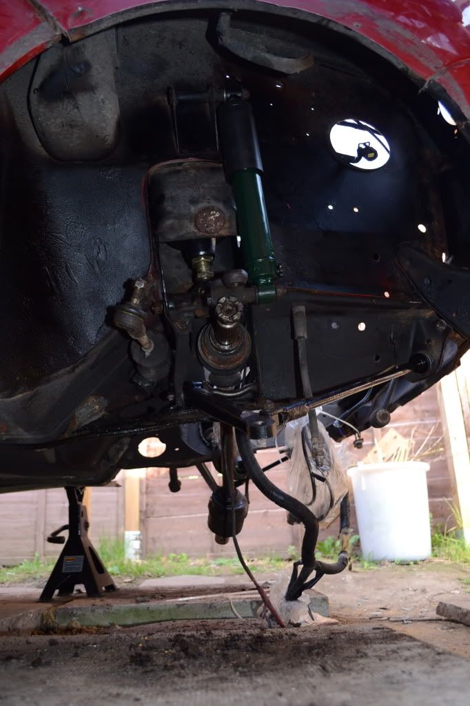

Front suspension in minus the hubs, got one hub ready built,and one half way done, although I think I need some new balljoints :(

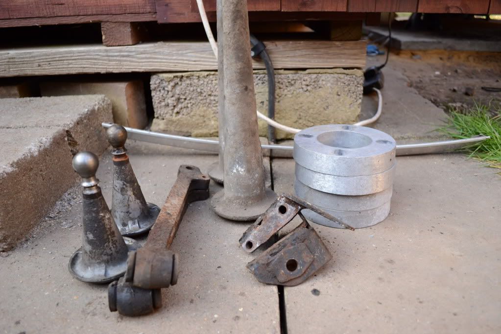

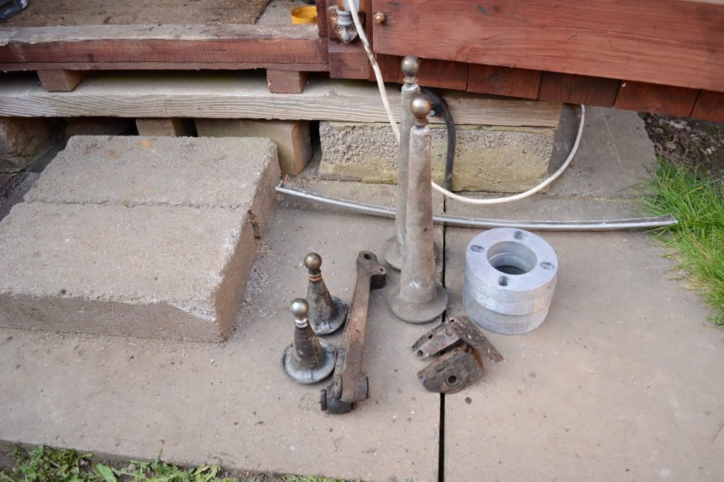

Also I've got these bits laying around and going to get them up for sale, So if anyone wants them drops me a PM.

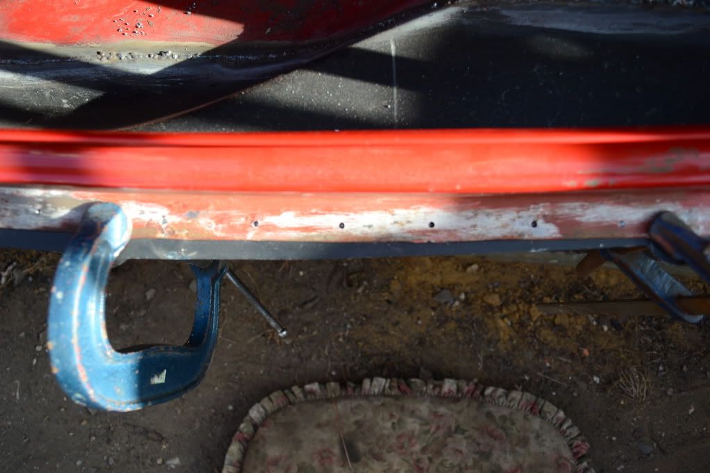

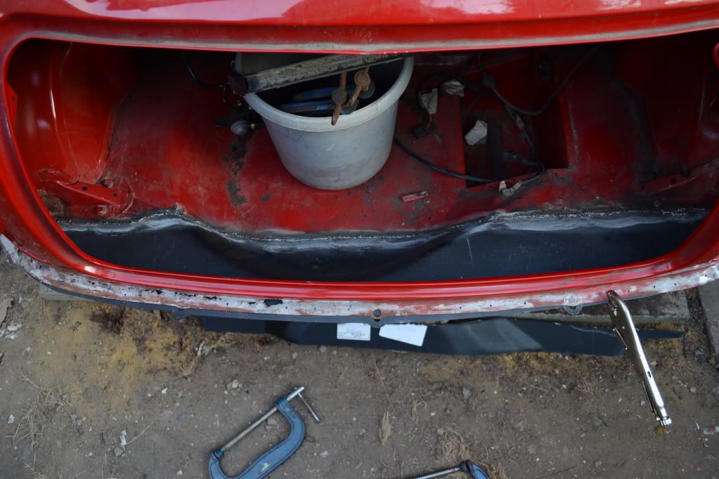

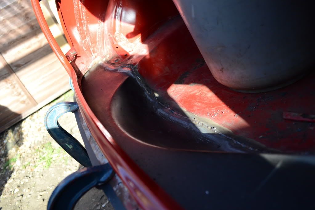

Welding and panel fitting, not as fun as it sounds, especially when you have a temperamental welder. Managed to get it welded into place to the floor though.
and have drilled some holes for spot welds, will need opening up a bit though

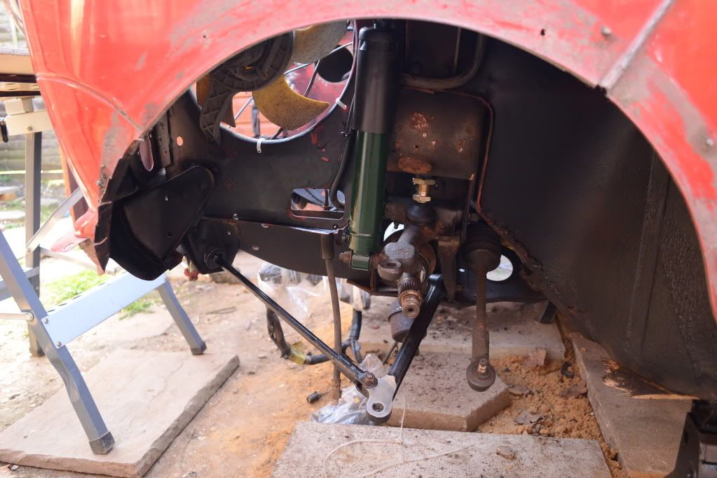

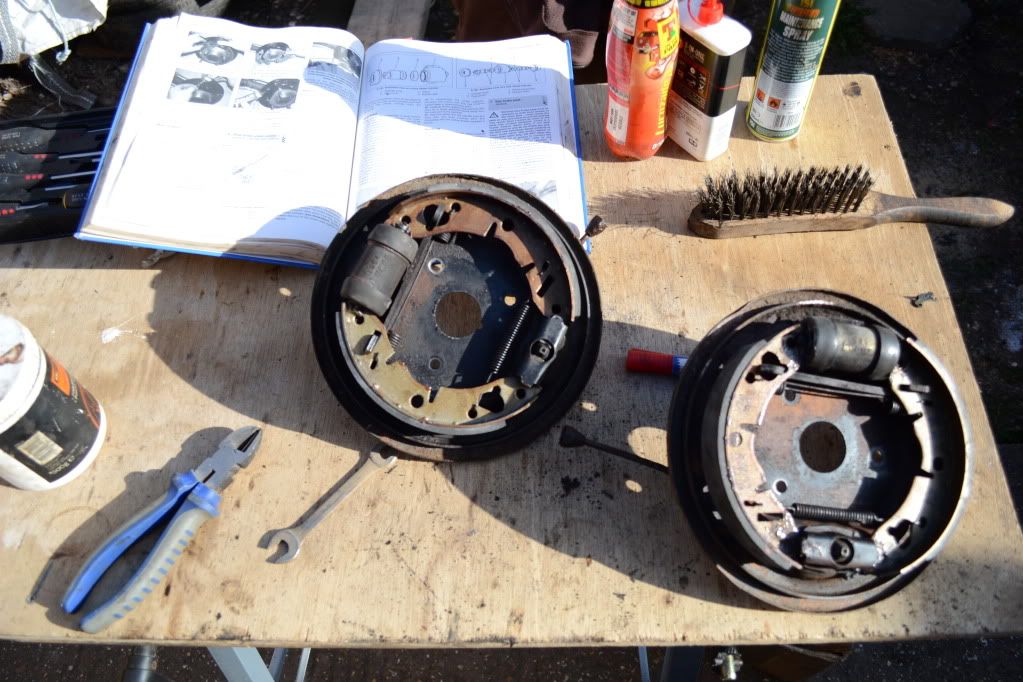

started building the front end up as I got bored of bodywork, and my friend who did the welding went, and I'm not confident to let loose on my car yet :shy:

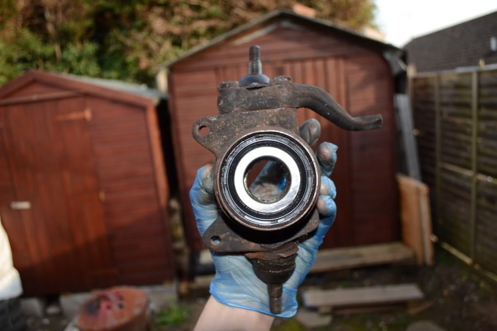

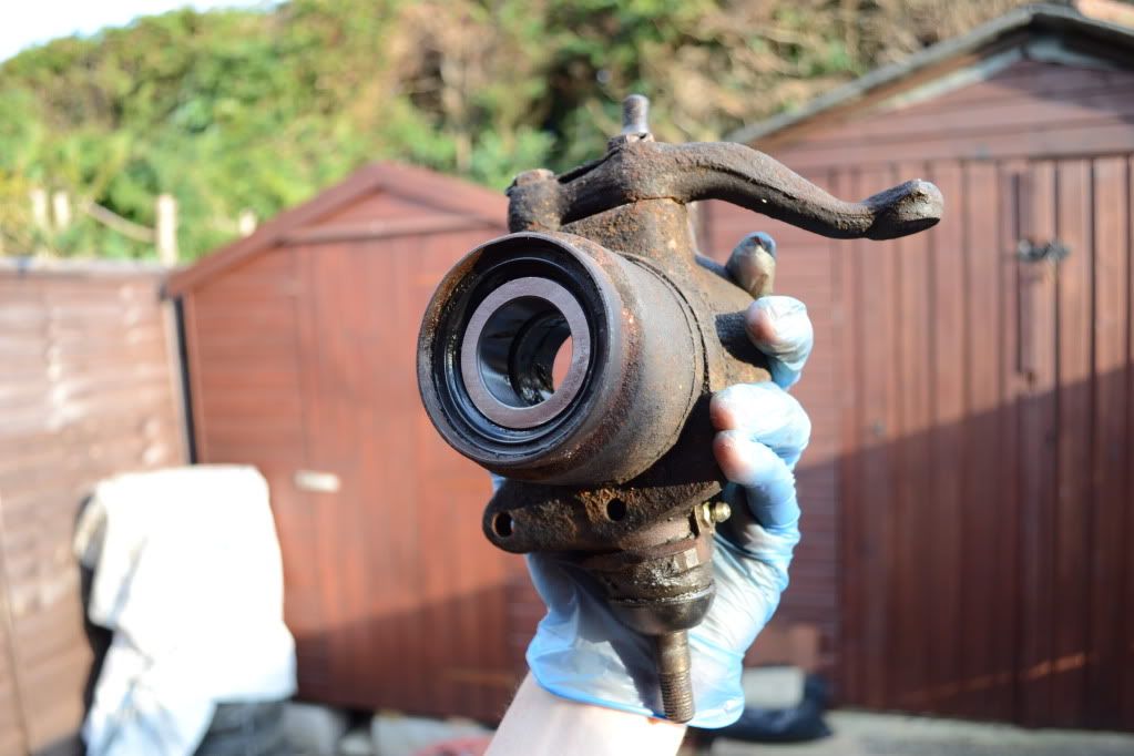

One built hub, new bears and greased balljoints, one feels a bit stiff and tight, may have to change them... hmmmmm

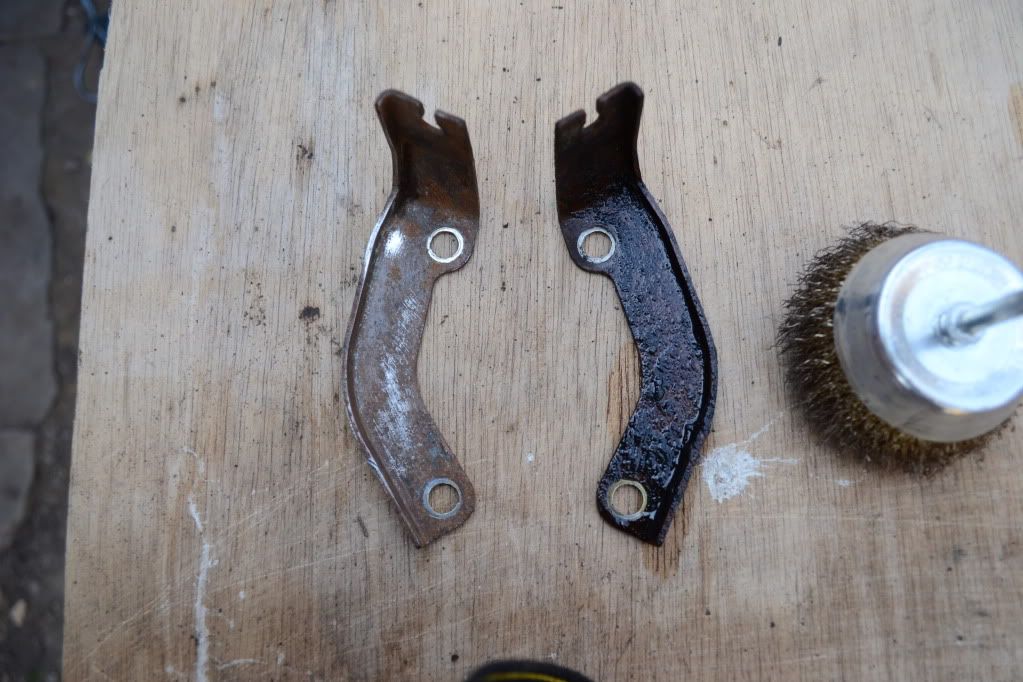

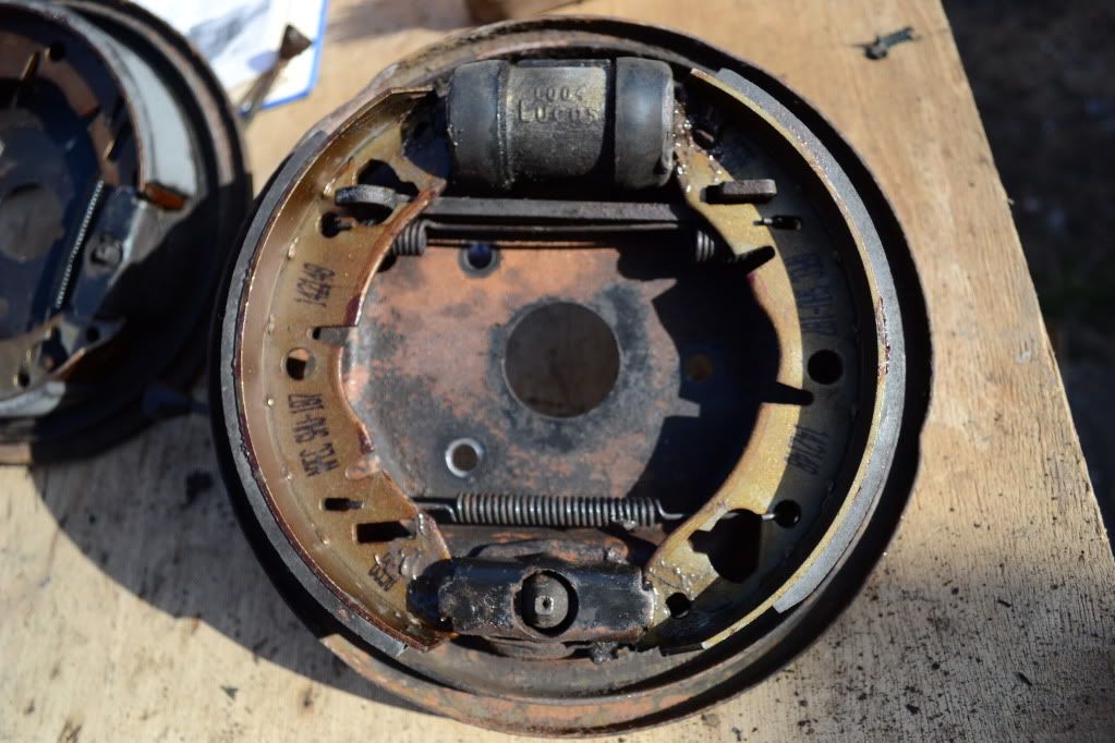

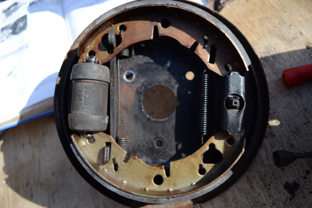

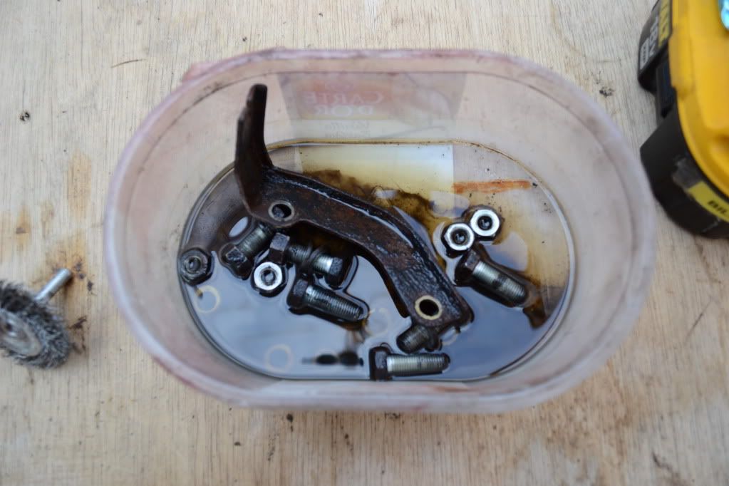

Also cleaned and put new shoes on my back plates, and cleaned up the bolts and handbrake cable brackets, ready for when I get round to tackling those sheered bolts, REAAALLLLYYY not looking forward to that.
Also got another coat of paint on the engine, and on that note, NEVER buy halfords engine paint, its just awful. :proud:

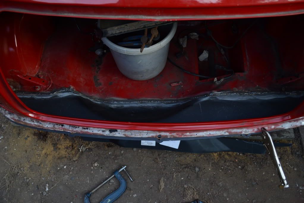

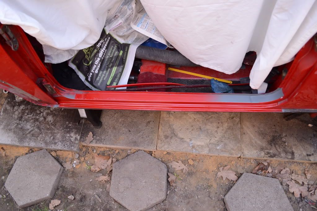

Been spending a bit of time over this 4 day weekend on the mini. The boot floor is now completely welded in place, spot welded along the bumper mount edge and with some sections of seem welds along the inside edge for more strength.

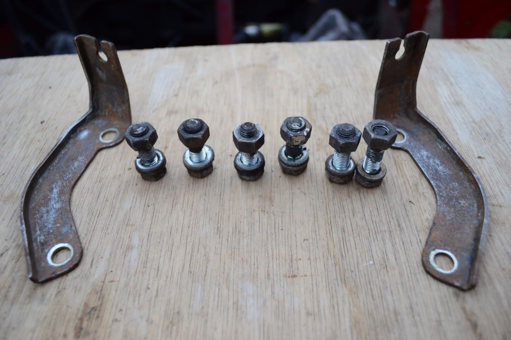

I have got the 2 sheered bolts out of the subframe!!!! YAY, took a fair while, welding nuts and washers to them to make a make-shift bolt head and then turned them out! I've got a new set of bolts on there way so no money more rusty crappy ones, and when these new ones go in, they will be plastered in copper grease :proud:
Also I have ran a tap through the threads for the radius arm brackets to get rid of the grime in the threads. I've started building up my new radius arms ready for fitting when the new bolts gets here.
Have also done a bit more spraying on the passengers doorstep, looking much better now :D
