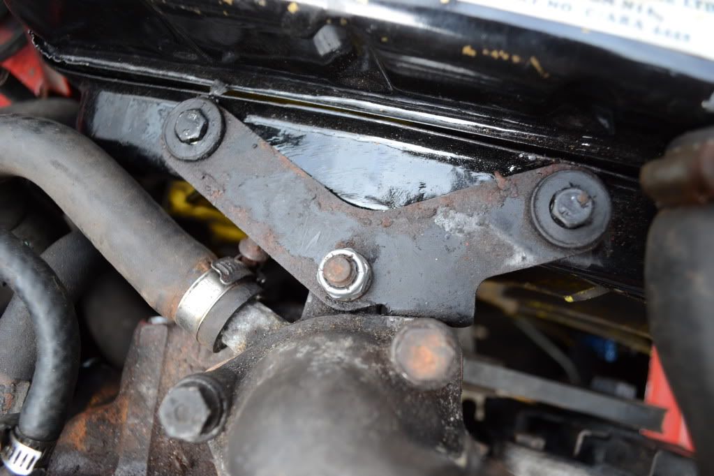

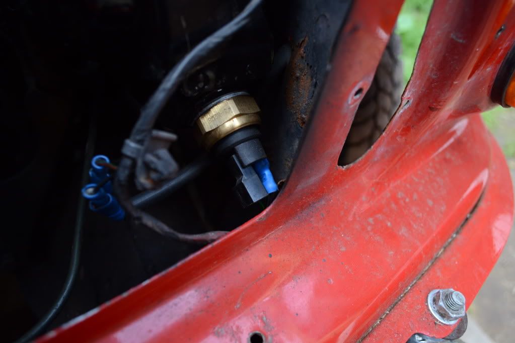

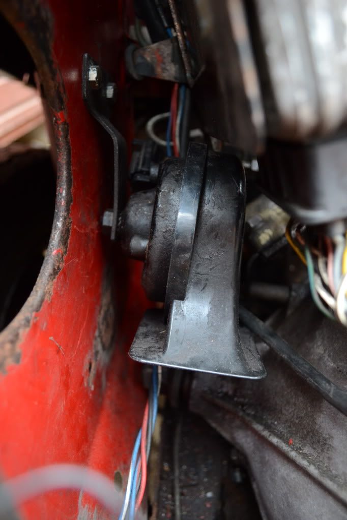

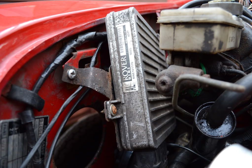

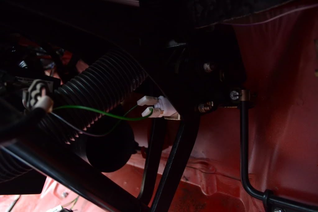

Well time for some photos. Got some little annoying bits done.
Horn in
ECU mounted, I really don't like it in the engine bay, I think in the near future it will be living in the dash.
Radiator top mount in.

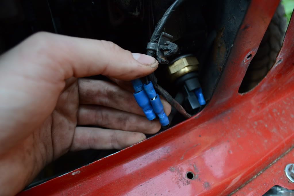

Got the indicator wiring, coolant temp sender and brake light switch all wired in.

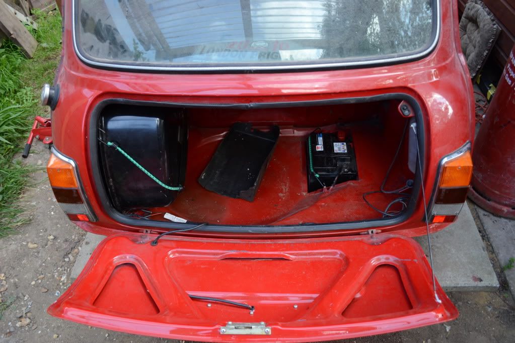

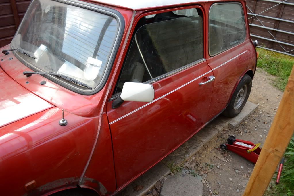

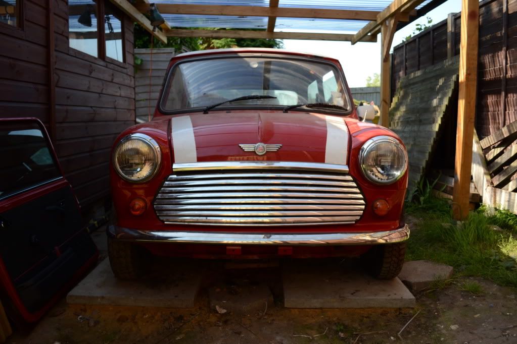

Right, I've actually been doing some work on this again. I got a bit too stuck into my Golf, bought some new wheels etc etc, been busy at work too.
Time for some photos! Can't really remember where I left off last time so I'll chuck some photos up!
Got the doors on, front grille, bonnet and bumper, also boot lid and petrol tank and battery are all secured in now.
painted the rear valence and sprayed the whole underside boot floor and inside of valence of box sections with red oxide primer and stone chip.

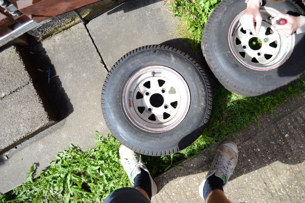

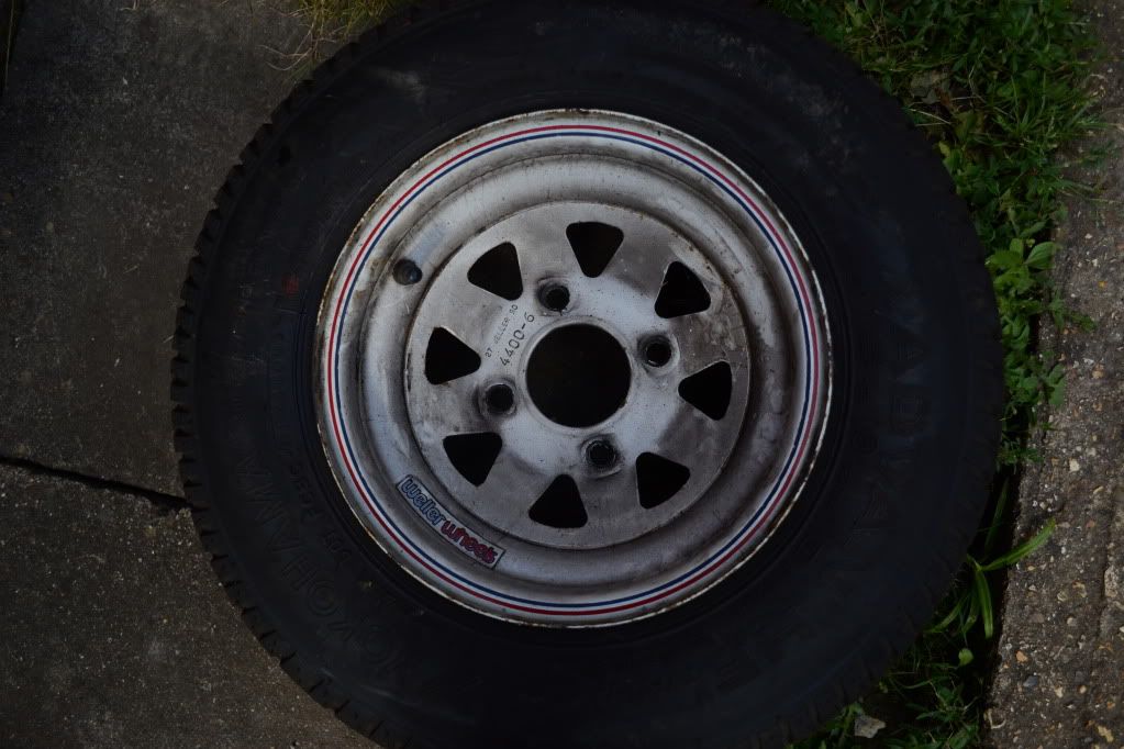

Started to re-furb my wheels aswell, they were looking tired and dirty and a bit of yellow surface rust was poking through, pretty mush all of them were like the first couple of pictures. So sanded the rusty areas back, keyed up the rest of them gave them a couple of coats of zinc primer and then just some white gloss spray.
Need to spray my arches body colour as well, other than that not much left to do, just need to sort the hole in the rear arch. Got a panel made up so I'll just weld it in.
