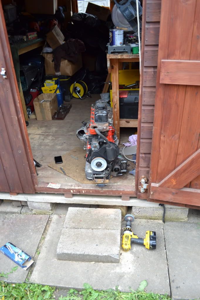

Some photos from the other day and todays work!!
Welding completed, I have done some spraying but no photos >_<

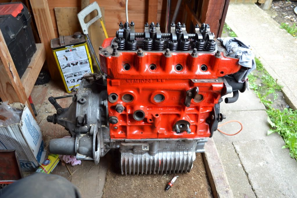

started doing some engine prep
Done the valve clearances, new rocker gasket, new engine mounts and bolts.

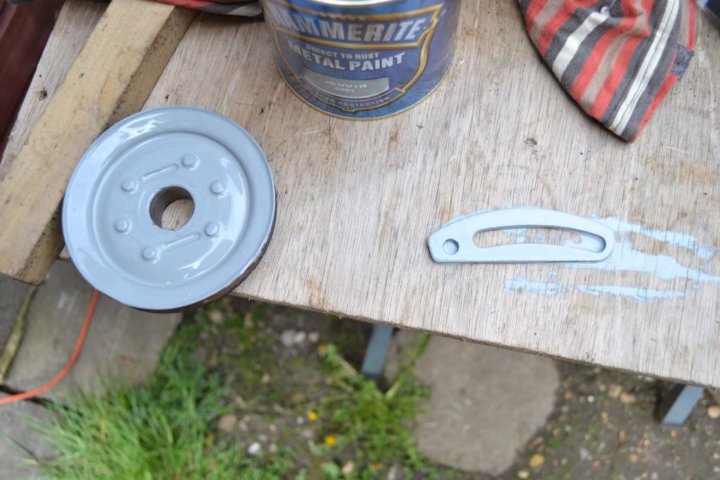

also I painted the fan pulley and alternator bracket

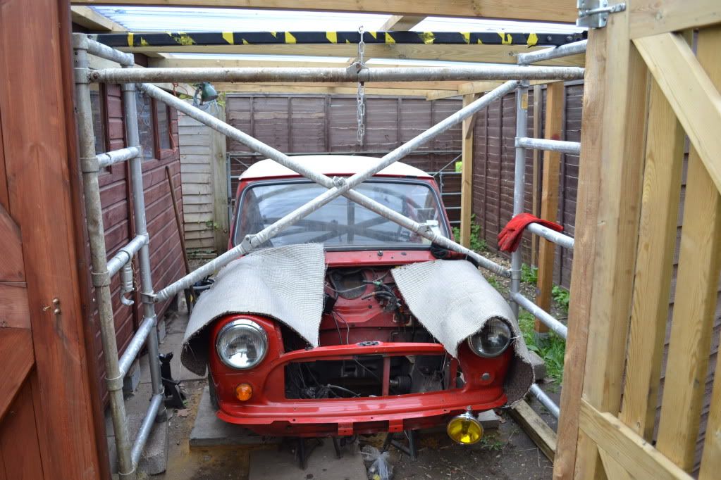

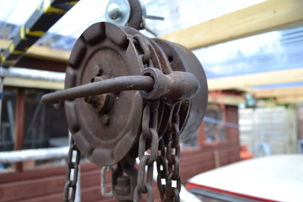

Have also rigged up the crane/hoist thingymajig ready for tomorrow
will be hanging the the block and tackle off the bar along the top and then just man-handling up and over.

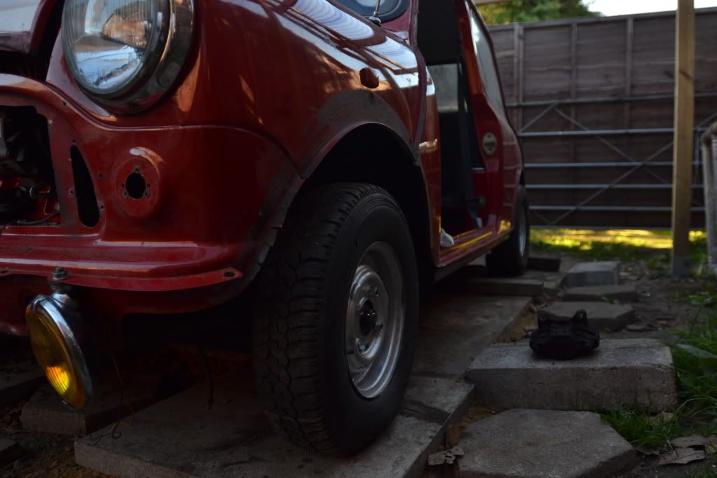

Also I can't seem to get to the bottom of the "wobbly" wheel problem it seems to stick out a bit more than the other side too
normal side
wobbly side.
It sort of clunks and moves back and forth, although you can't see it wobble you can feel and hear it. I suspect the bearing hasnt seated properly in the hub, so I'll be taking that off again soon :mmkay: F'in minis!!!!!!!!!

I'd say check the radius arm pin is seated without any issues as well, just in case.

Could well be the rear hub which is wobbling (maybe due to damaged-incorrectly seated bearing)

Hopefully its not a damaged bearing I've just replaced them!! >_< I think its likely to be it not seated properly, but the radius arm pin is another good point, I was having trouble getting the washer and rubber seal to sit right so this could popped out and pushed the wheel out slightly. Hey ho I'm sure I'll find out soon!! haha.

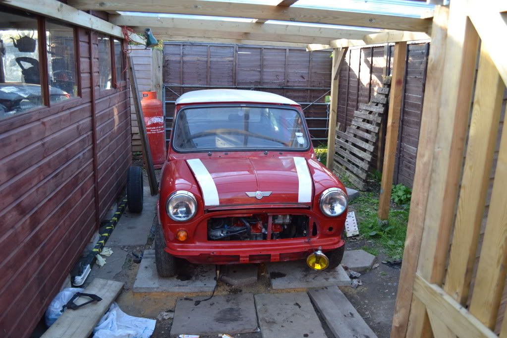

Well today this happened
(new engine mounts)

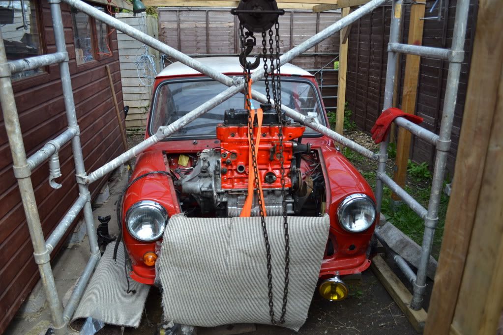

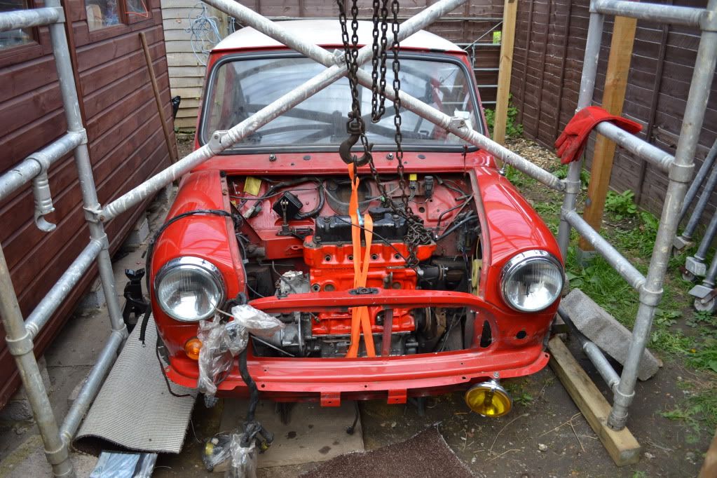

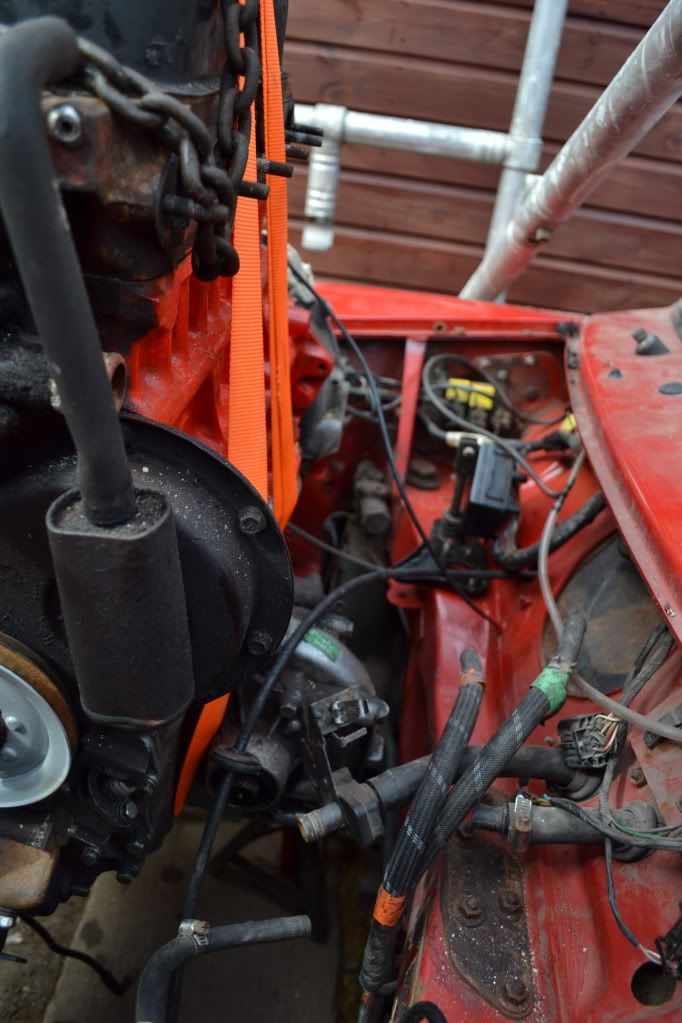

So yeah I think you've got the idea now, the engine is back in!!!!!!! :D :D :D :D I used this little beauty to get it in
Engine mounts torqued up
(don't really know why you want to see this :lol: )
I also started to put some stuff back on the engine and painting some stuff to make it look nice and tidy :proud:

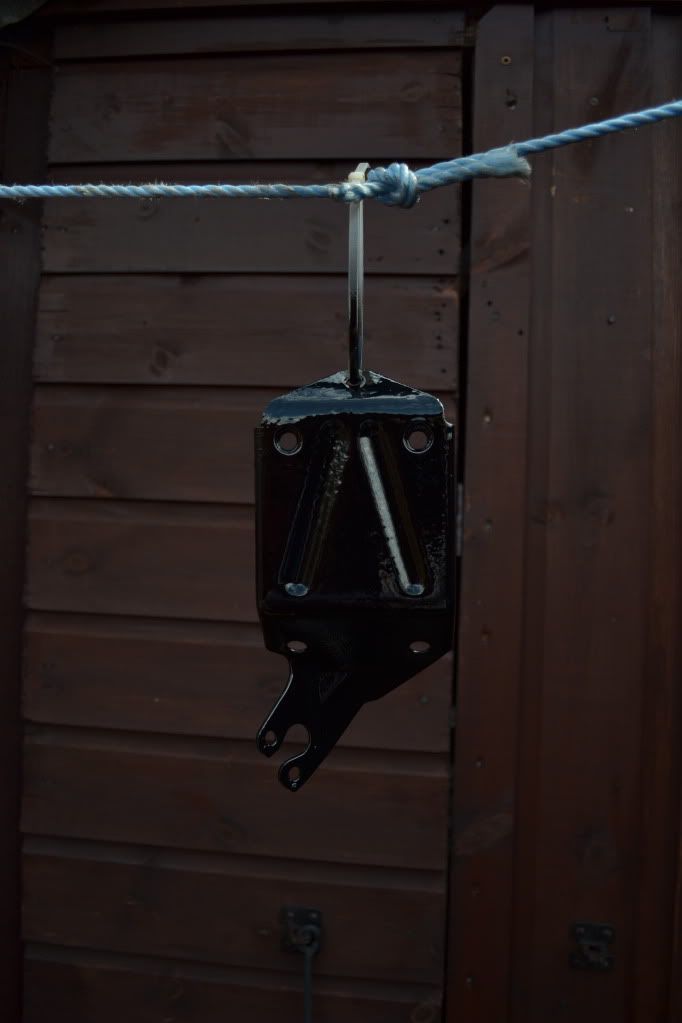

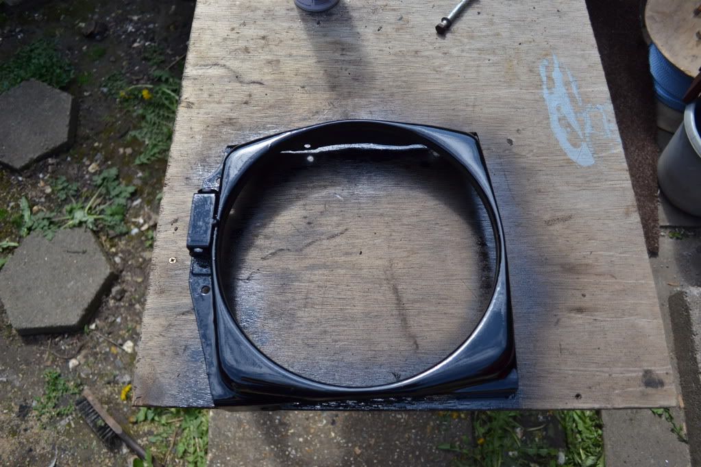

Painted the radiator cowling, breather, and slave cylinder mounting plate.

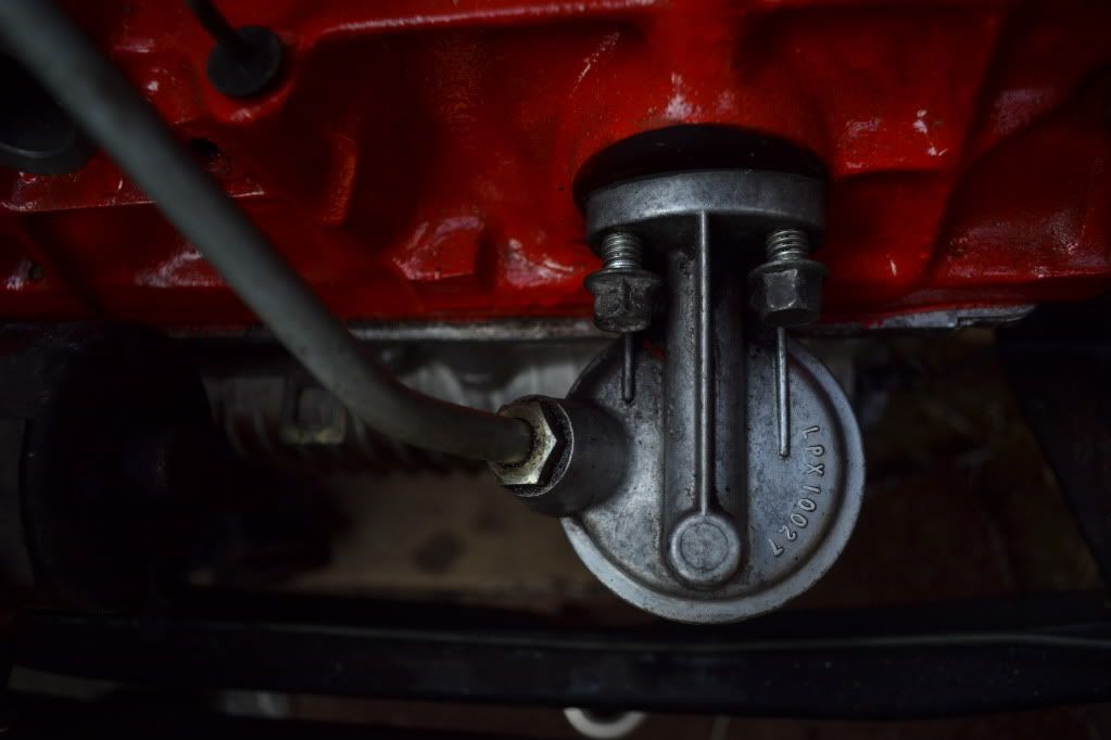

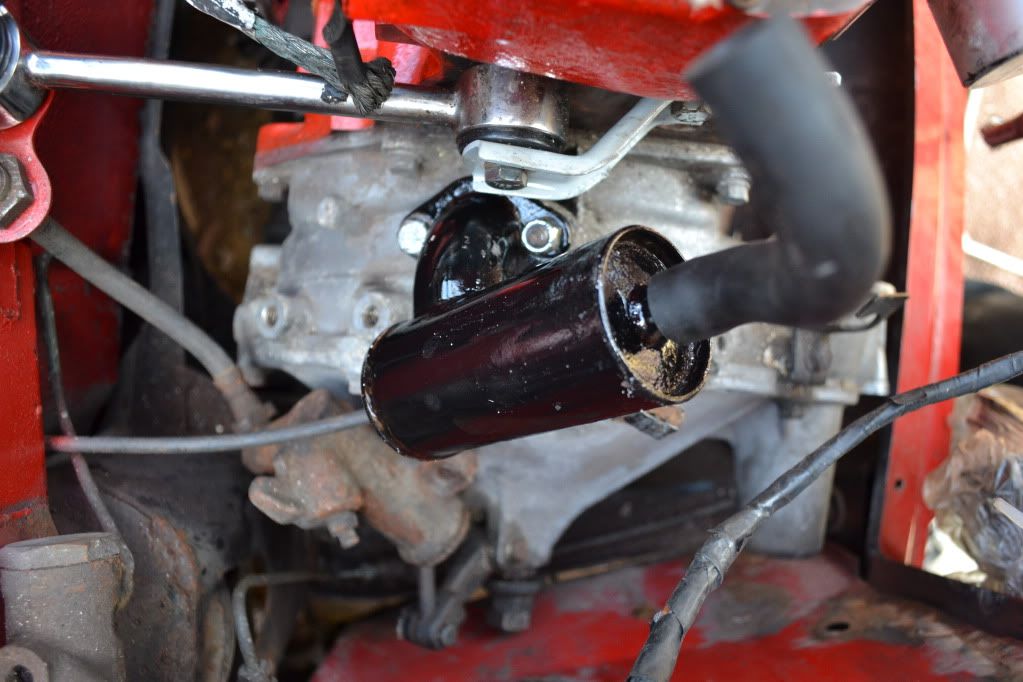

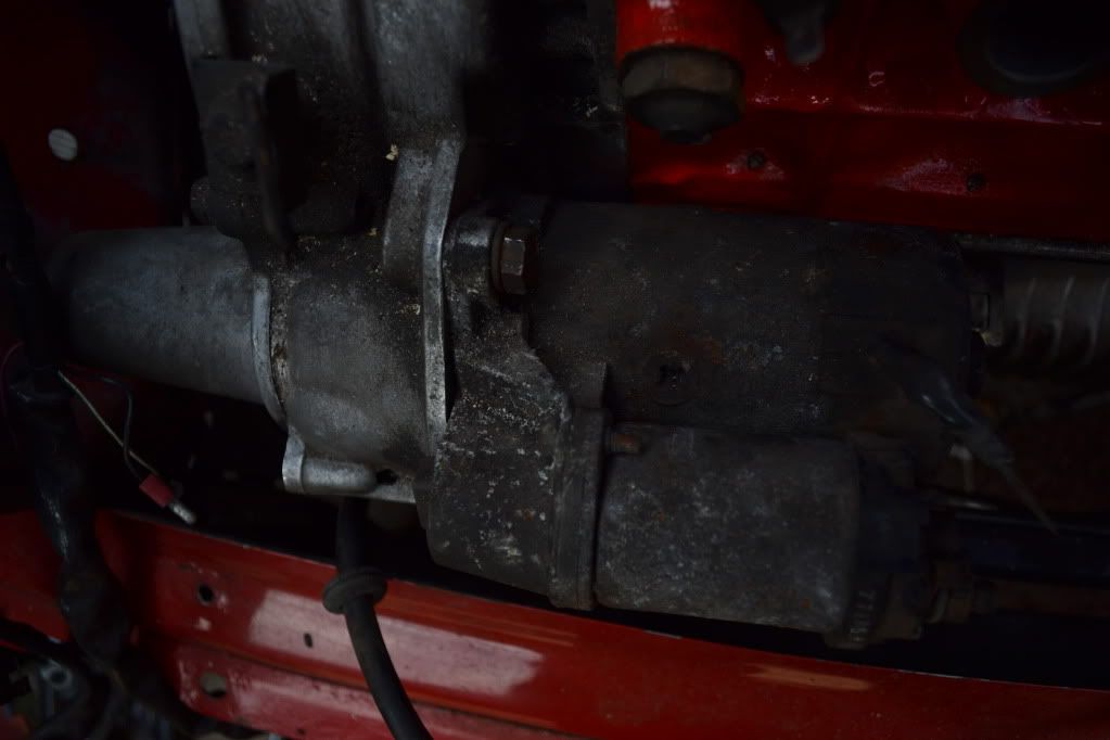

I've put the starter motor, thermostat, top engine steady, oil filter and pipe (not finished need some gaskets paper), oil breather, and had a go and figuring out where the wiring loom goes, it's not too bad really sort of just falls back into place.

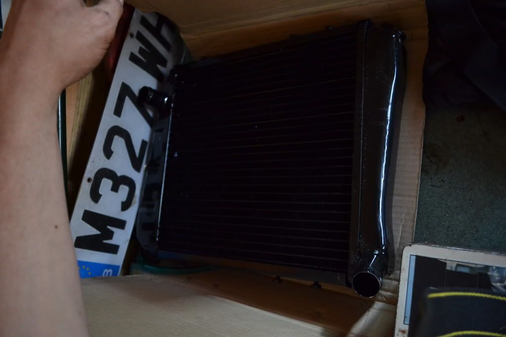

Also got my new radiator
Thats all for today, I think... haha. Tomorrow I should be getting a good day on it tomorrow get another load of stuff plumbed in hopefully the exhaust etc. This time next week I'd like to have it in a position to start it up and see if it goes. That reminds me I need some more spark plugs.

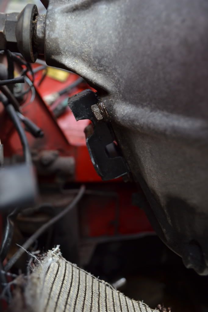

Right, I'd love to be posting a nice video with me running around cheering like an idiot with the engine running, but I can't, because the even will not turn. As in forward or backward, by hand or on the starter, even though it turned over when out of the car.
So yeah, I'm not very happy.
Anyone with any ideas?

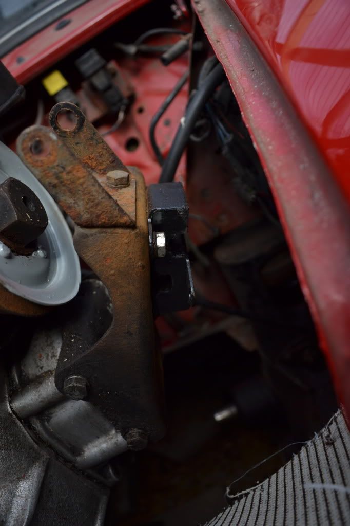

I have a update of sorts, I posted up a question about my problem and got some good suggestions, (bent dizzy drive and clutch slave bracket bolts fouling the flywheel) so I'd like to be trying those tonight.
BUT, Over the weekend, I think sunday, I managed to rupture and tear my groin muscle and cause a muscle hematoma :xxx: , basically my muscle is bleeding from the tear and has swollen up, so yeah I can't walk and am bed/sofa ridden for at least a week.
Hopefully my mate who's been helping me out will be coming over and doing some work for me to see if he/we can sort this engine.
But also even if the engine runs and starts and it's finished for L2B this weekend, whether I'll be able to move my left leg properly to drive it is another question.
Not good news, although it does give me some time to research engine builds/engine swaps.
Hopefully I'll get some photos up tonight if nothing else :(
#56 RayBoogs
RayBoogs
  • 1,109 posts
Posted 14 May 2012 - 09:13 PM

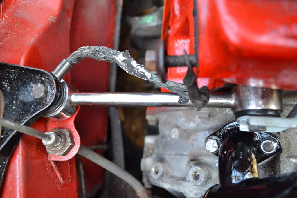

I'm an idiot, It was the clutch slave bracket bolts jamming the flywheel, massive thanks to ANON who pointed this out!
I, well my mate, took out this bolt, which was chewed up a bit >_< , and it turned over by hand so.....

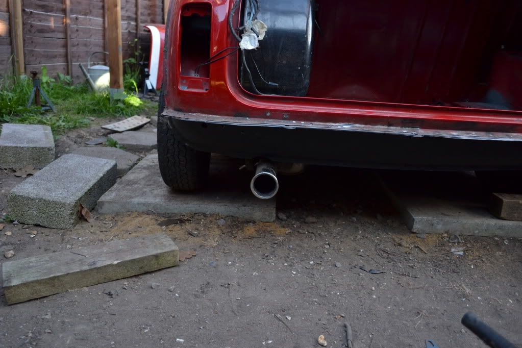

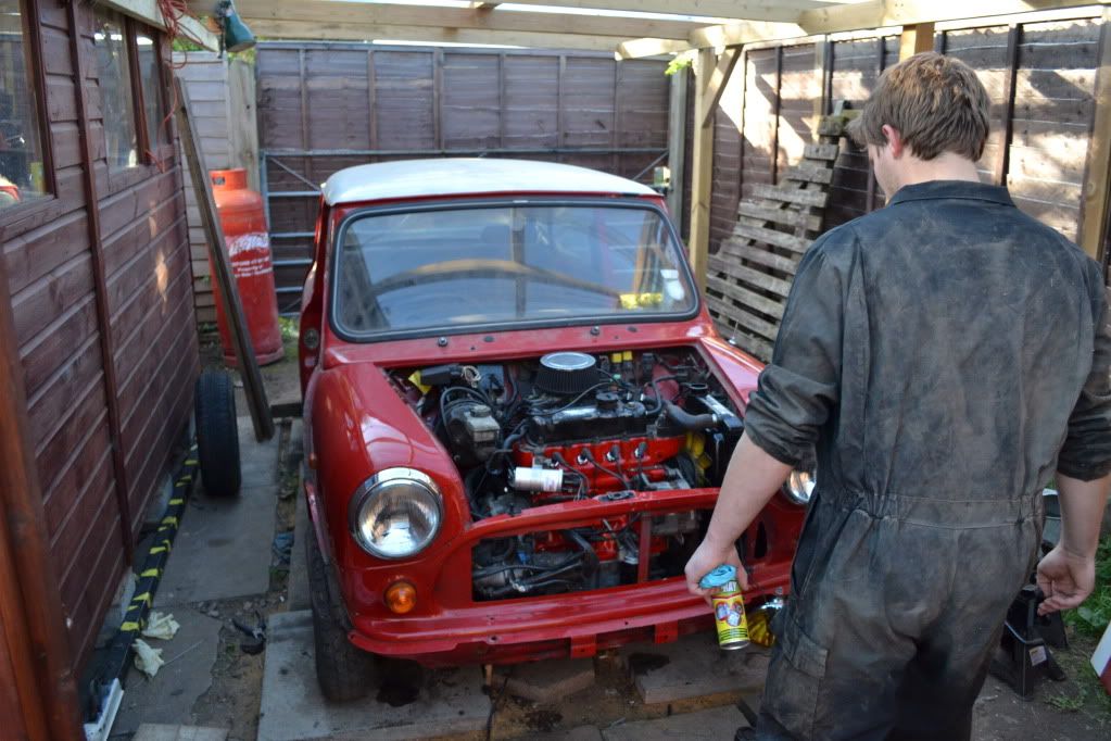

IT RUNS!!!!!!!!!!!!!! It sounds much better now as I've put the back box one!
I was extremely surprised when after 1 turn of the key it burst into life! chuffed!!! :D

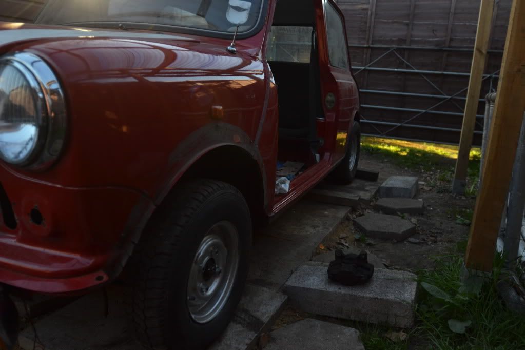

anyway here are some photos of the car now

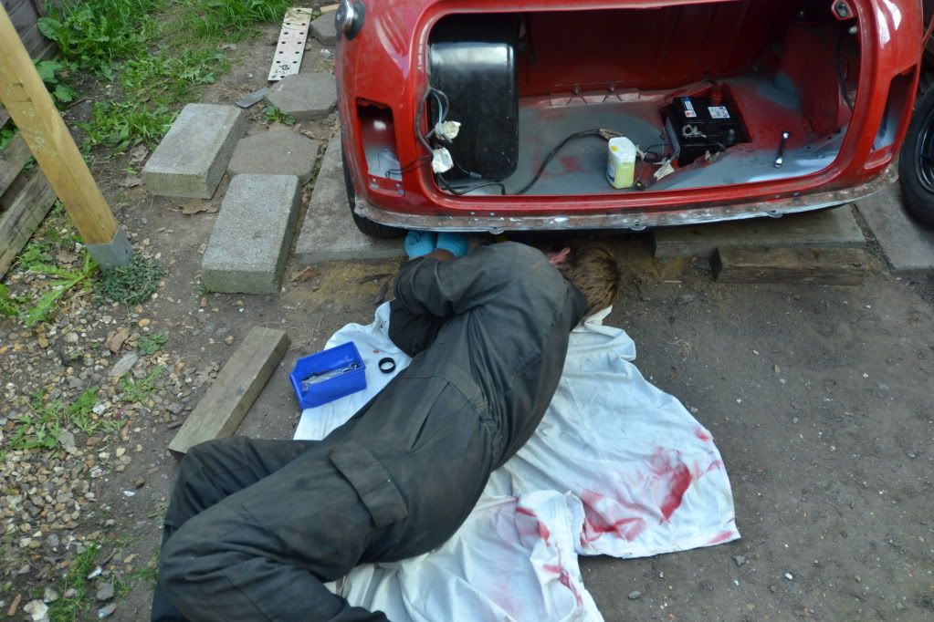

(foggy doing the work, while I was sat on my arse!)
how its sitting now, needs to go much lower!
Only a few more things to do now, Foggy is coming back over tomorrow to do the clutch and brakes, Hopefully I'll have it ready for this weekend and depending on my leg I might make L2B

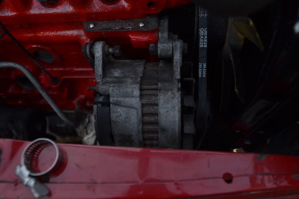

Alternator

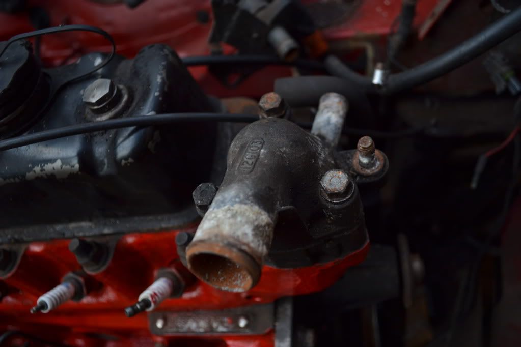

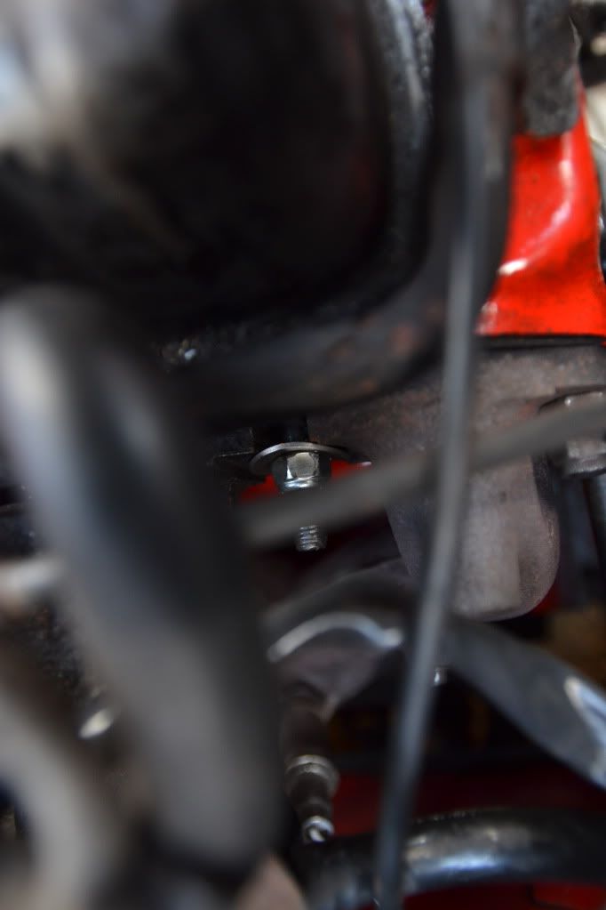

The suspect manifold nut, causing the leak, luckily I found a proper manifold nut and fitted it and the leak has stopped! I have a new gasket on the way though, so will probably end up changing it anyway.

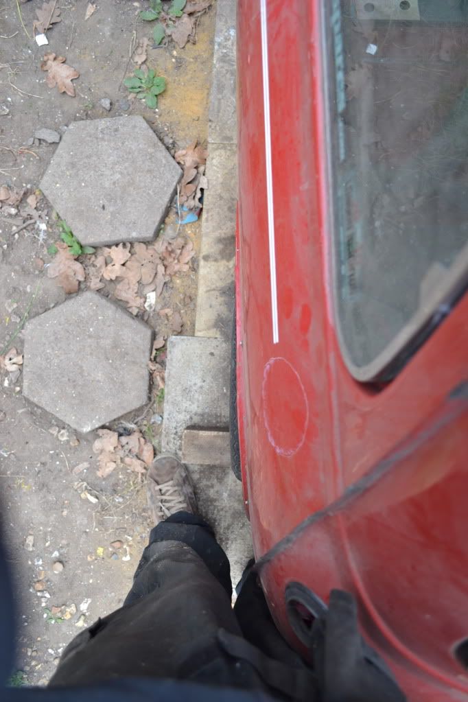

Driver side door repair, will cut this out and weld in a new patch, as it is right on top of the seat belt mount.

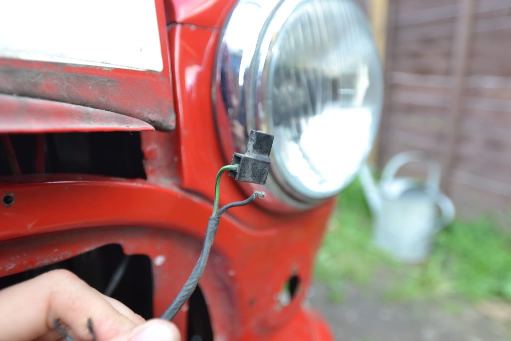

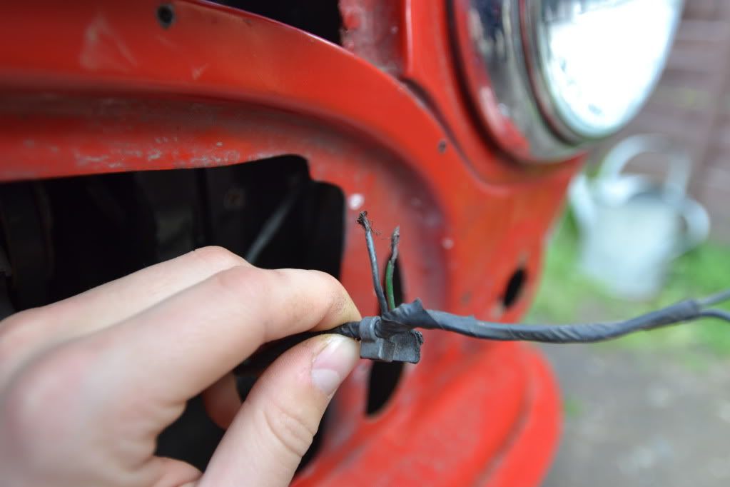

Indicator wiring minus the connectors!

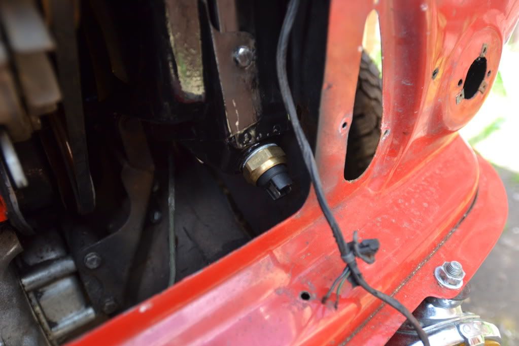

Wiring for the temperature gauge on the radiator, the connectors looking worse for wear!

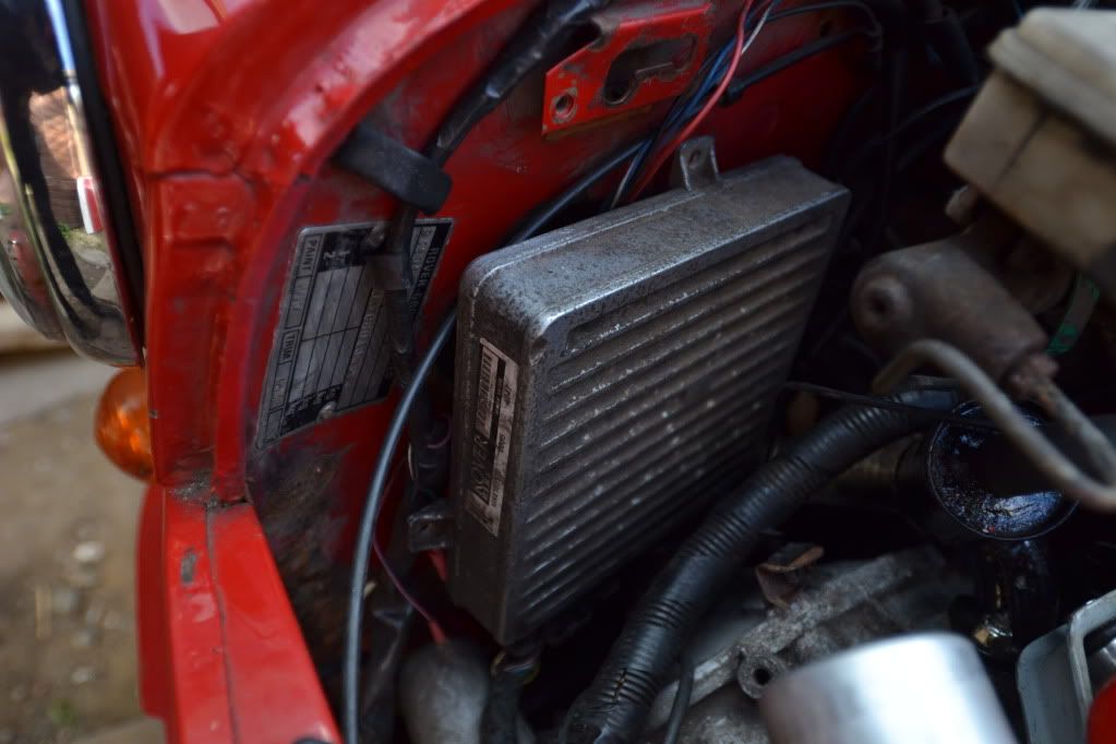

Need to mount the ECU, was thinking of moving it inside the cabin to free up some space. Not sure how much work this will be.

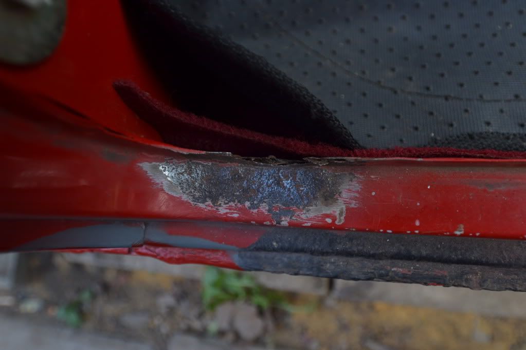

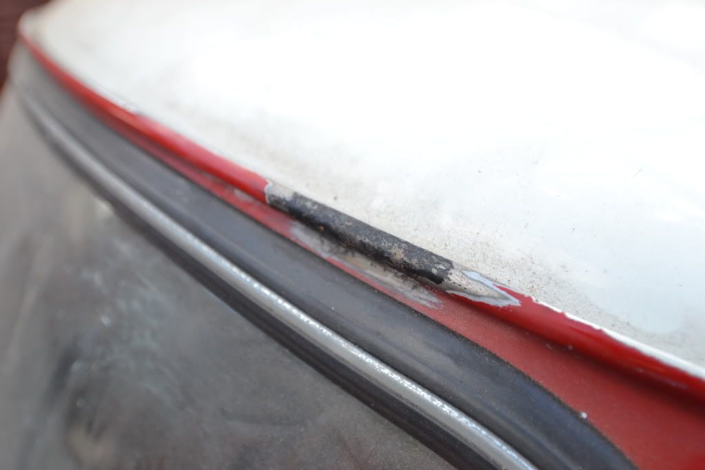

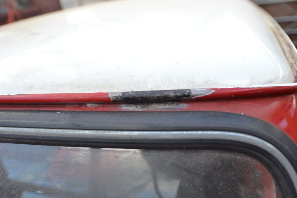

More rust that needs treating on the roof guttering.
