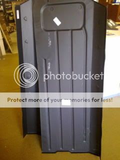

So, with the list of panels to replace, we set of, to a place in Attleborough, called DSNClassics, and came back with a car FULL of panels, luckily a cheap purchase meant we could replace more panels.
[IMG=http://img862.imageshack.us/img862/5313/17092011065.jpg][/IMG]
In that picture there are:
Inner wings x2
Outer wings x2
Full floor pans x2
A panels x 2
Door skins x2

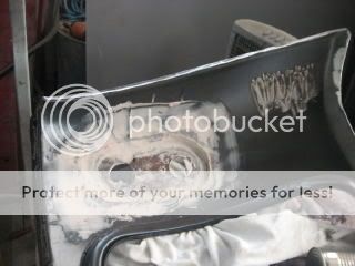

As you can see, in this picture, the doors are fairly battered,
[IMG=http://img194.imageshack.us/img194/6088/p9180222.jpg][/IMG]
A simple door skin, and a few 100 saved later

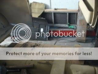

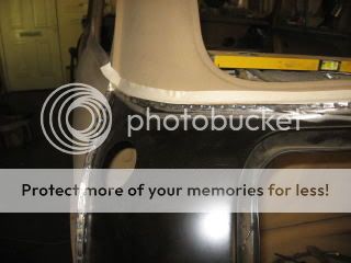

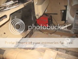

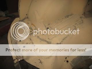

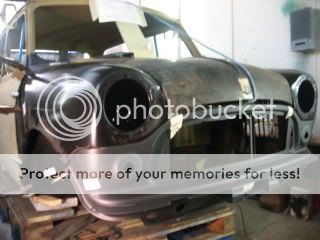

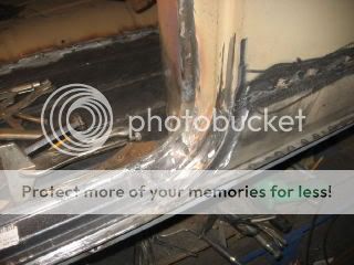

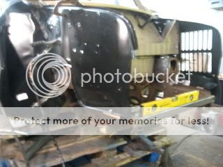

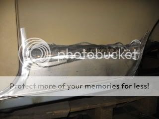

I still havn't caught up to where I am now, but when we got the Mini in its current home, seeming how the doors now fit the hole, we braced it up (using a golf club carrier :P) And started on the front.
Because we decided to chop the wings of before shock blasting, the front wasnt much hassle to get off.

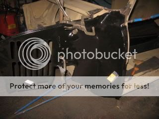

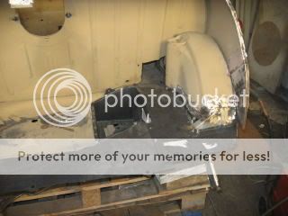

So, as the front was fixed, I cleaned the subframe to line the inner-wings up
And the finished product from the inside :)

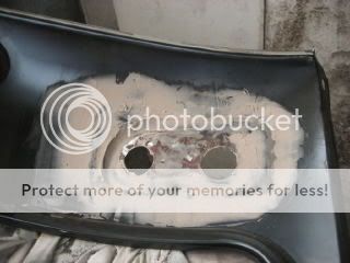

And with the front panel and repaired bonnet on -

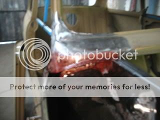

Once the front was sorted, the window screen corners where repaired.
Edited by Thorpsta, 06 June 2013 - 10:46 AM.

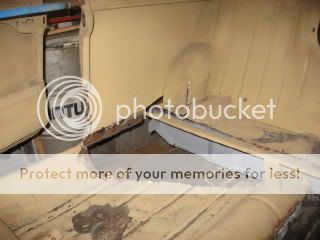

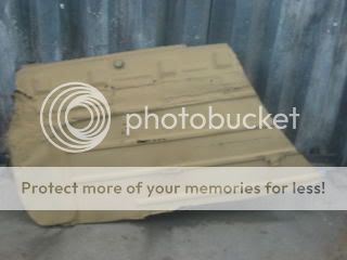

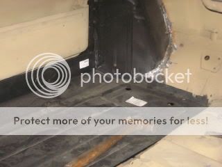

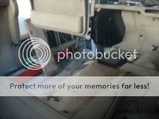

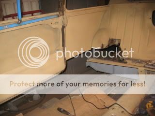

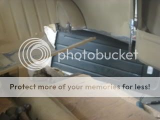

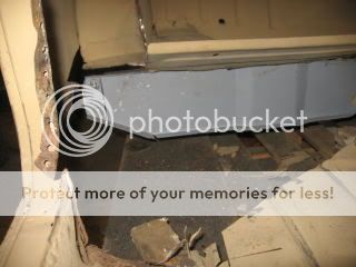

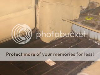

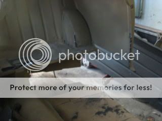

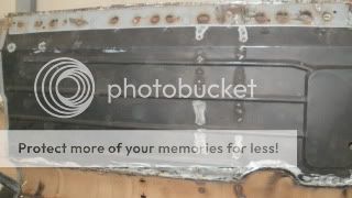

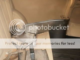

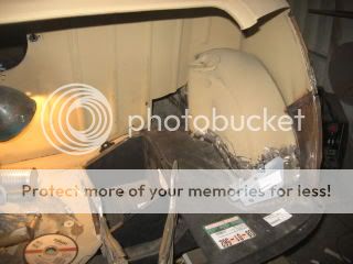

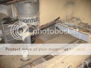

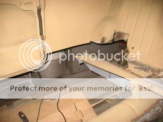

With the front all squared up, it was time to start on the floor pans, we started with with the left hand floor pan.. unfortunatly, we destroyed the back seat passenger pocket, so we had to make a new one, luckily, the back seats needed a new patch aswell
Onto the floor pans
And the final product (in the back)
Gonna leave it there for tonight, I'll finish the rest tomorrow, take care :)

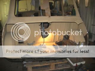

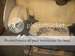

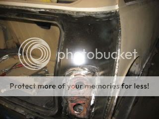

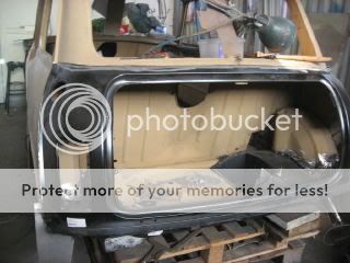

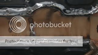

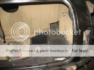

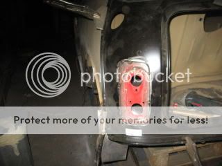

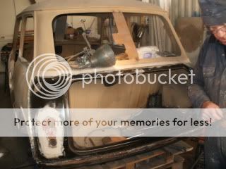

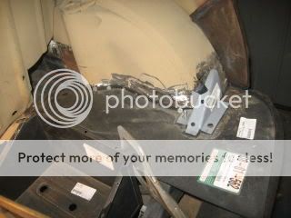

Hey everyone, time to update my thread, the back panel is on, and so is the boot floor, just some underside welding left.
I didn't do this part, so I'm not sure in what order they where done, I'll just leave the pictures in the order they where taken/uploaded.

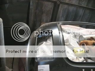

Now, onto the back panel. - Unfortunatley MK1 back panels arn't available, so we used a MK2 with the conversion kits.
And to our luck, the conversion kits, didn't fit the hole >.>
But! We did have an old rusty back panel, so we switched the light apetures over.
Next up, to weld the bottom up, stone chip it, under seal, paint etc.

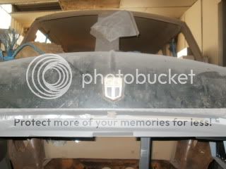

Still struggling to find a MK1 boot, don't want to fork out £200 for a new one, can anyone help?

hi looks like a great project i have a set of those mk 1 rear light panels and are they hard to fit? how did you get them level? also for your boot floor maybe try old skool minis? http://www.oldskoolminis.co.uk cheers tom
Unfortunatly our conversion kit didn't fit, but we had a old mk1 panel laying around so we cut it up, try to make sure your conversion fits before you do any real work, they should just slot in, and line up anyway, i dont know how to explain it, if you get the sides to touch on all 4 sides, and make it flat (as if you was to rub it from the panel to the apeture) there shouldnt be a bump, I cant remember how we did ours that well >.< just make sure you check it fits first

This may help you with your boot lid problem!
http://www.theminifo...l-to-mk1-style/
We have considered it :P But apparantly it rusts from the inside?
#12 leaky
leaky
    Iv never hit a penguin in the face with a casserole
  • 6,890 posts
  • Location: Costa Del Tadley
  • Local Club: Basingstoke Mini Club
Posted 12 February 2012 - 12:40 PM
I cant comment on that as I'v not got one. Pretty much anything on a mini rusts anyway and I'm sure it cant be that bad if done properly. I would rather buy a boot lid for a tenner and that for £15 and fit that and have it rust in 5 years time then spend £200 on a mk1 boot lid that will still rust anyway but just may take a couple of years longer.

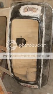

I'm back with a small update :) - I was playing with the camera settings and managed to get HD pictures, When i took these I set it to the wrong format without checking >.<

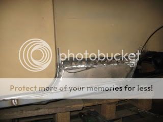

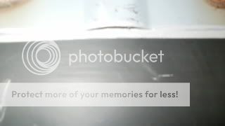

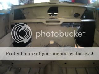

Back panels and lights are finally finished, seam sealed and such,
Now to just finish the passanger bin, it wasn't quite right, tomorrow we'll be turning it over so expect some pictures, I am going to a party tomorrow so they may or may not be up tomorrow :P
Edited by Thorpsta, 06 June 2013 - 10:48 AM.

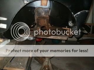

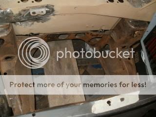

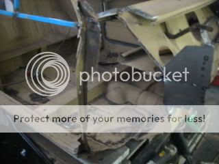

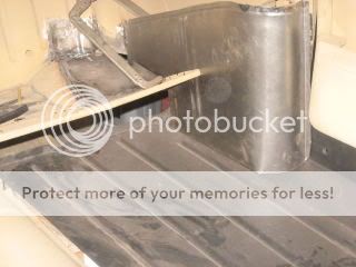

Well, It's on its side, that was fairly..easy, I'll post a youtube video showing that soon.

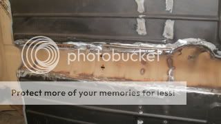

The underside is welded up, and grinded down, just need some stone chip and paint!
Still waiting to get the pictures and other camera >.< So I took some on my camera, unfortunatly it's not that great.
Seam seal
