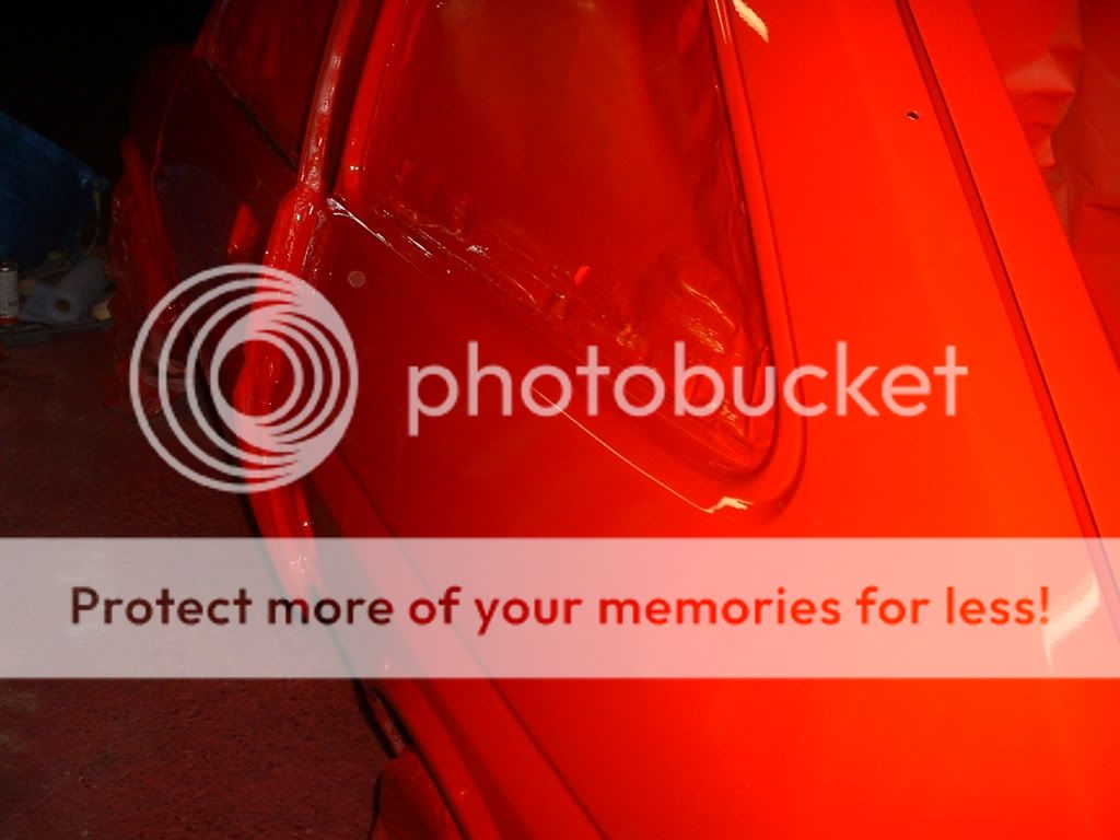

Heh heh!! I wouldn't even consider painting a car for someone else as a paying job, I'm not good enough!!!
I did do an xr2 for a mate and that turned out ok, I think he gave me £100 to cover my costs(some would say he was robbed!!)
There's people who I would trust to paint a car for me and they're around the £800-£1000 mark.

I'd say that's a pretty good job myself. My mini was resprayed orange just before i bought it. It cost the bloke £800 and i can see why it was so cheap, there are a few runs in the paint and some random cracks. Buy cheap, buy twice.

Posted 12 March 2012 - 06:39 PM
Trust me............its not as good as it looks!!
Note the fly on the rear 1/4.

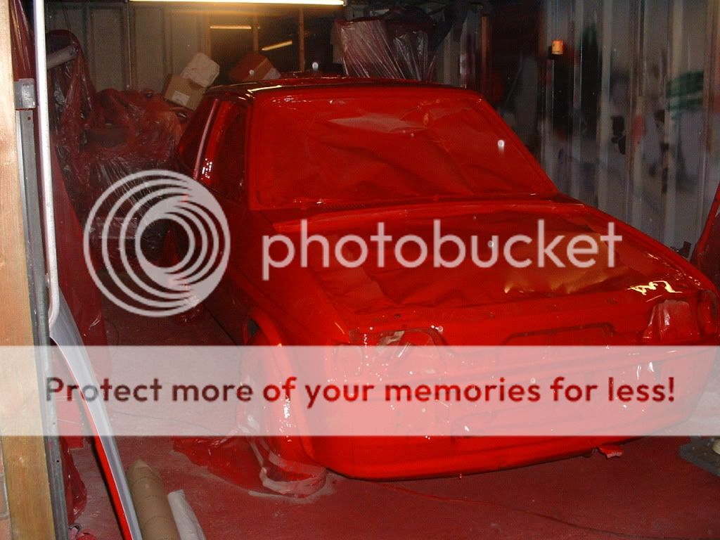

Posted 12 March 2012 - 10:28 PM
Before you get this..
This happens(twice)
