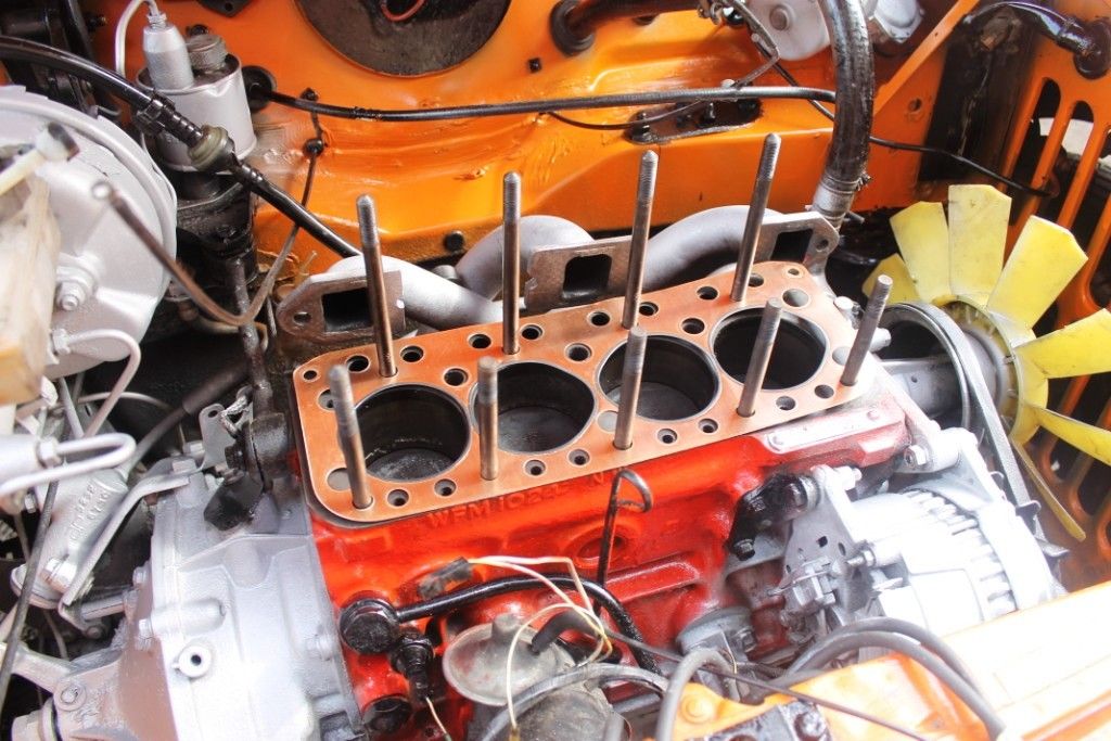

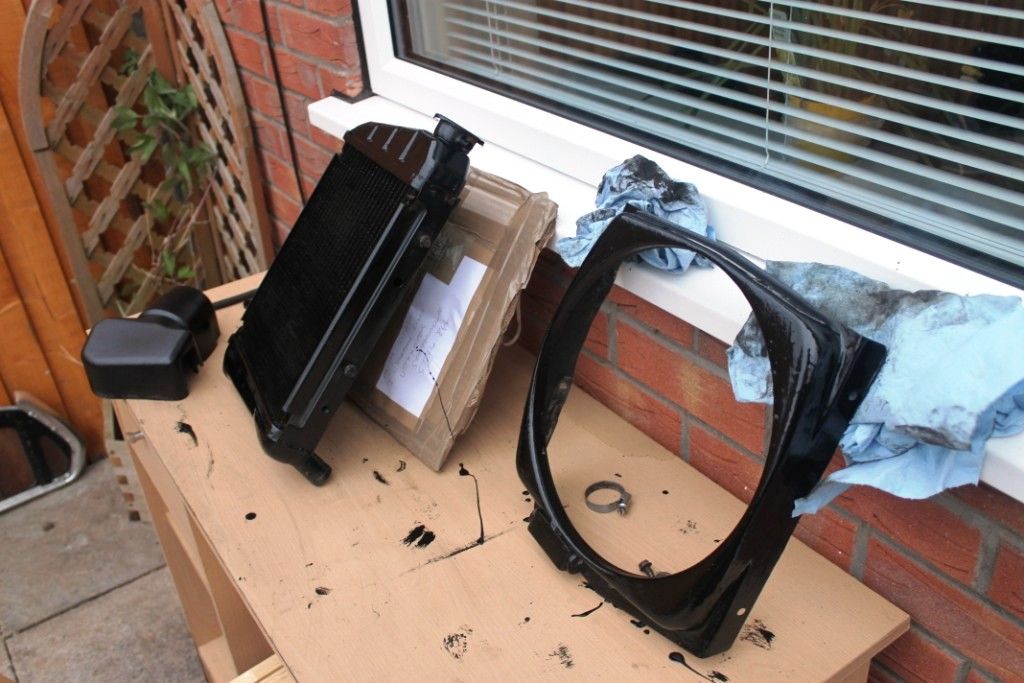

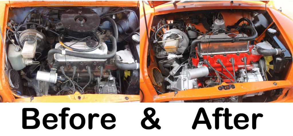

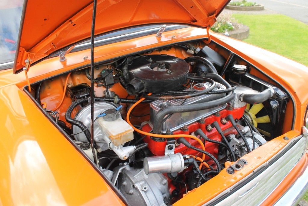

Shortly after buying this mini the fan belt snapped so first job was to replace this.
When doing this I decided that the engine bay seriously let down the rest of the car so I decided to get busy. First Job was to remove radiatior and surround and clean these up with some fresh black paint.
Then I decided that I would clean the whole engine with Gunk, and after a few goes and some scrubbing it started looking very clean indeed removing most of the dust and grime. I stripped the head and carbs off and covered the engine. I then prepared and sprayed the bulkhead and inner wings to match the rest of the car. I then refurbished the cylinder head over night whilst the paint dried including a nice lick of red engine paint. The next day I fitted a new head gasket (although it had only just had one) and then started to rebuild the engine, cleaning up any parts when fitting them back on the engine. I.e. spraying exhaust manifold silver, cleaning carb. This cleaned up the engine bay loads. I also added new orange vacuum pipe, some cable conduit etc
The enginebay clean up was done in 2 whole days.. I was very pleased with the result as although not a show car it looked great. (before and after shots attached). It doesn't even look like the same car.
Oh plus not forgetting the new shiny rocker cover to finish it off!

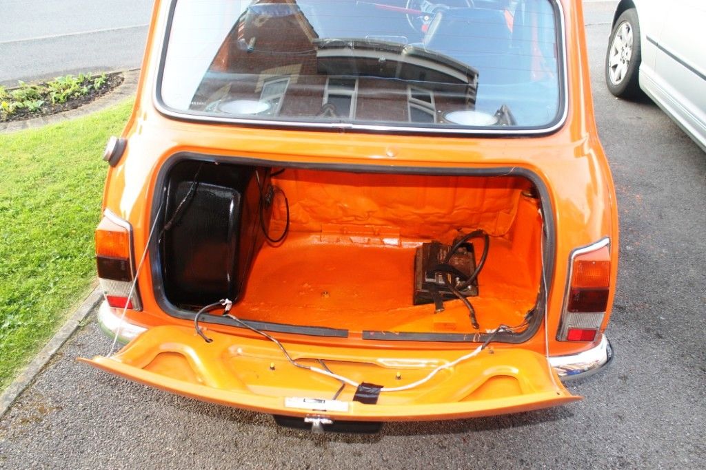

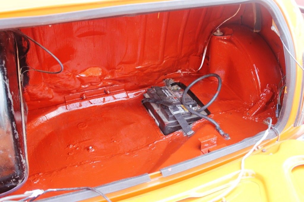

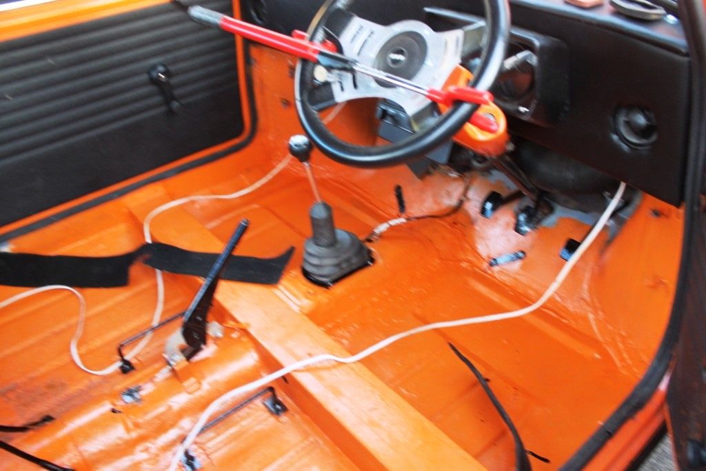

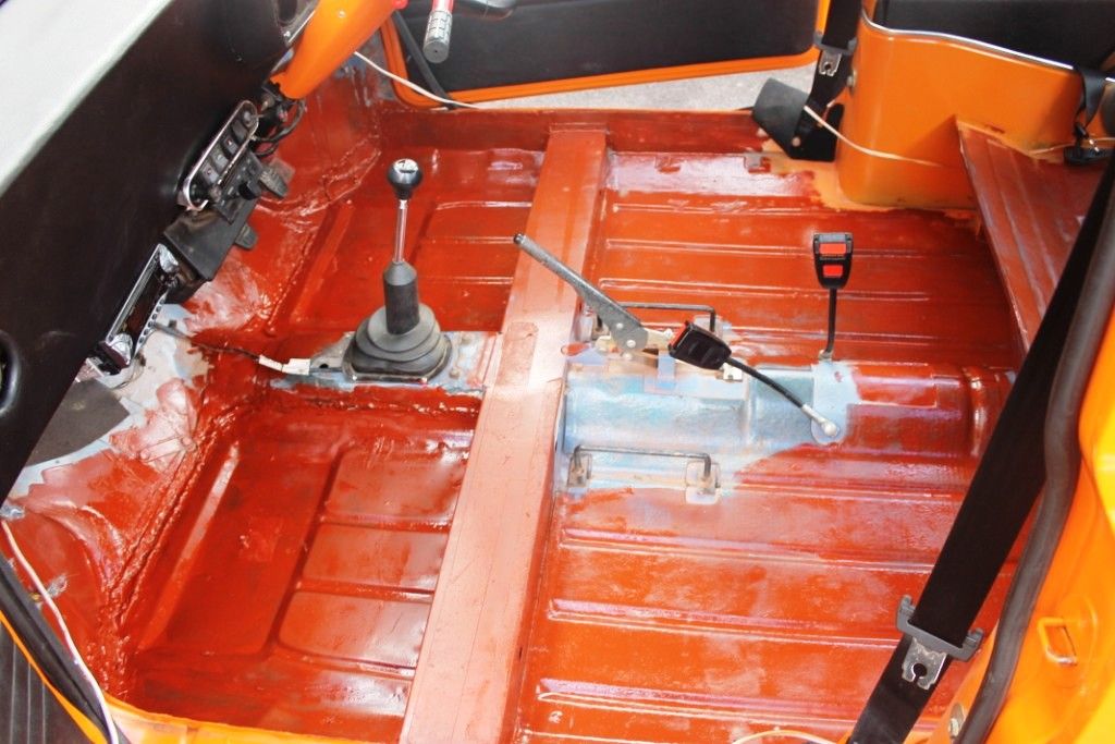

I then decided with all these new panels and lack of rust they needed protection and also colour matching so I cleaned up, prepared, red oxided the floors, boot and underneath and then gave a nice thick coat or matching orange paint. I also prepared and gave the petrol tank a nice coat of black.
I spent alot of time underneath cleaning and rubbing down before painting and was very pleased with the condition of the shell and subframe.
Here are some photos of during and after the paintwork:
I also gave subframe a thick coat of waxoil to keep it like new hopefully and the underneath a thin coat (as I only had black). I will add another layer once I buy a big tin of clear stuff.
Edited by msisask1, 10 August 2012 - 06:53 PM.

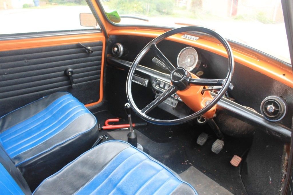

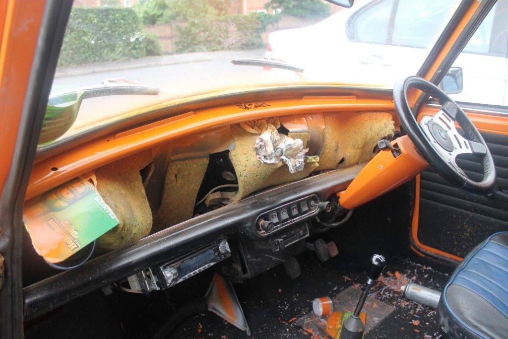

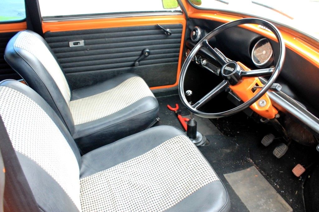

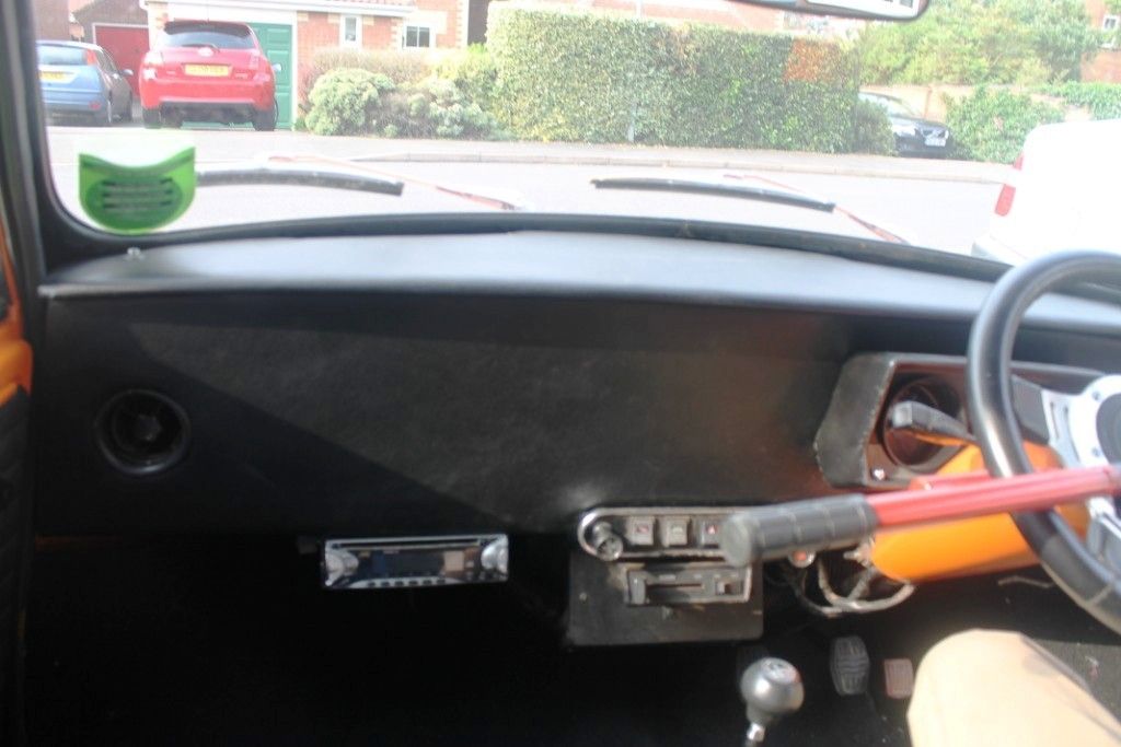

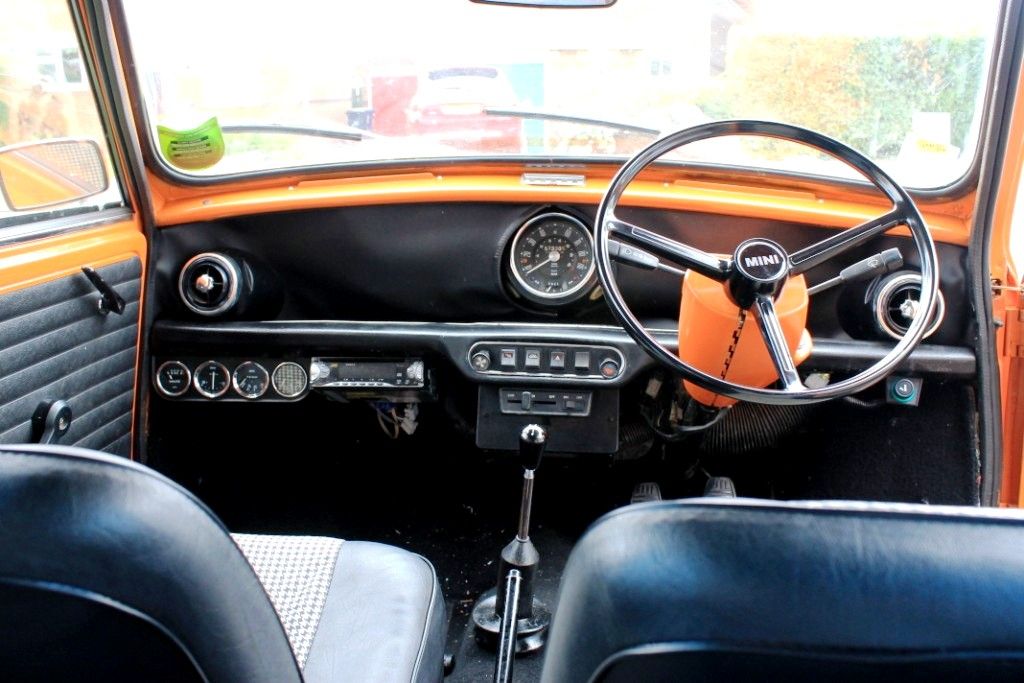

After completing the engine bay and paintwork my next job was to get the interior to my liking.

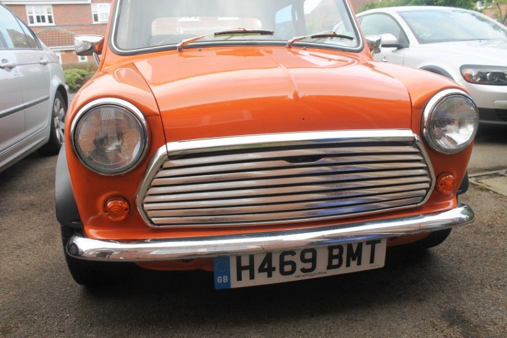

I also sourced a chrome front grille for £1 from ebay and collected from near me. Bargain!
After having 2 previous minis with 3 clock and 2 clock dials I wanted to go for a mk1 centre clock style.
So I set to work.. (sorry PastRecedes but the dashboard was removed).
I then added steering wheel and mk1 seats.
BEFORE
AFTER
If anyone has a matching rear seat (Black houndstooth design) they want to sell please PM me as I currently only have a plain black one and am looking for a matching one
Edited by msisask1, 10 August 2012 - 07:18 PM.

Posted 10 August 2012 - 09:00 PM
only thing i see wrong is .. that you have a 998 head gasket on a 1275 motor !!!
other than that looks great
