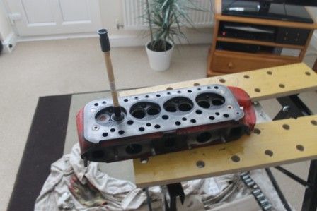

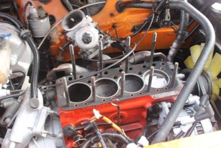

Thanks for the comments.. Although you have me thinking about the head gasket now.
I did all the engine stuff in a weekend so i placed the head gasket on, took a photo and popped inside to get the head.. Didnt really think anymore. The gasket didnt seem to go over the cylinder.. I would have thght it would be obviously undersized (or maybe it was)
Guess I best reserve another weekend to get it swapped over. will it do it any harm running the engine with the 998 gasket?

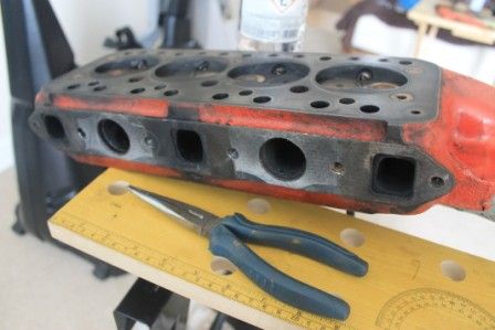

Job one complete
Guide here http://www.theminifo...al-with-photos/
and parts for the 2nd head refurbishment. Got a couple of extra bits too whilst I was ordering :D

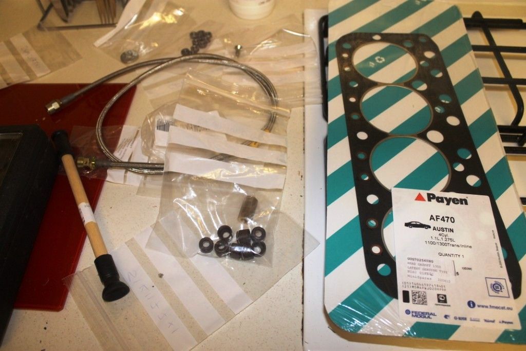

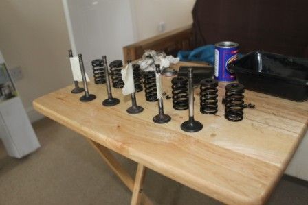

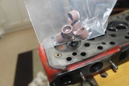

Posted 20 August 2012 - 08:31 PM

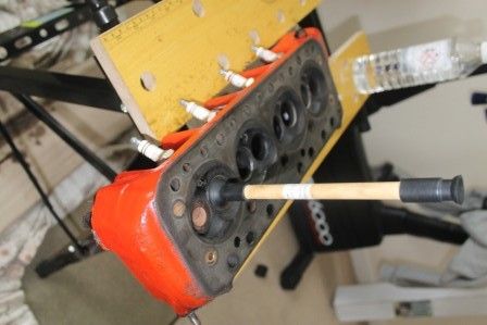

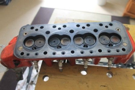

I have redone the engine, this time with the right gasket.
As this is the second time i've done this I did the following:
Re-lapped valves
Fitted MPI valve seals (the good quality versions)
Removed and replaced all manifold studs
Fitted new gold manifold studs
Fitted new head gasket
New exhaust gasket
New rocker gasket
New rocker cover t-bar grommets
Tightened spring on carb
Topped up dash pot
Adjusted accelerator cable
Fitted oil pressure pipe (but not connected to engine)
I did fit a cable for the oil gauge but the T-peice adaptor just stripped when trying to put it in.. not sure if the hole need re-tapping so I put the old oil sensor back in.
Here are some photos.. gasket looks obvious now.
Now the engine is running better than ever and no smoke on start-up! :)

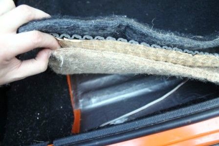

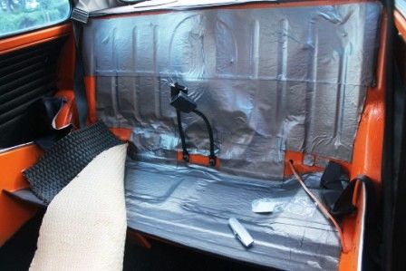

Posted 26 August 2012 - 08:41 PM

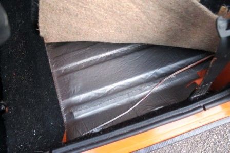

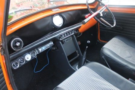

This weekend I added sound insulation in the form of flashtape, rear carpet underlay (turned out to be good quality) and to top it off nice new set of velour mats. It's much quieter, comfier and better looking although will get some Silent Coat or Dynamat for the bulkhead and bonnet as I think this is the loudest part.
I also:
plugged in the oil gauge, wired volt gauge and temp gauge
Tightened alternator as washer on it was too small and was slipping (noticed after I fitted volt gauge)
Adjusted the bent part on the underside of the radiator cap as the cap was very loose. nice tight fit again now.
Bought an up-rated bottom engine mount and gearbox bracket but didn't get round to it as I headed to a car show instead..
Overall not a bad weekend. Here are some photos of the insulation and car show:
Plenty of layers on top of the flash tape to reduce the noise..
Back Seat..
And then.. onto the show!
Edited by Sisco, 26 August 2012 - 08:42 PM.

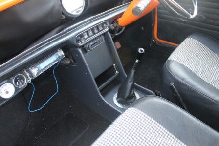

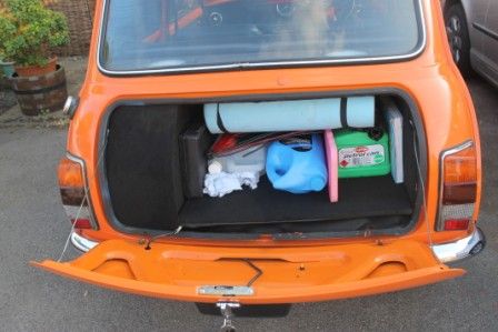

Last weekend I was at Uttoxeter's Mini Fest.
Bought a Boot Liner to tidy up the boot (although still full of emergency supplies)
And then a Centre Console..

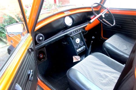

My plan is to move the cd player (or a new one) to the centre console with the 3 clocks above it (all working now - Temp Gauge, Oil Pressure Gauge and Voltmeter.) I also plan to put some speakers in pods up front with tweeters in the dash liner. Here is a photoshop of my plan.
Think it will look tidier and speakers should be better up front, I will take the parcel shelf ones out and replace with a solid parcel shelf to reduce noise from the exhaust a little.

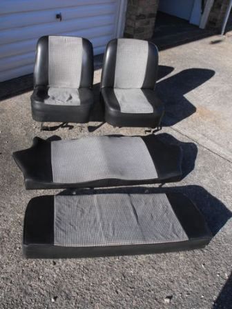

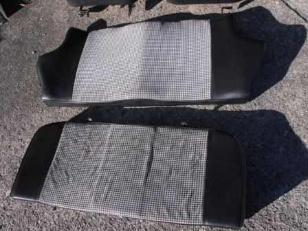

Also spend the whole of Minifest looking for a rear seat to match.. found some with the pattern but brown and green only. Was fed up.. then went on ebay to find a full set going for £30 only listed a few hours ago so BUY IT NOW, BUY IT NOW, BUY IT NOW (I've been searching for a matching back seat for 2 months solid). Went to pick them up last night.. a 3 hour roadtrip after work.
Here is a pic of them.. the front seats are better condition than my already nearly perfect ones. They looks like they are out of the factory. Leather is immaculate and foams are like new, don't even feel like they've been sat on. Photos don't really do them justice but will get some better photos up of them in the car at the weekend.
I am a happy man and slept well last night.. knowing my search is over!
Edited by Sisco, 05 September 2012 - 09:14 PM.
