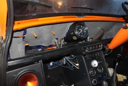

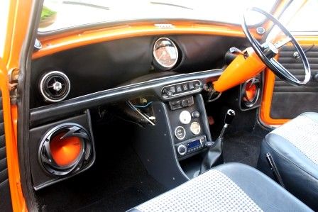

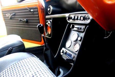

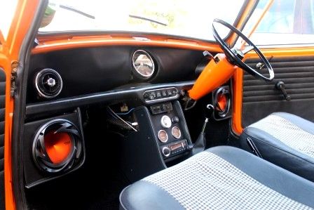

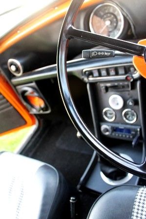

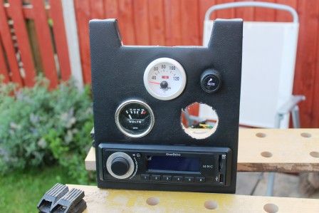

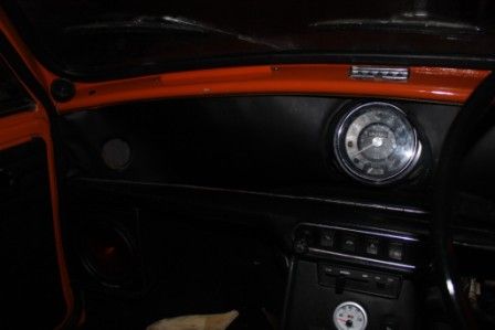

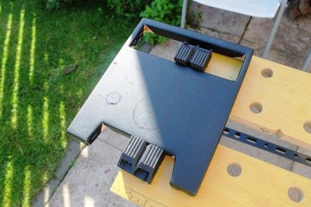

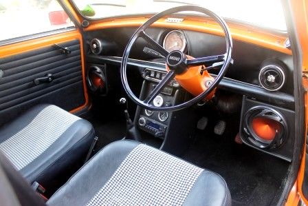

Before anyone give me abuse for the choice of speakers, I wanted low budget components to get some sound up front as I only drive this the occasional weekend and to shows and didnt want to spend a fortune (plus the colour scheme may have had something to do with my choice). They are still much better than the single speakers in the parcel shelf. If I decide to use this as my daily drive I will likely upgrade.

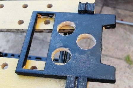

Preparing the centre console.
All fitted and wired up:

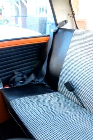

Plus some photos of the now matching back seat (tinted side windows make it look blue)

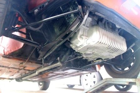

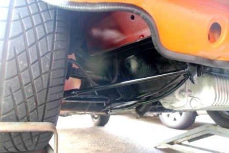

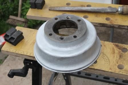

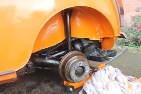

Brakes failed on me the other weekend so replace wheel cylinders and brake shoes
and cleaned up the drum

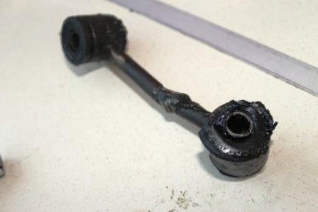

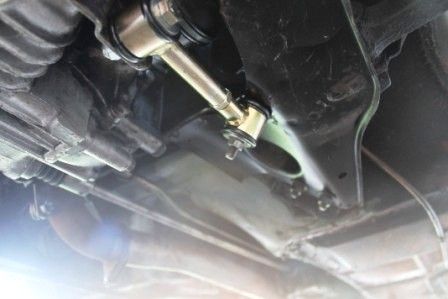

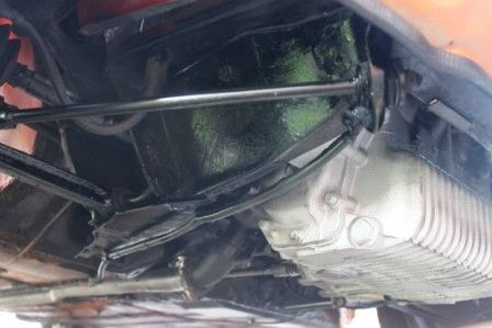

Removed the engine mount which had been welded..
and fitted a new one with poly bushes

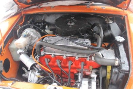

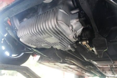

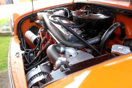

Then while I was under there used some Junk to clean all the oil off the engine, cleaned with brush, white spirit and sand paper and gave it a coat of silver spray.

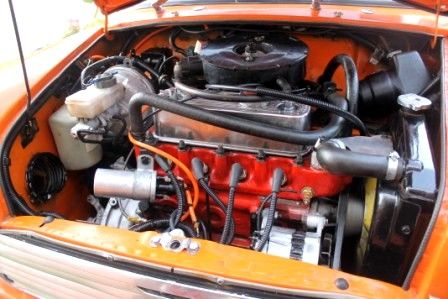

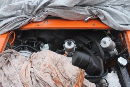

Then cleaned up subframe, tie bars, steering rack in the same way. Overall its in good condition under there! kept protected by the oil. There was only slight surface rust to clean up with some wire wool. I then sprayed and painted all of this with a nice fresh lick of black paint, will probably cover the subframe in waxoil tomorrow once dry for further protection.
and took some nice shots of the engine bay at the moment (have cleaned up a few bits and added a chrome fuse cover and new radiator cap.
The front underneath is now looking pretty good underneath. Next job I want to do is strip under all the arches, paint orange to match the rest of the car and the clear waxoil over the top. Then the underneath should all look pretty good. Not going for concours but wanting everything to be as good as I can get it without completely stripping it down.

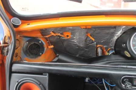

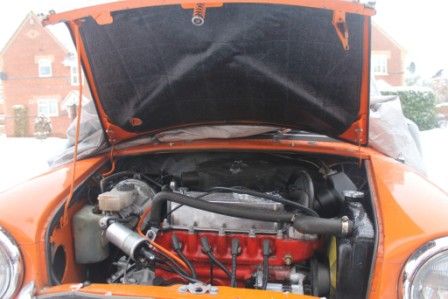

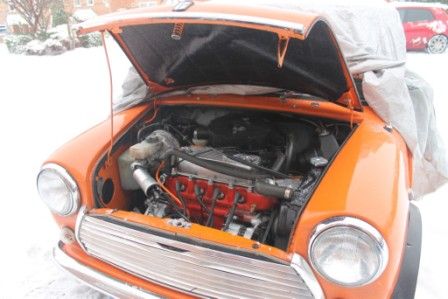

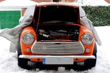

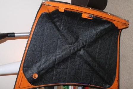

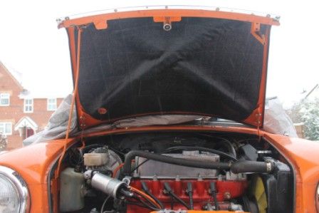

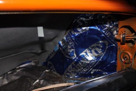

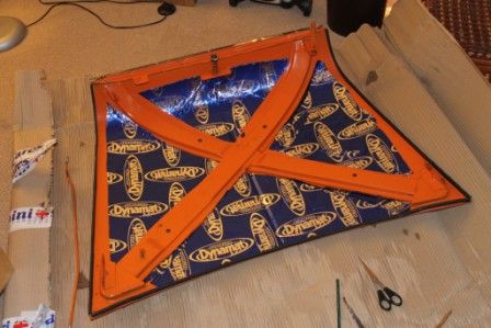

The last week I have spent some time trying to block out some of the engine noise.
I added a layer of dynamat to the bonnet and then covered this with newton commercials under bonnet kit; which I have to say is great quality and looks great. Hopefully it will protect the dynamat from too much heat as the pvc is quite thick. If not then I will replace it with hoodliner. I also added the newton commercial bulkhead insulation. With both of these fitted the engine bay looks pretty tidy too.
And a nice shot of the mini with it's winter coat!
#39

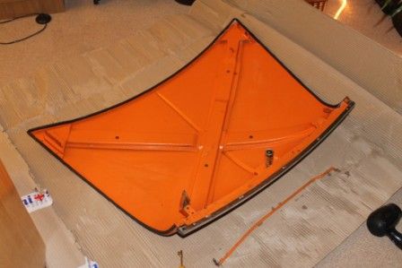

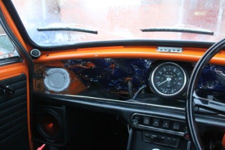

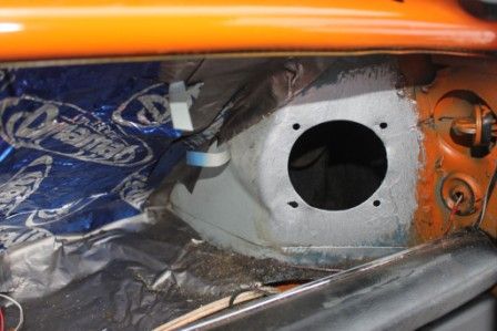

Posted 20 January 2013 - 11:20 AM

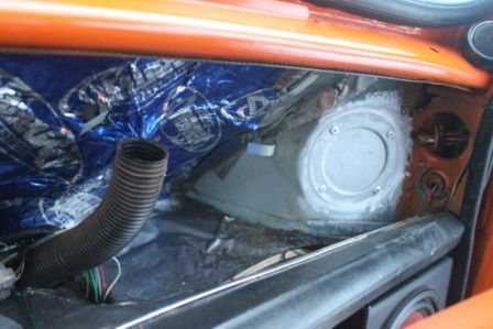

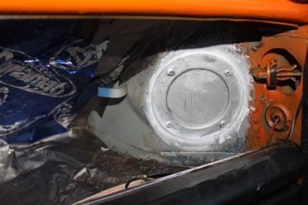

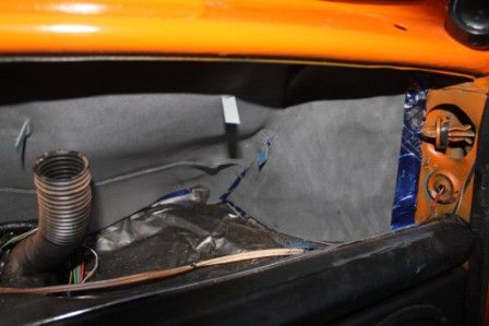

The air vents were a pain to remove so I drilled off the screwheads and then tapped them out with a screwdriver which knocked the back nut off the panel.
I cleaned the holes up as there was some slight rust although not too bad and coated with some silver hammerite.
I then silicone sealed the plates on and rivetted them and added silicone around them to seal them.
I added a layer of dynamat all over the current flash tape and over the blocked off vents followed by some closed cell foam and then topped with the standard felt insulation and dash liners (need to change these to some new ones without holes now). When the weather improves I will get some waxoil under the arch on the new plate to protect it.
Just need the weather to warm up so I can see if it makes any difference.
The mini looks cold without his coat but the orange looks nice against all the white!
