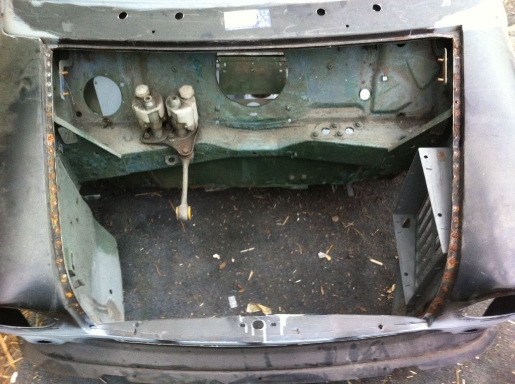

Haven't got it flipped yet took the bonnet back off and stripped a few bits out the engine bay. Welder a still not fixed and I need to finish small areas of welding before it's turned over !
Does anyone know what holes I need and what ones I can weld up on my bulkhead as I'm going with a mk1 loom as per original

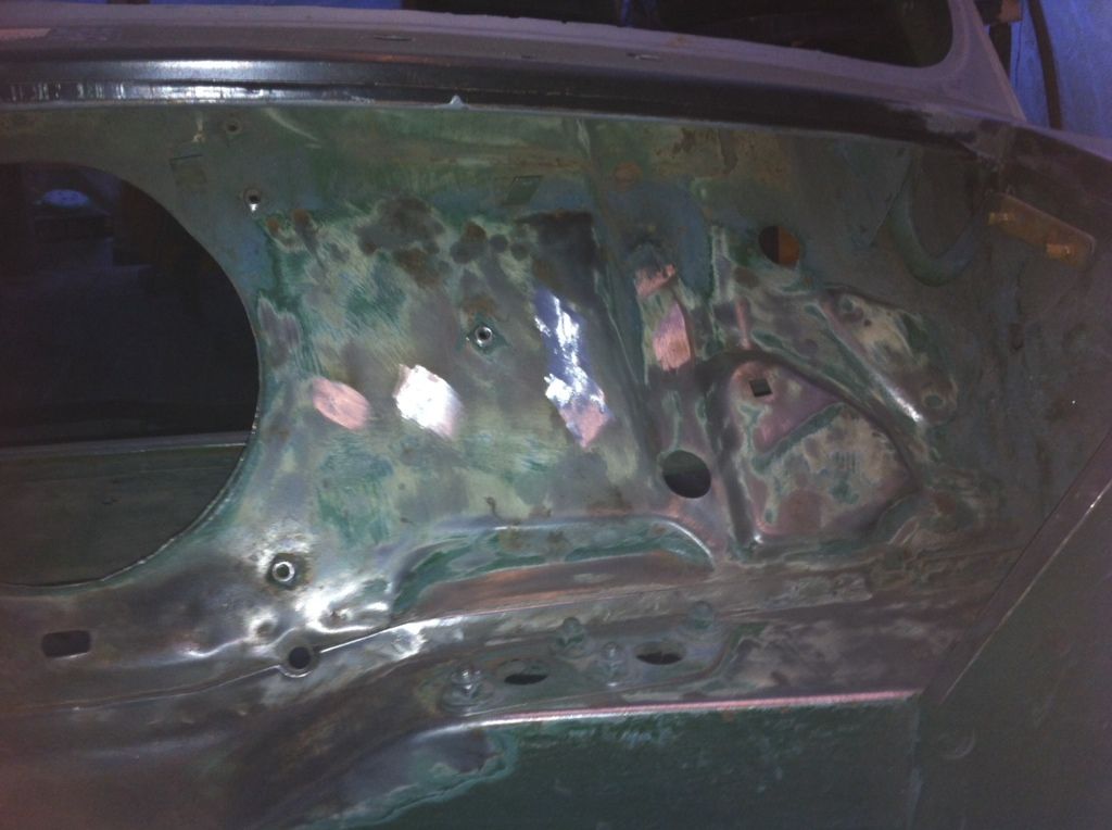

Update !
Sorted this area in front of the arch!
0ABB84C8-CB75-4D56-9645-8D21F3BC5570-317

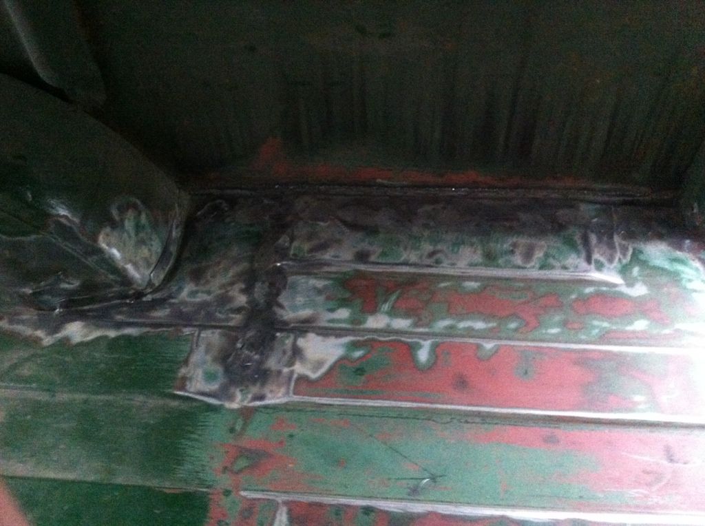

Cut this bit of rust out of the rear quarter d/s and made a patch to go in

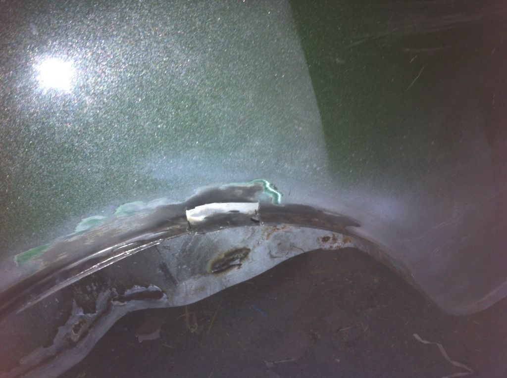

Finished welding the wing plugs up and ground them all down !
685190F2-97BB-451E-8BD4-1A1FA40F7B6A-317

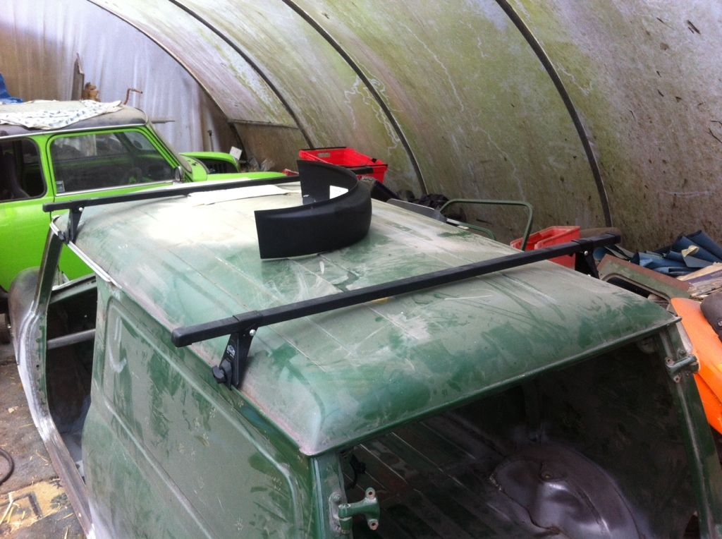

Got the roof bars on ready have put some paper between the bar and roof now to stop any dents

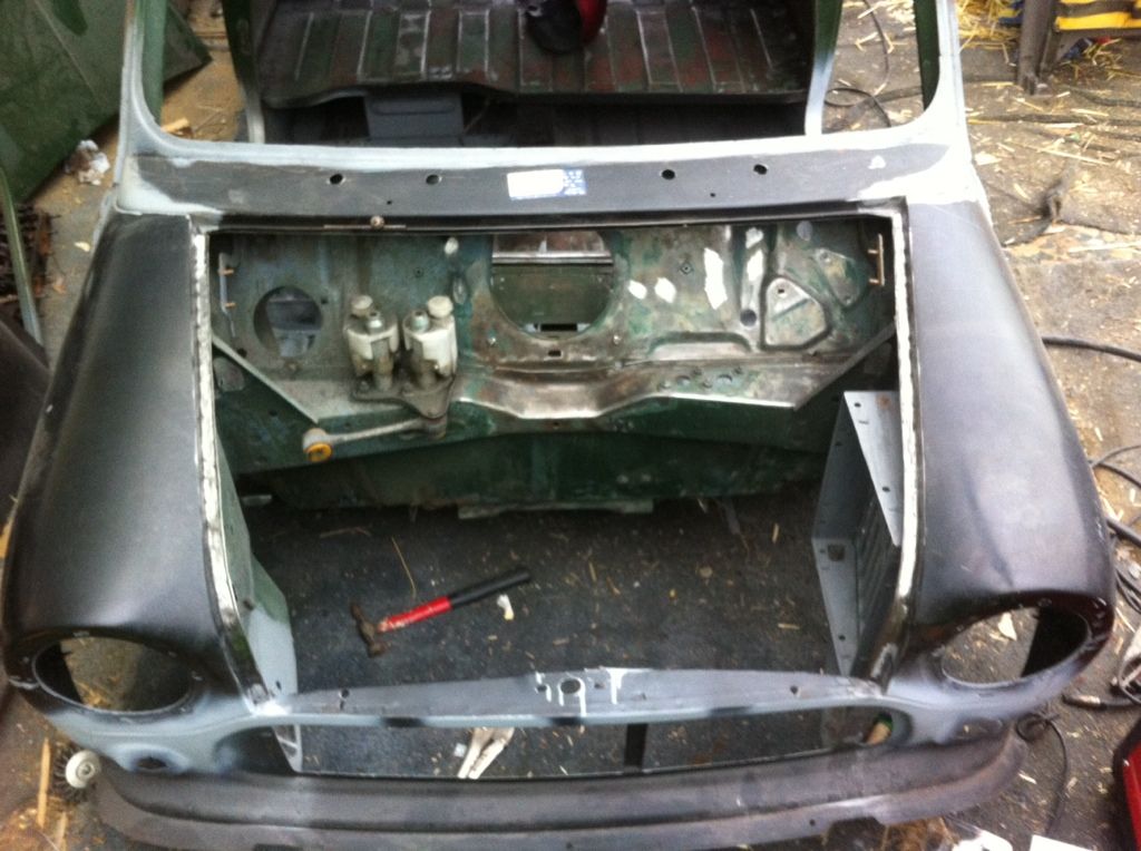

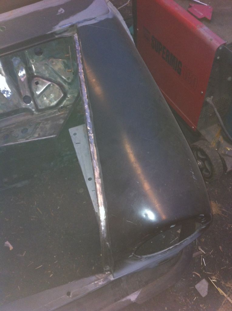

Sorted the other wing join welds! Happy with the front now!
71246ACA-1B6E-4F6A-82FF-3A6D64F1760C-474

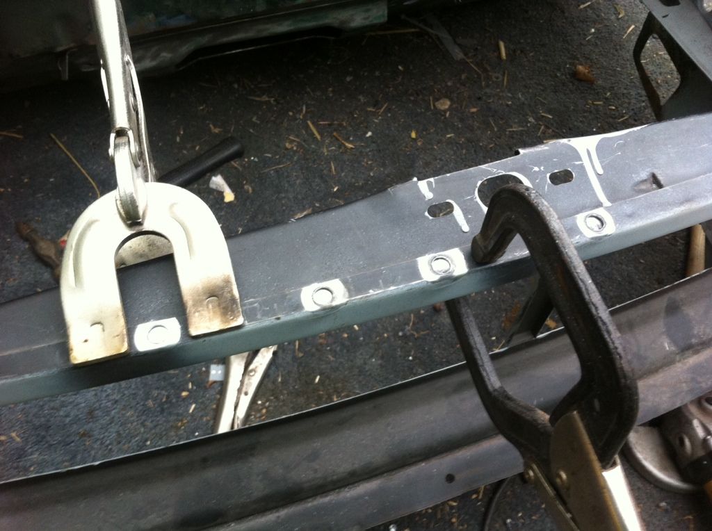

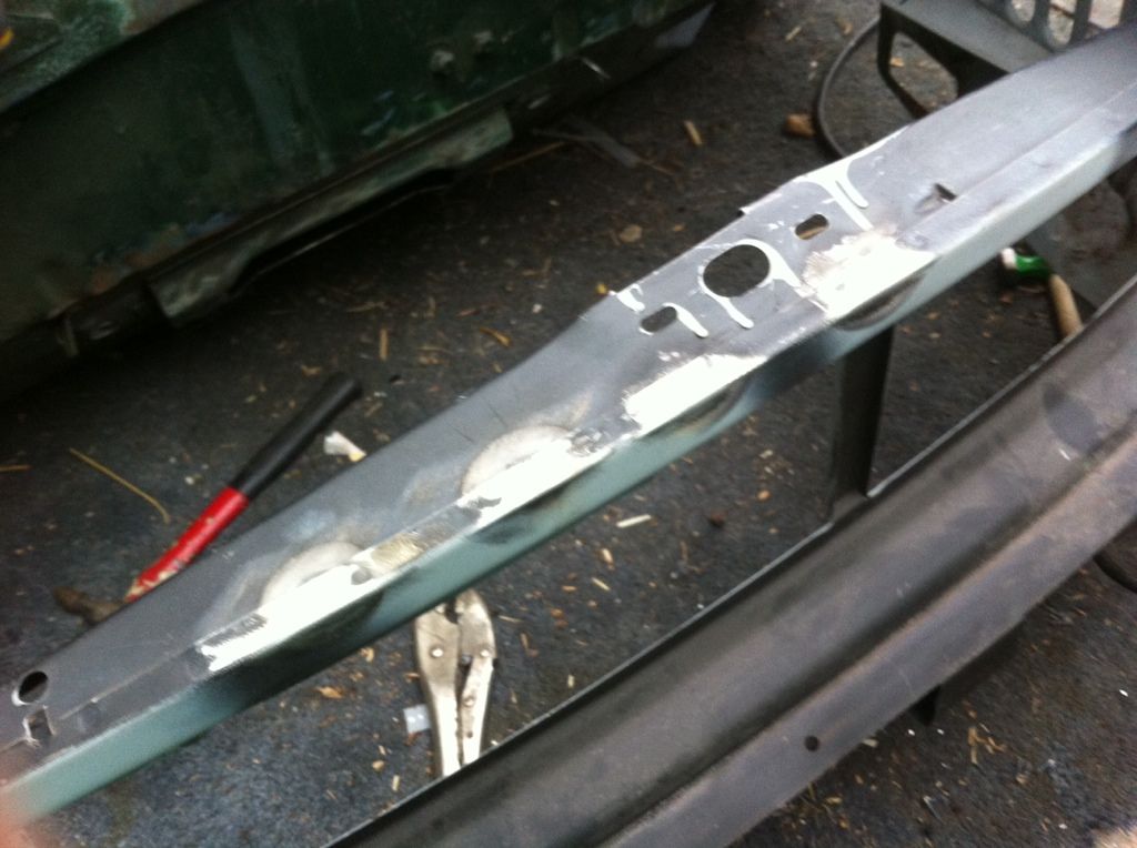

Also sorted a issue with the front panel the spot welds had popped apart shows the quality of non gen panels ! :s good job my grandad leaned on it else I wouldn't of found this issue! So I drilled between the spots and clamped it up
D023A9D8-1717-4311-9D0E-A2AAD6886ACE-474
Welded and ground off smooth!
0AF1AE38-2254-413A-A91F-B0EB2F4BB46B-474
