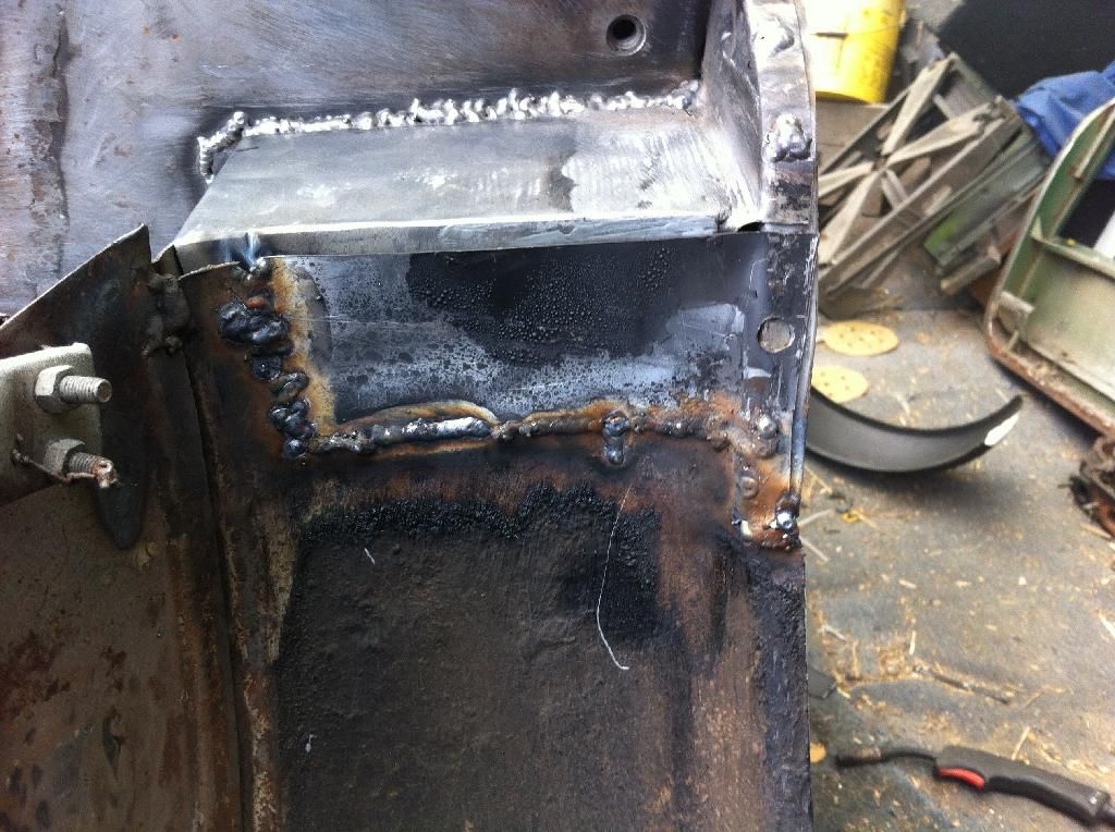

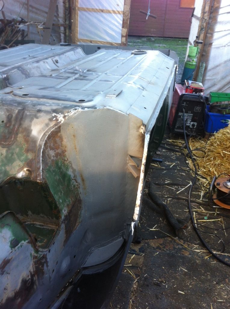

Done lots today ! Started off by welding the repair peice in the d/s arch and grinding it all smooth
1D6D8A24-2E0C-42C7-80F6-24E030F40069-959

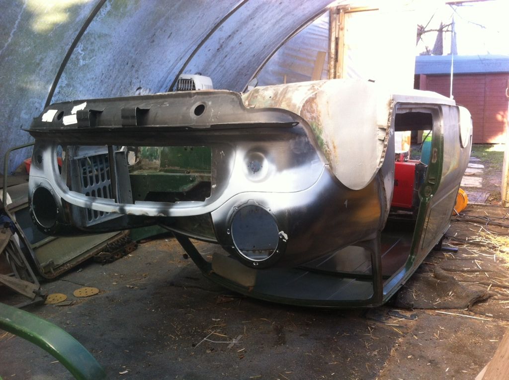

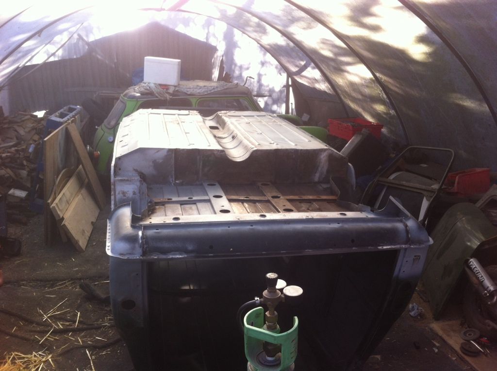

Then all the welding on top that is near anything on the floor was welded so I could finally flip it! The old man gave me a hand and here you go!
D77267F0-1421-4589-B2B3-7B72CFD51E69-959
34540B53-7AE8-42B5-9287-CBF3DAF482C7-959
It is perfect hight to sort out the arches, inner wings and floor the tunnel you need to stand on a box to reach with the grinder lol. I have started doing all the final grinding / welding on the d/s and wire wheeled most of the paint off

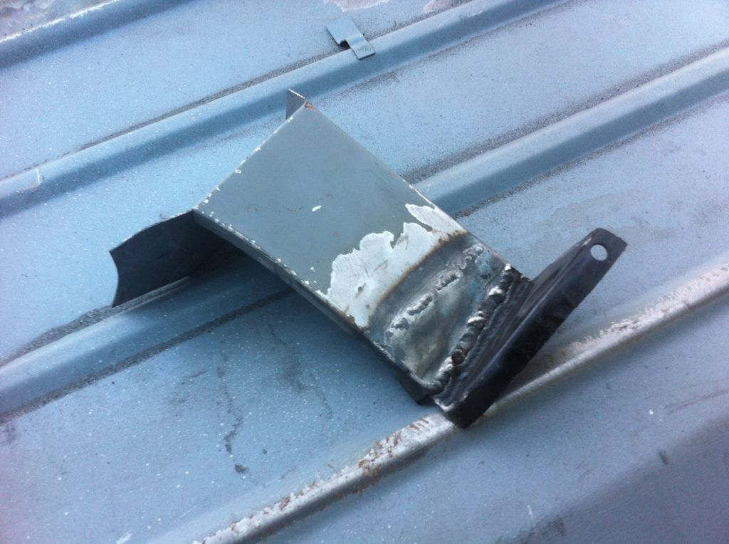

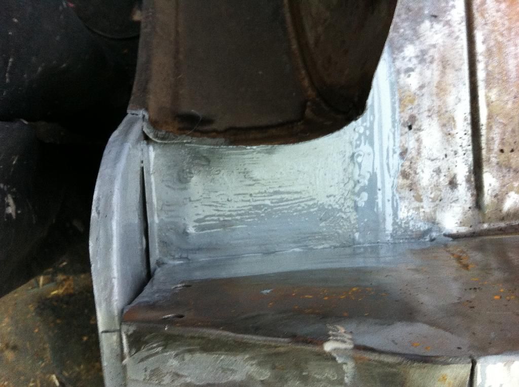

Clamped up
AC06F2B3-551C-470E-9145-C90478B5CCE8-959
Welded from both sides has now been ground off and given a coat of zinc 182

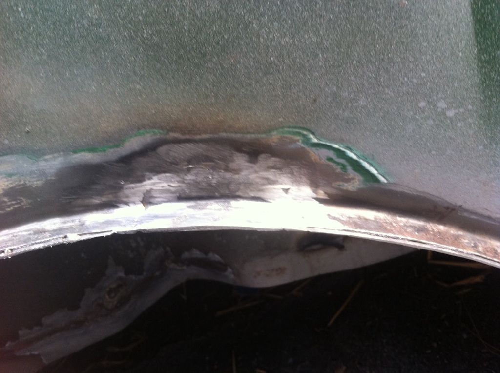

Got the last closer panel nearly done today !
ED2186F0-6633-46CD-A672-1225B62262A3_zps
50B46335-28BB-465F-A581-E669F651E18E_zps
Still need to finish welding and grind it off. Welding a a bit crap as my mask busted again ! I will soon be painting the floor!

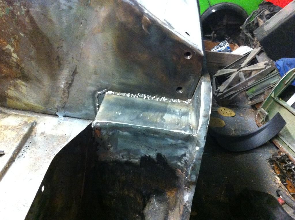

Could only get this finished today !
DEC60C23-B01C-4950-902F-D1CB7E286D90_zps
Don't know when I can do any more work on it I'm getting raped at work! I'm loosing the race !
