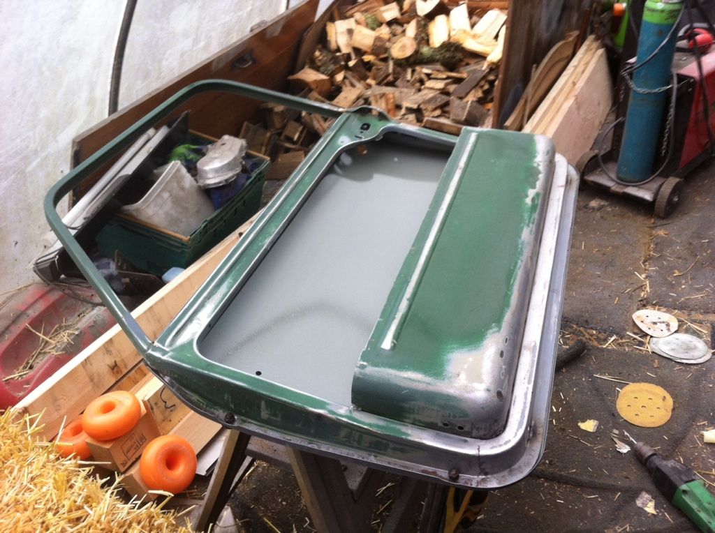

Done a bit today on the door got the skin bolted up to check alignment

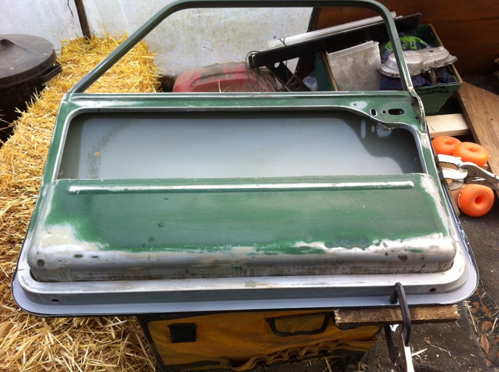

I cleaned off the edge and painted it with zinc 182 to stop the rust when the edge is hammered over.

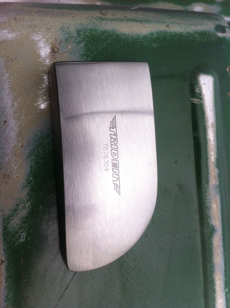

I was going to join the two parts today but went to use my sealer and it had dryed up so got to go buy one ! Then I can use my new dolly I bought at the Nec classic car show !

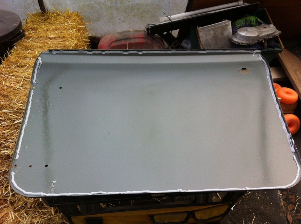

Right got the skin on today! Started off with a bead of sealer around the edge of the skin

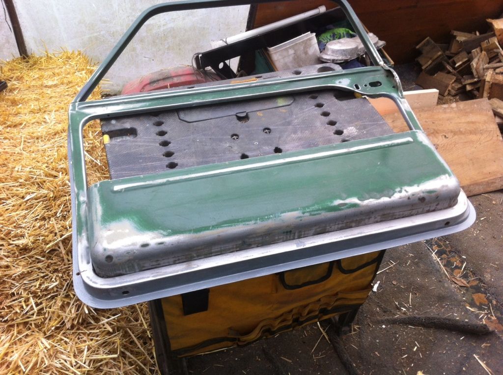

Clamped and bolted up
898C3ADC-99C7-457B-8541-9D397CBA0B39-150

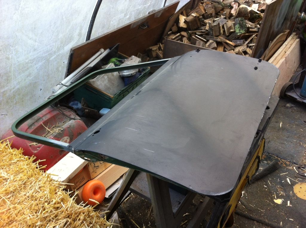

All hammered over without making and dents on the front face
36FA31F3-E2CF-471C-8722-D771EE487B16-150
BEA253C6-BC66-4CDA-A109-42F846442041-150
I will weld the tops and the plug weld in a few days once the sealer has gone off !
