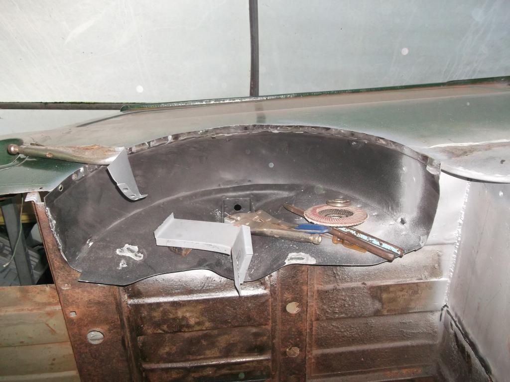

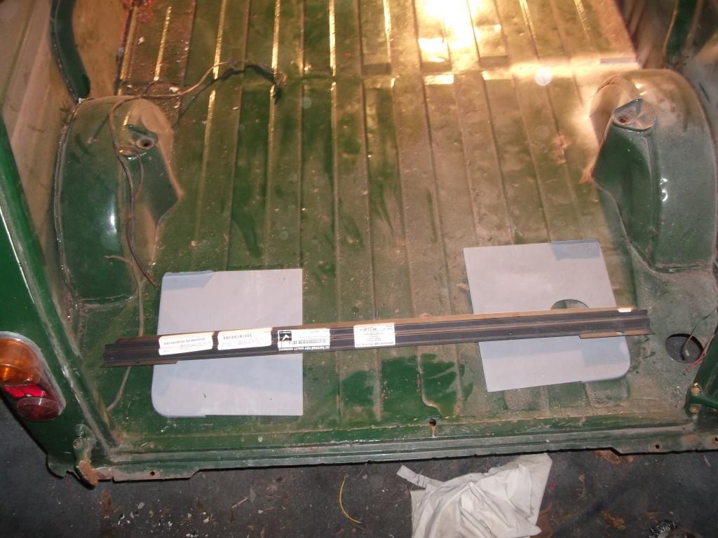

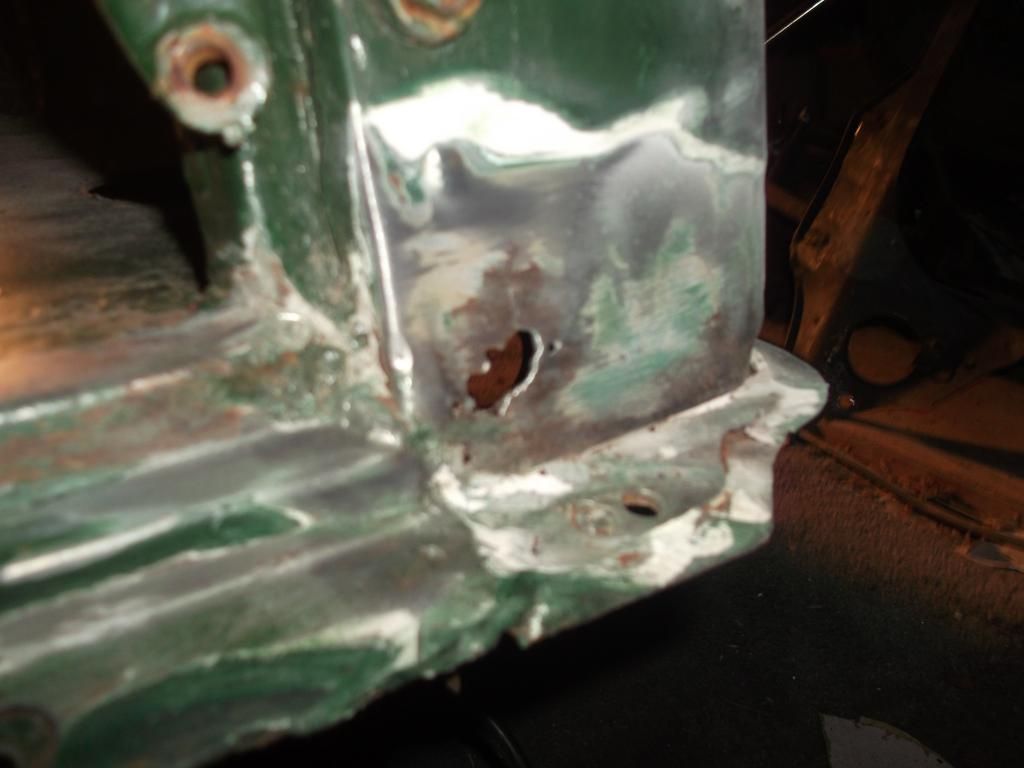

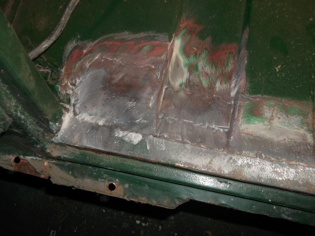

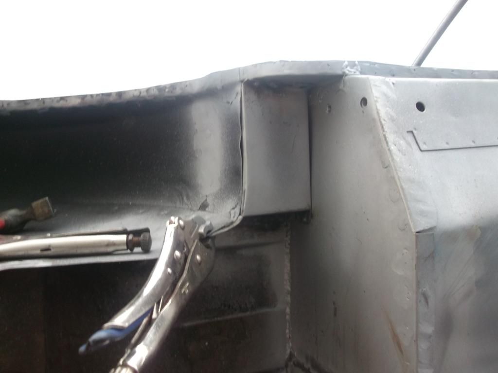

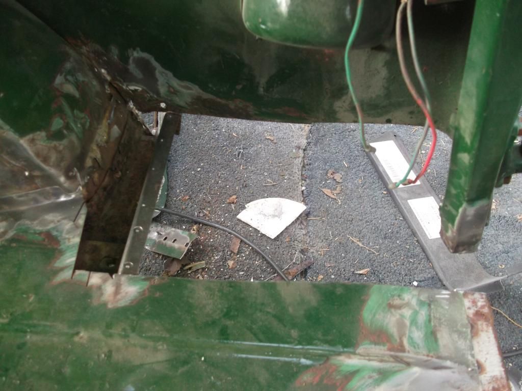

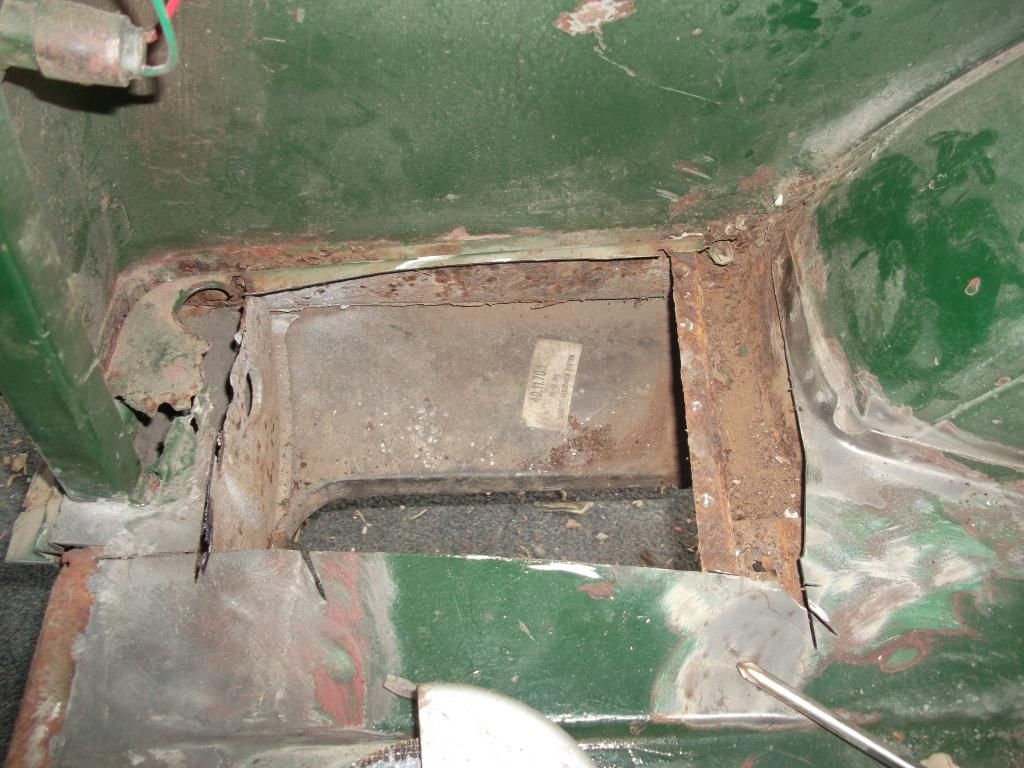

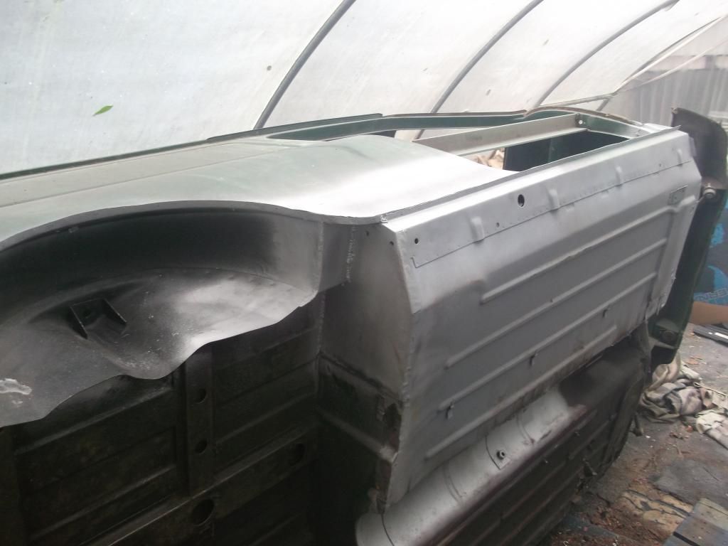

Here is a few pics of work done in the last few days ! been cutting and welding today as well! Just ordered a wheel arch for the drivers side only because if i patch it it will never look as good as a new replacement panel :) Need to roll it over again to remove the arch and the rest of the rear valence closing panel
New panels !
bodge patches!
Removed doorstep
Driverside corner cut out

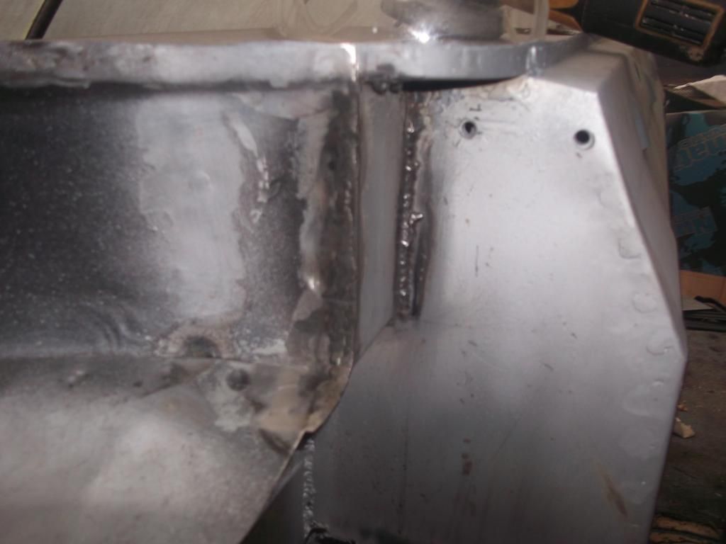

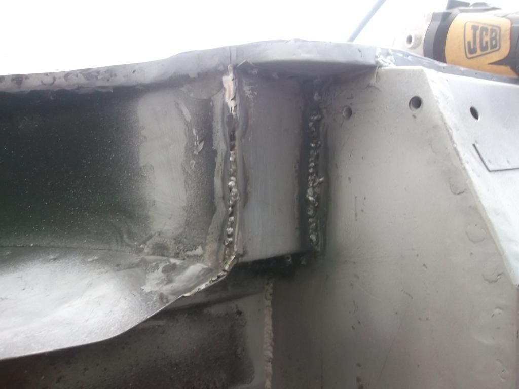

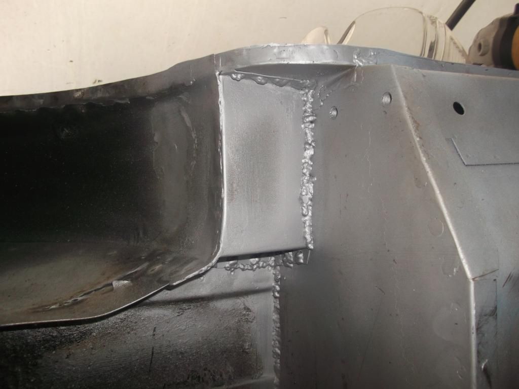

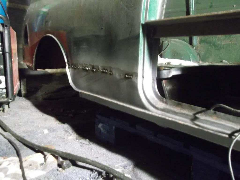

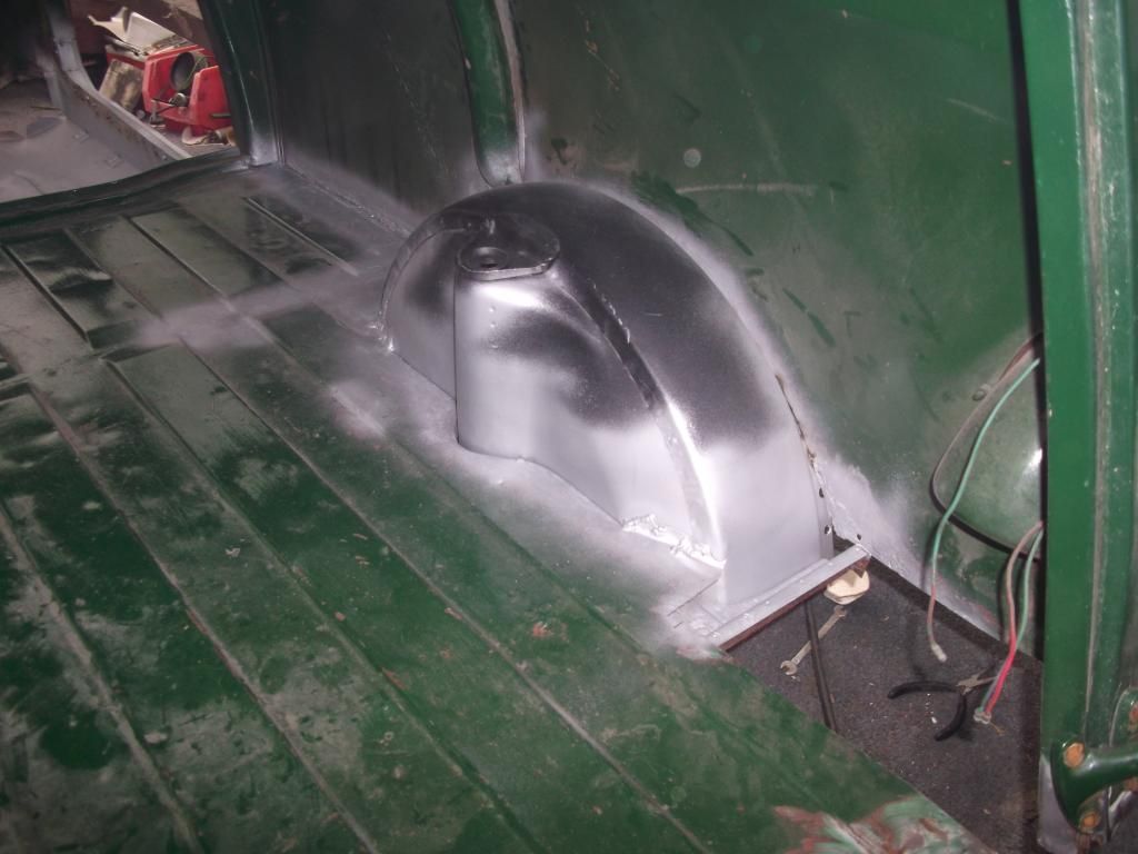

Been working on the van today welded in the new rear arch! Here are some pictures for you
next thing will be the closing panel between arch and heelboard then the rear floor repair panel! thanks for looking!

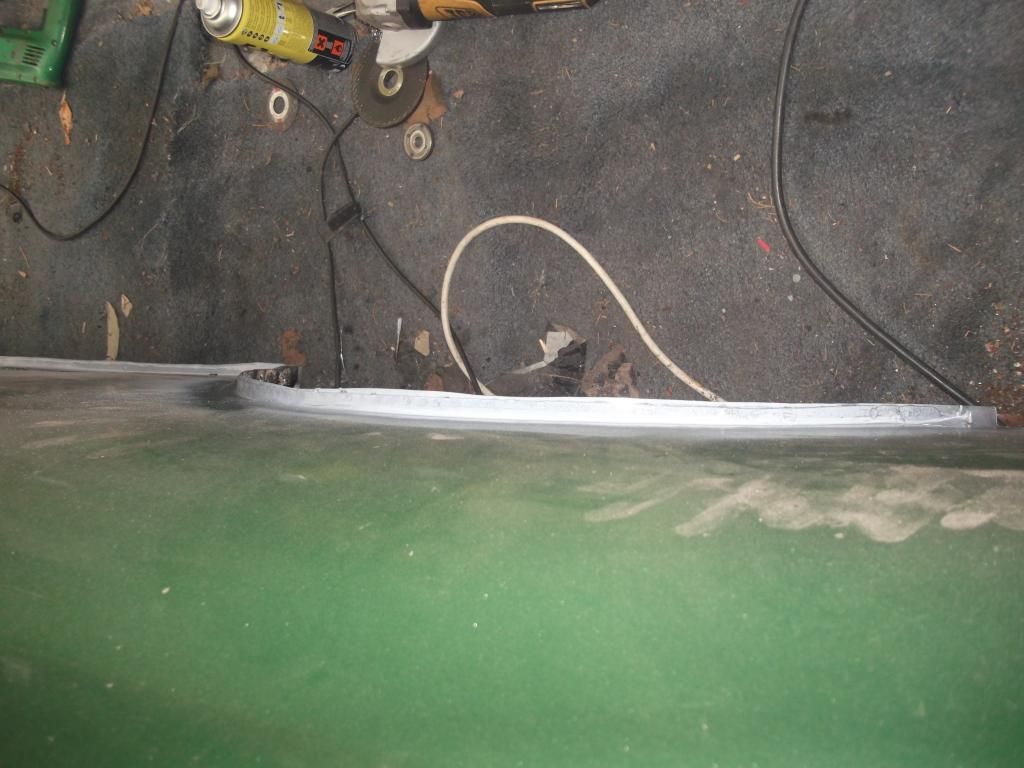

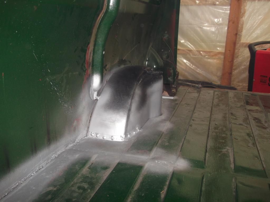

I have been doing a little bit more to it this afternoon but its getting cold! managed to grind all the plug welds down and add a closing panel to the back of the rear quarter ready for the heel board to arch closer to go in! :)

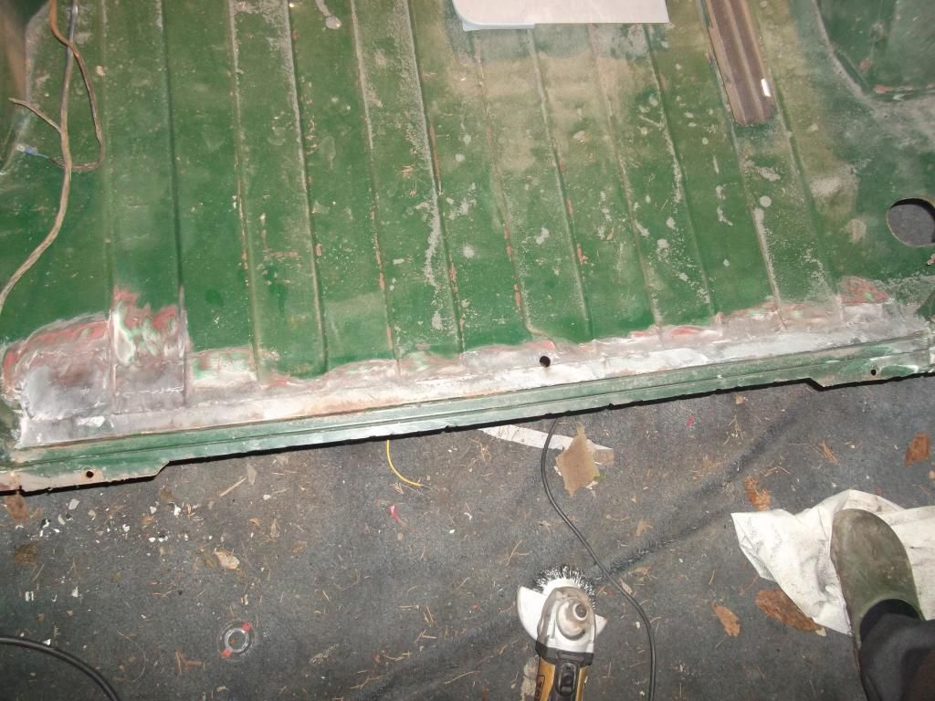

Been knocking some of the dents out of the load bay floor yesterday someone must of been hauling some heavy stuff in this van! need to borrow the pin puller from work to get some of them out! XD

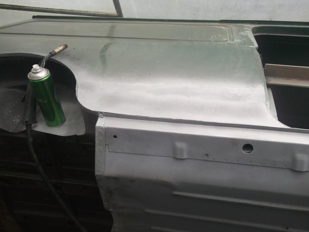

Right update for you ! :)

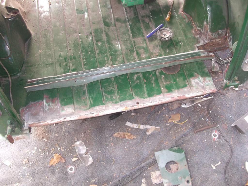

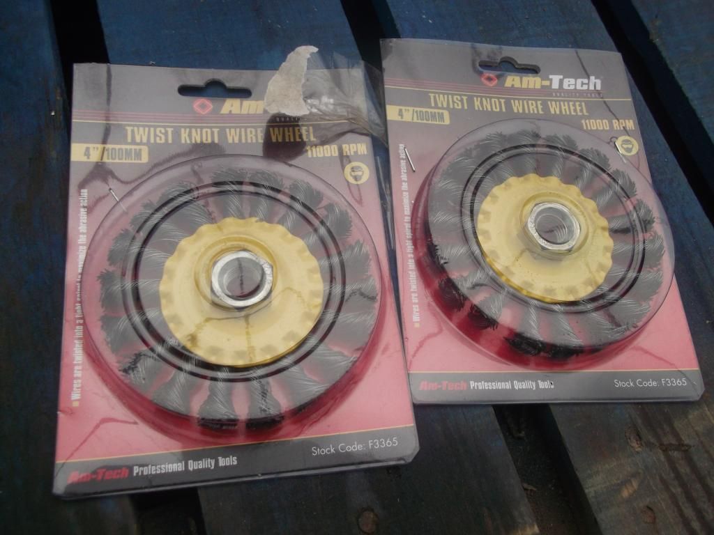

First of all i went to work this morning and got sent home so decided i should work on the van! opened my post to find new wire wheels!

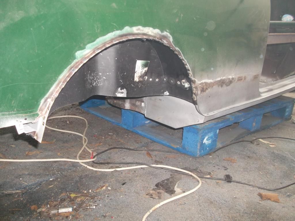

Then i got the arch to heelboard closer ready for welding in and clamped it in place!
welded it in and started to grind off and re -weld any holes
primed up to prevent surface rust !
After this i decided to finnish up the quarter panel and prime it up
Posted ImagePosted Image
This side of the van is starting to come together got to do it all again on the other side XD but i will get to that in time ! i have had to try my hardest not to start on that side untill this side is complete as it will all become to much ! i need to get some more cutting discs before i can weld the new rear floor piece in !
