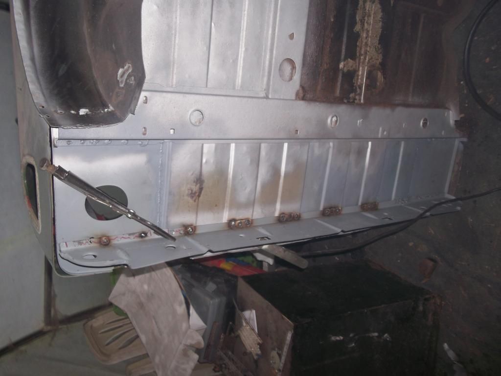

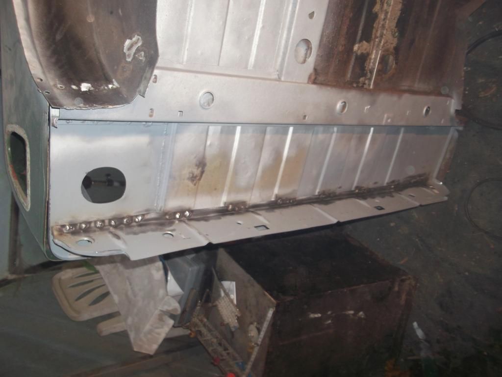

UPDATE

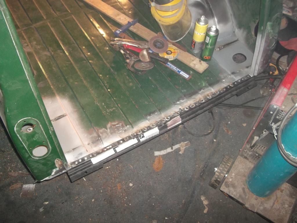

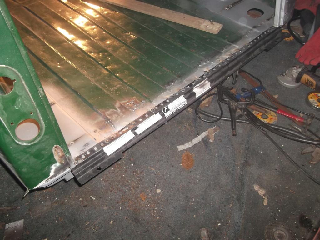

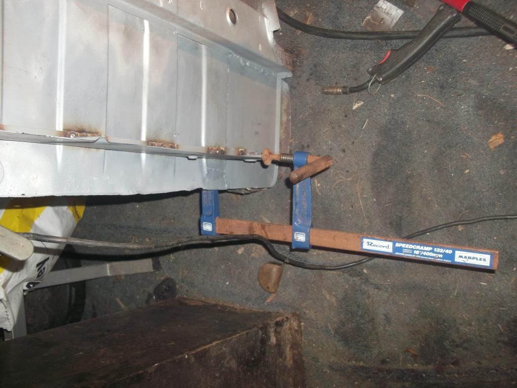

Got some work done today! first off i drilled all the holes in the new rear valence closing panel and lined it up with the old marks and welded it in! :)
big clamp helped with the slightly warped floor from the corner repairs :s
Done! just needs grinding down and covering in 182!
Next i drilled holes in the rear step and started to weld that on ! i Decided not to get the better one from m-machine as i had already bought this one and the budget is a bit tight at the moment :( so i have to make do with what i have got ! But i will be making sure it all fits well and looks good!
heres one of how i left it still needs some of the plug welds sorting out

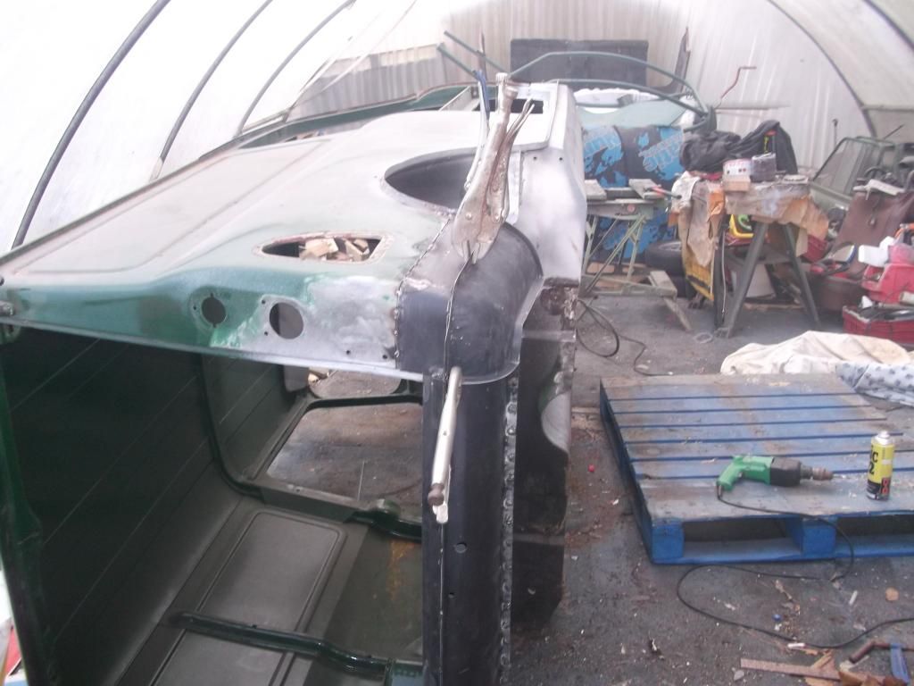

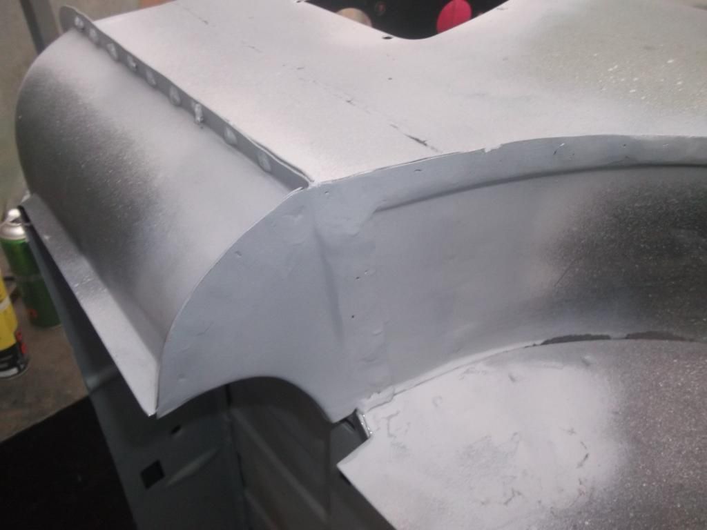

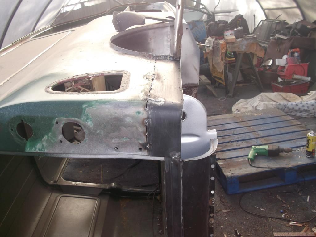

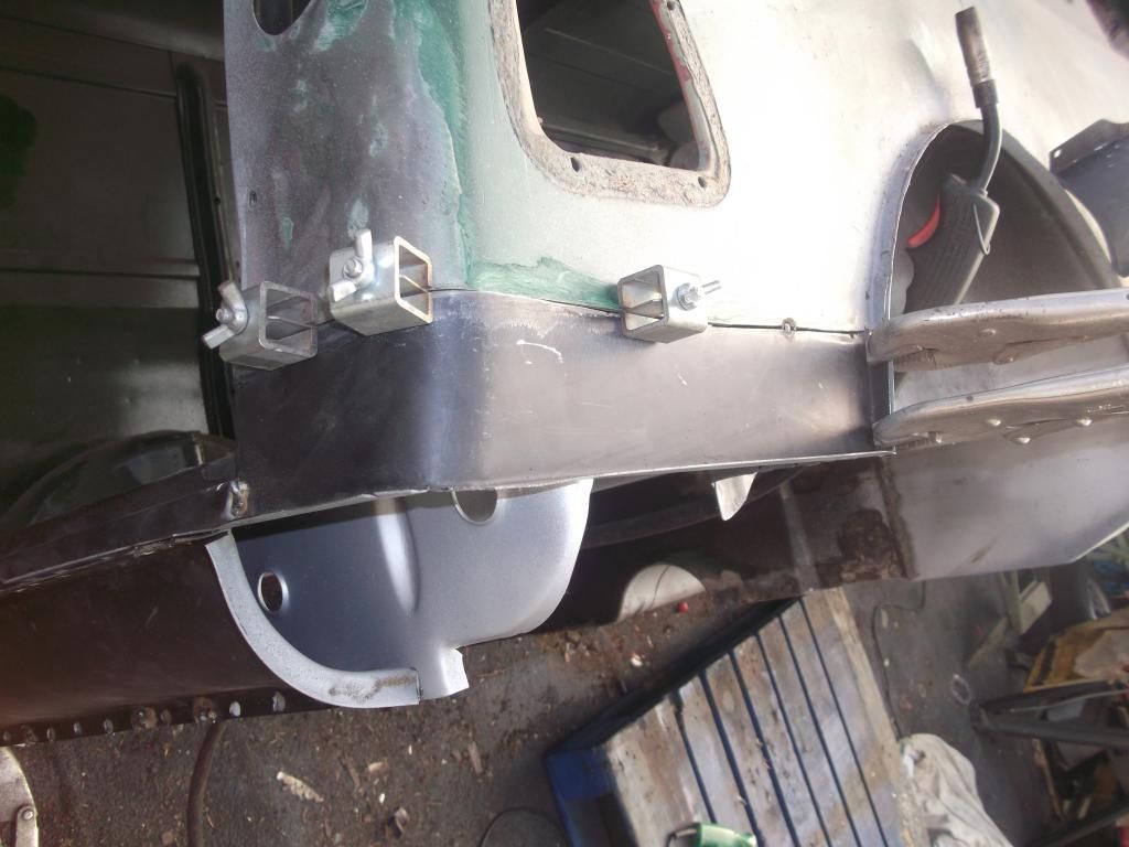

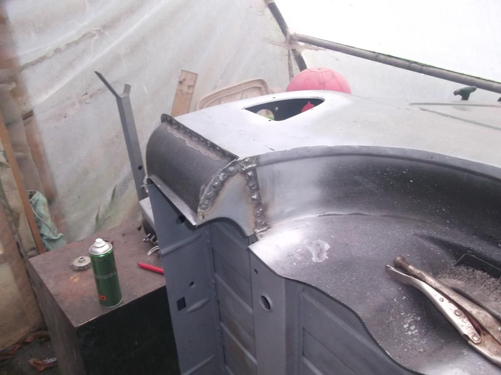

update again!
got the rear valence welded on!
then the corner
tryed the valence corner on for size :)
grinded down the door step
picture of were they meet

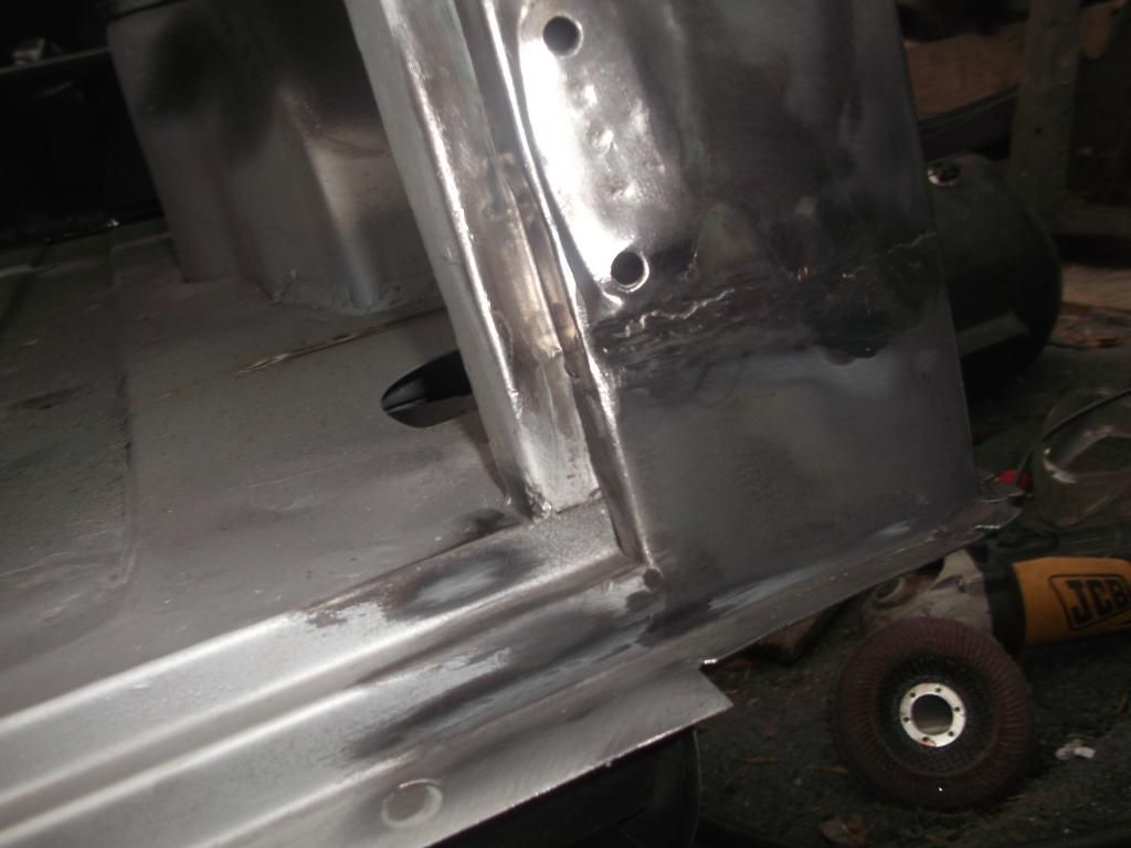

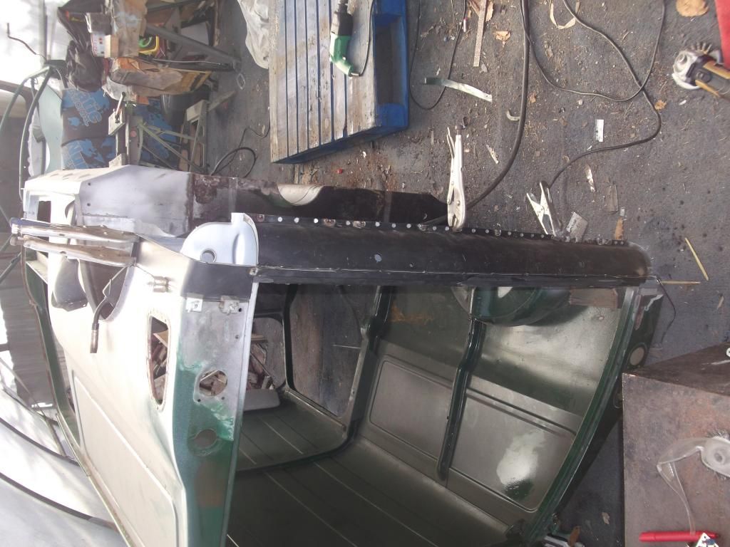

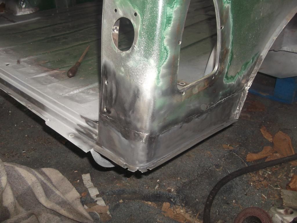

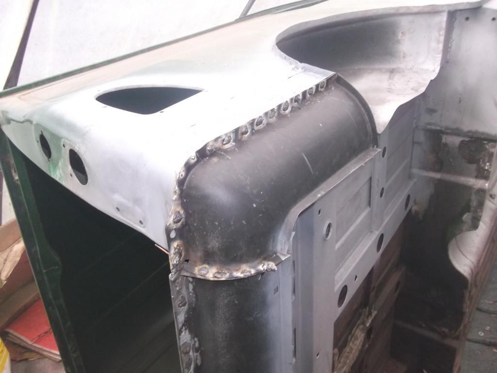

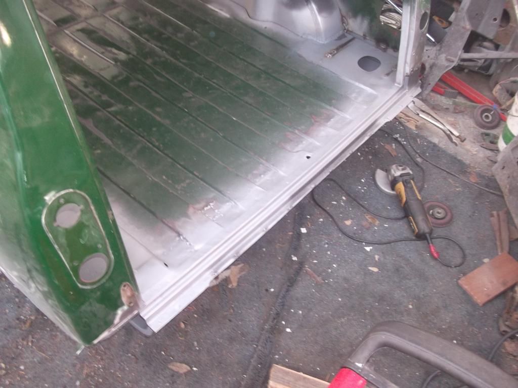

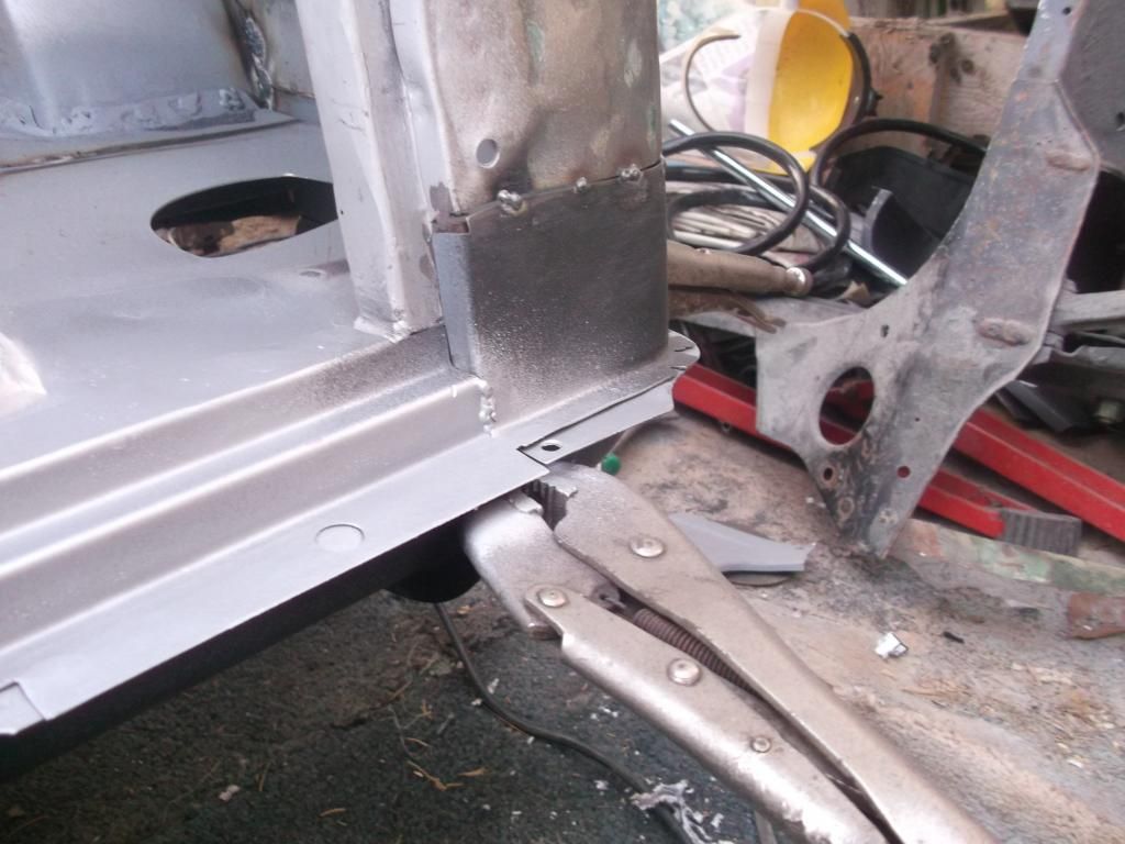

Right didn't quite get onto the passenger side rear this afternoon but the drivers side is basically done! i have turned the van onto its other side for the first time and wasted some time hammering holes in the rusty floor :@ !
here are some pics of the corner repair panel fully welded in and grinding mostly done!
heres a pic of the valence corner welded on!
valence to arch closing panel welded on and grinded off!

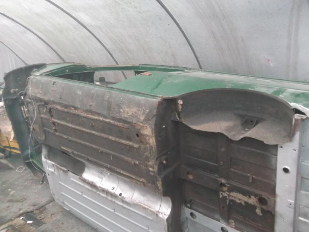

And here is a picture of the passenger side! oh dear! fun fun fun!
I will get the other valence corner done first the cut the floor out ready for a new full floor like the other side!
