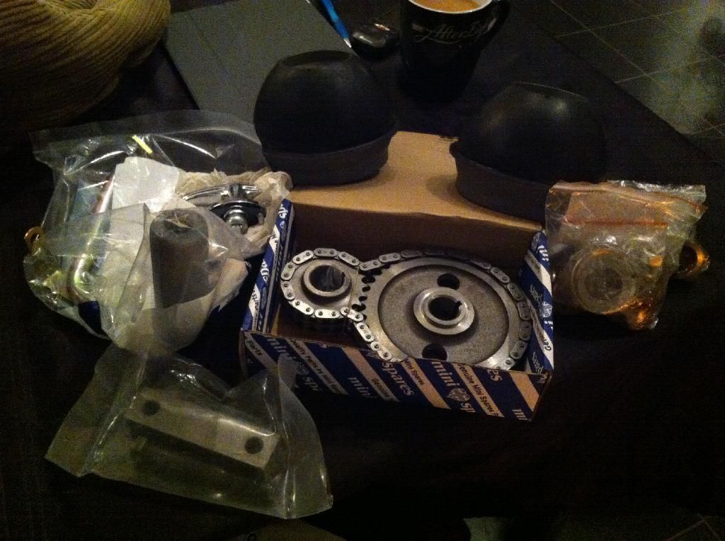

Posted 26 January 2014 - 10:34 PM
I got a few bits for the van!
89409CC8-E862-4777-B63F-88CEDAD320A6_zps

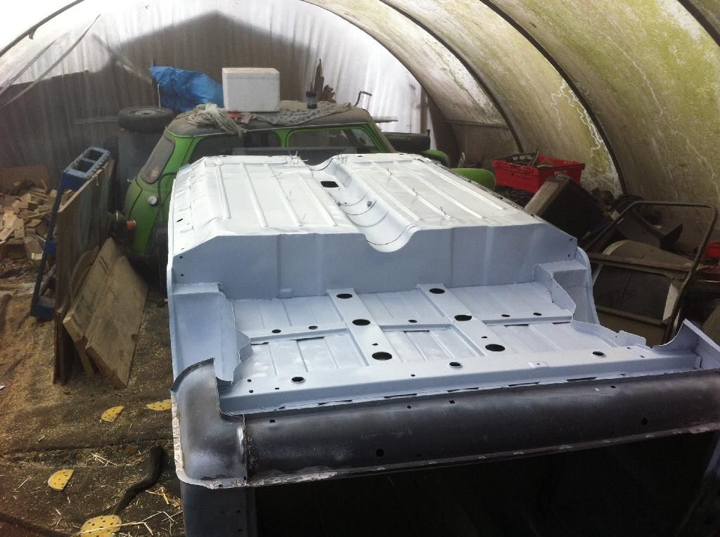

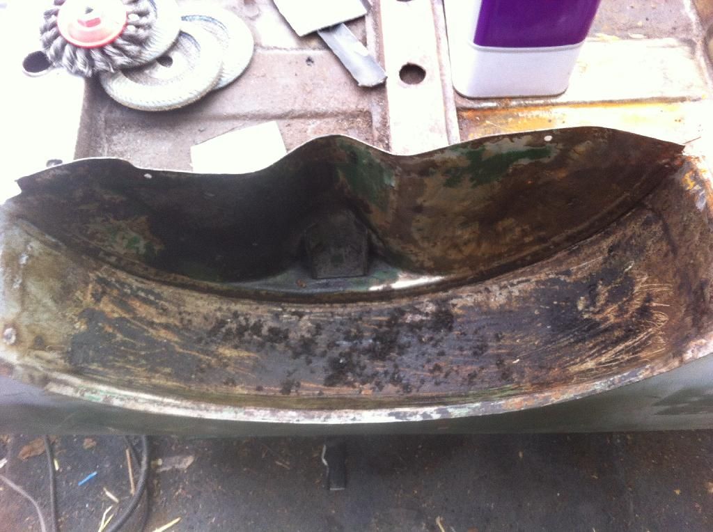

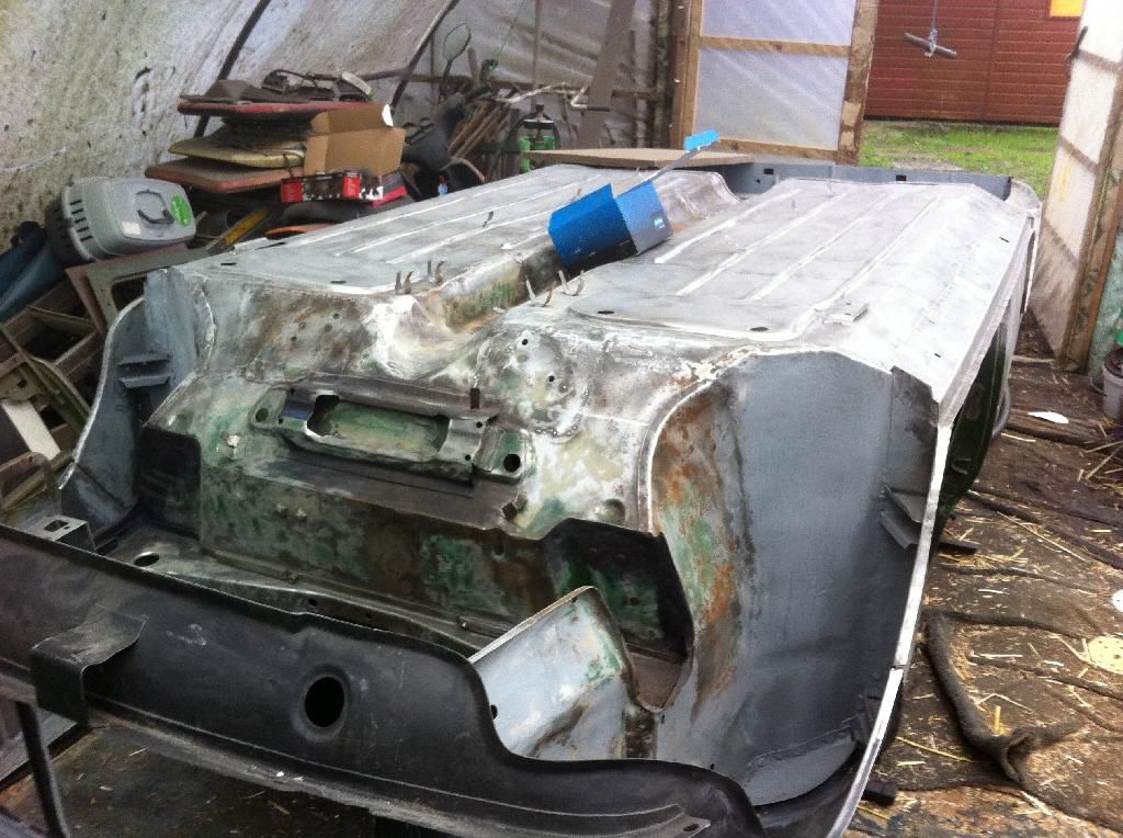

Posted 30 January 2014 - 04:01 PM
Done a bit today ! Got rid of most of the underseal on the load bay !
41C63F25-68AD-4B86-86E5-283A266641C3_zps
5E4558D6-1706-4DAC-979B-63E2A2FBBD9B_zps
Then I cleaned up the other floor pan / tunnel ready for the da!
22A6B879-4BA7-4F8F-AFD4-8253D59EFA61_zps
Tomorrow I will be doing some more cleaning up and hopefully get it all rubbed down!

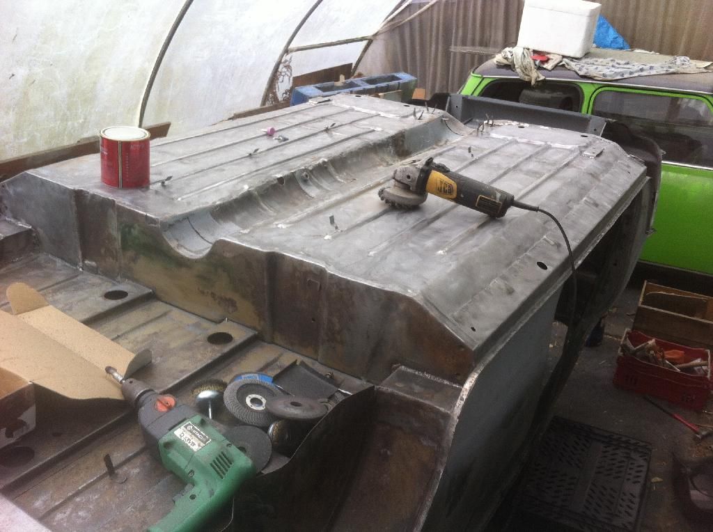

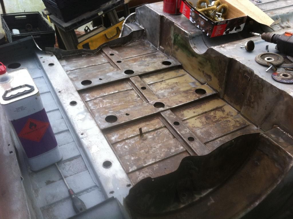

Posted 03 February 2014 - 03:25 PM
Right got most if the bottom rubbed down today and a few bits of grinding done
I have brushed rust converter on the rear load bay as it's quite pitted
F6822C23-5CC4-4F44-A5A7-B398D6C243EF_zps
I have gave the floor pans a good DA and just the front fiddly bits left to do and the tunnel
4D57A26A-FB6E-40C7-AD5D-E55E81E44D50_zps
Should get the etch on tomorrow I hope!

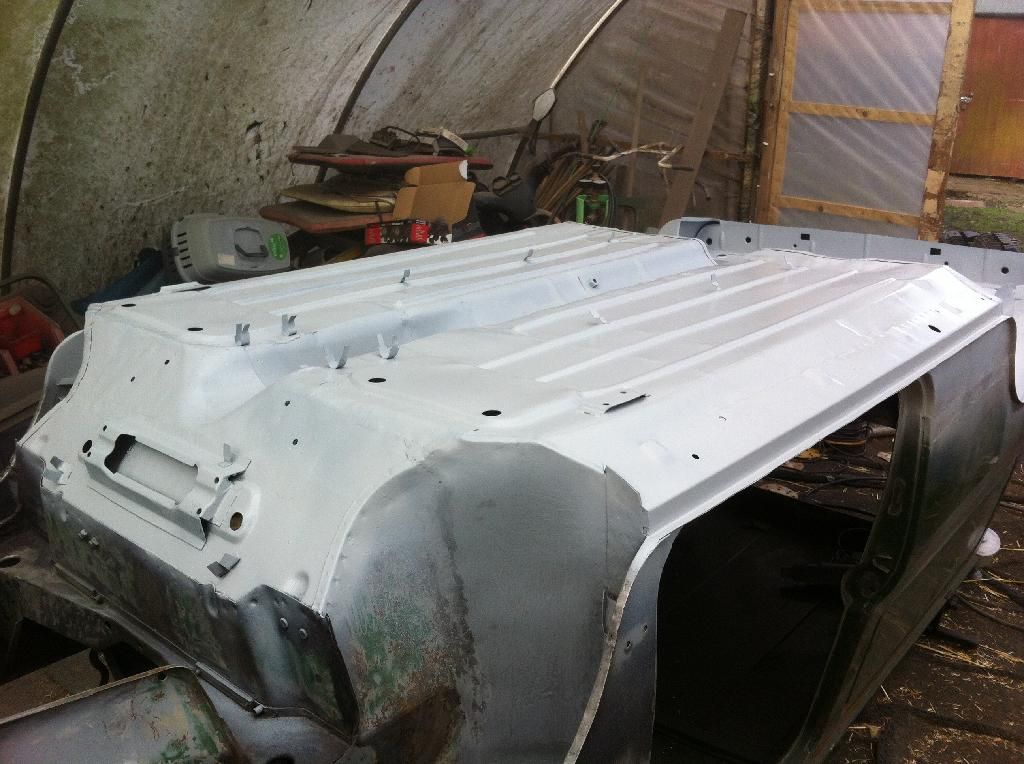

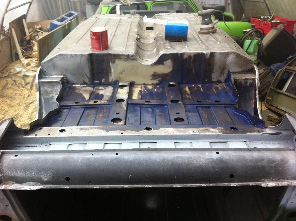

Posted 04 February 2014 - 12:50 PM
Etch XD
81C404FF-45F2-459D-BFC6-6265A303F13E_zps
2F1175A8-83D8-4A90-B648-F799A2A738BA_zps
Will do inner wings/ front panel at a later date as I'm waiting for a parcel I need to weld on ;)

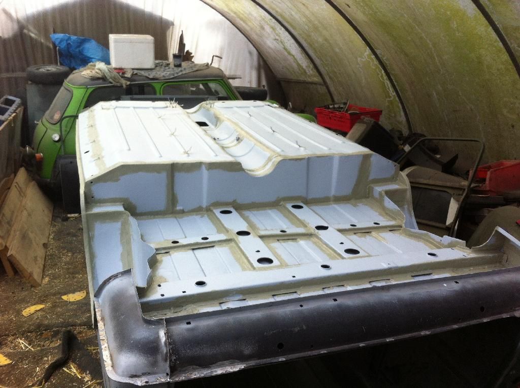

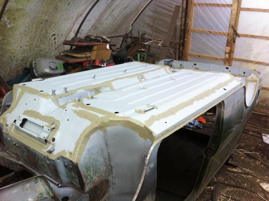

  • 1,478 posts
Posted 04 February 2014 - 02:11 PM
Seam sealer ! Don't be shy with it! :P
ADD3409D-323A-444F-A545-5D5C48A67224_zps
Rear
9B5FEF9E-A7E2-4A6B-B396-5AF37616E6A7_zps
So I'm waiting on post! Bottom will be fully painted this week!
