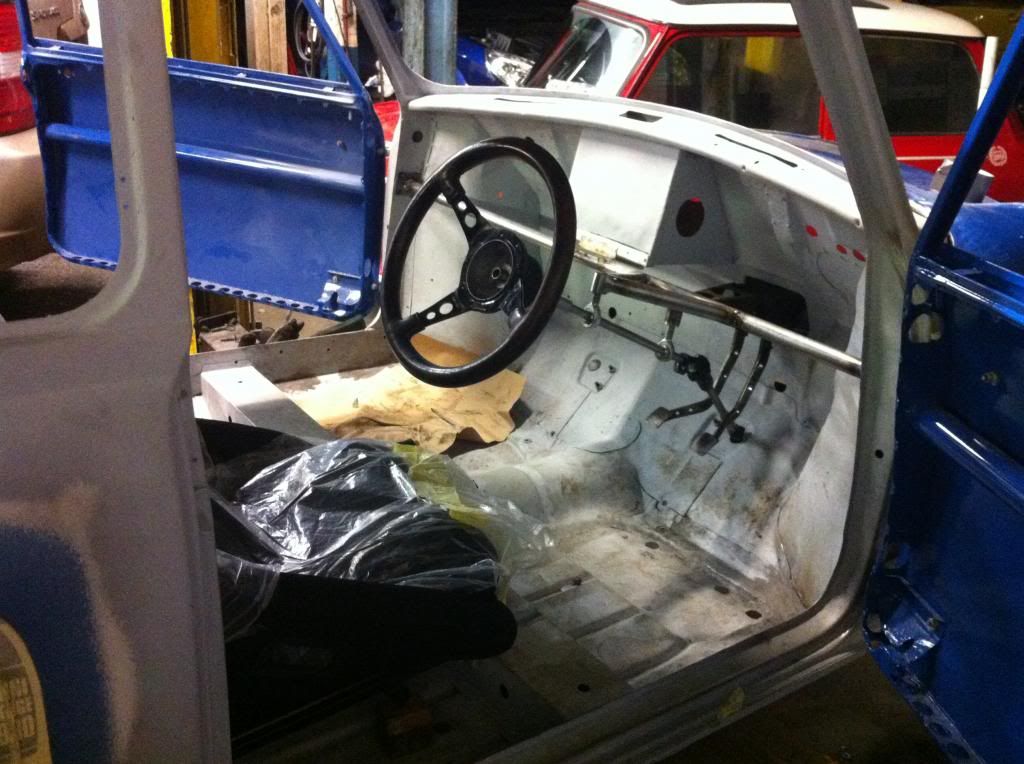

UPDATEROONIE!

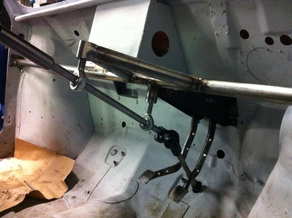

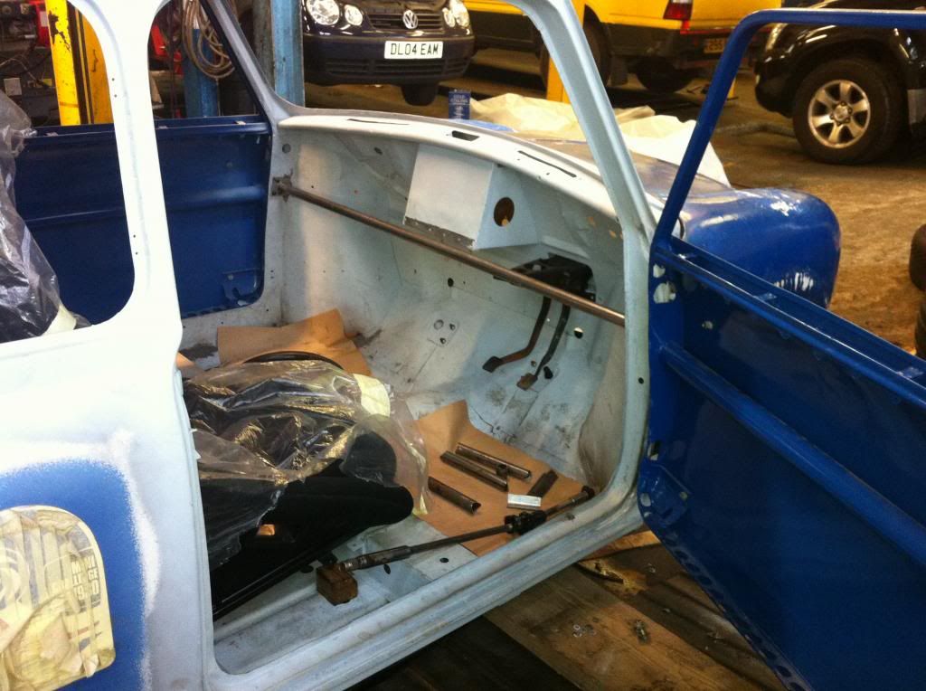

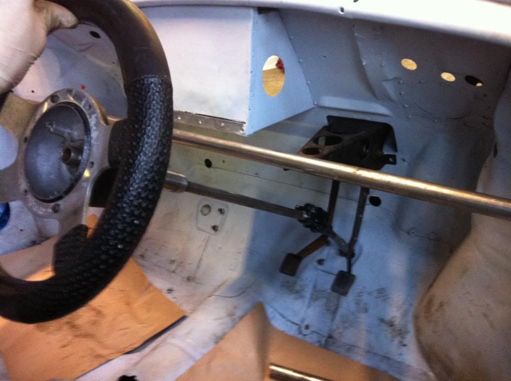

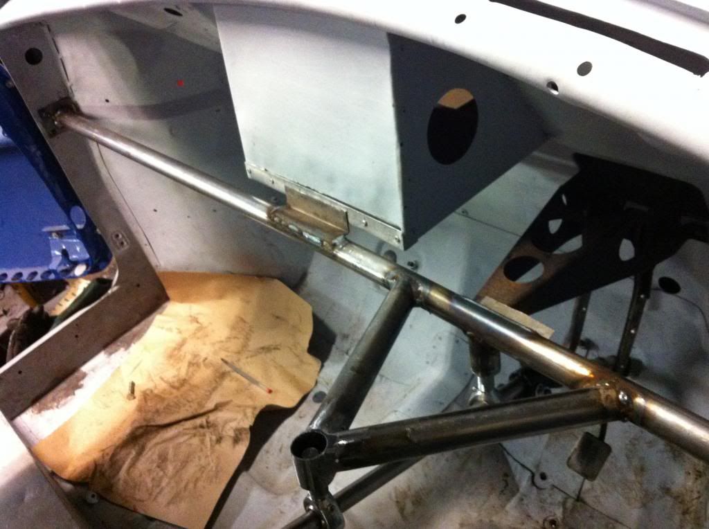

crossbar cut in

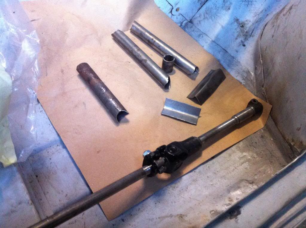

column cut, UJ on and support bars trimmed to fit ( took AGES)
cooool

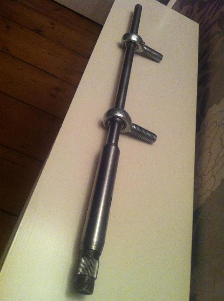

rosey rosey rose joints! ( actually had to spend ages with the column in a lathe sanding it down 0.26mm becuase i couldnt find 9/16 rose joints. only 14mm!!
and in
brackets to the weber box and to the pedal box. all triangulated and strong 8)

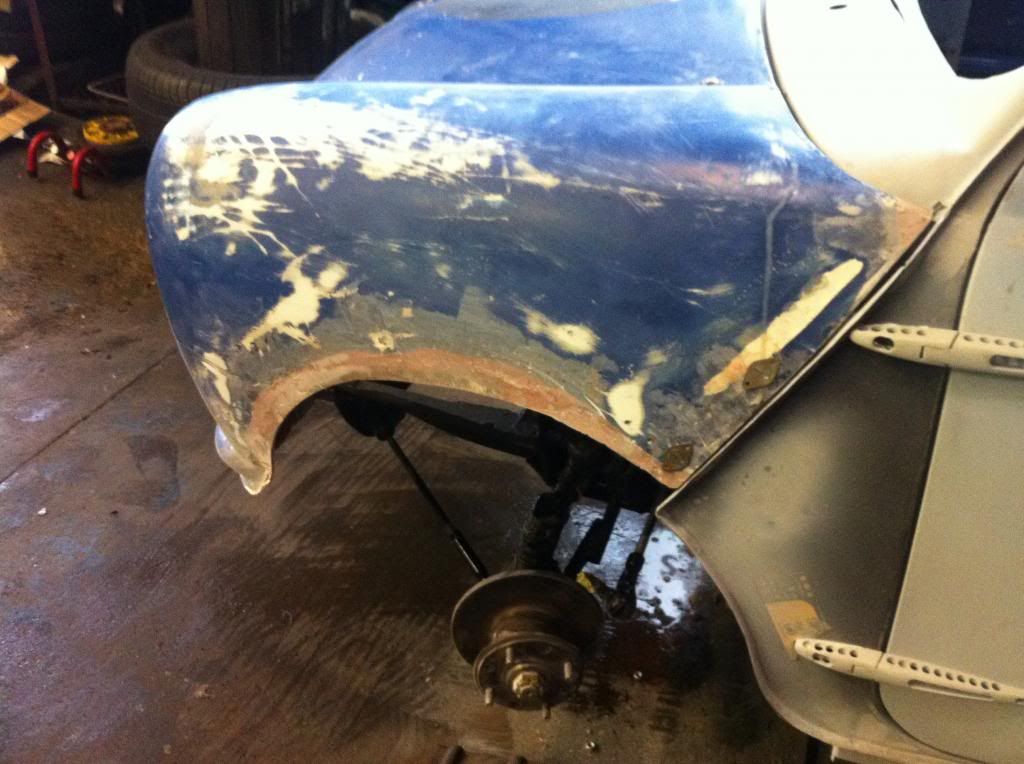

done work to the front end. layed loads of matting inside and used some filler stuff that had matting stands in it to rebuild the arches. proper strong. also made up the hinging mechanism.. :P
no more pics of that though untill i get the right pip pins for it to make it work! :D

Any chance you could take some detailed pics of the gear linkage in construction?

Yeah will stick up loads of detailed picks of it up ginsters

Great build and really like the steering column. I've fitted a uj to mine but down at the floor to help to get the wheel to the middle of the seat. Its ok but not completly happy with it. I might even try what you've done, looks good!

Where did you get the UJ from.
Looks exactly what i will need.

Looks like a fiesta one, there's a few on eBay that I've found
eBay item number 200337723996
Looks really nice by the way, very similar to my set up just neater! Looking forward to seeing this at some shows fella

Fiesta, Ka... Think it was around 30 pound? Have cut it around a bit but it's a good UJ!

I will be re making my column soon with CDS tubing and a slightly different bracket
