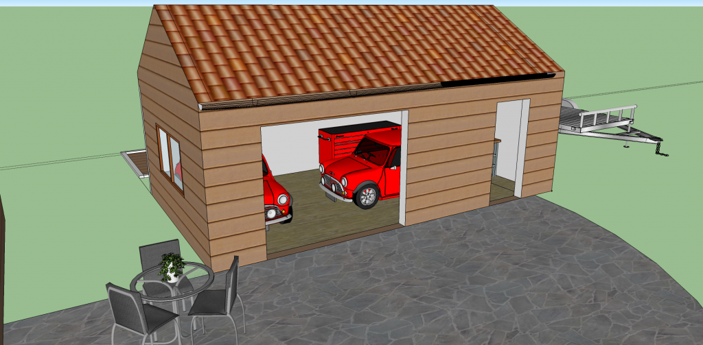

so we are building a shed in our garden so i can have both minis in it and room for work.. engine building etc and my dad can have his shed for his jeep back. its currently residing at a friends!
i got told to model it, and i was advised to use google scetchup. i like that! i didnt put up doors, becuase why:P and the cuttering went wrong, but who cares, thats not needed in the pre fab build we are doing.
i think im sad? maybe? i lowered the mini :proud:
can i put up a link so people can go around it 3D mode??
