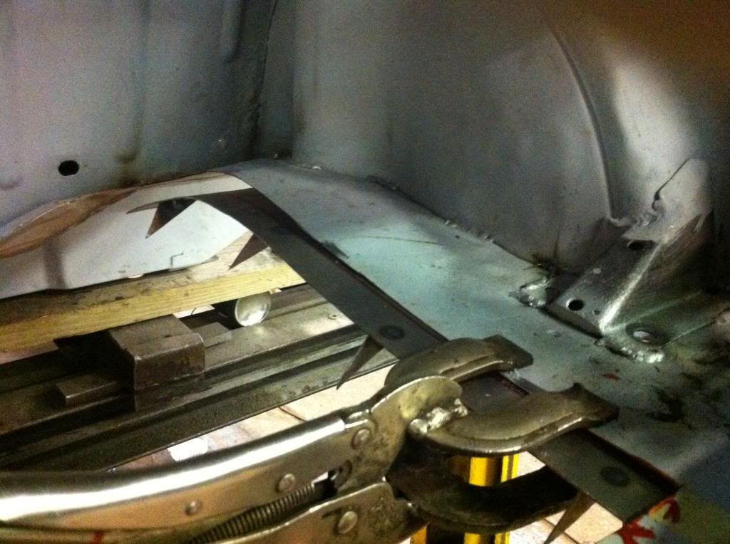

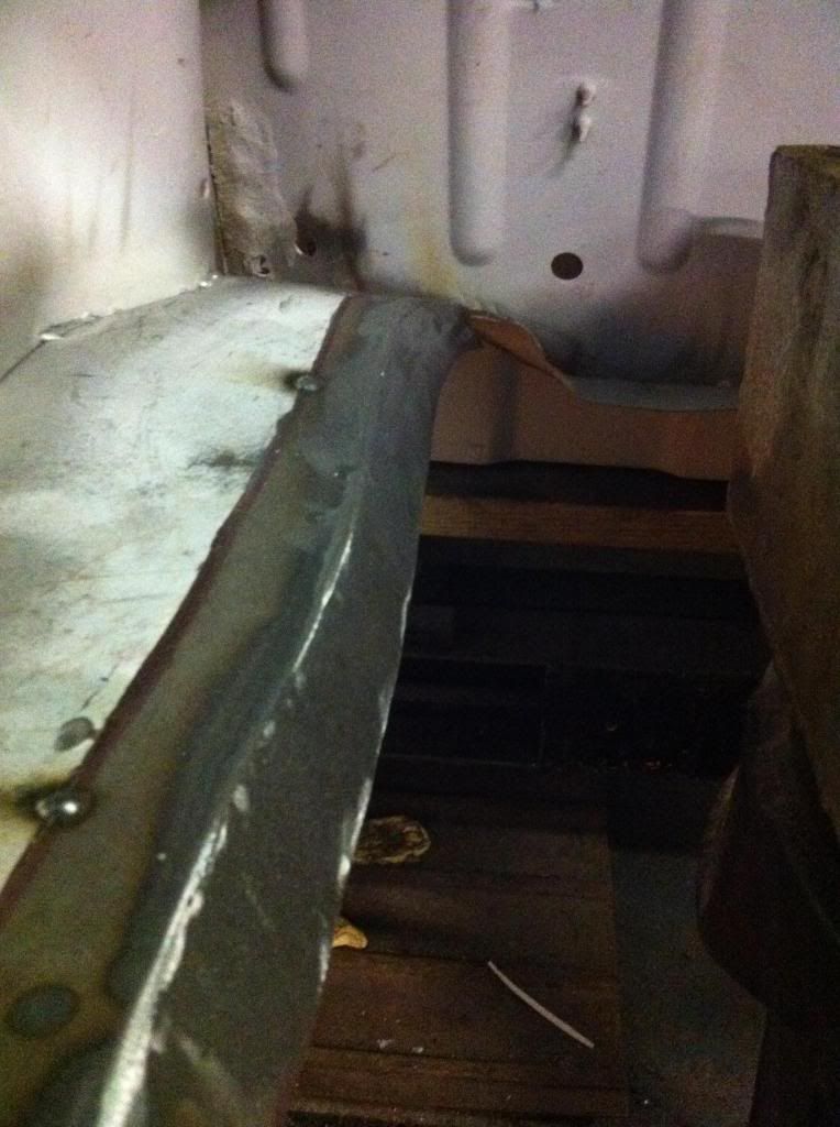

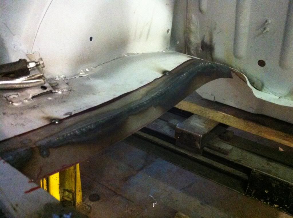

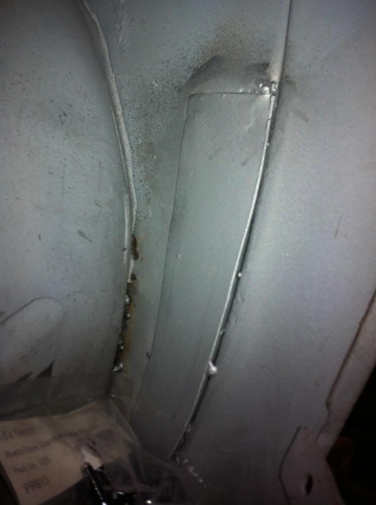

bit o progress.. you know that bootfloor i just welded in.. yeah...
hmm. i cut it out.
you read right.

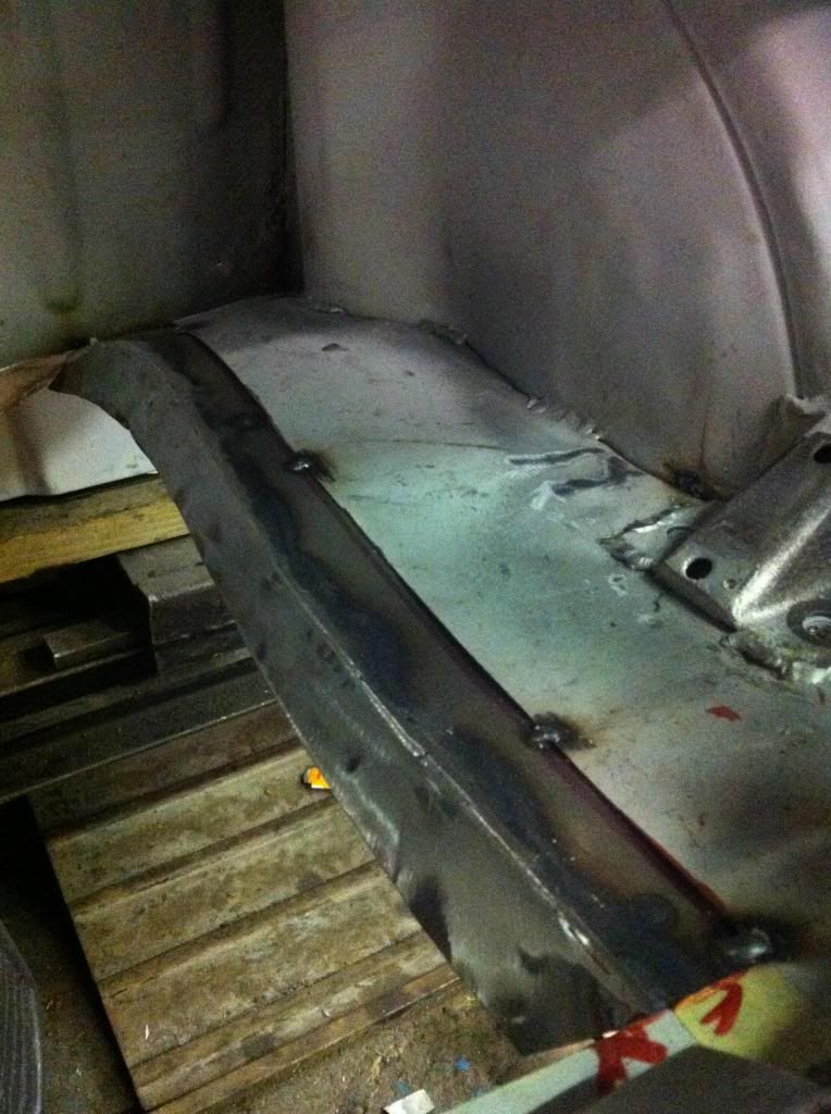

i cut it out and started making some angle bracketing to hold the floor in
note 60 degree angle steel to get angle right
left side in and welded up
smooth as ass.
childish test fit

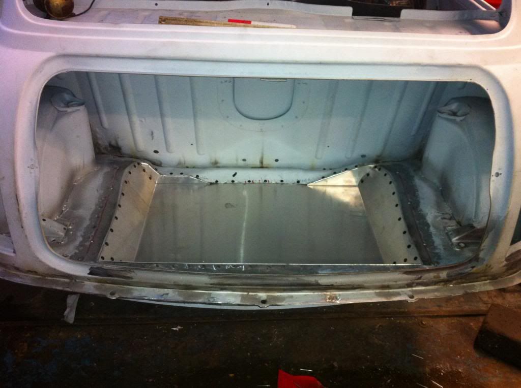

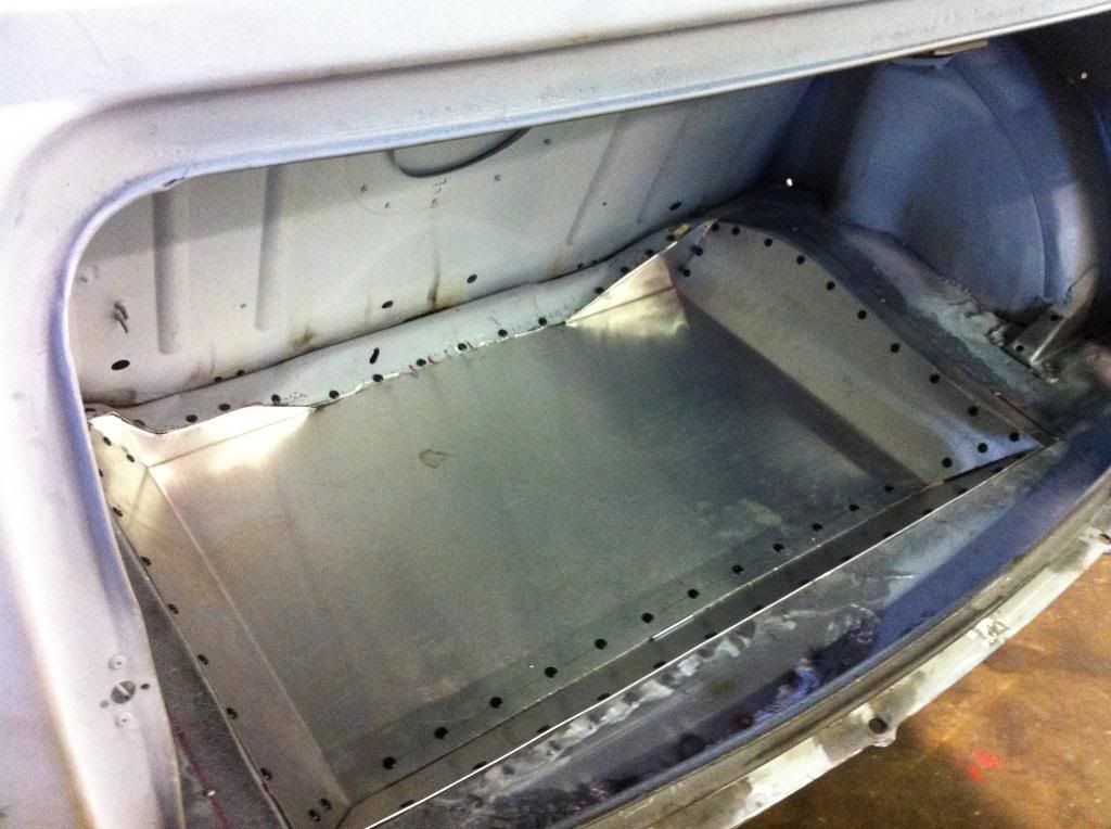

ally floor
will have a hell of a lot more rivets in it when its in for good. this is just so i could make templates for the holes at the front.
then some patching
obviously by no means finished. you can still see i have replaced it! cant be having that!
next up, works dash!

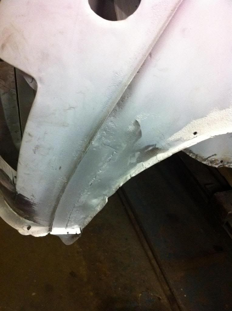

Cant you buy corner arch repair sections ? would reduce the ammount of filler needed,although if its track based a few bump & bangs are gonna occur anyways.

how come your making the boot floor from aly? why not fibreglass or carbon? is the ally floor what it had originaly

dunno, but when i have panel beat the living crap out of it im not going to need much filler ;)
and its mostly covered with group 5 arches
i have a grp one next to it! i wanted to keep the metalwork fabrication feel to the car so i made it from ally. not fussed about weight, although it is bloody light! also needed to mount the tank low and central.

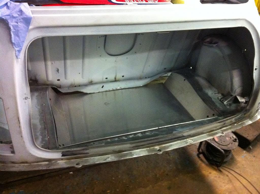

  • 4,435 posts
Posted 16 February 2013 - 09:13 PM
done :)
in truth, i finished it thursday afternoon, but i had lost an ipod cable until now and twas bi birthday on thursday.. 8)
boot floor is nice, lighter than std aswell :P

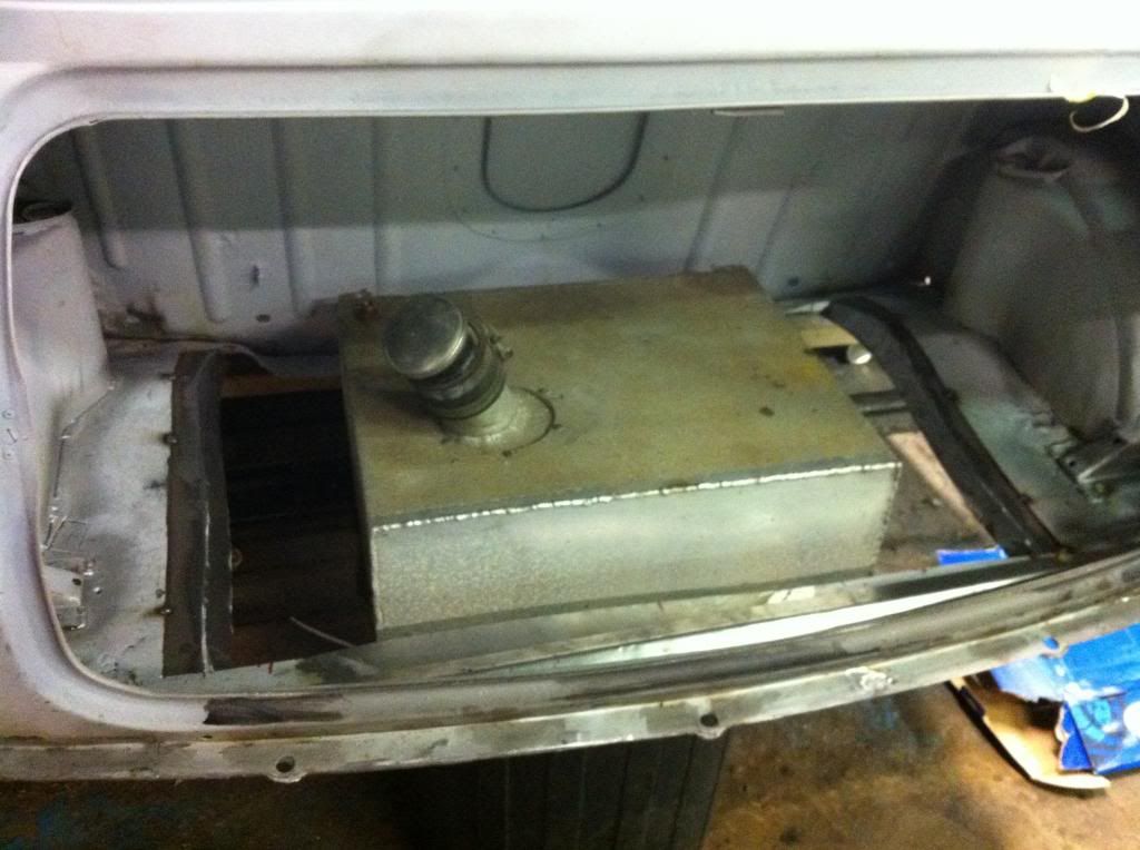

and the fuel tank brackets. tick ally. still too heavy so i got buisy with a hole saw
