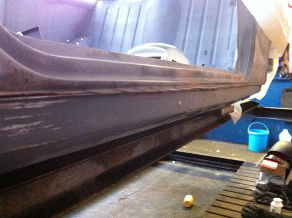

bit of an update while i am sitting around with a destroyed right hand....

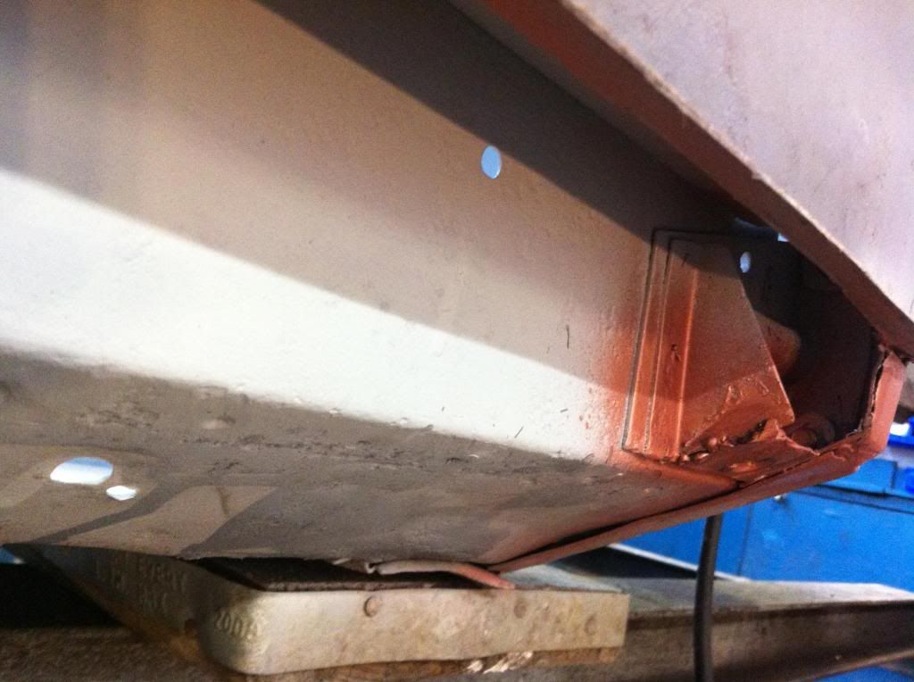

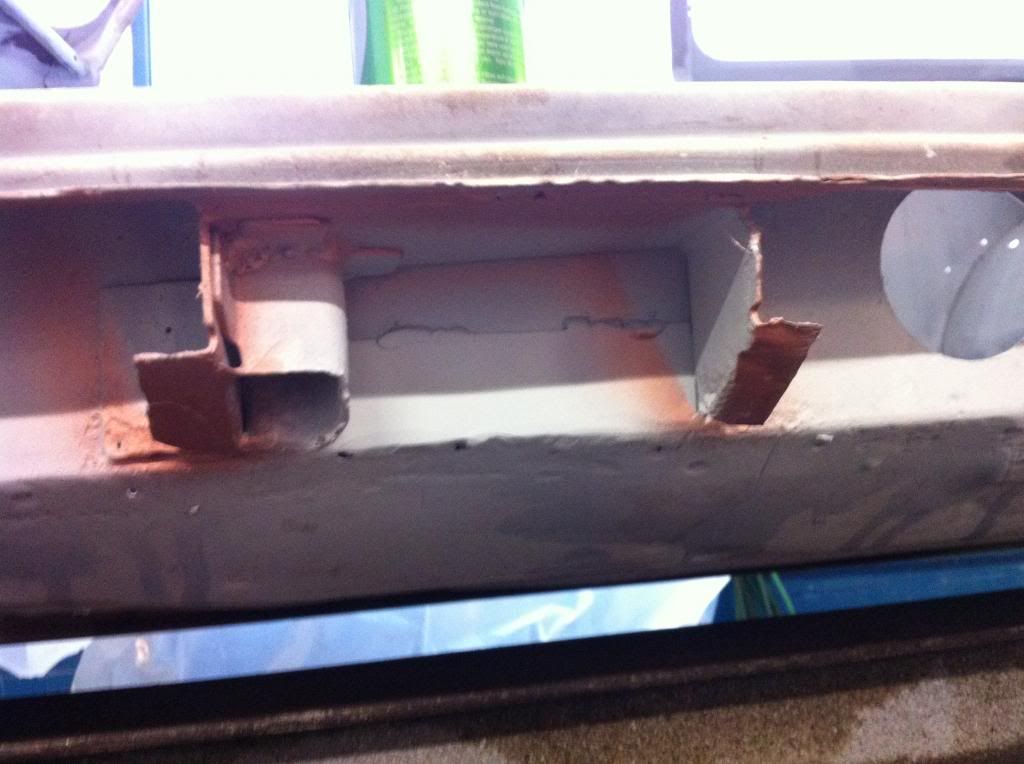

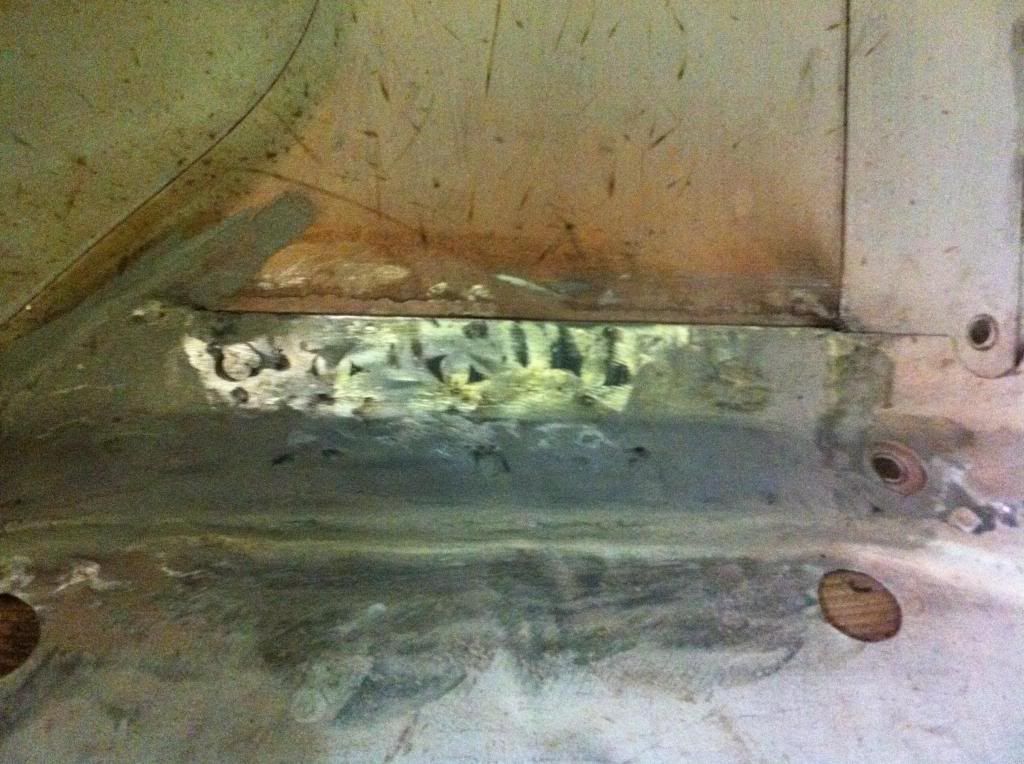

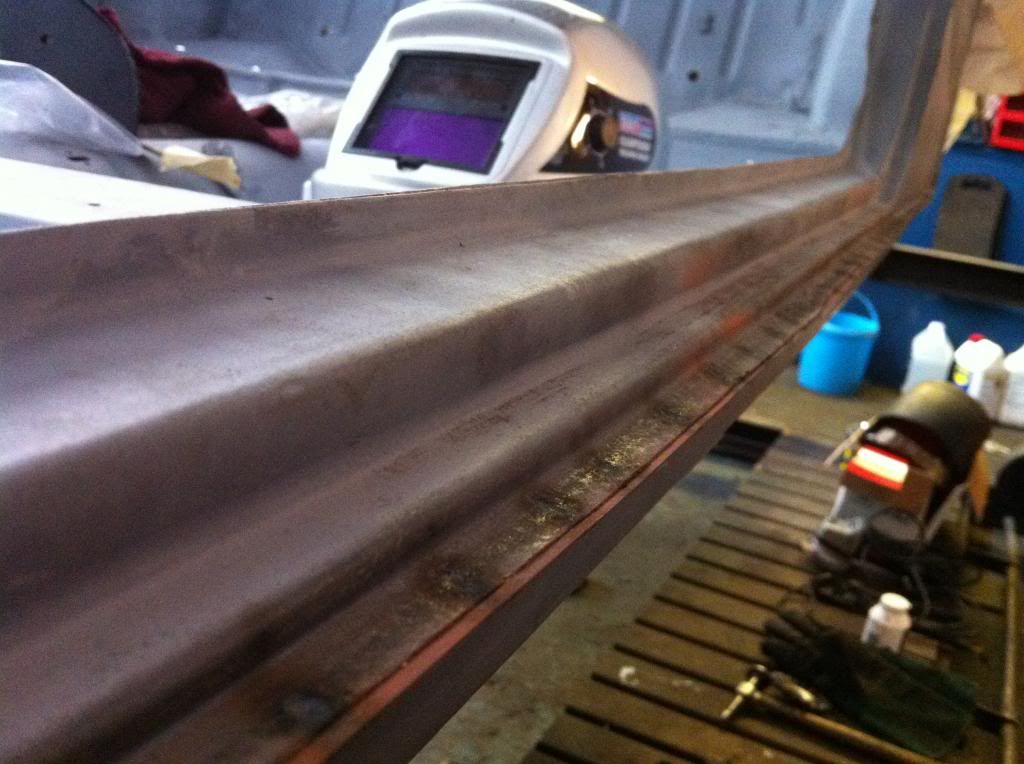

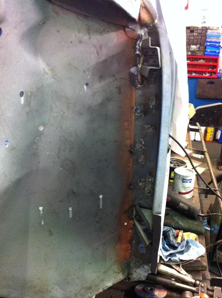

bit of repair work and paint ( lots of!) to the inner sills pre-outer sill
patch pre finishing work to make it look good in and out
love a spot welder 8) have to grind back a bit of the sill lip but it looks good!
amount of cutting and rust to outer sill.. naturally, both will be replaced

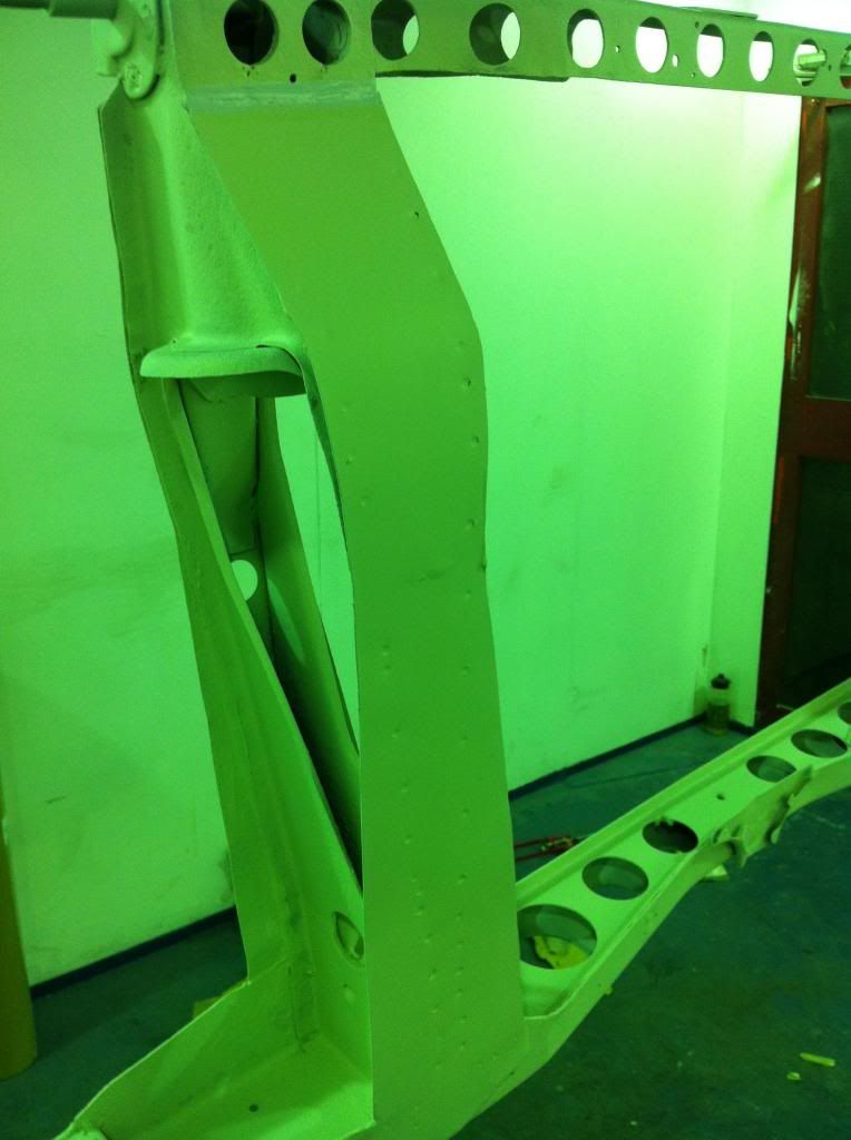

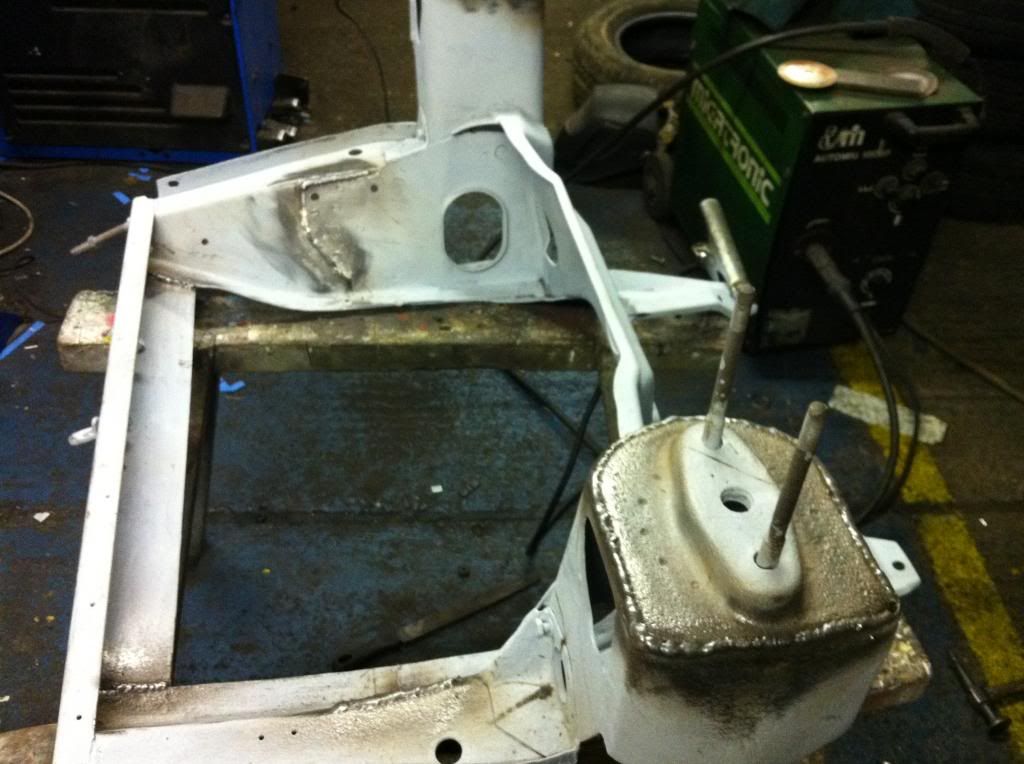

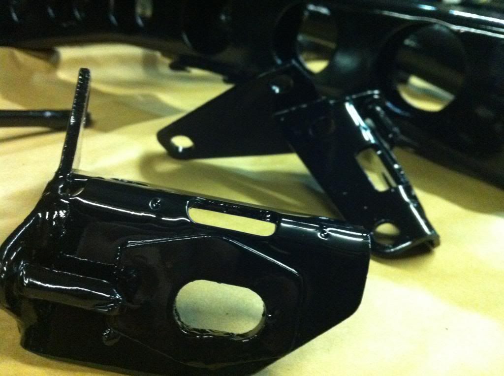

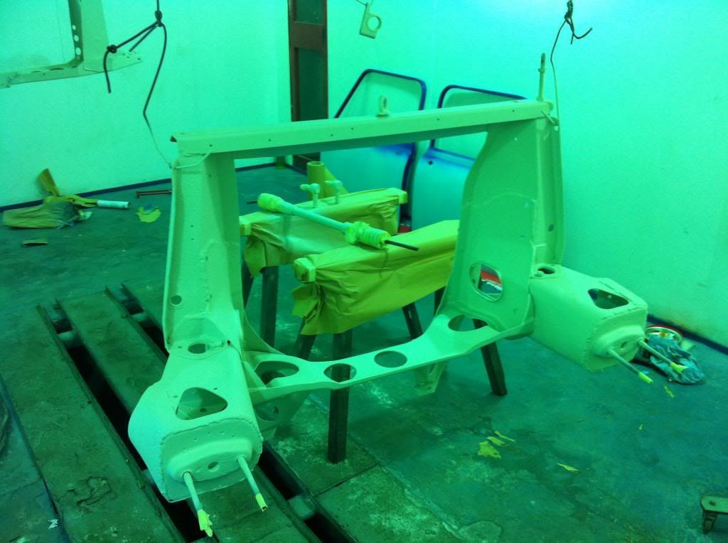

subframe time!

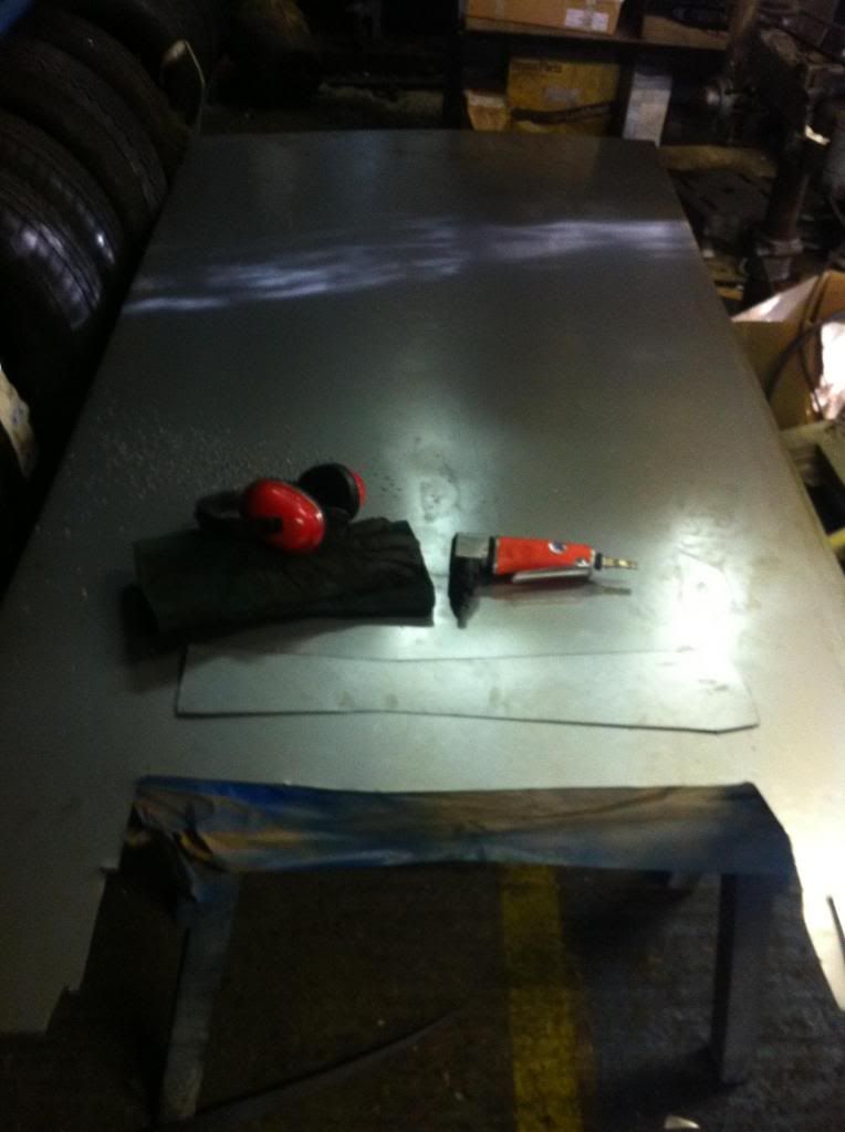

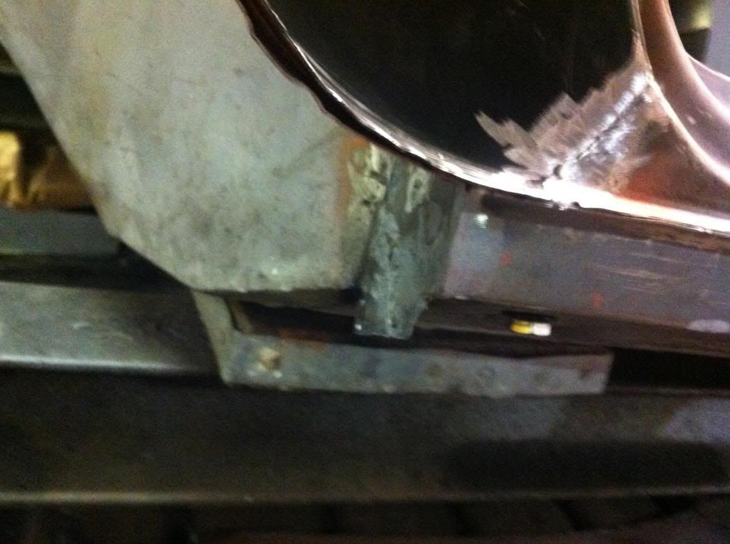

patch made for rear subframe. didnt actually get pics of that.. DOH! anyway, now equipped with AWSOME tools i can make the most excellent patches. lovin life

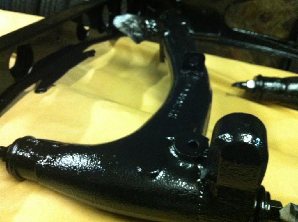

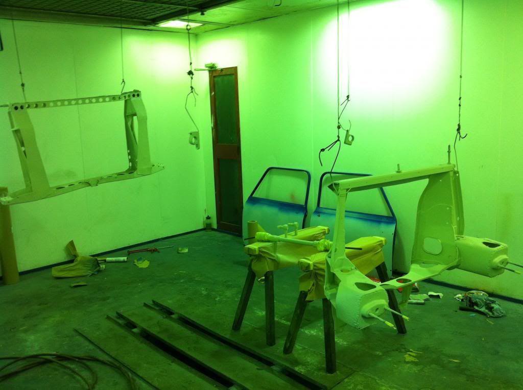

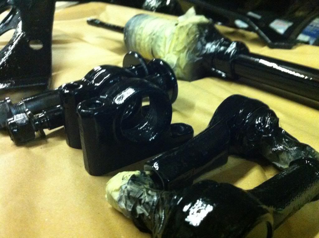

PAINT TIME
(oh there it is!)

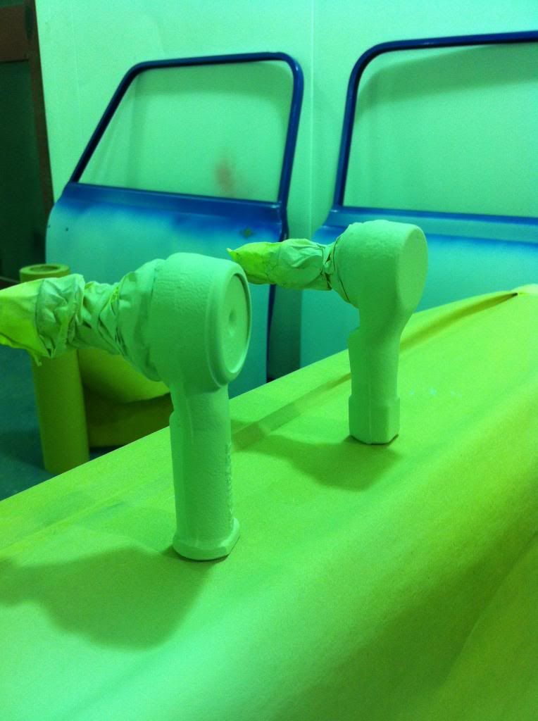

odd track rod ends.. hmmm, oh well! (this wont have any adverse effects will it? )
oooh yeah 8)

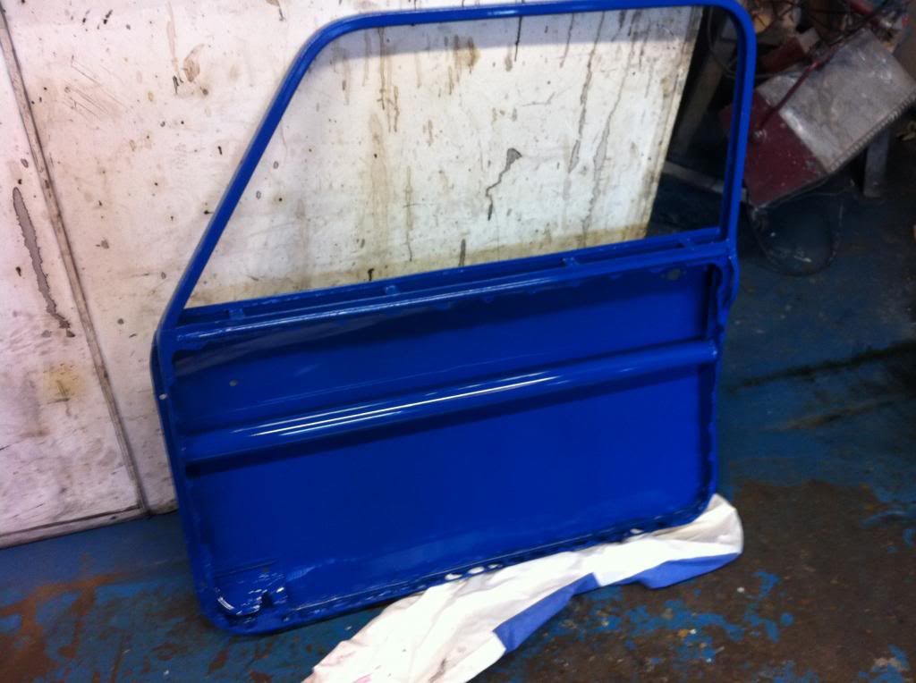

paint on doors ( inner is gloss, i dont think paint would fade when it is covered and inside all the time)

really jelous at the moment :( it's gonna look sweet, the parts look amazing and i love the blue!
did you the the seam welding yourself or was that already on the subframe?

yeah i did it. made a bit of a slop of it, had the subframe blasted, and it just started to rust ever so slightly, so i spend a day on the subframes cleaning and etch priming etc. then when it came to welding i couldnt get the etch mprimer in the crevaces, so the weld was a bit messy, but im happy with it! feking strong though!

Look's good, I bet the spot welder is alot easyer than plug welding.

looks spot on to me, you got all near corners for extra strength!
and indeed it makes it bloody strong as anything once you weld the seams up!

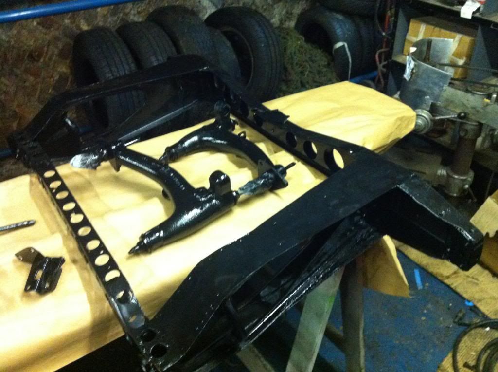

built up rear subframes, just need wheel cylinders and 1 oil seal to finish brake setup and its ready to go

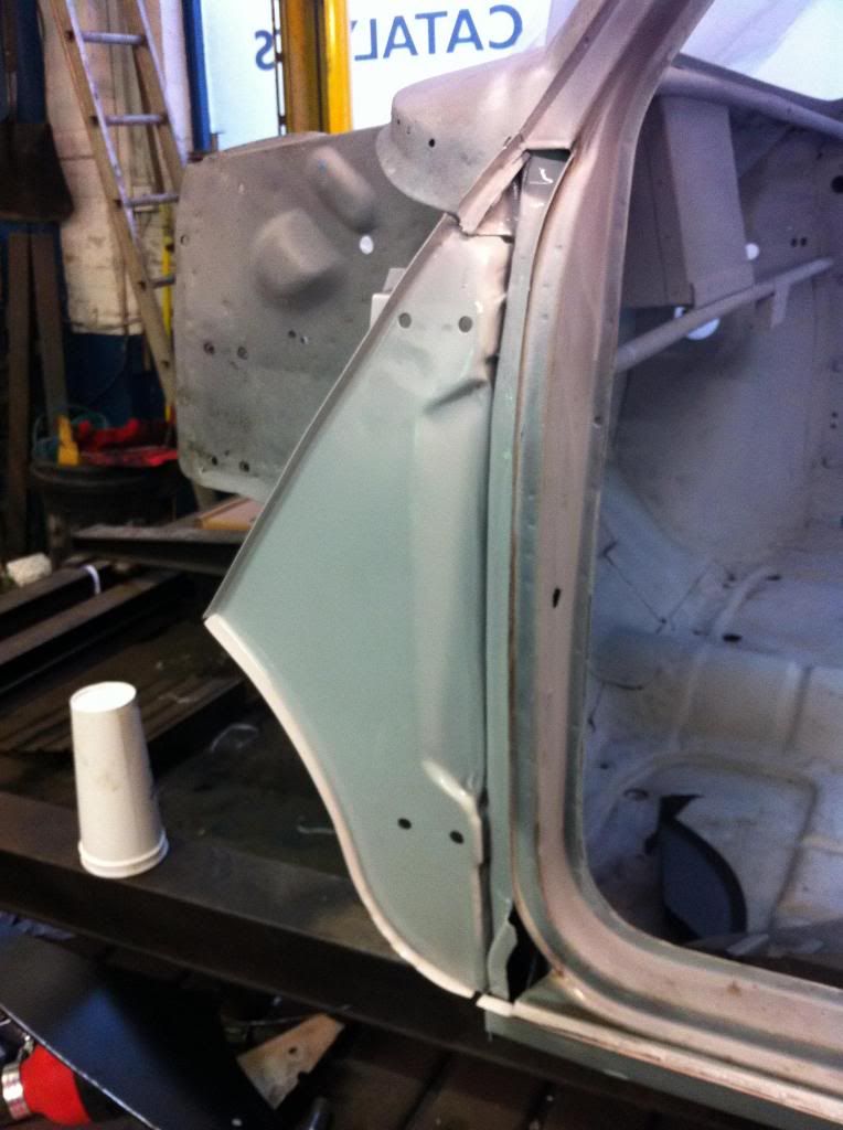

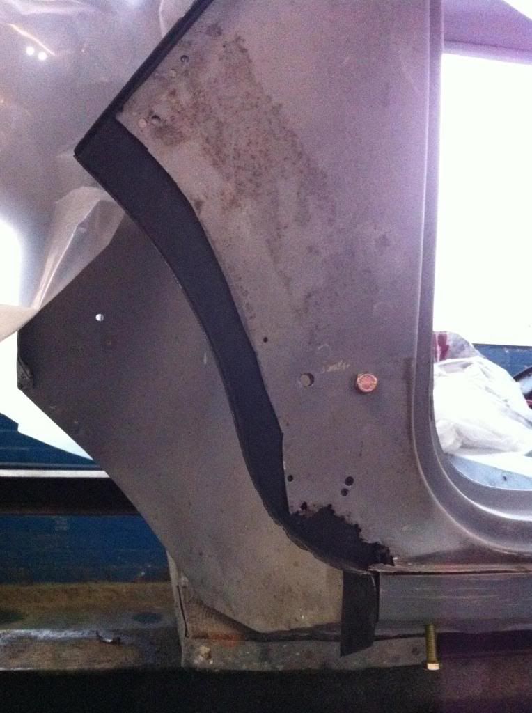

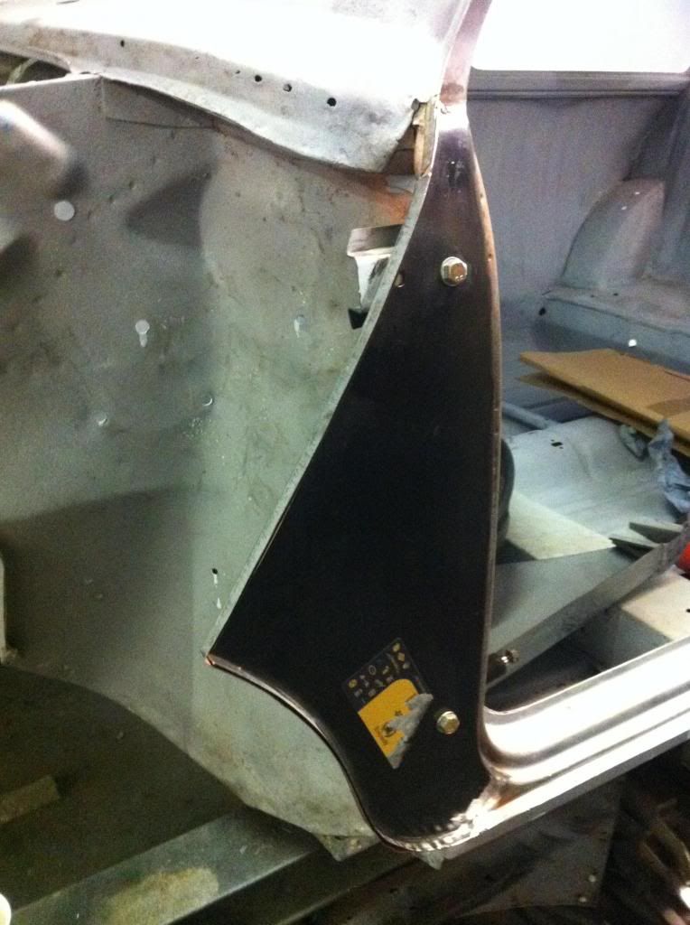

smashed the A panels on today, i must say, they fit so well!!

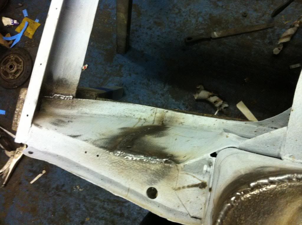

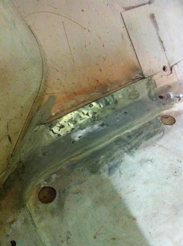

did a repair to the toe panel, hopefully i can finish it off so it looks like no repair has been made
the grey is not seam sealer, its an aluminium filler, basically normal filler that can be used on metal. its real tough, but not really ideal for a finish filler:P

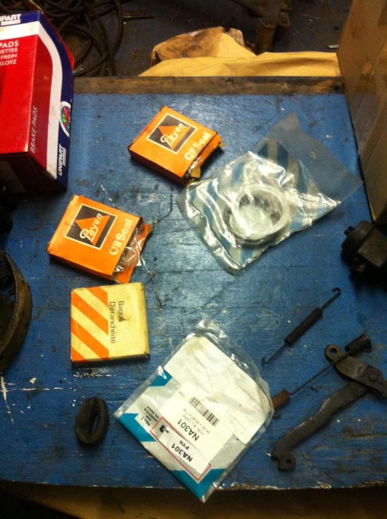

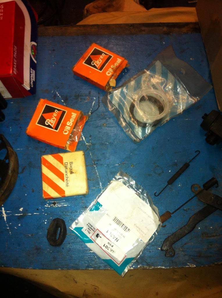

NOS seals for the front and rear hubassemblys

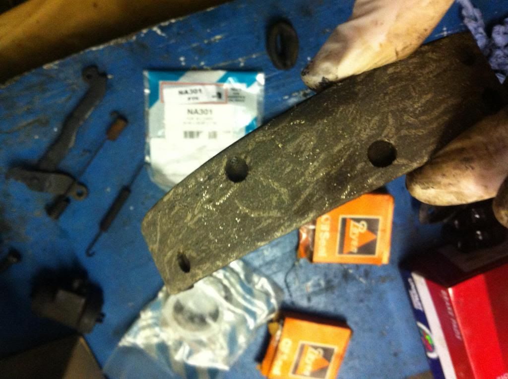

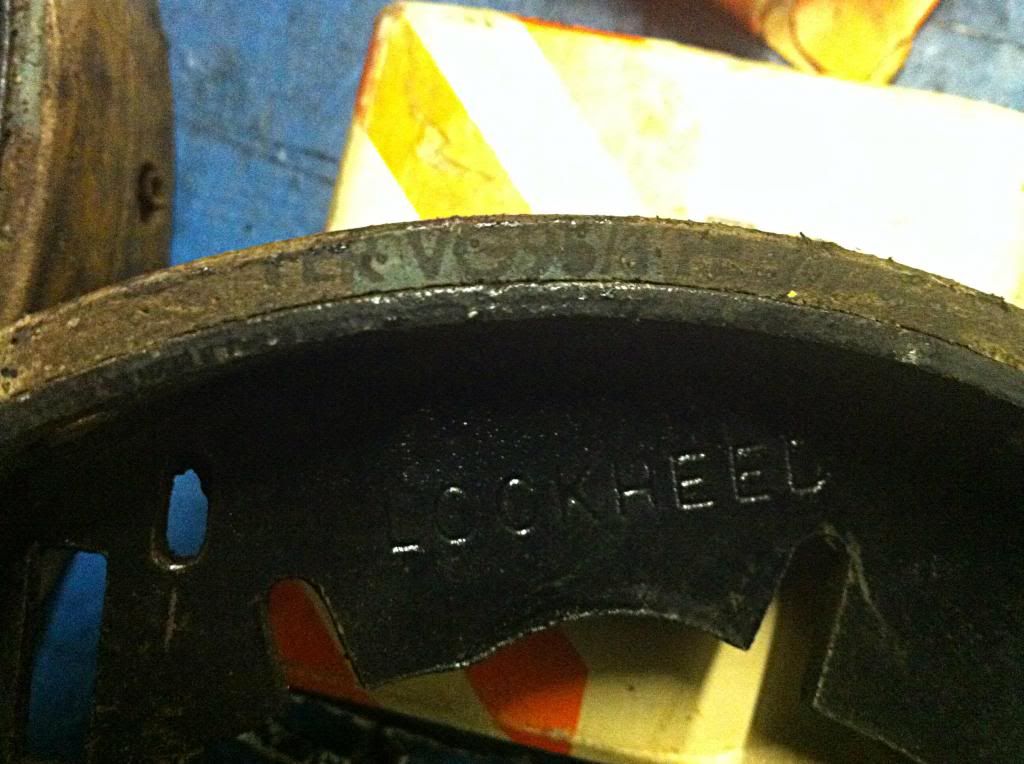

lockheed VG95 brake shoes, racing spec ;) in such good condition they can be reused :P
doing the other side sill tomorrow, then A panels and then tackling the BOOT FLOOR! AAAHHH. :o

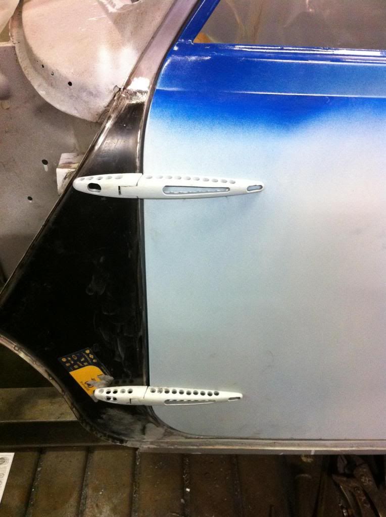

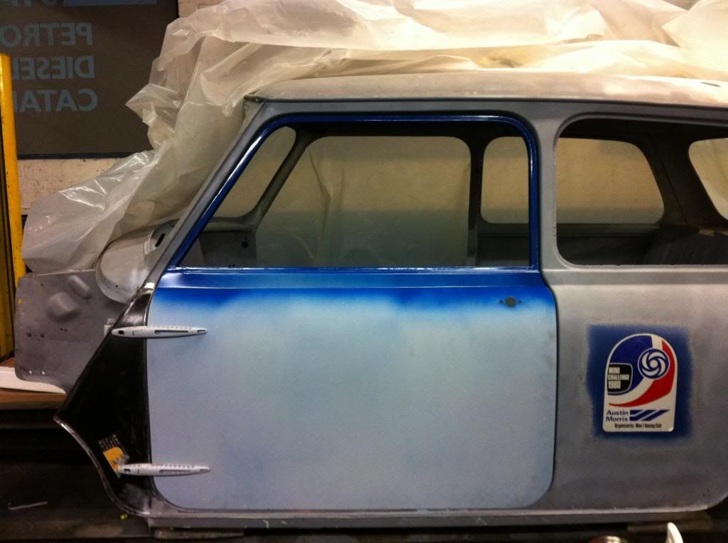

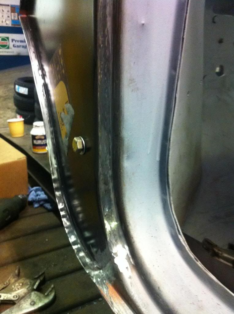

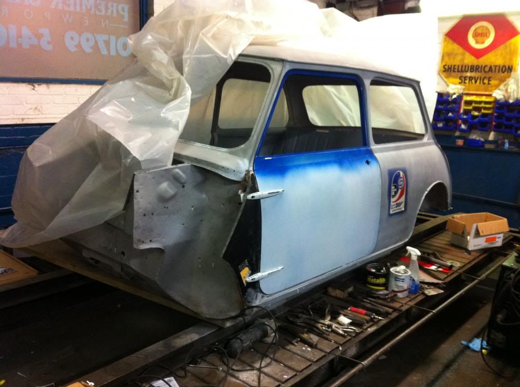

had 2 hours on it this evning. finished the A panel, spot welded the seams and took out the weld at the top using the die grinder. then fitted the door and made the gaps as good as. seeing as the pipe and gutter have been welded in ( possibly twisting the door a fraction) its got bleedin good gaps!!

Posted 29 November 2012 - 09:32 PM
Those door gaps look good AD. Those door hinges have had a wood pecker go mental on them. :D
