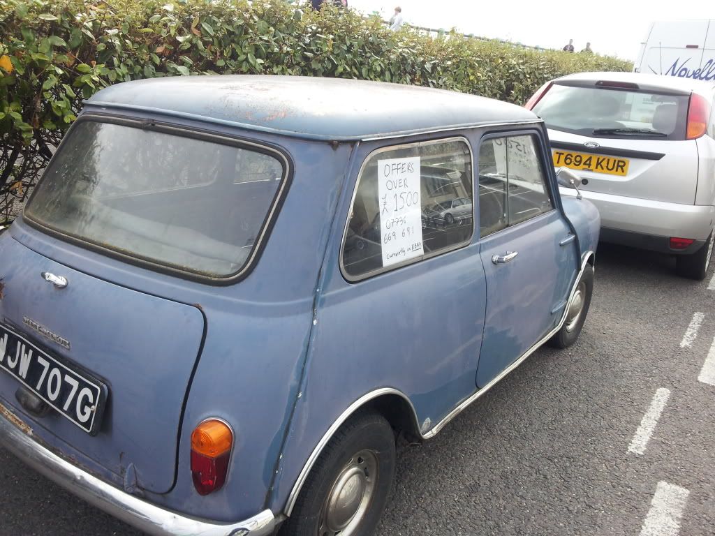

Yeah I missed it at L2B & bought it in June I think it was.
Anyway o/s floor all welded in -
