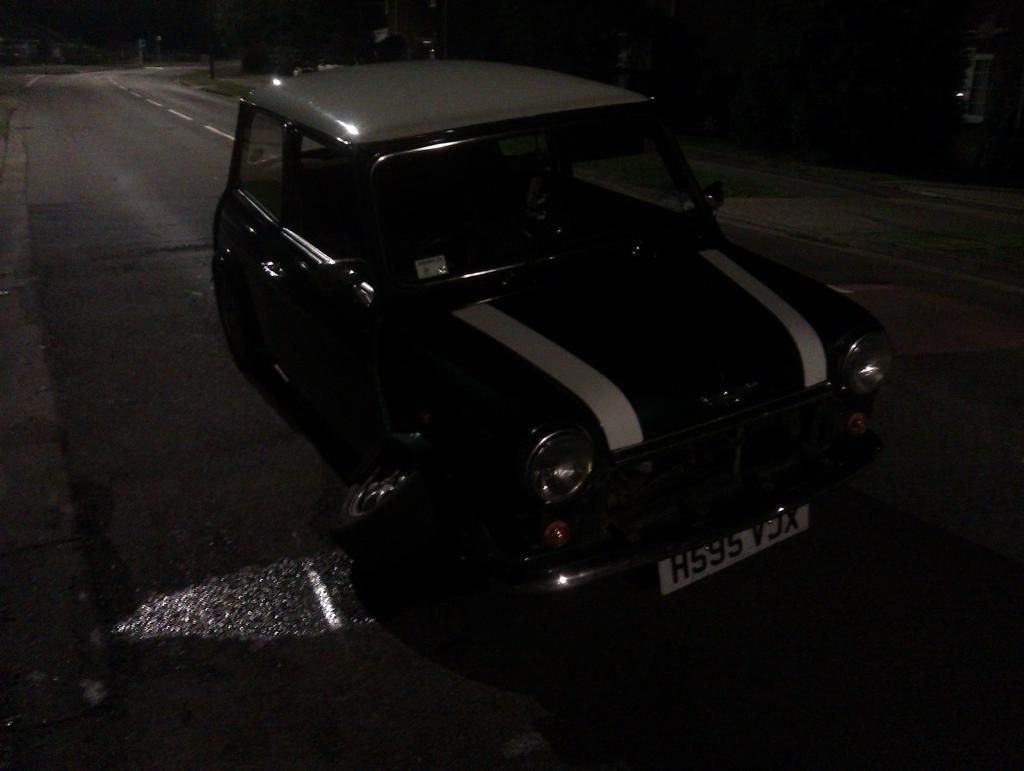

Ye my car defiantly has a problem with speed bumps
It actually turned out that the grease nipple part of the locking tab had broke off from the rest on the bottom swivel pin, so it slowly unwound until it snapped off >_<
Check your swivels people!!!

#70 patto
patto
  • 199 posts
Posted 22 November 2012 - 07:56 PM
HOLY ----
WHERE ARE YOUR HAZARD LIGHTS?!
Seriously though, that's a mega bummer.
That was about 3 hour after it happened the battery went dead (turns out the battery was duff too >_< ). It’s ok though it was a quiet estate at about 2 in the morning and one of my mates had his car pulled in front of mine with his hazards on.
It actually wasn’t too bad, I had it back on the road at 3:30 the next day :D just 2 new swivel pins and a new brake hose. Luckily when the gear box hit the speed bump it didn’t split it or anything just left a nice gouge in the bump :P .
Wow bad Times!
Though looks like that speed bump potentially saved your life!
