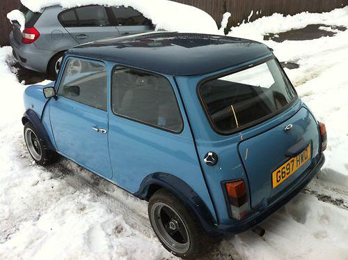

#11 wiffin
wiffin
  • 35 posts
  • Location: Cheltenham
Posted 18 March 2013 - 09:37 PM
i have a mini city for my first car, im 17 and cost me 1200 for insurance, and welcome to TMF :lol: and here's a pic of mine ;D
