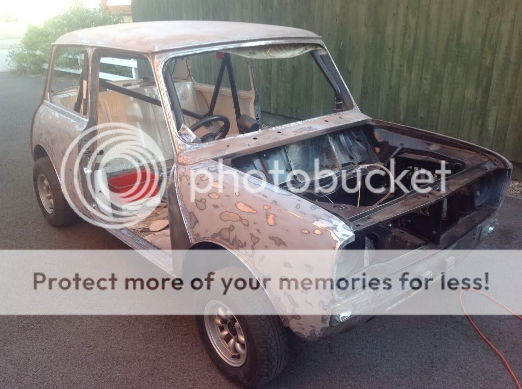

If that wheel arch looks a bit odd, it is because it was cut and modified to allow for the coil overs. Not the prettiest welding ( done years ago by a chap I knew at the time) but seems pretty strong. Would also say the paint finish looks better in the flesh! The ipad camera does not seem to get the light and colour quite right, or maybe it is might rubbish photographic skills?

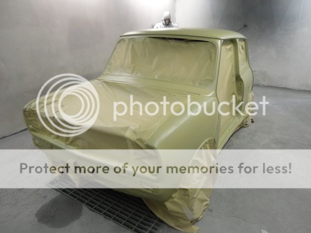

Unfortunately my mate who had been doing the welding work and was going to respray injured his knee, so plan B was required.
In the end bought a new welder and my Son and I have been filling various holes I had drilled when it was stage prepared and have now also welded in the air box. Have also bought a new fibreglass boot lid (double skin type) which I have trial fitted and fits much better than the old single skin one.
So now some photos
So air box in properly this time, not pop rivets and fibreglass!
Front cage, heater and instrument binnacle removed.
And bit the bullet and removed the headlining! Might regret that one??
Then made another phone call to get it booked in for respray, hopefully going next week.
Then it will be a case of putting it back together again........
