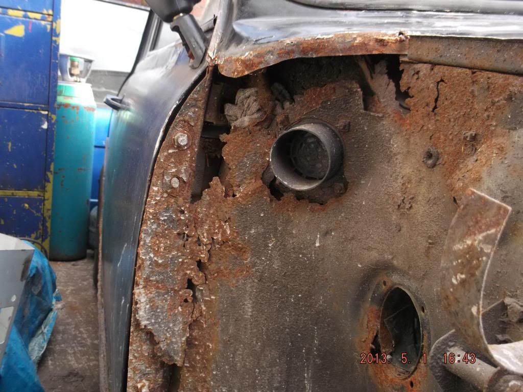

Now came the inspection of other parts that i didnt intend on doing yet i know thats never the case.
So heres more to add to the parts list....:

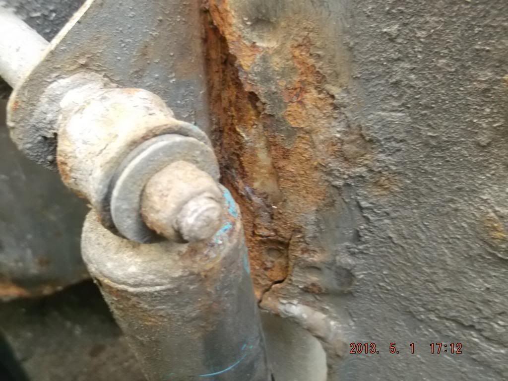

Theres no doubt a big rot hole behind the shocker mount & notice the crack in the wavy bodged inner wing, seems its been involved in a offside fender bender as innerwings err well (look at it haha) & the offside wing had NO spot welds holding it on, just more house hold silicon.
Has made it easy to strip though :lol: .

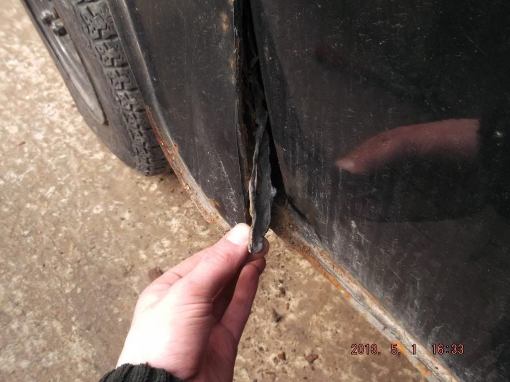

& finaly, a big mess i found under the car that im not looking forward to peeling off O_O
:ohno:
:cry:
For those of you who dont know whats wrong with the last two photos i shal explain.....
What you see above are sills running the length of the car, problem is these "un-vented" sills are a way of bodging a mini for MOT & not a proper repair.
Theres a cavity in there & it needs to be vented & allowed to breath.
These are the correct sills needed:

looking good mate i have those sills on my mk1 mini? are they the wrong ones? or are they like that? cheers tom
#15 rally515
rally515
  • 3,848 posts
  • Location: Lancashire
Posted 02 May 2013 - 04:41 PM
Cheers tom, i have seen mk1's with no vents & no ridges which i understand came 100% sealed on early mini's,
but you should go for vented all the way, these are the correct sills your after http://www.minisport...nfo_MCR95R.html
(NOTE: The 4 vents instead of the six that mk3- have.
Although you're gojng to be getting a whole new floor no doubt in your mk1 tom so you can get them pre-spot welded on the floor assy if you state to them (atleast you can with M-machine).
