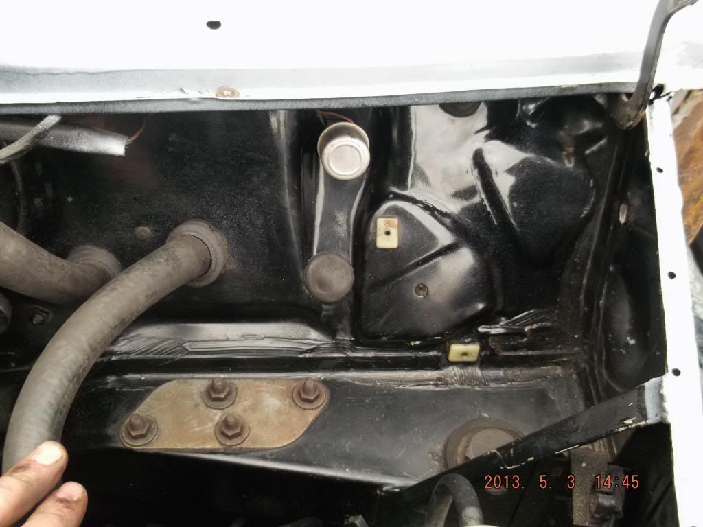

DAY 4
Hello again followers, had a late start on the checkmate today as job hunting takes priority.
So today as planned i clean the nearside bulkhead area up & got to work on the inner wing.
I got a little distracted soon after i finish preping the top mating surface on the inner wing & started removing the shock absorber & mount, soon enough it was off & i had krept over to "quickly do the other side".
Soon enough i found myself butchering the offside flitch panel i was planning on leaving but hey ho progress is progress ;).
So heres a few photos i have taken today:
First up, the bulkhead clean up:
Heres the bulkhead on the offside for reference:
Now here comes the graphic stuff, i hvent yet used any power tools apart from on the nearside wing so excuse the pealed metal haha:
Looks like some work on the inner sill's will be required:
Heres what came out of the front of the oversill cavity area:
Shocker mounts & mounting point so far  (forgot to picture the nearside sorry):
Wheels off & up on axle stands to make working on the inner wings easyer:
Whilst i was under looking in disgust at the oversill seam weld i thought id snap a picture of the diff area:
Thats your lot for today guys,
Thanks for viewing.
Cheers
Cliff
