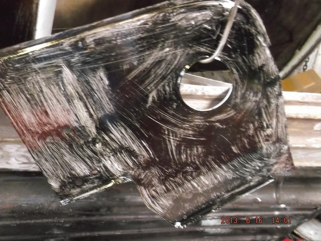

So as i said i would i got a bit done on the mini today, took delivery of a few bits and bats so the list is shrinking slowly :D ..
Started cleaning up the messy shocker mount area i previously butchered at in preperation for the new inner wing being welded in.....
Before:
After:
Need to re-make the
inner stiffener panel for the area first before i weld in the inner wing.

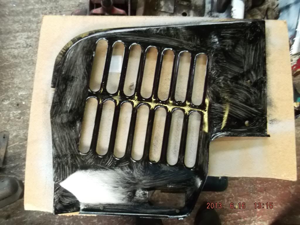

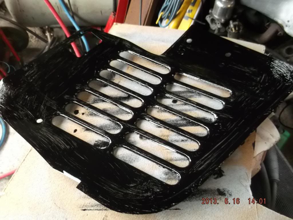

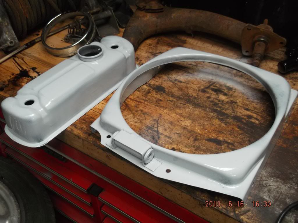

Got the radiator/shroud and rocker cover in primer and paint:

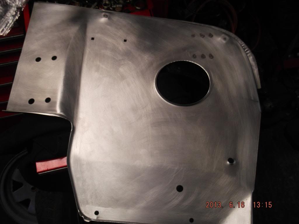

And the new inner wing being rubbed down ready for some primer:
After a spray in etch (dry's quite quickly), it got a brush over with some chassis black:

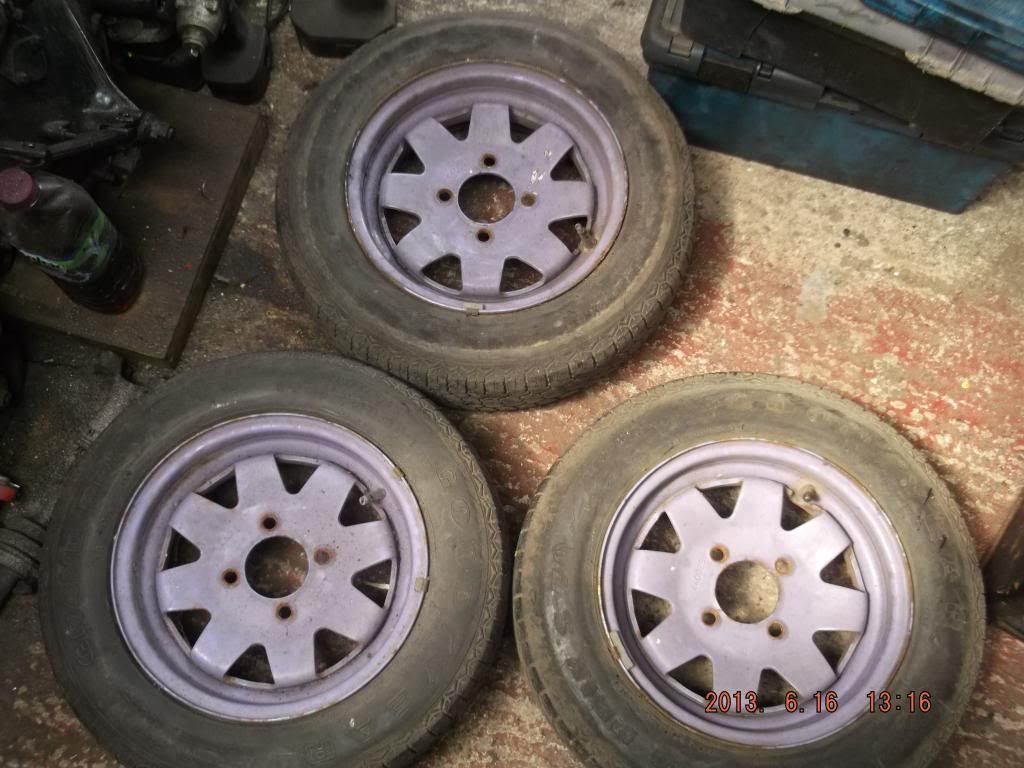

Also bought these purple circular objects O_O :

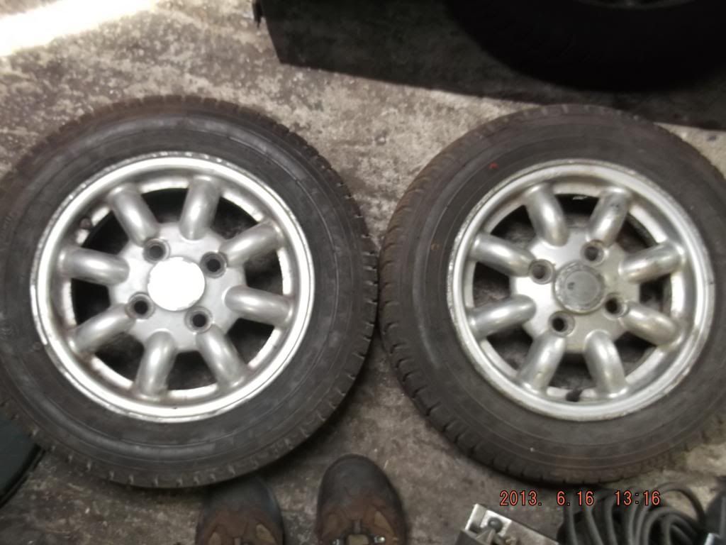

And a couple of RSP's;

x4 RSP wheels (Got two so far due to budget)

What model is this? An RSP?

Its a Rover checkmate of which is part of the red hot and racing green varient, i know they only made 1500 of each and they came with these wheels stock (Probably a money saving exercise by rover).
