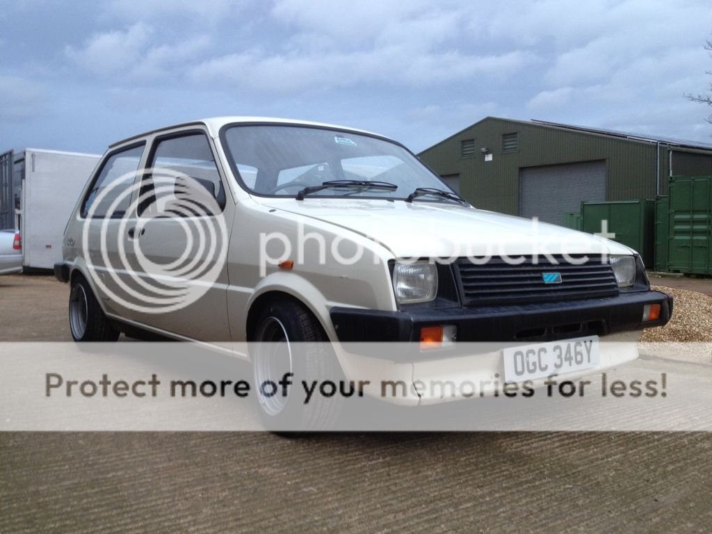

The bodyshell backwards from the bulkhead is identical, so from the bulkhead backwards its as simple as bolt off/bolt on to retro-fy things, the front end is built differently so some panel mods and welding is required, but will be far easier to retro-fy a later rover 100 to look like a mk1, than to modify a mk1 to fit a vvc in :)
These are my mk1s (blue 1 and beige 1 have gone now though)

The wings are the same to, as far as I work out the best way would be to cut the front 5" or so from the front of the wings to allow to correct recess, this is presuming you dont want the same arc hand body line crease line as the Mk1. The rest could quite easily be fitted, the front valence on the earlier cars is obviously welded and meets the wing but again this would be fairly easy with a donor Mk1 panel and some fairly simple fabrication. The bonnet should mount fine with the correct hinges but I'm unsure how the contours and bends differ between the Mk2 and Mk3, I'd presume the slam panel would need modification since the Mk4 bonnet for certain is more curvy, but still follows the lines of the wing.
I think fitting a later engine to an earlier car is better, more work and also destroys an A-Series powered classic, but its no different to converting a Mini to non-A-series, if any easier since you have the extra space of a clubman front and then some. To me a Mk3/Mk4 Metro/Rover 100 series is a very different car to the early Metro aside from sharing its shell. Even in an older colour like champagne beige or cinnabar red I just don't think it would look right. The Mk3/Mk4 also have different tailgates and I know these are not interchangeable between the two without a fair amount of modification.
