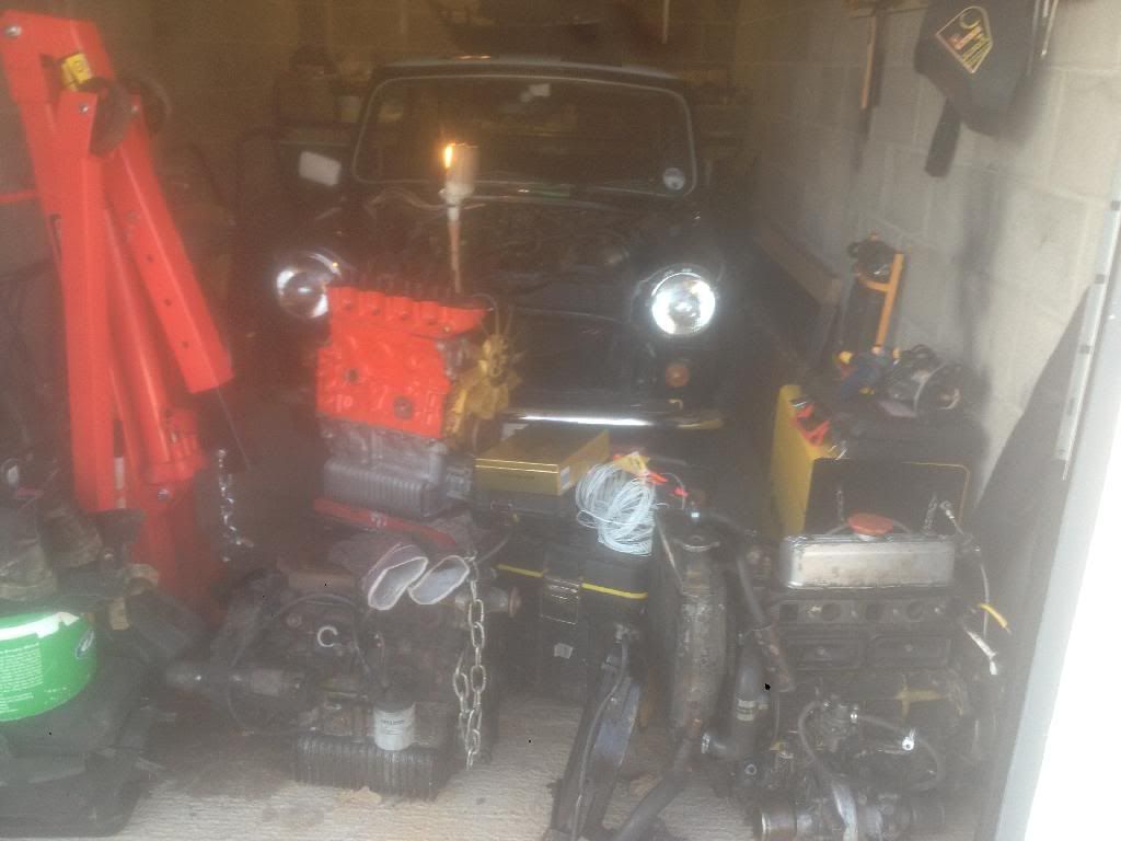

OK so started the day like this...
D7C15B1C-2713-4371-9748-738ACD6E6983_zps

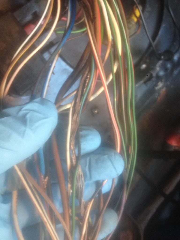

then after a clean up and shuffle of engines i got to the wiring loom...
47E702E8-C44C-43EF-B0D1-AEFC67CB064F_zps
E6D43DE4-68F9-45AA-B316-BA57AEA08243_zps
FC8CCA00-944B-4600-88F8-616FD70781FD_zps

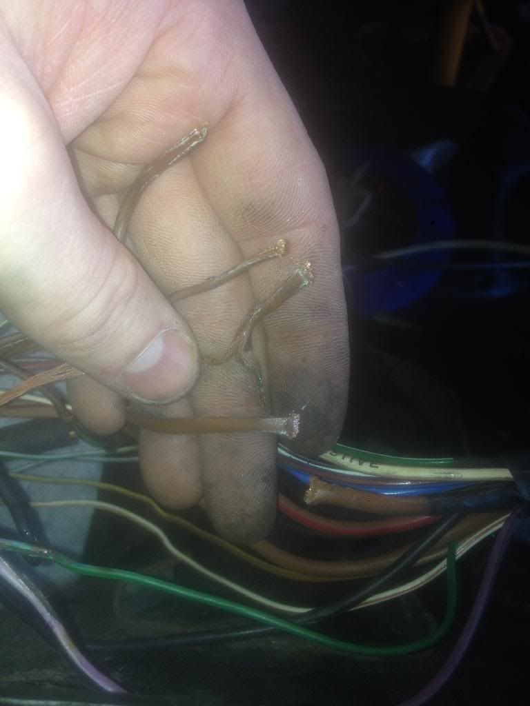

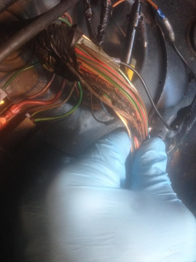

now i know they just look like wires... you can see in the first 2 is how shot one wire was... completely shed its insulation the whole way through the loom.
this did some damage in places to other wires but mostly shed its own skin.
from what i can see (and without a wiring diagram or the greatest knowledge reading them) the 3rd picture someone had spliced an extra 3 wires into one wire, i could tell which one was the original so i snipped the 3 extras out and repaired the 2 original halves.
i think there are some extras in here still... like the pink wire with insulation written on it... none of the other wires have writing on them at all.  I'm taking an educated guess that the previous owner fitted spots to the front but wanted all the headlight wiring to run them.

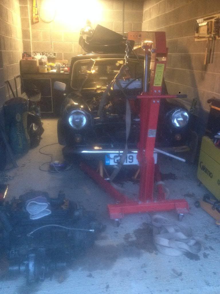

ive dressed everything over from my busted engine to the engine i got from mini_mezza .. . and lifted the engine above the hole ready for fitment tomorrow. I've fitted the speedo cable... I'm going to need to replace the CV boots... can i do this from the GB end of the driveshaft or do i need to remove the hub end ??

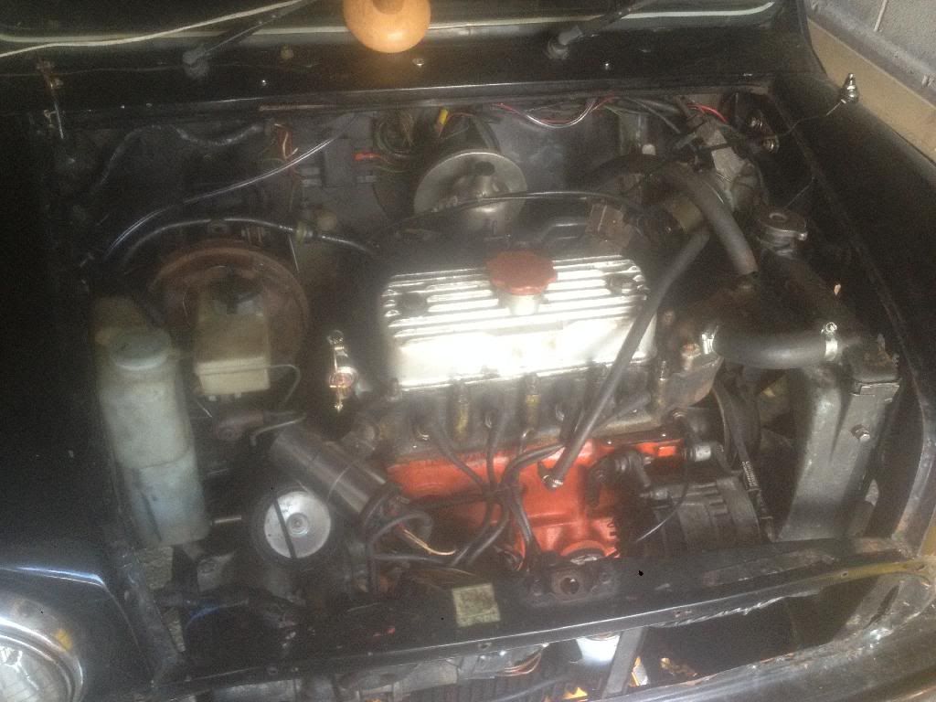

New year new post...
273723E1-1BED-44DB-962C-E9BEF4A46F63_zps
you've all seen an engine bay before.... i got the engine in and started with ancillaries. i have connected everything apart from the exhaust the fuel pipes the water pipes (of which i think i need a bit more...)  the problem is the festive season keeps me out the garage!! i put all my overalls on and walked out to the garage yesterday with the mother of all hangovers ! i looked at starting work... took my ovies off again and went back to bed. today might not be that much better but I'm aiming to get fluids (clutch brake oil water) topped up and bled tomorrow then we can try starting her!!
I've already booked the car in with a local a series guy to rolling road setup the carb :) she should run lovely !! i hope  O_O
