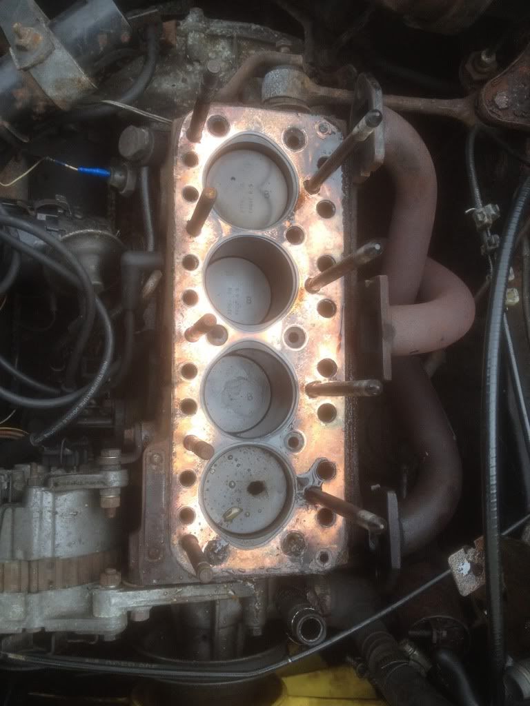

WOW this went from a daily to a project at the rush!! whipped the head off to finally se why she broke down... anyone spot a problem
0DB20C31-04E0-42A7-95A2-EDEEC7200E83-654
so lets start shopping for a new block or engine....

i'd suggest +40 pistons and rebore

LOL what caused the hole? Ignition timing out or running too lean?
I had the same on my first Mini but the hole was near to the edge. I popped in a second hand piston and used the car as a daily for several years (poor student).

might have been runnoing lean i never set the carb up fully after putting the new needle in, i was waiting to get a colour tune.
block out and rebore followed by de coke rebuild with new pistons is an option,
however ive just found a 1100 metro failed the MOT for bodywork engine still running in it for £150.
i question if option 2 would actually be cheaper...

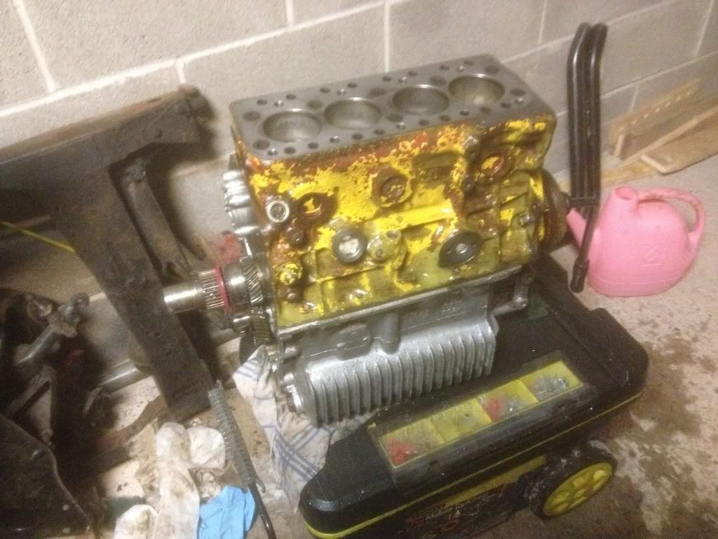

i spent the whole afternoon cleaning the 1098 block, i removed the flywheel and chutch housing, cleaned all the mating faces, cleaned the majority of the old paint off (enough that theres no flakes) i de coked the top with some scotch bright. i re drilled the water circulation holes that had some corrosion in them that would hinder coolant flowing... and finally after degreasing the whole engine ready for paint at the weekend i put a tsp of engine oil into the cylinder bores and turned her over by hand to keep the cylinders lubed...
19C63C37-D461-4F80-8037-CEFBFFFDE686-141
ive left the timing chain cover on im not going to mess with the timing! :P im worried enough about making sure the dizzy is in the right place !!

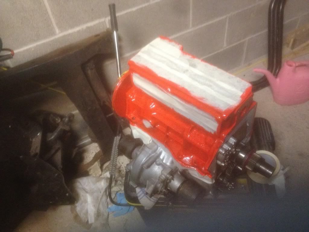

Posted 03 November 2013 - 06:50 PM
oooooh.... engine has had its first coat...  +10BHP for being painted red!!
