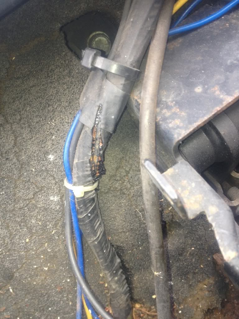

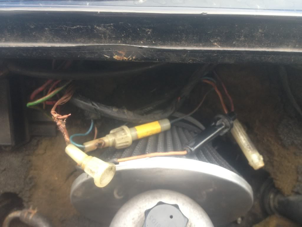

F2C6397B-A043-450C-975C-C3F1714C4F55-4099827D305-FEB7-4754-B3A0-53B21B934D46-409
OK so i Replaced the fuse wire behind the carb!! but the first photo has a slice out of it and im wondering if this is why my Tempurature guage has stopped working ?? I REALLY MISS MY GUAGE!! i feel its the most important one!!
any help is appreciated... theres no diagnostics in the Haynes for no temp gauge !!
Filbey

When temp gauge and fuel gauge both stop working, that could well be the voltage stabilizer gone.
Check by earthing the senders if they work, green-black wire at the fuel tank is the sender for the fuel gauge, green-blue at the cylinder head near to the thermostat is the sender for the temp gauge.
