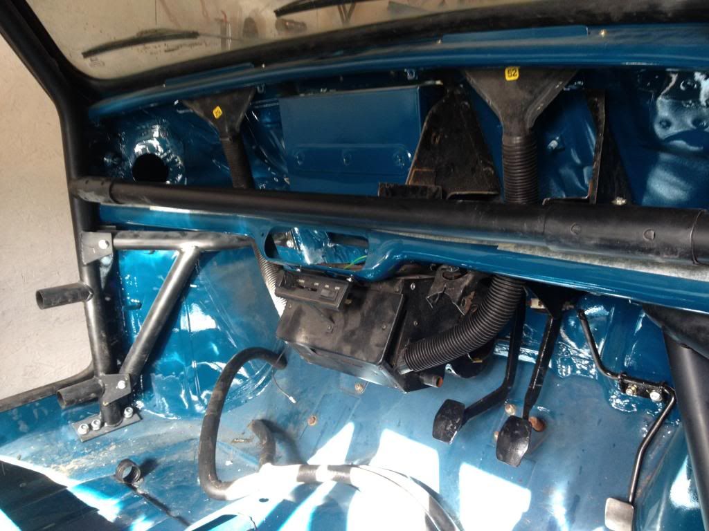

All in all iv had a productive day, hoping to get the sump guard fitted tomorrow. The dash board is my biggest problem, need to build or lend a sheet steel folder. My first attempt just won't do ;(
Things are not made easy with having the front cross brace, as i have done some measuring ill be sketching some dashboard designs tonight i think, wish me luck ;) i'll need it !

Fitted a s/h heater system as the original was goosed

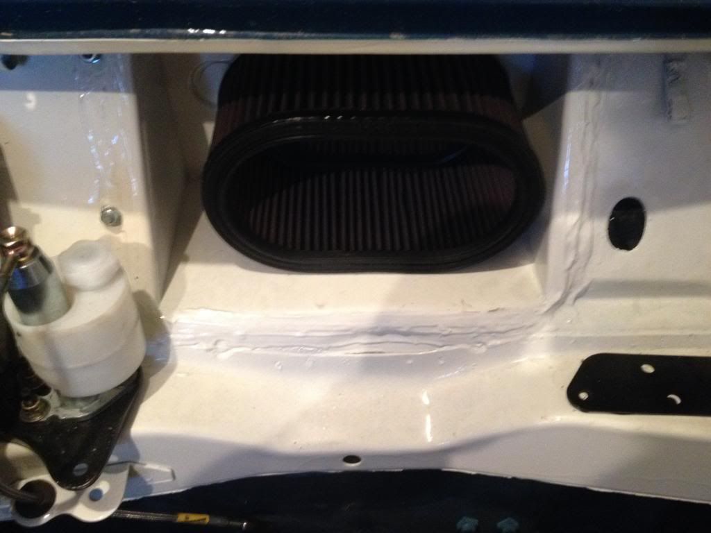

As I'm getting closer to fitting the engine, i am getting more and more concerned if i will acutely be able to get my weber, manifold and K & N in ?????????? I have taken a couple of photos and hoped someone reading this might help. Iv pushed the K&N tight to the back of the air box to give you an idea on how much room i have.

Thought i would ad it is a 5" Maniflow steel inlet manifold.
