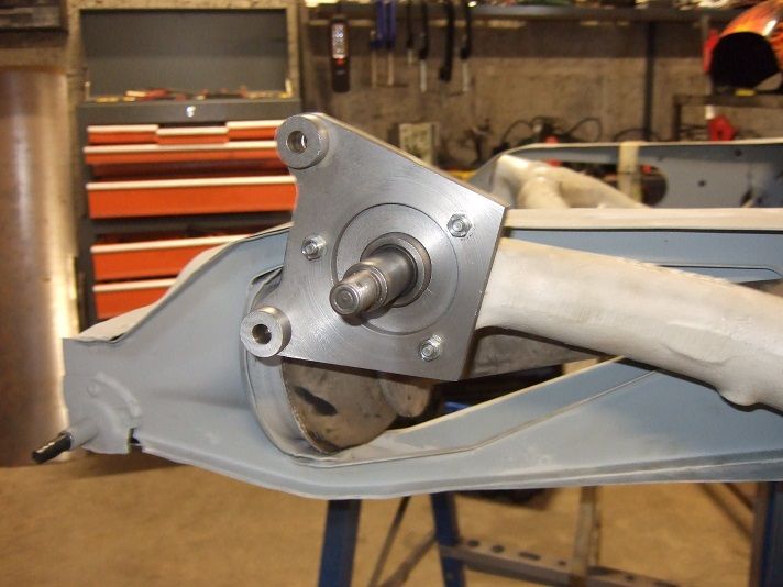

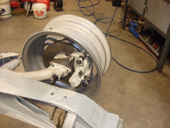

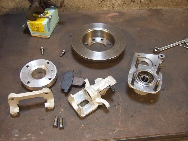

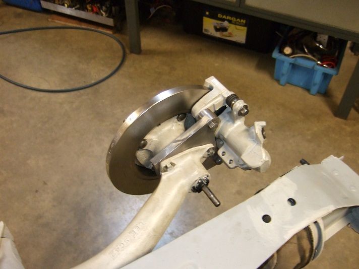

I’m making one.
Thoughts? Criticism?

The biggest problem with that is that as the rear brakes only do around 20% of the total braking on a Mini, those brakes will never get warm enough to work efficiently. How will you find pads soft enough to operate at those really low temperatures?
If rear discs are wanted to reduce unsprung weight on racing Minis, a thin motorbike disc system would be best from a small lightweight bike with thin discs and small pads. If this is not done they will never work properly.
The rear brakes on a Mini really do virtually nothing and are only for passing the MoT, parking and, if the need exists, for handbrake turns.

...it also looks heavier than the standard drum set up.

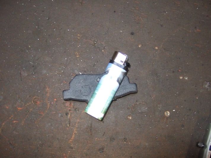

Oh, the pads are quite tiny

edit - looks like it has an handbrake crank on it - so ignore that

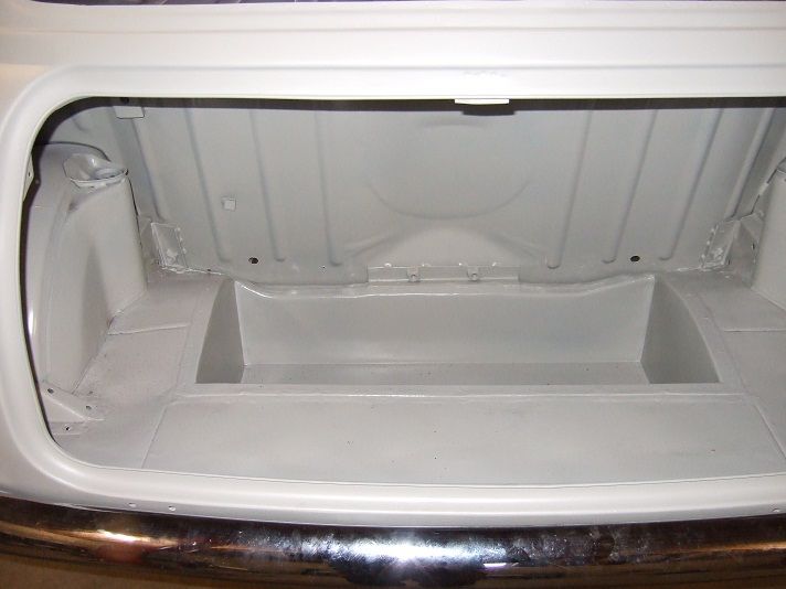

Rear brakes in my mini will actually have some, except from rusting, work to do. I build an electric mini.
I’ll be carrying 100-150 KG of battery worth extra weigh in the trunk at all times.
