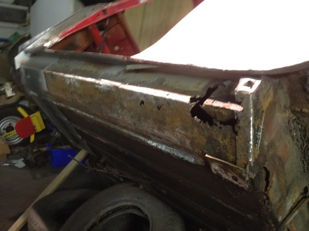

Thanks mate, Dose that assembly include part of the floor pan aswell? If I cut out the floor pan aswell will I not have a problem with trying to stop the chassis from distorting/twisting after removing so much structural components.
Just peeled back some of the over sill in the corner and found some filler and a hole going through to the rear seats side pocket on the offside.
On closer inspection opening up the hole and looking down the inside of the sill (very small visibility) the inner sill only looks corroded at the corner at the rear and some at the front but further in it looks like its primed. If this is True if at all possible is it acceptable to remove the outer sill etc and just remove all the rust from the inner sill, patch any bad/missing material and then fit new outer sill or would you just replace the inner sill also.
I can feel a project coming on now. I originally wanted this mini to learn the ropes of mini ownership and just have a rough and ready run out for the weekends then maybe take on a full on restoration once I had learn a few things but if I cant have that then I might aswell just in the deep end and hope for the best.

Personally if it's not your daily driver I would remove the over or outer sill on the worst side that you suspect, with a grinder it'll only take you an hour or so if you have never done it before, then inspect what is behind, if you have over sills fittled you may find the original outer sill if not then you will reveal the inner sill or technically the floor (as there really isn't an inner sill it's actually a fold in the floor that helps create the box section, but easier to call it an inner sill)
I would then post up pics on here of each end and the middle so we can all help and advise you on which panels to buy and the best way of fitting them.
Remember take it slowly with the grinder so you only cut through the layer you wish to remove

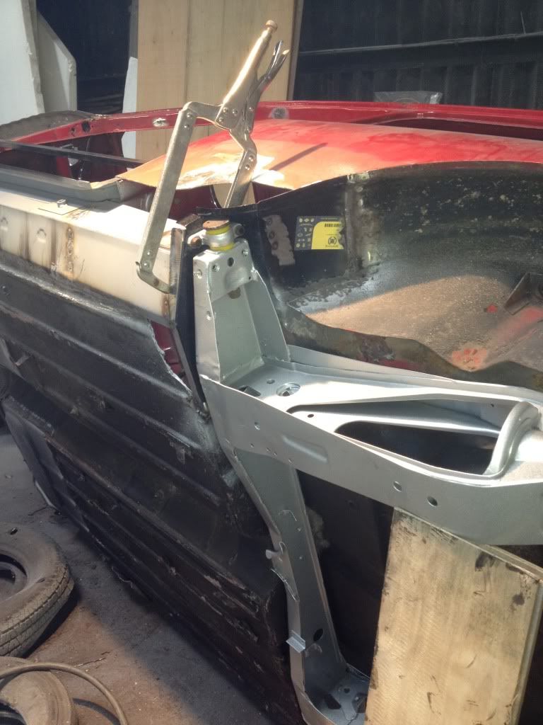

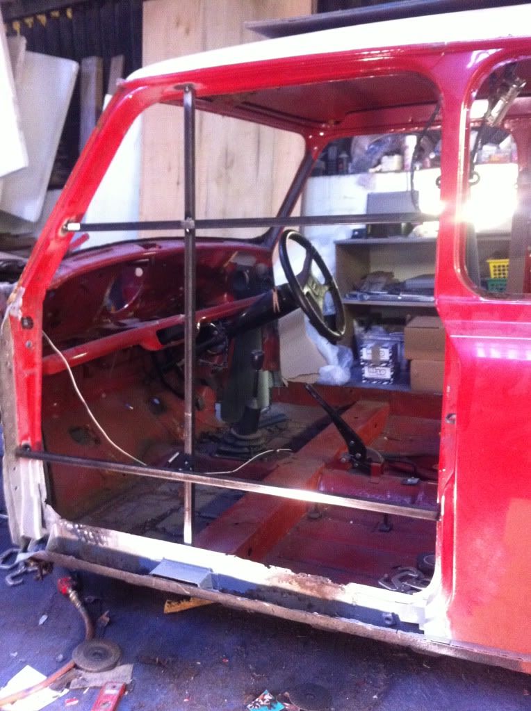

Here's some pics of mine
With the door step removed
Inner sill or really the floor
New inner sill and heel board end going on
Outer sill back on
Hopefully this allows you to see where best to cut to remover the outer sill, when I did this one for speed I cut along the underside seam where the doorstep and outer sill join with a grinder with a 1mm disc then due to having over sills fitted the oversill had been fully seam welded tl the floor so the easiest way was to slowly grind through the weld and peel it back
Hope this helps

If you have a look at the thread Wills Mini Special in the Prihects section you will see exactly what and where you need to do. This includes bracing etc.
