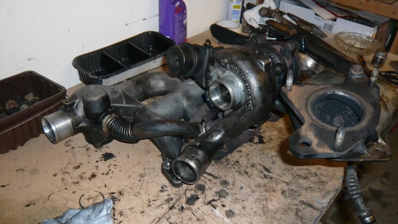

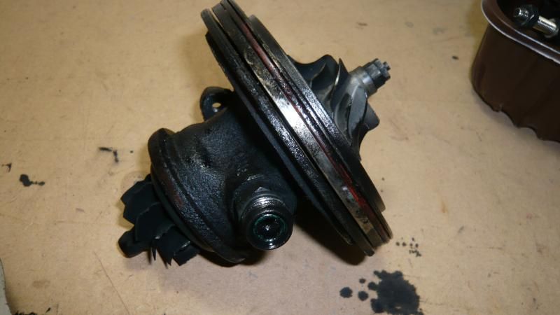

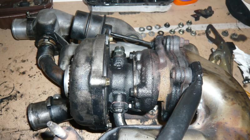

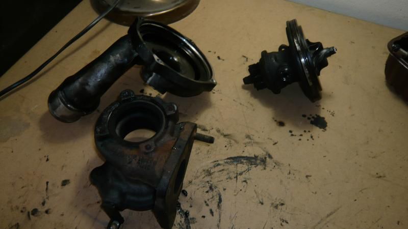

So i split the turbo today
And this is the CHRA which i can hopefully rebuild when the kit comes through.
I stupidly started dismantling it without marking the corresponding positions of the castings but luckily, it was so gunged up that i could easily see how it went, bolt it back up and then scribe the positions. Phew!

I stripped the castings off on my turbo with nothing more than a 10mm spanner and to strip the CHRA, i will need a pair of circlip pliers, a 10mm spanner and an 8mm spanner. Oh and perhaps a flat screwdriver and a punch.

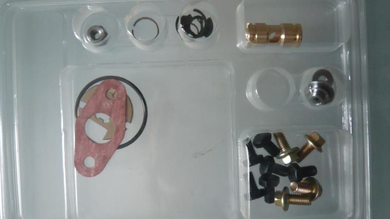

Ok so i received the rebuild kit today and decided to tackle the turbo.
This is what the kit comprises of
Fitting the kit was one of the worst experiences of my life. Well getting the turbine shaft out was...
You are supposed to un-do a nut and gently tap the shaft out. Unfortunately the shaft had other ideas and had fused to the turbine.
I tried wd 40 which didn't do much and then resorted to heat. After a while, it dawned on me that the threaded end of the shaft was in fact bent which is why it was stuck on, so 2 hours later i had it off.
The kit fitted ok but once reassembled, i noticed that there was still very very slight axial play. I think this is due t the fact that one of the piston rings was the wrong one so i had to re-use one of the existing ones. Luckily, it was the other one that had worn right down so it's not too bad.

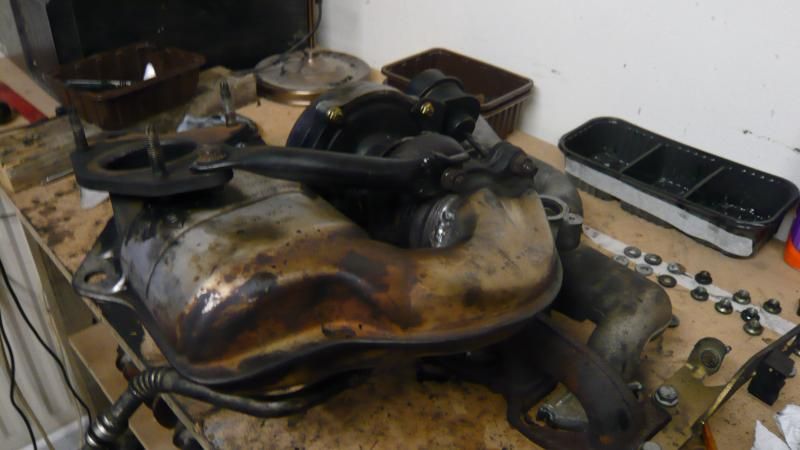

Here it is assembled on the bench.
Fingers crossed.....
Ben

Remember the O-ring that needs to go on the union

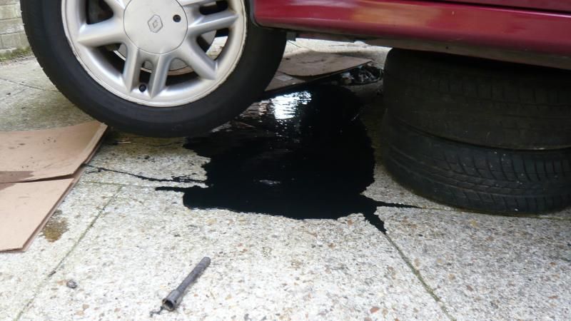

Well that was pretty much a waste of 4 days and £40.
Its all back together now and runs but this happened.
f ing car!!!
Found the problem quickly, It was the magical O ring on the oil feed union to the turbo. The O ring wasn't fitted correctly so it was literally pouring out.
So i wasted an hour clearing it up and sorted the o ring.
Leak fixed and i ran it up again.
