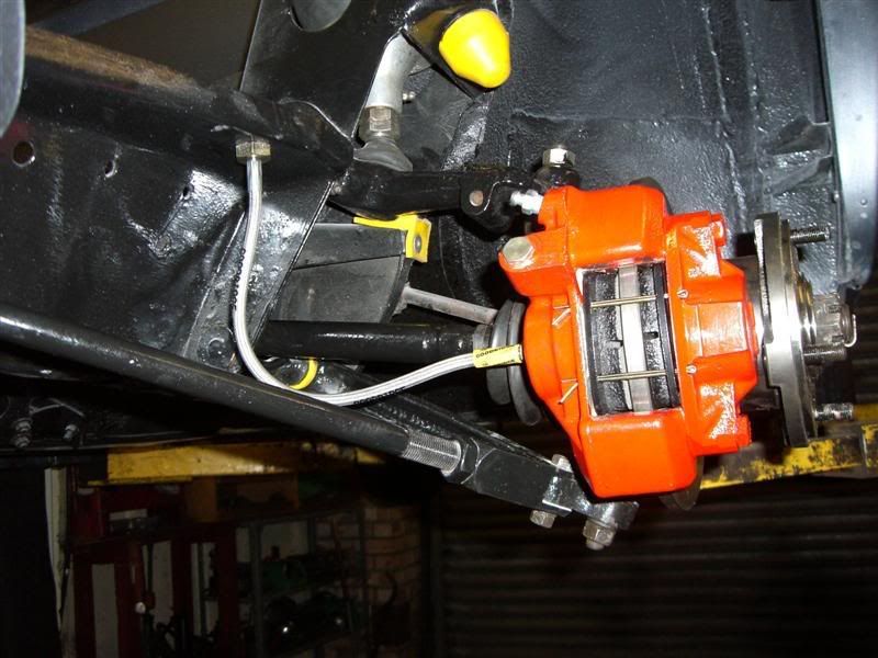

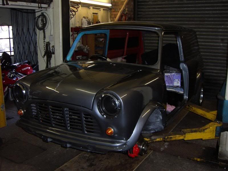

Yes thats right, I put two back wheels on. I was all lined up to bang the cooper S setup on, and it all turned to poo. The driveshafts and hubs are a good set from the mpi I broke up. The brake discs went on, but when I tightened the hub nut, it locked the disc from moving. Which is obviously not an ideal situation.... Rang a couple of people, and nobody could explain it - except slyoldfox, who told me that the mpi hubs are different. Bugger. So tomorrow I've got to sort another set of hubs out and hopefully I'll be able to get front brakes on it.
