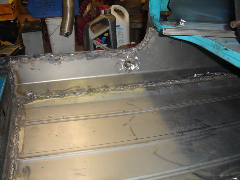

Finally got some pictures today. First is the floor repair we made, and the inner sill. Just need to give the gap between inner and outer sills a good coat of hammerite, then the outer panel can go on. Feels like real progress is being made! I'm picking up a floor panel for t'other side off dogmatix tomorrrow, so that side should be easier. Then the postman arrived, and made me a very happy man. Last 2 pics show what turned up.

Driver's side is getting there now!
next item on the agenda: turn it round and do the same for the other side - floor, heelboard, inner + outer sills and that side plate. I got some wood and pickett arches today from slyoldfox, that must have been fate! Got one door to re skin, and repair the front wings where they have been cut out for 13"s and the welding is almost over!

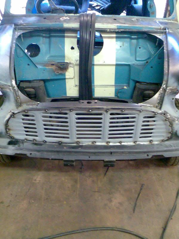

Grille is welded in:
Just need to clean it up now. I made the final fillet I need for the body at the front end, its starting to come up really strong now. I've also started cleaning up the panels I got from Tjenkos to repair the front wings. I didn't realise how much had been cut out of them until I offered these panels up. I dont even think sportpacks would have covered the gap! Now I need to weld in a blank in the other repeater hole, and plug two small holes at the front, and the flip front is about done. (I think)!
