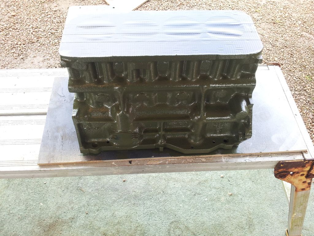

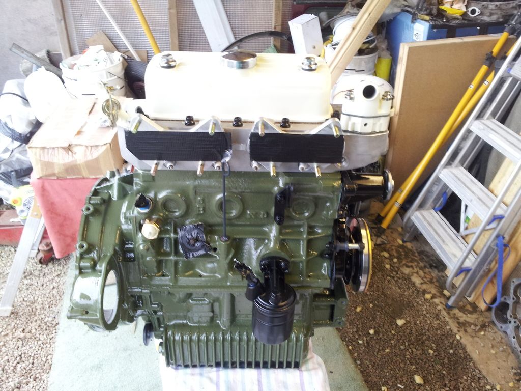

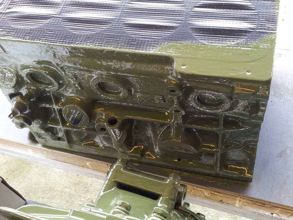

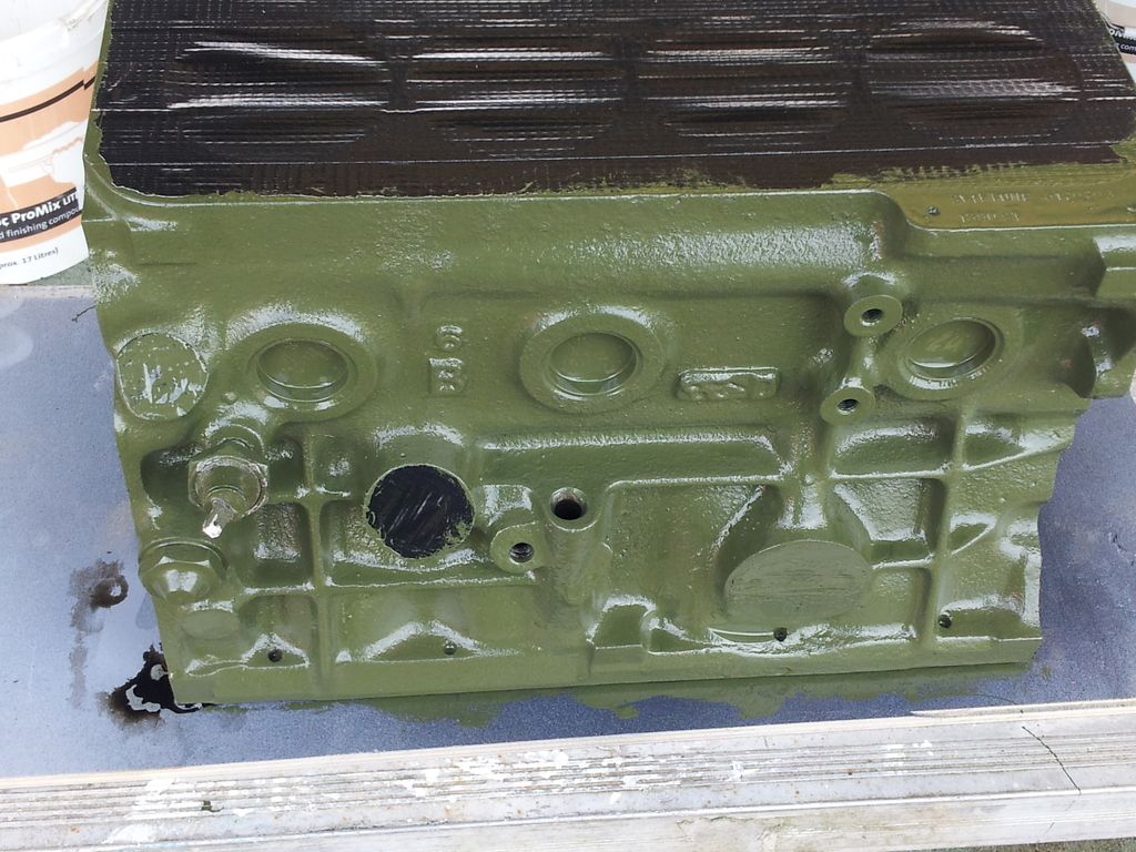

more done today......block degreased and washed out........
then masked the block and applied 2 coats enamel.....
block done

What did you use for the block degreasing?
Are you going to re-hone the bores or just reassembling as it is?
Hi..no not rehoning as its only done 9000 since built by Swiftune.....
and I used this stuff............   http://www.holden.co...m&pCode=094.921

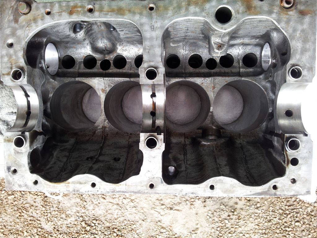

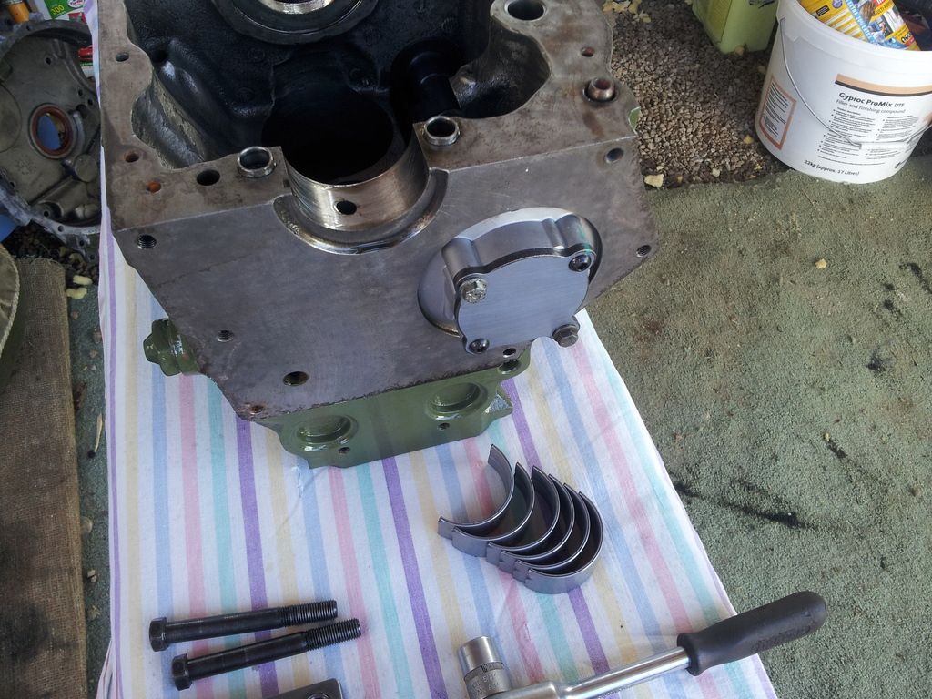

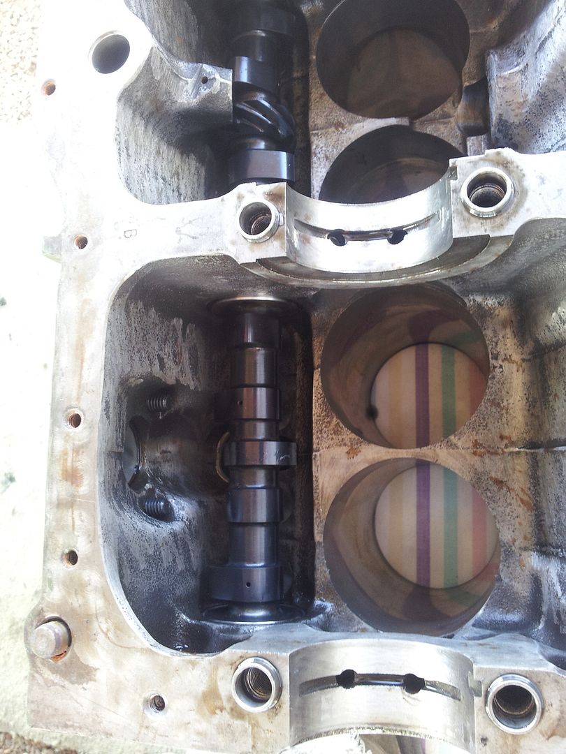

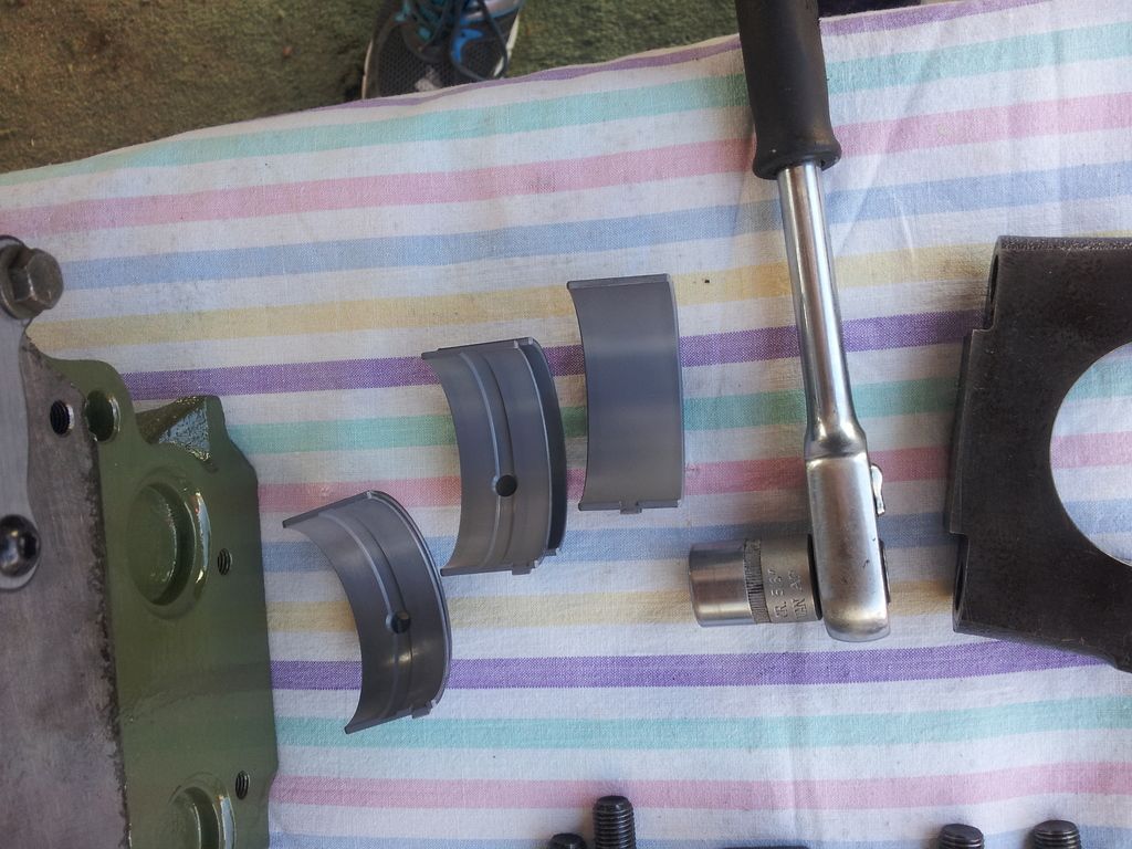

Bearings finally arrived from MED and made a start on rebuild........New Swiftune oil pump fitted......
New SW8 cam installed.............

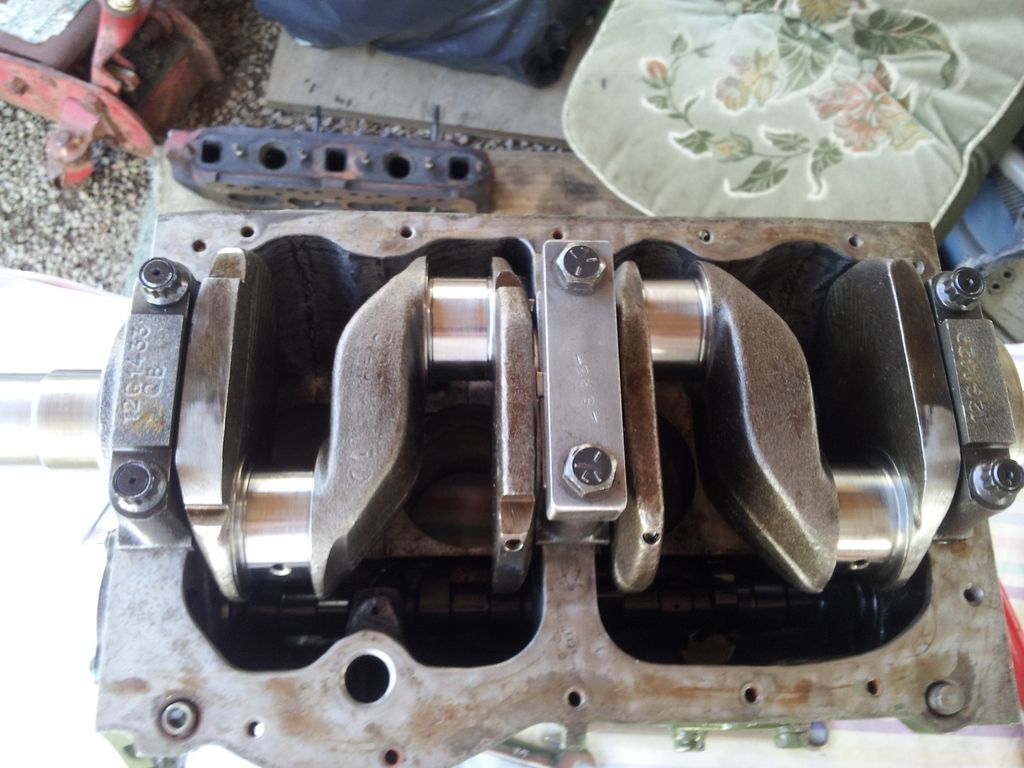

new bearings fitted to mains journels and crankshaft fitted..............

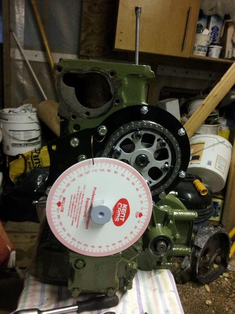

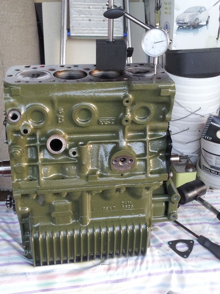

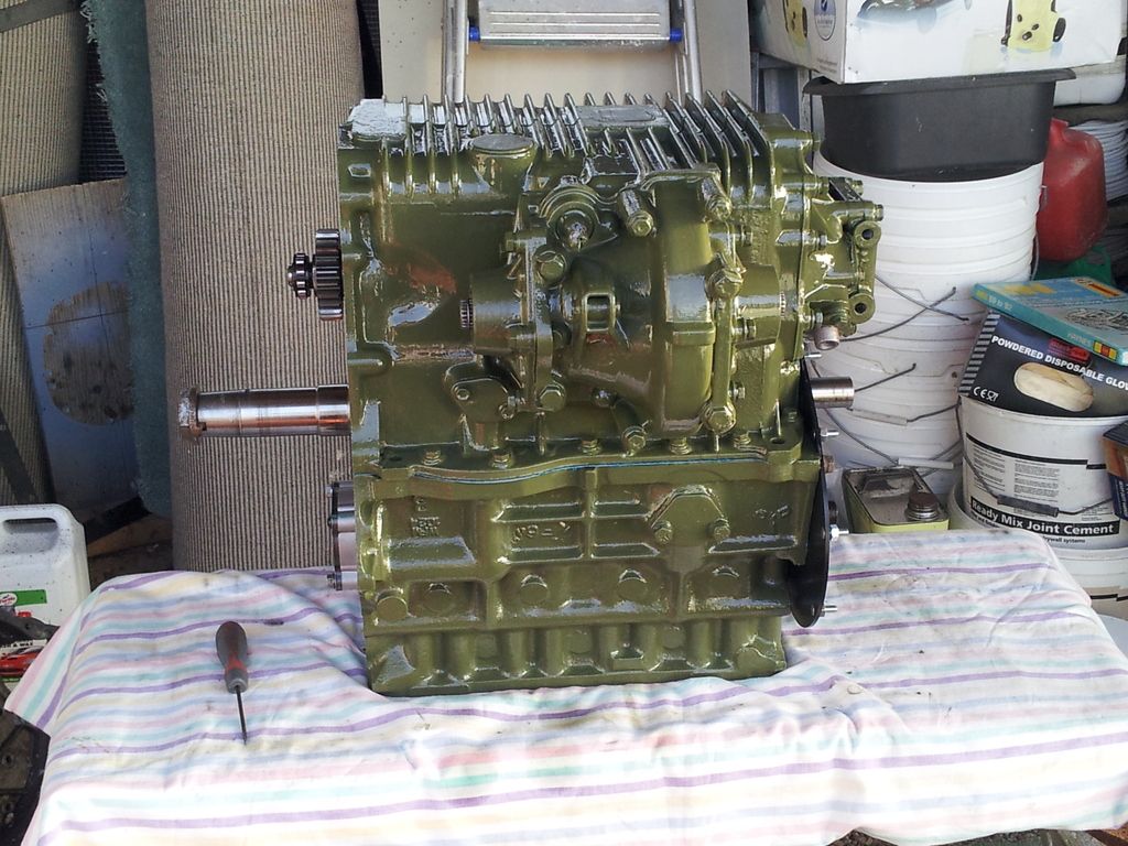

Fitted pistons and New MED ally  timing plate.............
then mounted G/box to block.......
and then set timing up......
Cam timed in........
Rebuild%202%205_zpswynscs0d.jpg.....
so far so good....

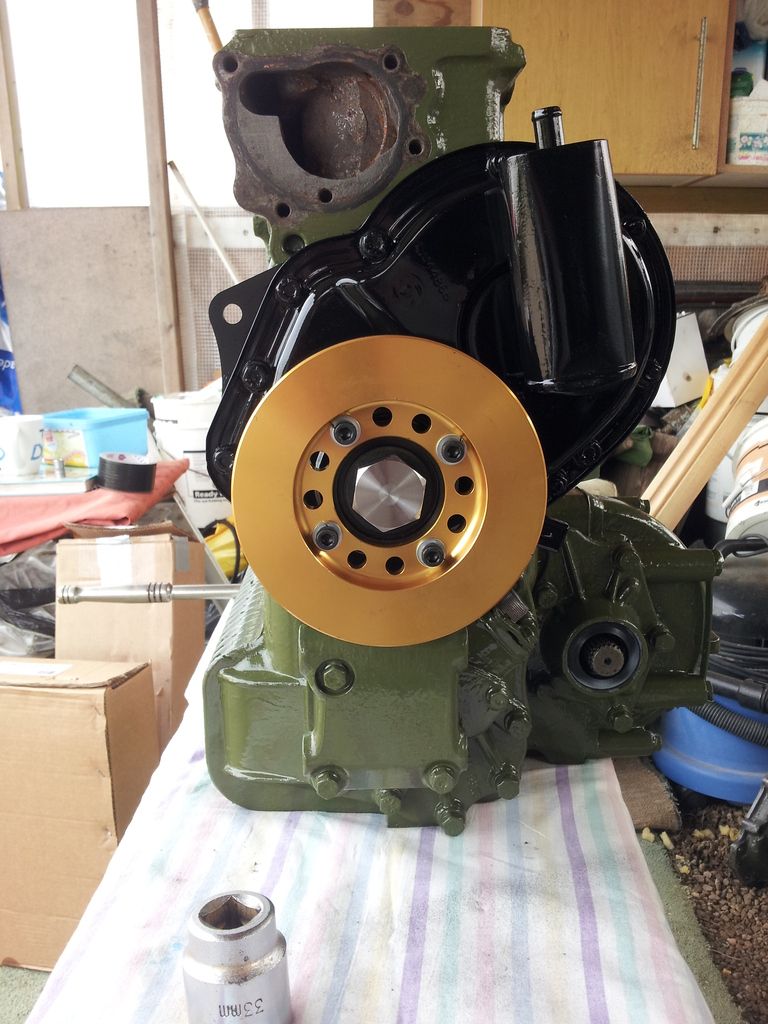

Fitted timing cover and New MED pully.......
fitted primary and transfer gears and clutch cover.....went to fit new Lt flt and plate but no verto center in kit.....lol and I dumped the old fly.....DOH

I was advised to clean the coating off the lobes from the cam before installation.
#40 mk1leg
mk1leg
  • 9,343 posts
  • Location: Jersey
Posted 16 April 2015 - 10:25 PM
Hi..I throughly degreased the new cam before fitting........

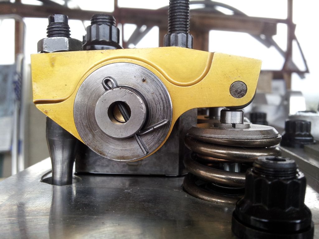

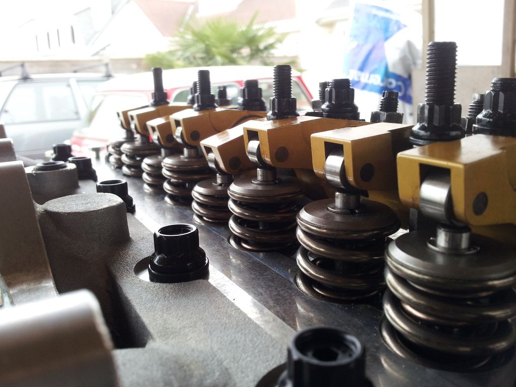

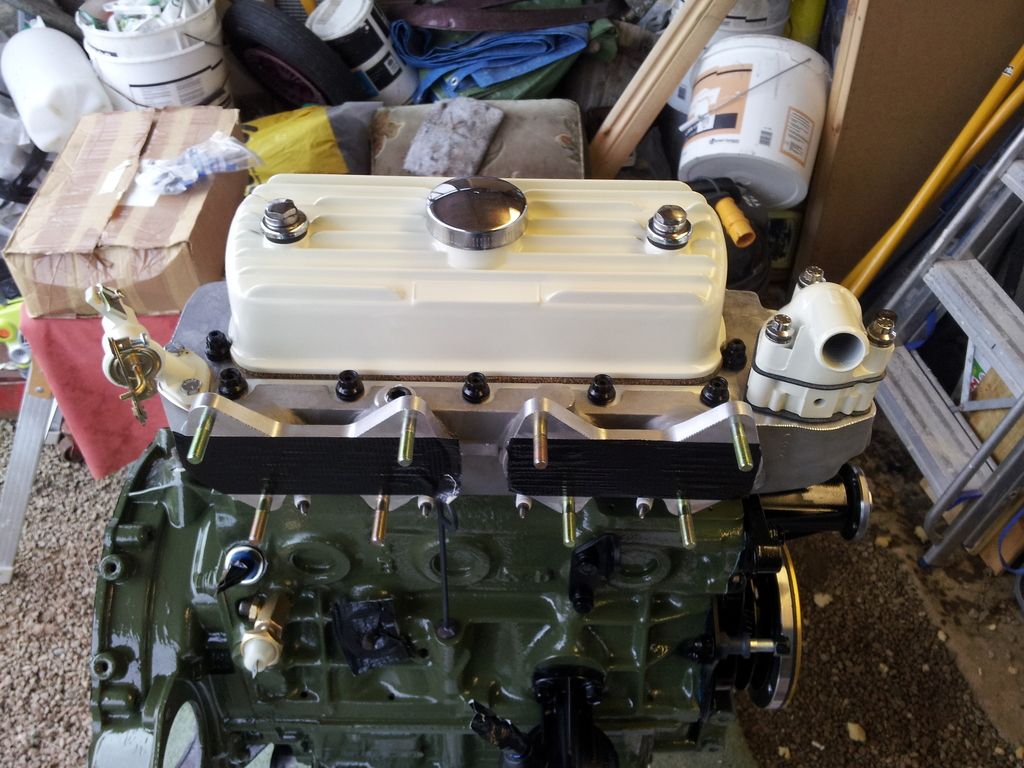

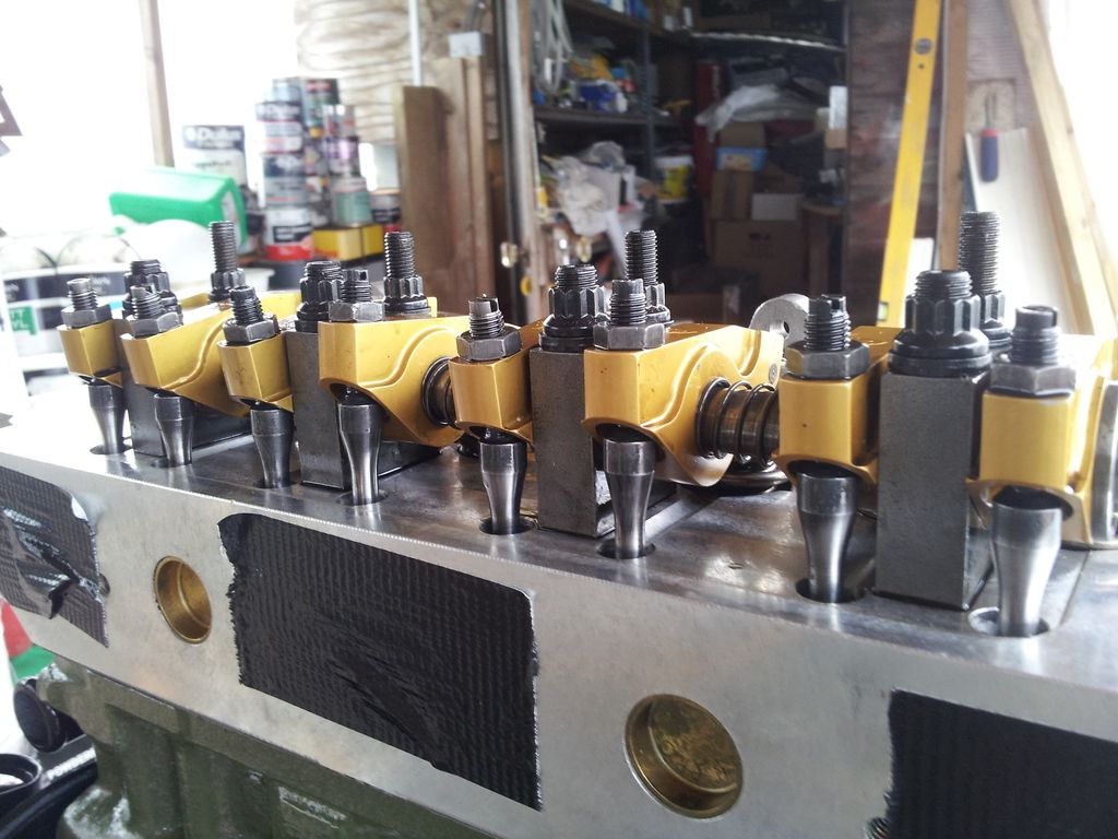

Hi..Fitted new 7 port head to block with new MED pushrods and fitted rockershaft and torqued head down set valve gaps............
also fitted water tap, thermostat housing, water pump, rovker cover.........
just awaiting new verto flywheel center as dumped old fly....lol

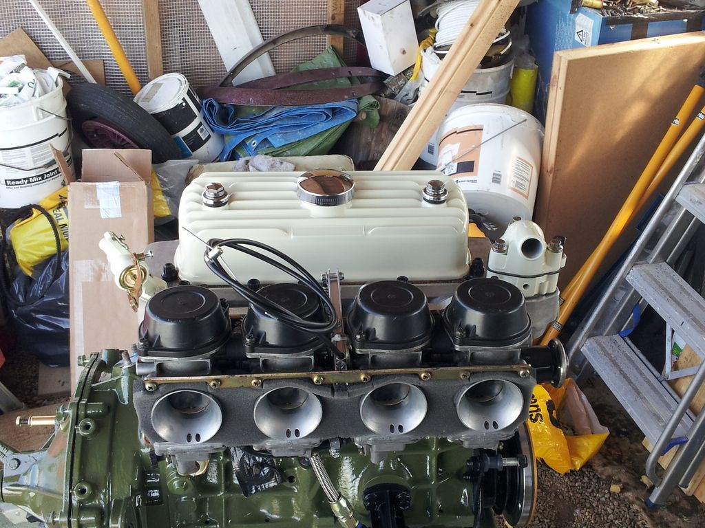

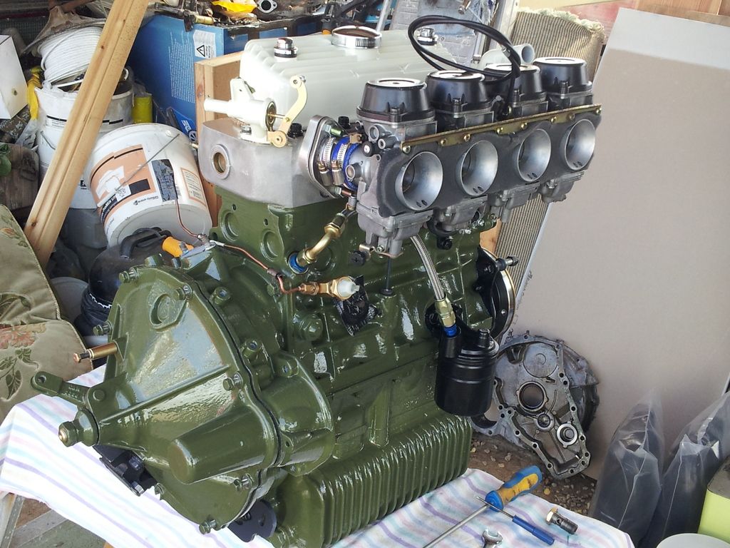

today I test fitted carbs to head so as to familiarise myself with how to install them as engine bay will be a bit tight at front.......
then fitted air box.......
