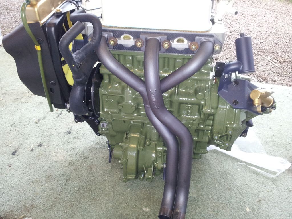

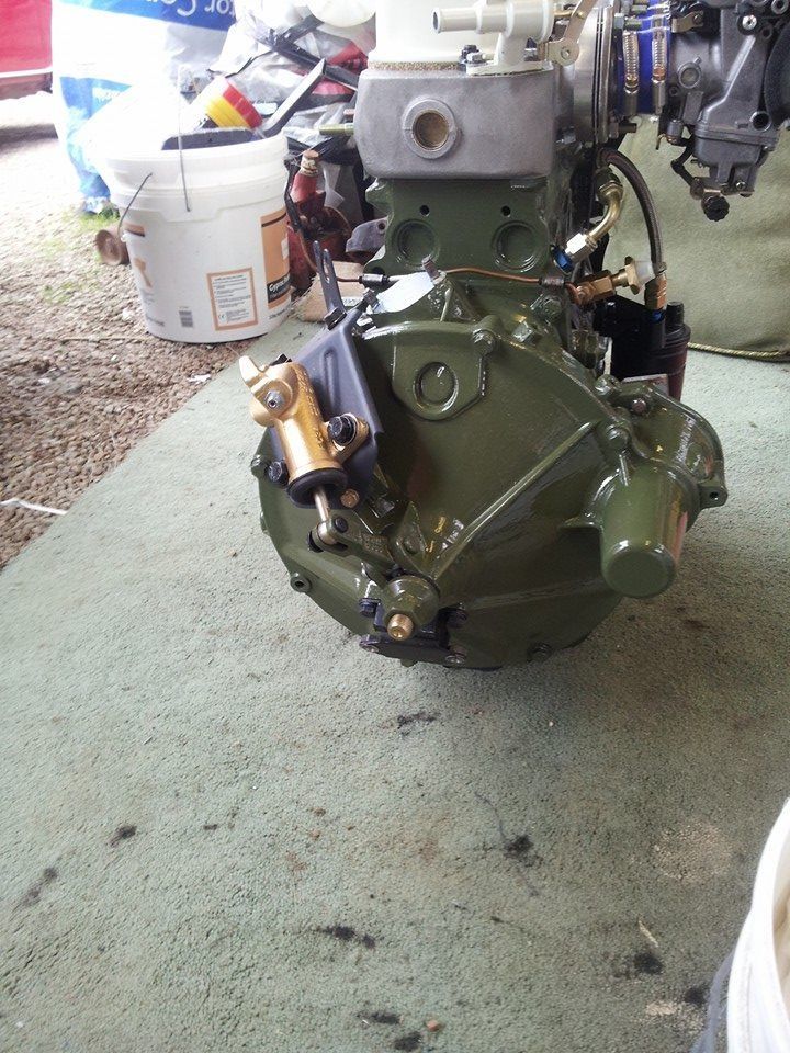

Hi..after MED came to the rescue with Proper clutch to flywheel bolts I have finally fitted the flywheel to the engine......
will try and hopefully fit engine into Bay but Jersey is destined to pour with rain over the weekend...........LOL

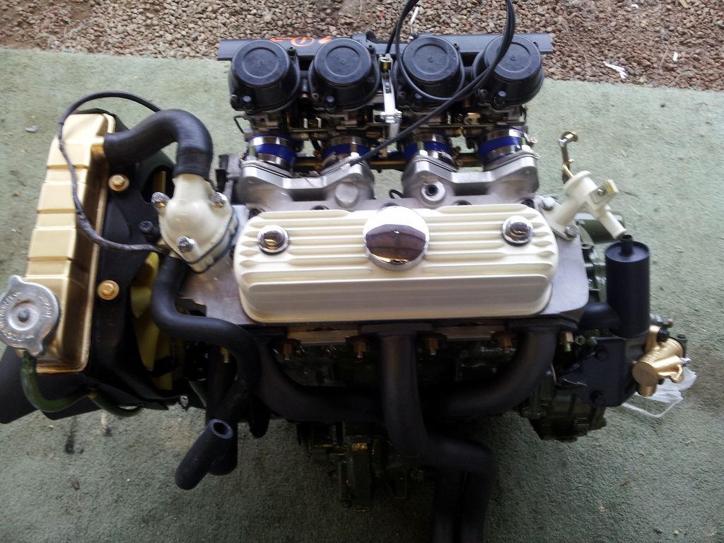

so I was hopeing to fit the engine in the car today but the rain stopped play ( no garage) lol.......so I test built up engine with all the ancileries to check if it goes together.....so far so good.........

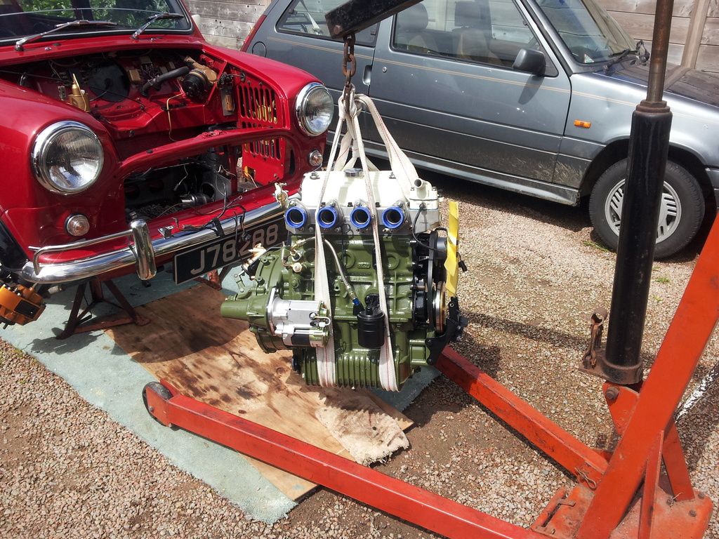

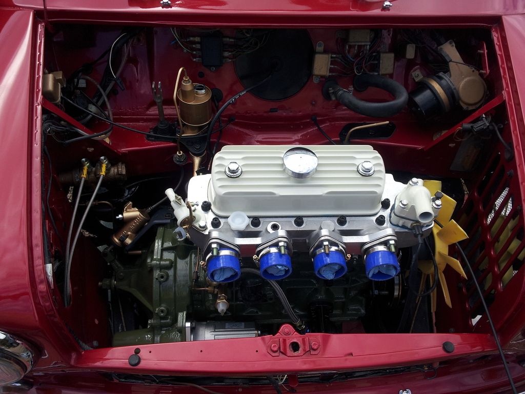

Posted 03 May 2015 - 08:04 PM
Thanks.......good news it was a dry day today and I removed the rad and altanator and fitted engine into Bay.........
still a lot to do.....fit fuel reg and new fuel line to front of engine.....refit servo and bleed brakes.........refit exhaust....put oil in....and waterless coolant......
