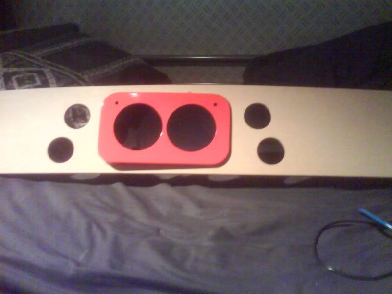

UPDATES :dontgetit:

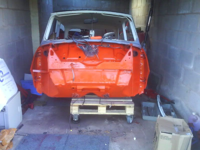

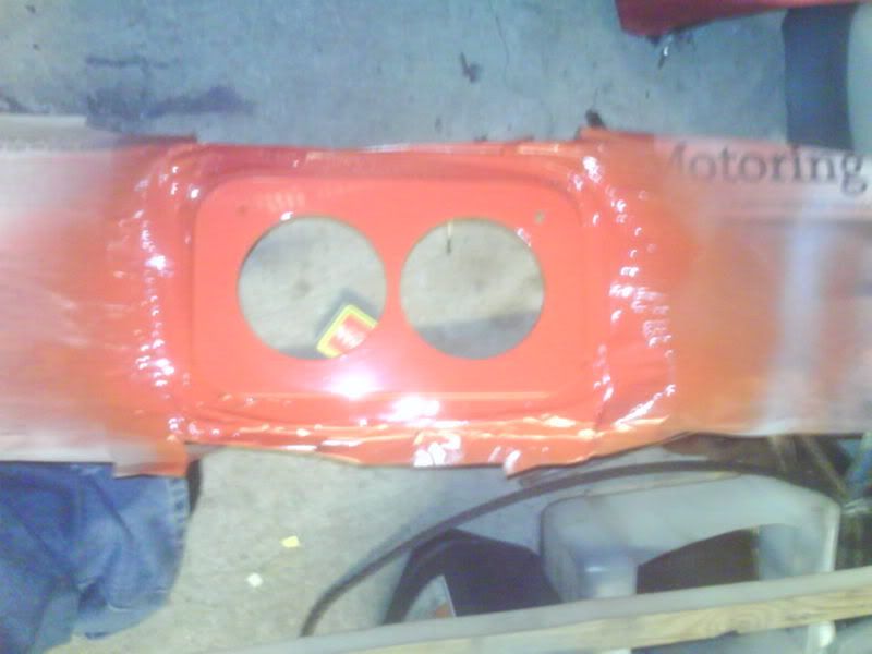

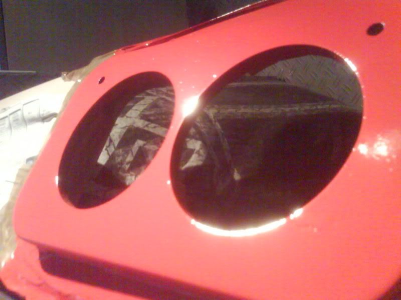

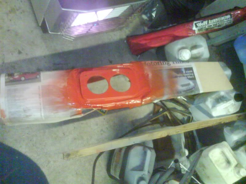

Ok today, after I primed my bulkhead, I gave it the first coat of paint... looks good with just one coat, but I'm going to give a few more, as the dash has turned out great :proud:
Dash in Prep, (last coat curing off)

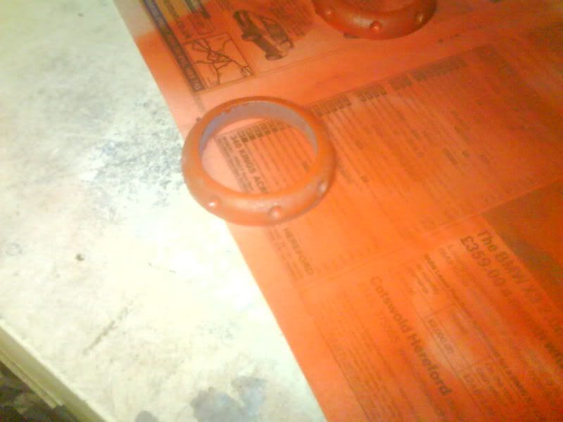

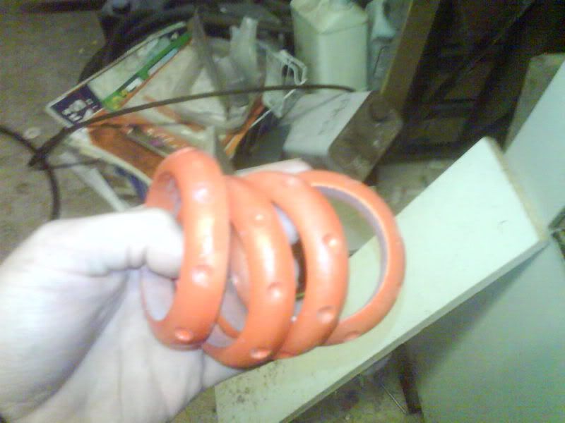

Dial surrounds, I need to re-think how I'm going to do these, as they are not going quite to plan :D
And finially the finished artical (well not quite) This is the centre bit done, once its hardened for a week or so, I'll go out and get some black leathatte, to cover the rest, and hopefully, I would of worked out how to make the Aux Dial surrounds match the centre peice :w00t:

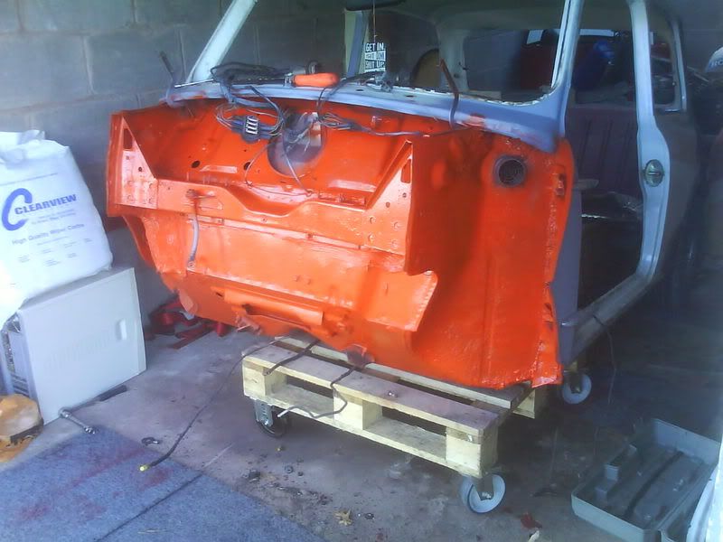

Some better day-light pics of the bulkhead
Before;
After;

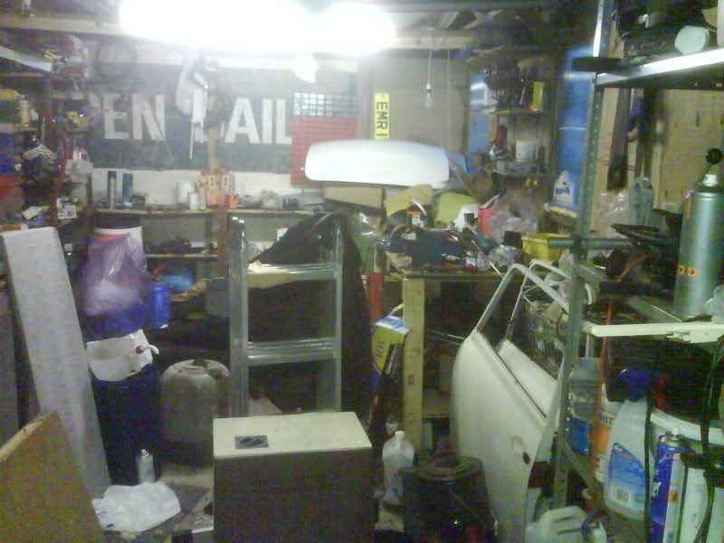

And I thought I'd post up a pic of my other workshop...
A right tip atm, as I can't store much in the garage due to the Mini being in the way!

how come u havent removed the floor mounts or the clutch hose before u painted, could be some surfuce rust under them?? or cut the bottoms off the hinge panels??
Edited by wobblybob, 17 December 2006 - 07:04 PM.
#627 Dog
Dog
    Deathwish Fairy
  • 9,550 posts
  • Local Club: Shatrats.com
Posted 17 December 2006 - 07:22 PM
Floor mounts I havn't removed because I haven't got a socket that I can use yet....
I'm not worried about them, as when I get my socket, I am going to remove them, then clean and red oxide, then paint on waxoil, so basically everything from the crease in the bulkhead down, is going to black waxoil...
The clutch hose... there is no surface rust under it
Hinge panel bits... they are part of the sill, so don't need removing, if they cause trouble later, then I'll get the hammer out, and bend them back over the sill.
