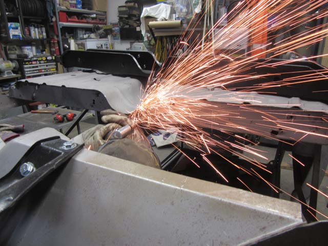

Posted 08 December 2015 - 11:28 AM
Both full length half floors are now in...some grinding to do today...and, might have the new heel board in today.
