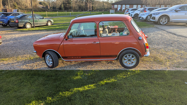

The Mini had a good run out to Beaulieu where I purchased a new steering wheel and front mats, I then went on to the Isle of Wight for a week, while there I popped in to see Ben to arrange for some work to be done later on in the year, the car has however developed a creak from the front suspension (front knuckle joints ?) and an exhaust blow as a result of going over a very high speed hump.

Thought I would change the carb float and needle valve to a Minispares ethanol resistant stay up float, I also gave the underside a good clean and noticed that there are a few areas where the paint needs some attention, the car is booked in with Ben in September so I have just treated the areas with hammerite kurust until then.

I have been getting the Mini ready for its trip to the isle of Wight Mini run and after that a trip to Ben's for some minor paint repairs, I have tried a different wax (Turtle Wax Ceramic + Graphene paste) on the roof and am very pleased with the results

After attending the West Country Mini day on the Isle of Wight, I took the Mini to Ben for some paint repairs to the bonnet, seam trims, sills and a couple of marks around the windscreen, Ben as always did a great job on the paintwork, he also injected some wax into the sills, repaired the brake light switch and adjusted the O/S lower ball joint which it failed its MOT on.

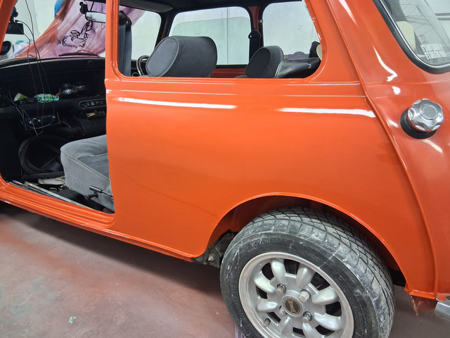

On washing the Mini I noticed what appeared to be a bubble in the paintwork on the passenger door about 30mm up from the lower edge, after removing the door card I could not see or access the area from the inside, so a 100mm hole was drilled in the door, this revealed a small area along the seam and door drain that looked discoloured, the rest of the doors internals looked good and were covered in wax. I have coated the inside of the door with hammerite  kurust (which turns black when dry), and will then prime the area before painting and covering with wax. It looks like another trip to see Ben to sort out the external paint is on the cards.

The Mini has been with Ben for a few days to sort out a paint issue on the rear quarter, on investigation it was an area that had not been bare metal resprayed and had several layers of paint which it seems had some reaction after a number of years, Ben has taken the area back to bare metal, he also looked into the rust bubble that had appeared on the passenger door, the door was replaced in 2019 after some accident damage, on stripping the paint off a hole was discovered, Ben cut the rust out and welded in a new piece of metal, the door and rear panel have been resprayed and new GT stripes have been applied, and the inside of the door has been coated in wax. Ben has done a Great job as always
