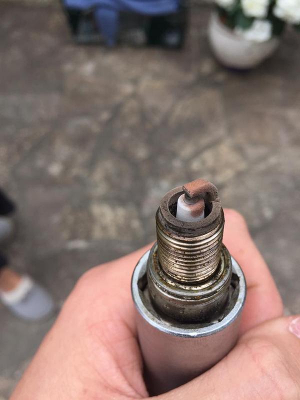

The needle is the one usually fitted with the stage 1 kit. My air filter is new and clean, the car starts instantly in the morning without choke but struggle to accelerate without it (only when the engine is cold). So I guess the carb is pretty well tuned...
But the spark plugs look strange...

Strange copper residue there, but otherwise it appears to be rather on the lean side. What fuel are you using?
It looks very lean on one side, but perfect on the other  O_O
I use Unleaded 95-E5, the only fuel available in Corsica
