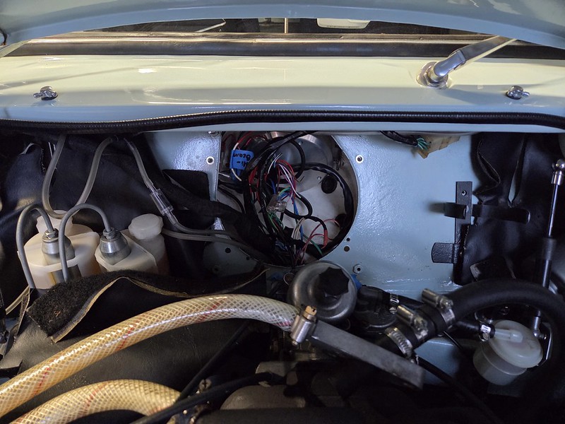

Figured I’d take some pictures of the speedo before I attempt an install this weekend. I did look into them, and a few of the different styles of mini speedos are available digital, but they’re from vendors that are charging a decent amount more. The black dial I got (SN4421-33CC) is $695 from minisport (Aus) the same from Howard’s instruments is $911. The necessary speedo adaptor (GSD1000) is $125. For me it’s a no-brainer, but if you want the closest digital speedo you could get for your mini, there is that option.
For a look at the different styles available out there (minisport.com.au only have two styles) check out the link below, I think pages 6 and 7 have the electronic
https://www.howardin...ogue - Mini.pdf
