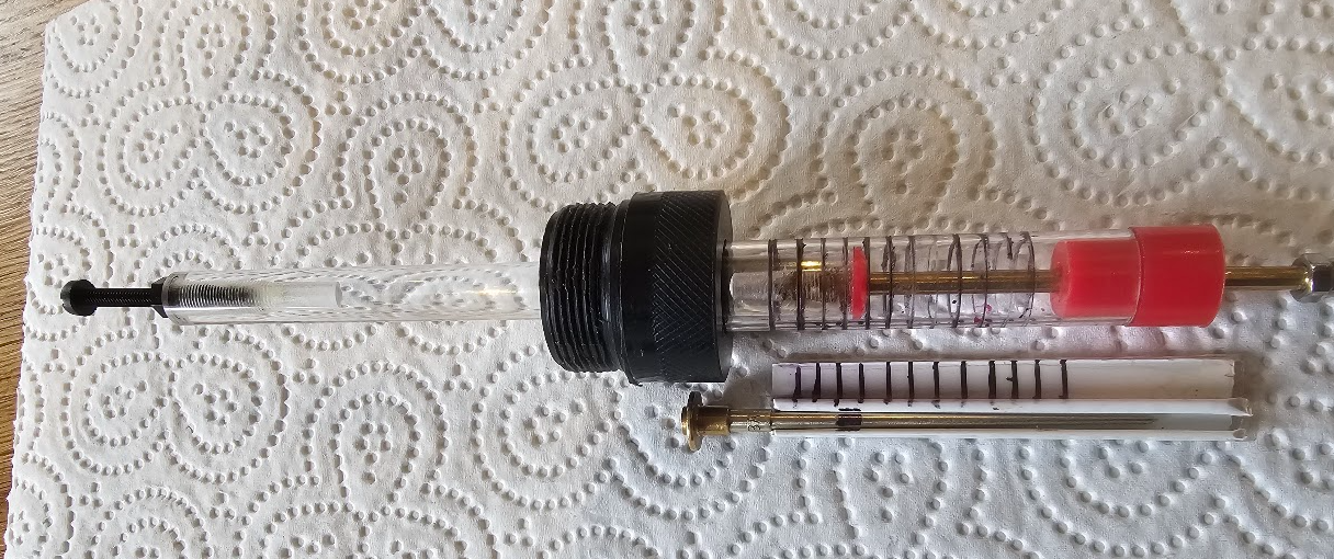

by the way, I made myself a "needle-station" finder for tuning.
Looks interesting do you have a link to what it is/how it works or could you explain a little bit please? (I understand the idea of tuning different parts of the needle, just not what the gadget is or how it works)
thank you!
thank you!
HI,
The idea on this one is that the adjustable foot allows you to represent  the actual height of the needle with the engine off (where the jet is wound down to and the bump stop of the carb piston typically 60 + 12..15 thou').
Then when you run the engine the indicator rises to show you what station of the needle the engine is fuelling from.  What you do is slowly increase your revs to half-throttle and note any point where the engine "stumbles", that station is where you adjust your needle by polishing with 1/8" wet & dry strip.   The whole process is documented by Des Hammill in his book "How to Powertune   SU Carbs".  He just used a bamboo stick with a paper taped to it.  I tried to be a bit more elegant is all. :D
So far I have made 4 for HIF38/44 carbs and 2 for HS carbs.  Only because the project fascinated me and I had the materials and the lathe all ready to do it.
I am not sure whether the engraving on the sight glass and the adjustable foot is best or just having a printed slip-sleeve over the sight glass for initial position set-up.
It has all been prototyping and experiment.  But it does indeed work and bob up and down as you alter the rev's/throttle.
